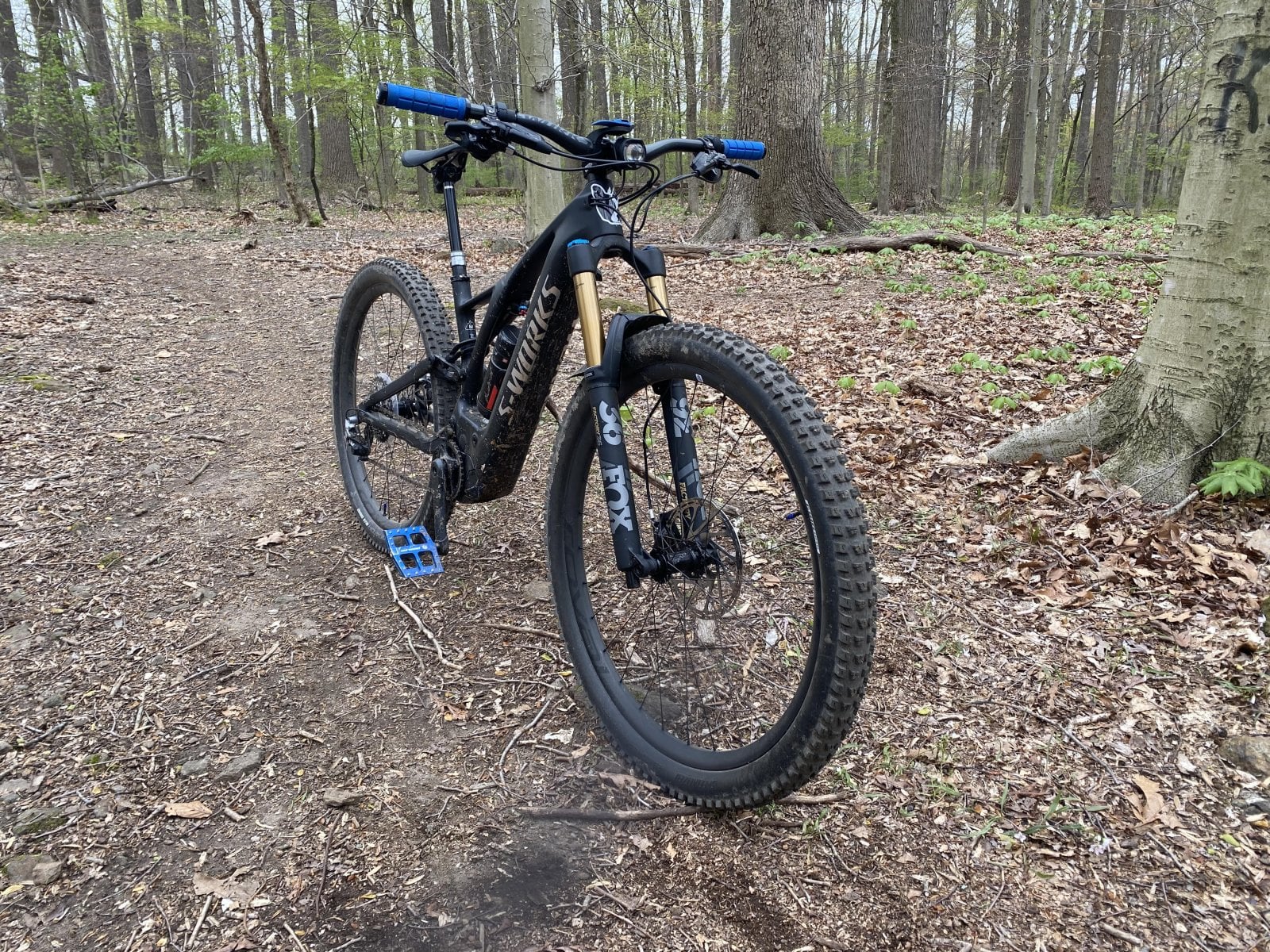

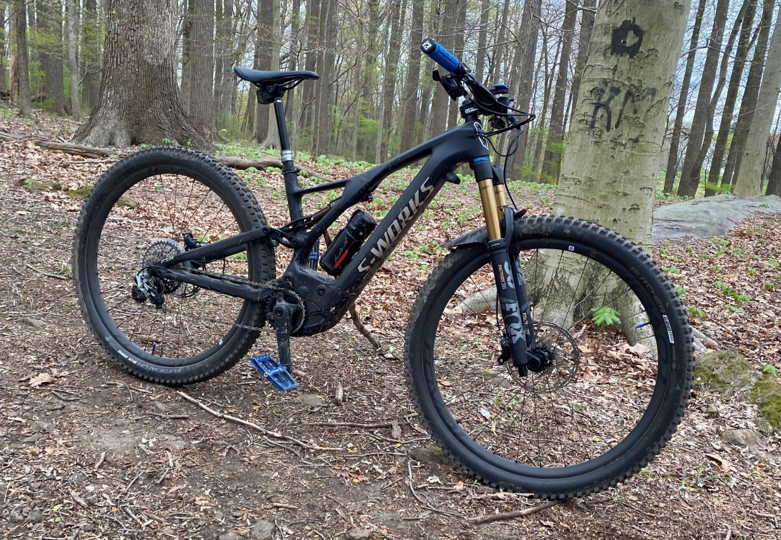

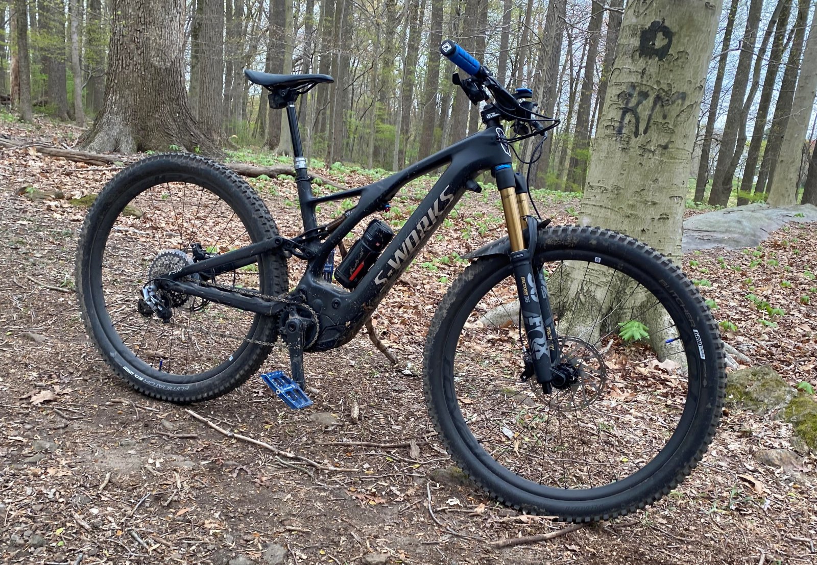

I thought I should post my SECOND 2020 Levo... when Specialized marked down and rebated the Sworks, in my size, and in my color... and my dealer closed the gap, I couldn't resist. I love my 2020 Comp but it is on the block!

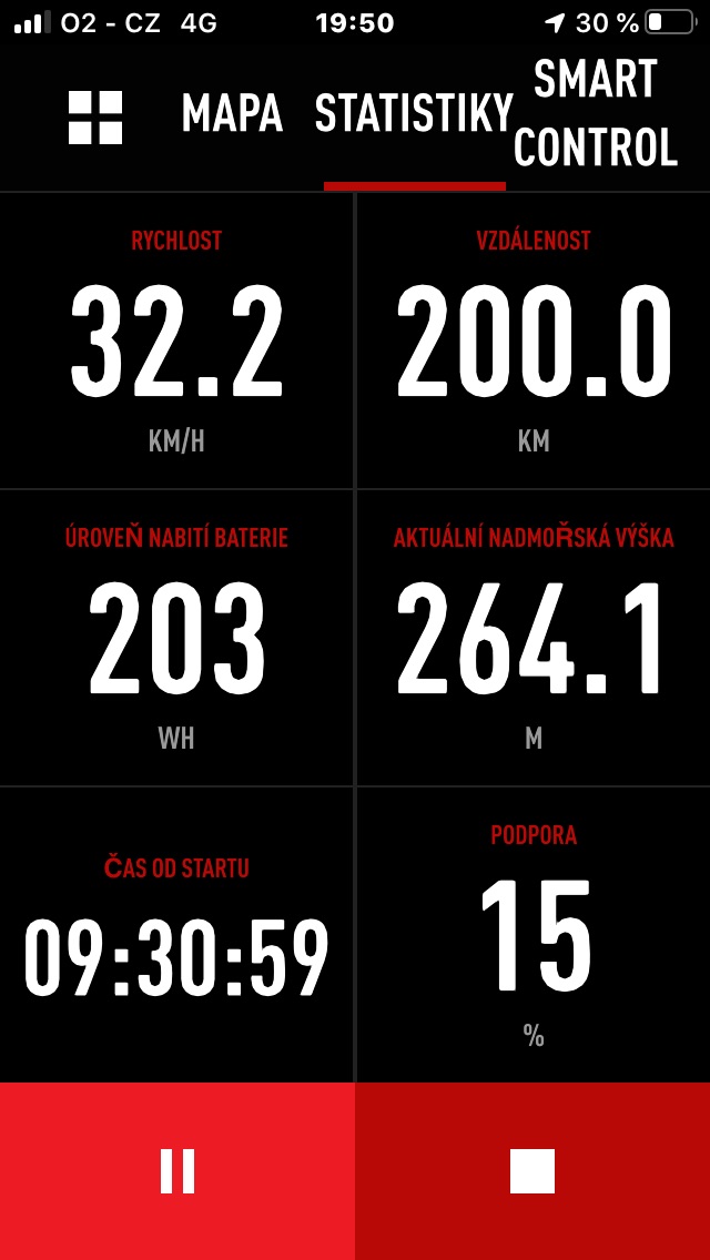

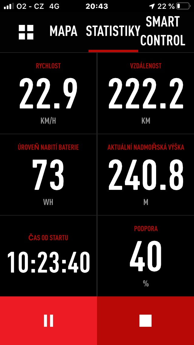

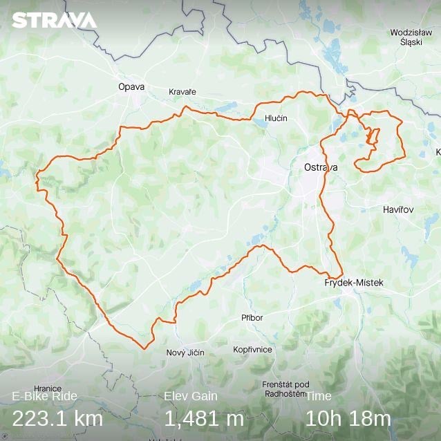

Jirka_S
Sep 8, 2019
30
31
Czech
On Saturday I did a longer trip, 223 km, didn't charge or change the battery. Even after 200 km I had still about 28 %, but my bottom said strongly enough.

Jirka_S
Sep 8, 2019
30
31
Czech
You're right, mostly flat roads. I am 90 kg and 59 years old so I wanted to try what I am able still to do.

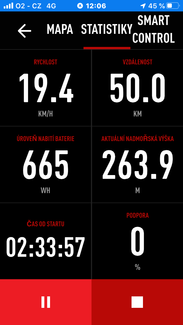

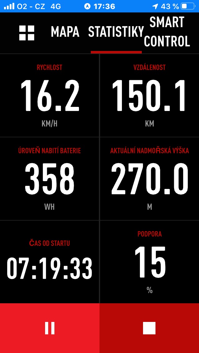

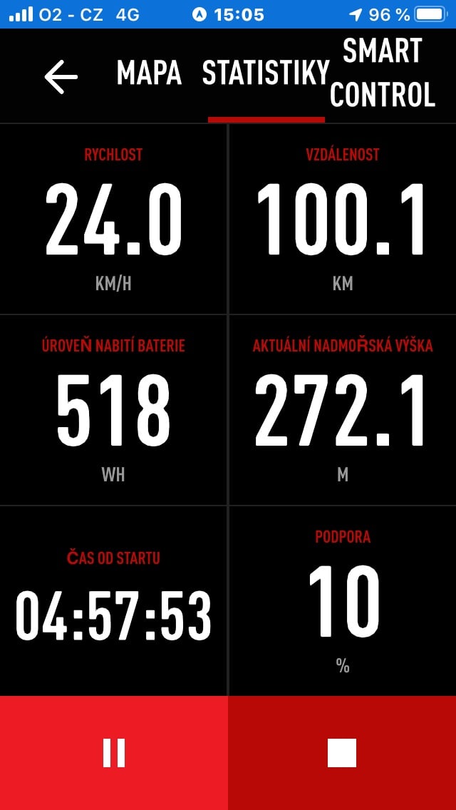

Jirka_S
Sep 8, 2019
30
31
Czech
BTW, I did printscreen every 50 km. It's seen from beginning I rode mainly without engine. Some parts I rode more than 25 km/h so without again. After 200 km I was really tired so I've set the Turbo or Trail for last 23 km around home. If not it would be possible to do in sum over 250 km, but not the same day.

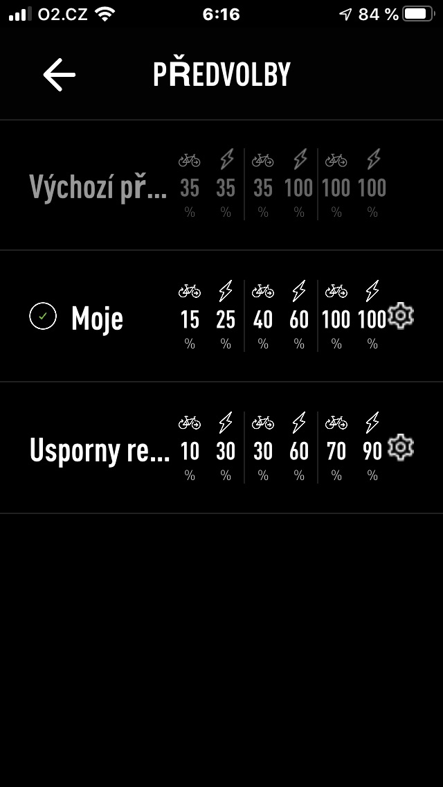

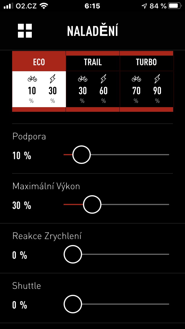

Levo Laland
Nov 27, 2019
274
236
Surrey UK
BTW, I did printscreen every 50 km. It's seen from beginning I rode mainly without engine. Some parts I rode more than 25 km/h so without again. After 200 km I was really tired so I've set the Turbo or Trail for last 23 km around home. If not it would be possible to do in sum over 250 km, but not the same day. View attachment 31033 View attachment 31032 View attachment 31031 View attachment 31030
You might be interested in this post I made:
100 mile range from a Turbo Levo with 500w battery! Normal bike SIM settings. - EMTB Forums
It focused on maximising range, but these settings can be used fix the assistance at a defined wattage assistance which you might find useful for road or XC rides. Each 10% segment of Peak Power is approximately 56watts (100% = 560watts). Here support mode is 100% so power delivery is constantly and safe to max. You will in theory get 40% more range from your 700w battery.
Jirka_S
Sep 8, 2019
30
31
Czech
@Levo Laland: thanks, it looks interestingly, will try it next ride and will see. I have no problem to ride just on myself for a long time but on the flat, on some bigger hills I am very glad I have the engine.
Usually I calculate 1% for about 2,5 km of medium difficult route. On mountains, in forest on pedestrian trails doing over 2000 m of EG my 700 Wh battery is OK just for about 70 - 90 km.

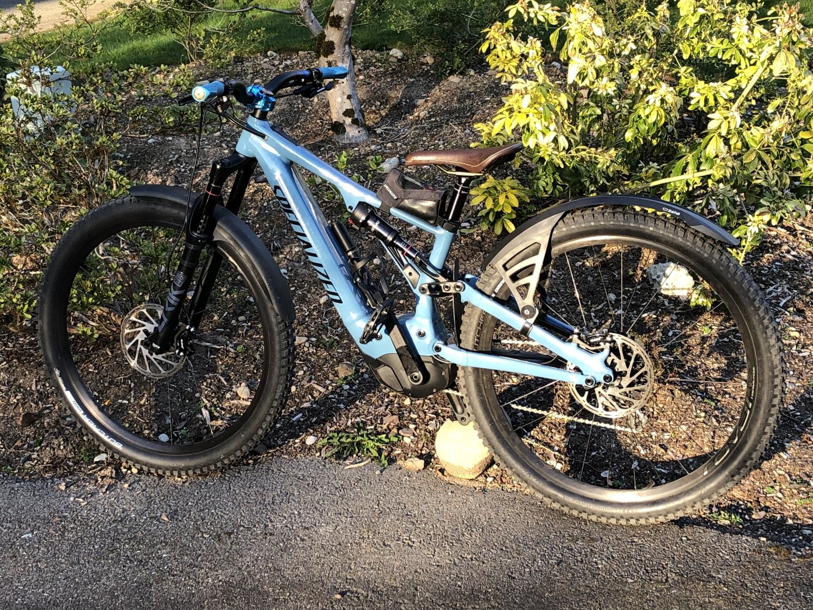

N928TC
May 8, 2020
11
Seattle
Went for my first real ride today with my 2020 comp. I was surprised how noisy the motor is, even in eco mode. Is this to be expected? Lbs says it’s normal Even though he hasn’t heard it since shop is closed for covid. I had test ridden the 2018 which was quiet in eco then progressively louder in each mode And expected similar on the 2020. I was under the impression eco would be quieter than trall. In fact turbo is just slightly louder than eco. I’m hearing a whining sound all the time.
Bike is all set up nice though and looks beautiful — got some compliments on the trail. View attachment 28616
Nice setup! Can you tell us the manufacturer/ model number of your front fender? Thx!

grantini
May 7, 2019
611
539
Delaware
Can I ask how different the S Works feels to the Comp. Ride lighter, feel much better?
I've been paying more attention and I feel I'm really able to go through rough stuff much faster and with more confidence... as you can guess it is hard to quantify. Oh it IS a little easier to load onto my Kuat rack!

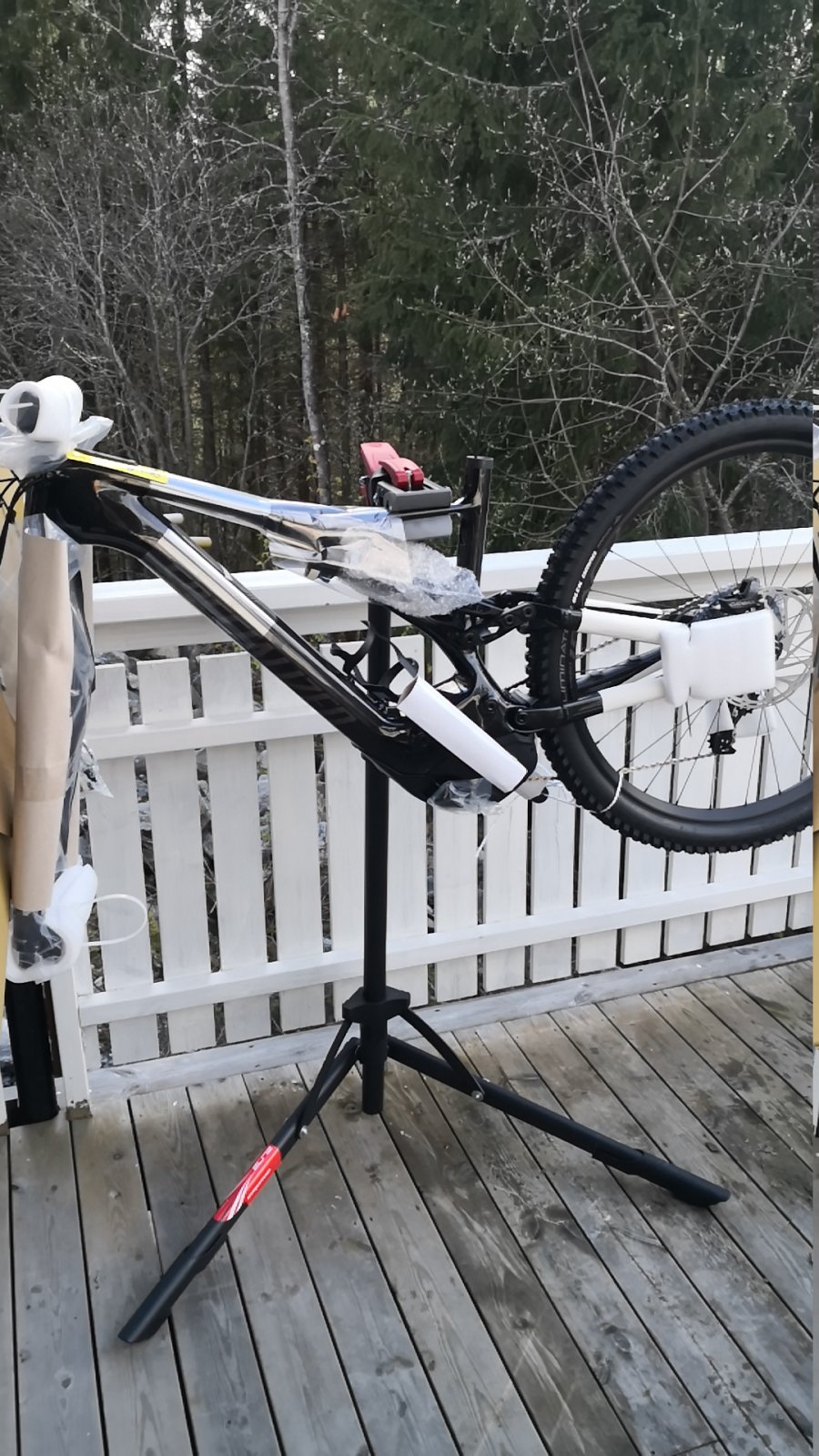

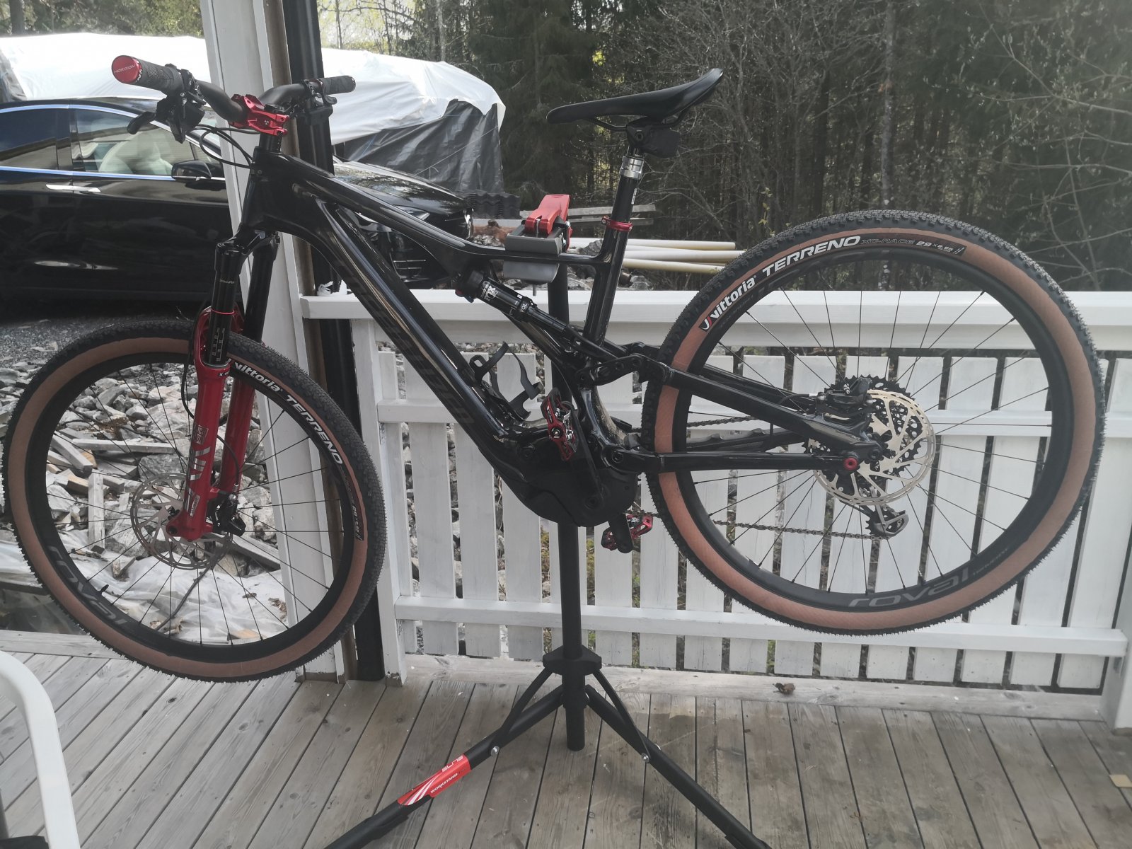

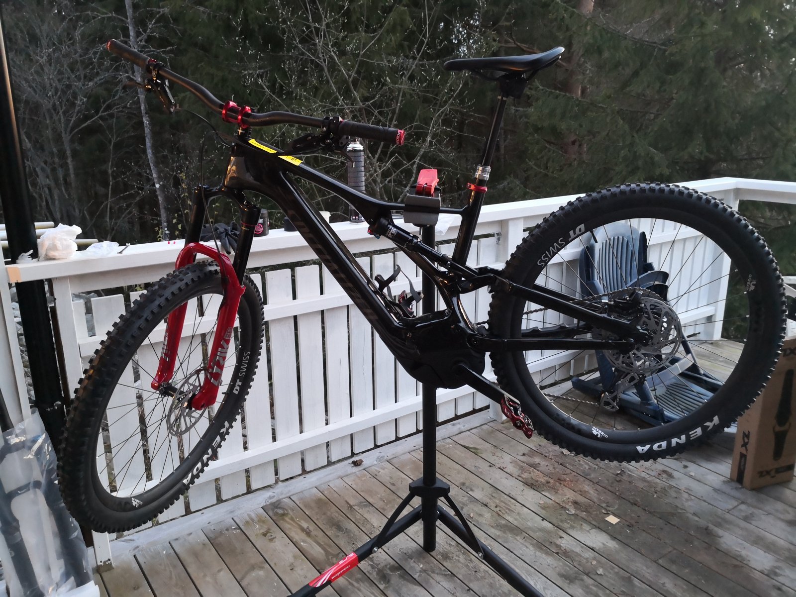

YrianX
Sep 14, 2019
205
253
Norway
Hi all, I'm baaaaaaack :)
And I can finally count myself a true Levo owner, not just a confirmed reservation holder. Even though I never got the S-works frame as planned due to current situation and specialized not being able to deliver that apparently, I did end up with a complete expert instead, which I put all the bling bling on.
Here's a few pics from when I built it for now both with trail wheels and commute wheels. Further pic's will come... I promise ?
I know, I know, not even drive side ;) I promise to do better.
Bling list so far:
2020 turbo levo expert carbon 700kwh
Rockshox 160 lyrik Ultimate
(still using the fox rear shock)
Sram code Rsc w/200mm rotors
Sram axs eagle X01drivetrain
Praxis 36t chainring
RaceFace next r carbon cranks
DMR v-twin SPD pedals
Sram reverb axs 170mm dropper
Ergon e-bike seat
Nukeproof horizon stem and grips
Renthal carbon fatbar v2 30mm rise
Dt swiss hxc1200 and hx1501 wheelsets
Tyres ready to go for testing: Kenda Hellkat, Vittoria Martelo, mezcal and terreno (love the Vittoria tires so far for commuting and xc style trails ) Maxxis Rekon, DHF/DHR II and Assegai.
Hope we get a nice long, warm and dry summer ?
Sorry for being away for all winter. Been missing the hilarious forum banter you all excell at.
