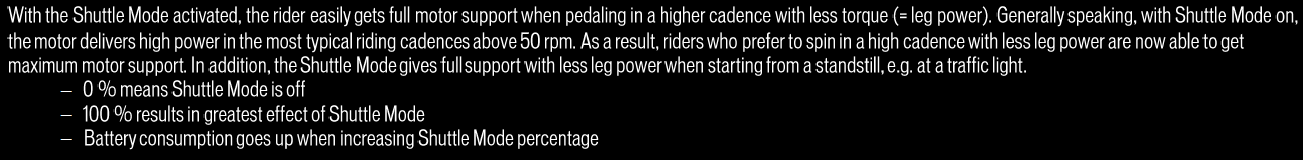

A completely new feature is the Shuttle Mode which can be enabled through the Mission Control App. Enable it and rather than the usual torque based assistance, the motor provides power based on your cadence. That will be especially useful for less fit riders because the full power of the motor is delivered with a lower pedalling input. Simply put: at higher cadences (from around 60 rpm) the full power of the motor is used without having to pedal at 200 W.
Why do you even need Shuttle mode?
If you can't pedal 150w-200W on a climb, than you will get little less boost, no big deal.
This sounds a lot like what Boost on a shimano motor does if set to max assist.
I have always had boost on mine set to max.
at my local DH venue I can soft pedal (barely trying at well less thsn 200w) at a fairly high cadence all the way up the fire road climbs staying at just below the 15mph assist cut off.
Why WOULDN'T you want this?
9,190
I think what it does is enable full boost even if in your normal settings you haven’t got the boost maxed out.

Also posted in the Mission Control section, please see below for a description of what Shuttle mode is. We're proud of it - it works well and there are no known bugs.
IMPORTANT: When we started production some months ago the available motor firmware did not support Shuttle mode - hence each bike needs a firmware update by the retailer prior to hand-over. This firmware update greatly improves walk-assist, and activates the shuttle mode & acceleration response features within Mission Control. Whilst we did all we could to ensure retailers understood the importance of this firmware update, it could be that one or two bikes left stores without it.
You can tell if your bike has had the firmware update or not by checking the display and motor firmware in Mission Control, display firmware should be 19b and motor firmware 6.1.0. If you are seeing 13a and 6.0.0 or 6.0.1 respectively, please contact your retailer and ask them to get your bike updated. Takes approx 5 mins.
