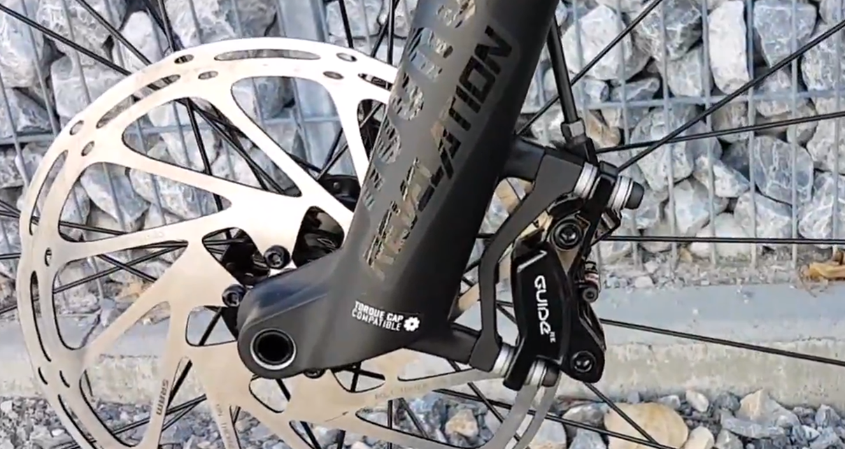

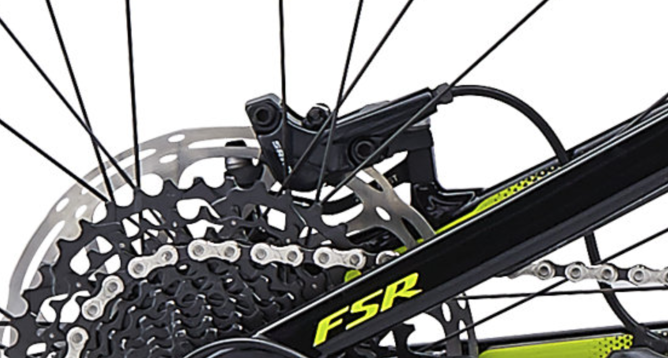

Stll looking for a photo or 100% confirmation what caliper adapter is on the back of Alloy LEVO.
Fork for entry lavel will exept 160mm rotor native and Comp 180mm. For the fork adapter will have to use;
160 mm fork mount:
SM-MA-F203P/P2 - for using a 203 mm brake disc
Couldn't find decent photos or video for the back. But still. booth adaptors look the same?

If the adaptor is the same on the back 180mm native, what would we logical Sram 20mm post adapter for 200mm?
If this is correct than for Shimano setup, will have to use SM-MA90-F203P/P on the back, right?
160 mm fork mount:
If you are changing brakes why don’t you just leave the adapters on the bike and do a straight swap. Unless you are swapping the discs as well to a different size. I’ve had Shimano, Magura and sram on my current bike and just leave the same adaptors on the bike.
I was thinking, that I have to buy Shimano 203mm rotors, so would have to go with Shimano adapter.
But as I just read, people are mixing SRAM and SHIMANO rotors-caliper combo, with no problems.
So basically, If I leave the Sram 200mm Rotors, I can just leave the same adaptors on the bike, problem solved?:unsure:

if you use shimano 203 rotors with sram 200m mounts you need to space the caliper about 1.5mm.
my opinion best to swap the mounts for shimano ones
I know, if I will use 203mm Shimano Rotors that will have to use Shimano 23mm back and 43mm front adapters.
But as Ledg sugested, I could just run Sram 200mm rotors with existing adapters, will have to decide. In the past, I have good experience with XT Ice-Tech rotors, don't know about Sram centerline rotors, if they are silent like XT.

I use centerline rotors with shimano brakes and they work fine little bit noisy when wet and muddy but could be the pads
Dura Ace and XT got also little noisier in the wet.
But if Sram centerline are OK in dry conditions, where I ride and will ride 90% of the time, will probably go that route too..;)
