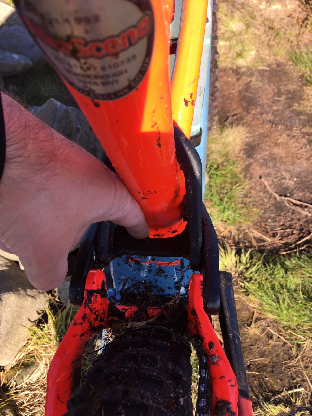

Had the updated top link installed and latest firmware.
I can now get my finger between the frame and link.
There's a couple of marks on the frame :-(

Is the marks from the install ?
Ive ordered mine from them and I seen the bike in the shop floor had it already installed.
I take it, it’s not working if you can get access
I would guess that the marks were caused by the original linkage not letting small stones drop through, so they sit there scuffing the paint.
The new linkage has a bigger gap allowing stones to drop through, therefore reducing any scuffing.

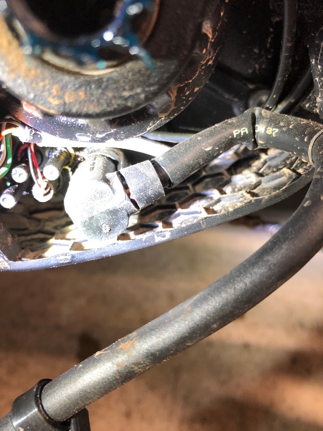

Decided to open my motor casing today to check up on the crud. The rear mudhugger and foam insert are certainly doing their job! Only very fine dirt in there which was cleaned up by using an air compressor and cloth. What i did notice though was the dreaded power cable insulation cracks!
I’m not experiencing any issues but will speak to Berkshire Turbo tomorrow.

Yes that will definitely fail in due course.
I can't see what is causing the cracking as that part of the cable does not look like it's under stress?
I exactly had the same! Also happy about foam mod but Specialized needs to find a permanent fix for the cable problems.
I am sure they will but it will take some time to find the root cause and right corrective action.
Would it be worth putting some electrical tape on it to help it last a bit longer?

I don’t think it’s quite that simple if you look at it on inspection..I think heat shrink would be the ticket but would need removing prior to taking it back to your LBS I would imagine as it’s a mod which would most likely get frowned on..
