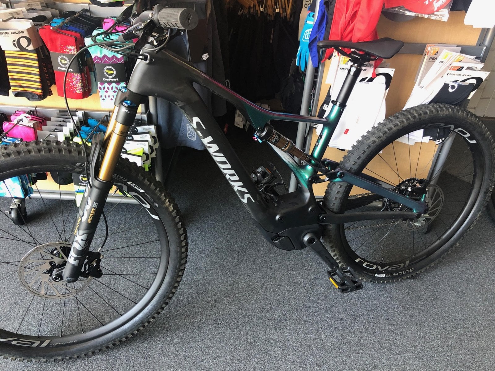

Hi everyone. It seems that the next levo that will arrive will be like this. It would have been nice to think about it first. :p

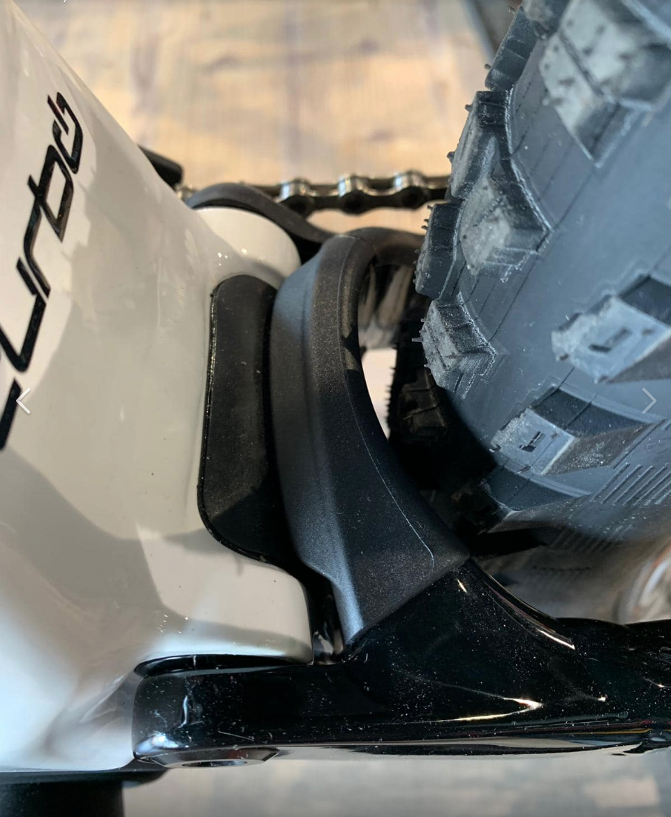

3 emails regarding parts sent to Customer Care in the UK, all ignored.
The mods show there was an original design flaw and as such the bikes previously manufactured should be fitted with the new parts free.
What do people think?
For sure they should, but Spec's approach is to wait for individuals to complain rather than treat like a recall.

This is referring to the parts now available to close the gap that allows debris to enter the motor casing, see the pics above re the new bike releases

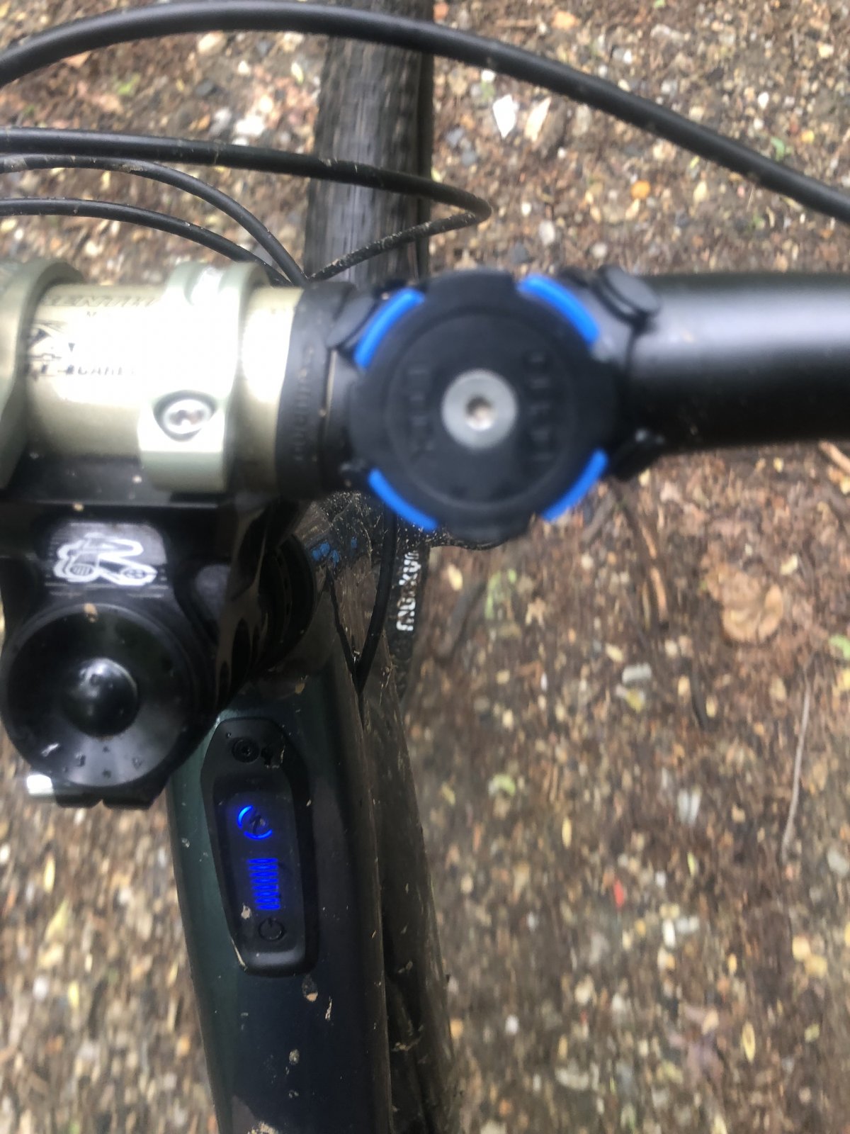

I had the cutting out the other day. At first I thought it was due to motor temp but it wasn't. I was running BLEvo with my HR monitor. So I reset BLEvo to stock Specialized including wheel size. Then swiped BLEvo off on my iPhone and ran Mission Control only and the cutting out while pedaling stopped. Never had any fault code

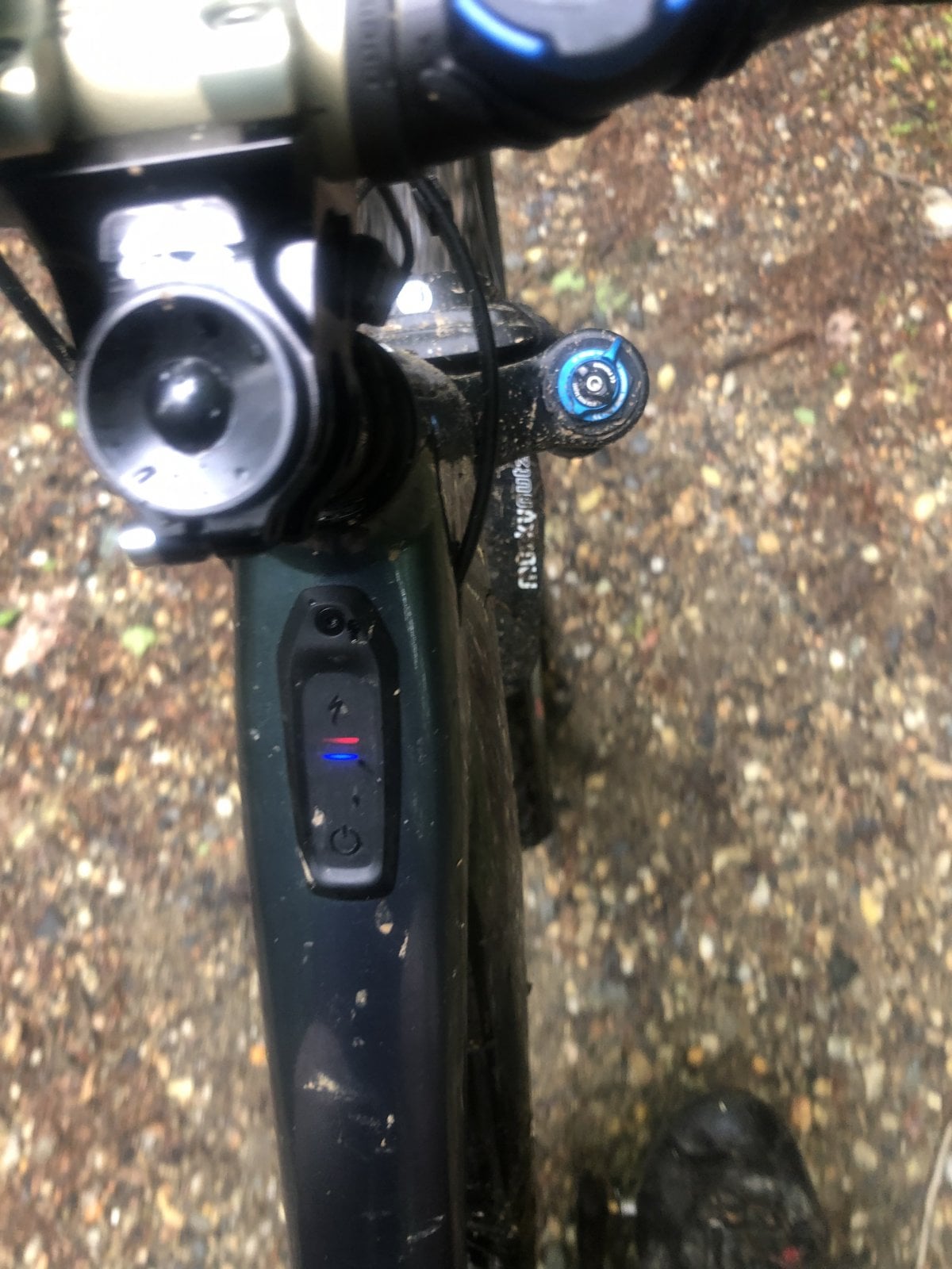

Did your display flash the red light like mine?
I also forgot to add when I first get on the bike and start out for the first 5 to 15 seconds the bike works properly and then I get the code

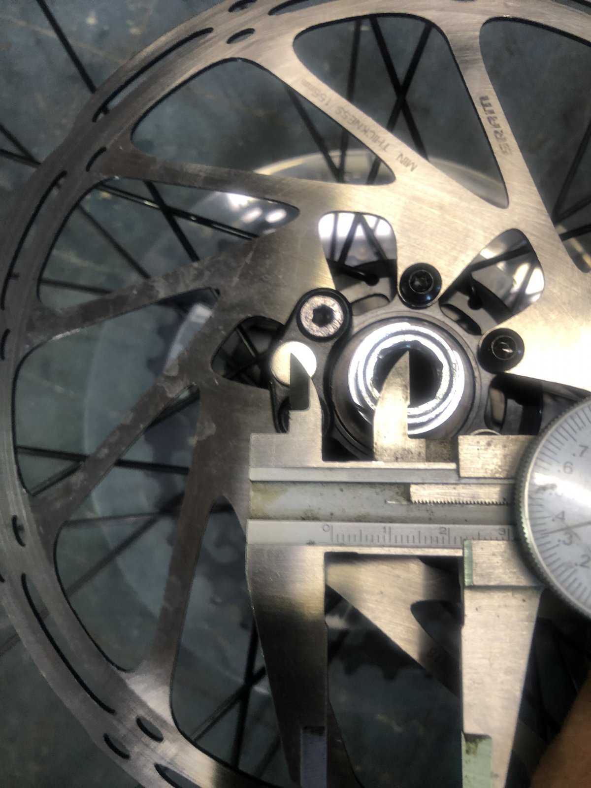

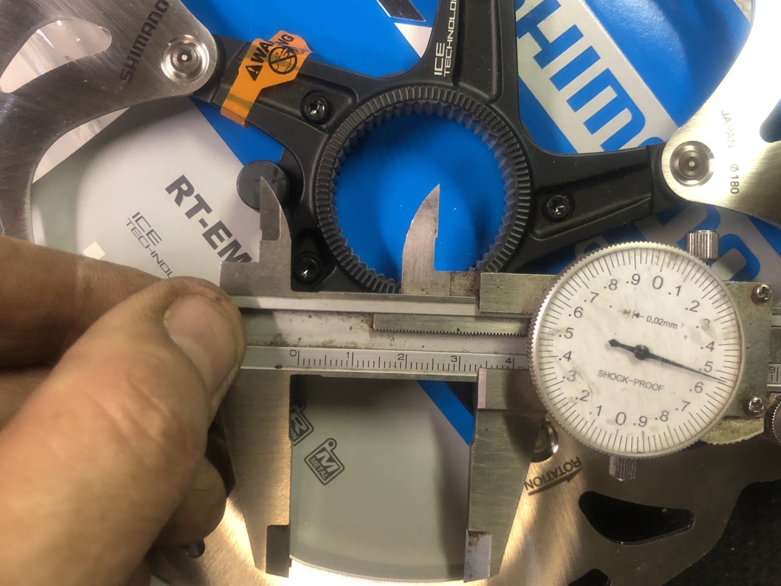

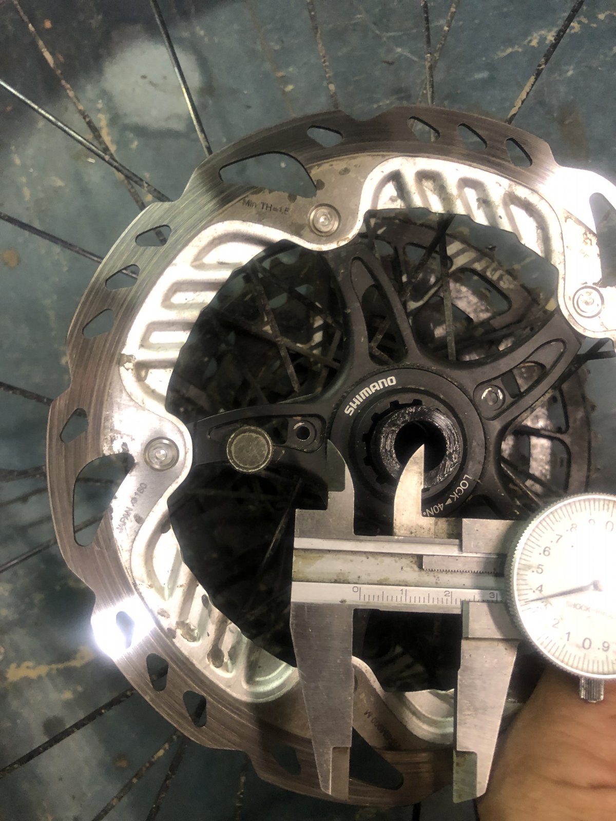

I just found the problem I was using a light carbon wheel set that I built up for my focus Jam2 and I drilled a hole in the rear rotor 40 mm from center where the Jam2 pick up is the stock specialized is 22mm from center I just tested it with the Shimano E bike rotor at 34mm from center and it works perfectly.
To some it up make sure your magnet on the rear rotor is where it supposed to be. 22mm from center .
The thing that threw me off is the bike work perfectly for the first 26 miles with the magnet in the wrong place .
See pictures
See pictures
Third picture is Shimano about 34 mm from center
I never got the red flashing light. I think it was BLEvo and my HR monitor acting up
I'll experiment tomorrow
I've seen that a few times - when the bike starts OK, but only runs for 20 seconds or so and the red / blue lights go on, it seems to be because the speed limiter detection system takes that long to work out there is something wrong; first time it was water in the speed sensor cable connector (after the bike had been washed), and the next time it was a piece of stick that had jammed up into the speed sensor. Both times the bike went back to the dealer to be fixed - the second time they replaced the motor before realising what was wrong !
