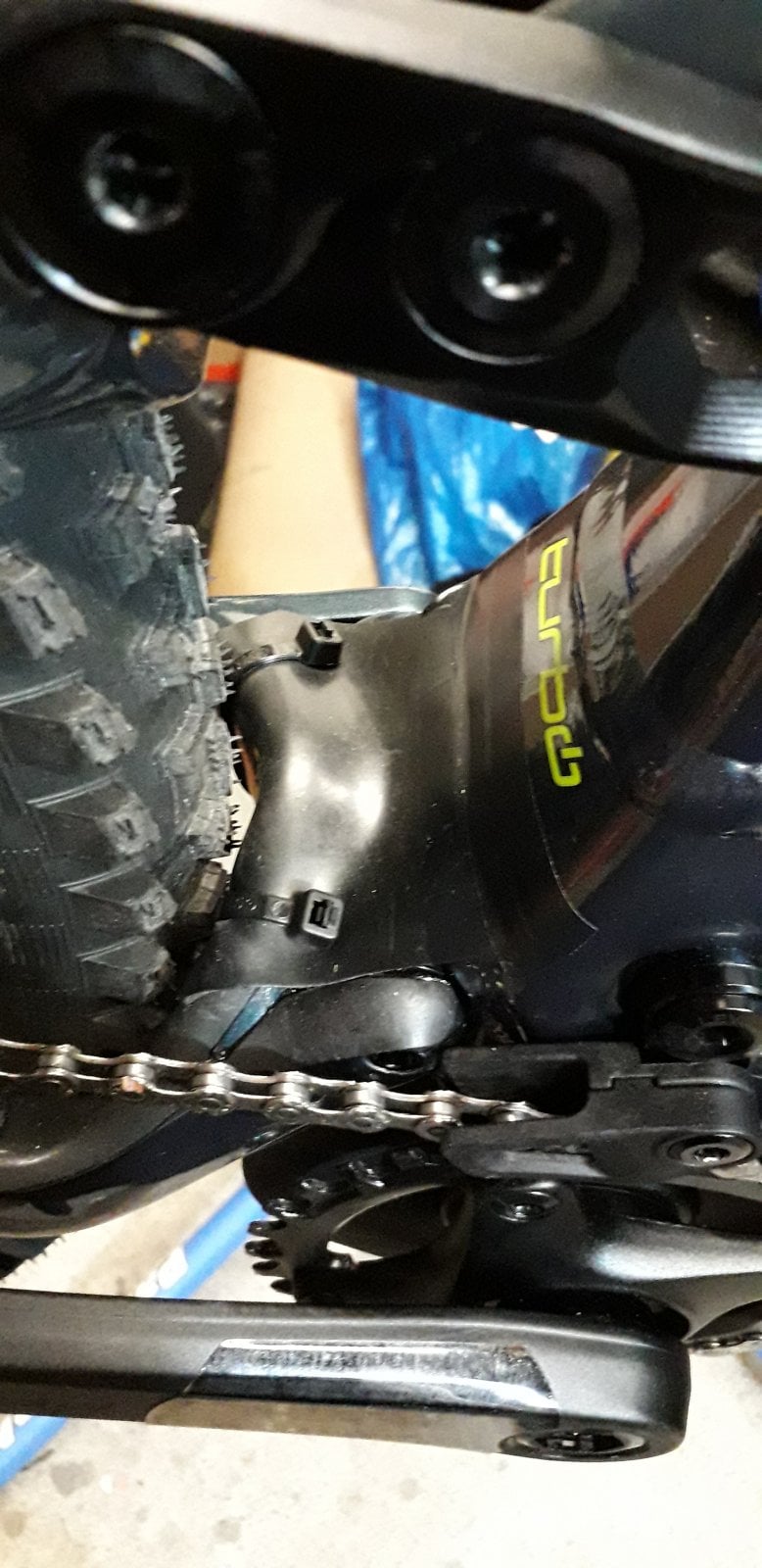

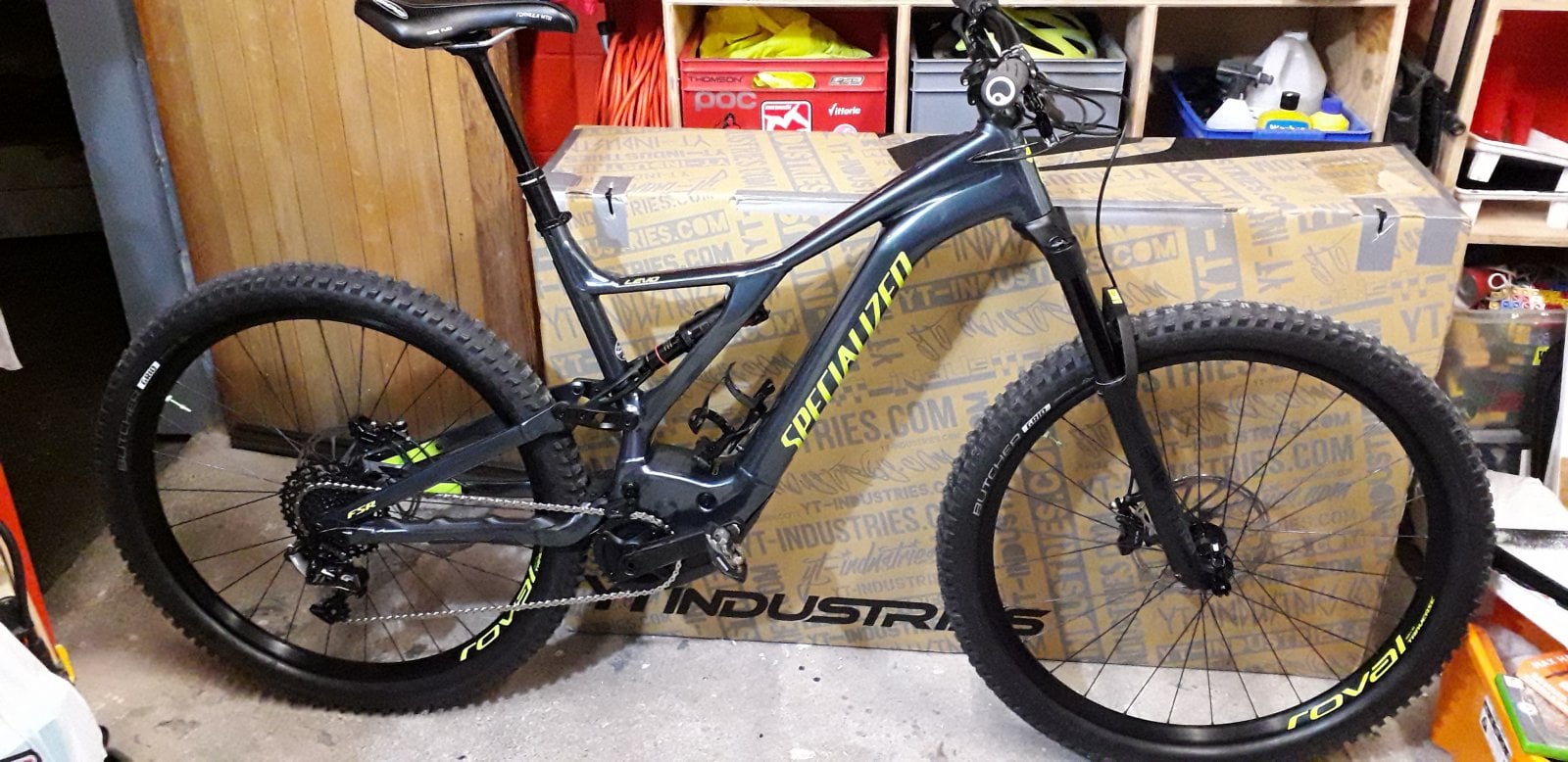

Just got my alloy Comp in XL, its the "Airflow" version with the open top motor which I have covered with a rubber flap for now. Also has a noticeable whiny noise under load (silent in ECO). Both issues I will go back to shop for them to sort out, but in the meantime I'm just going to enjoy the riding, which is amazing.
