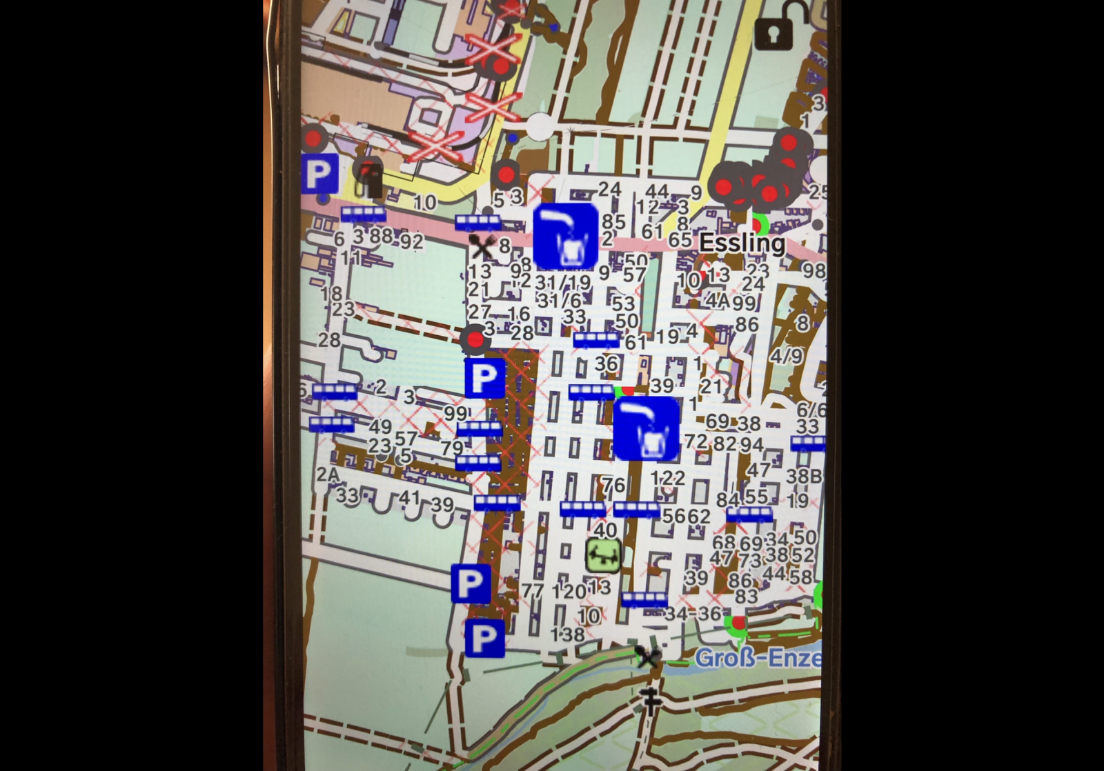

I just saw on page 2 that you updated openandromap. Last ride I did notice this change and wonder why it looks different. But is it possible to switch back to the old version? I don’t want to see so much point of interest, bus station etc. Can’t even remind me that there was the number from the houses to see an the map. It looks totally confusing now. You can see it on the picture! Is there a way that it looks like before? Please was much better ! Thx
+1 I tried to switch to one of the other map styles, but nothing is as good as it was before the change.
In the new release, you can choice the theme you want.
Under the folder /BLEvo/MAPS/theme/ you can copy the xml file with the theme of Andromap you want. In this folder, if you omit to copy the images, you will have the same map as in the previous version... Obviously you have to select the custom theme in BLEvo.
You can find the XML to load in BLEvo here
Legend andromaps_mtb mountainbike theme
I hope this can solve your issue.
Thank you, looks much better now 👍
