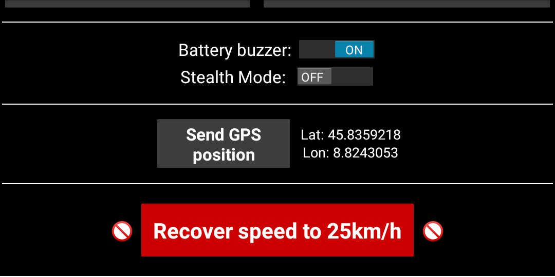

Hello,
I have a couple of questions and a suggestion for BLEvo. Apologies if these has been asked before and I missed it when looking through the thread
I have one bike (Levo HT) and two batteries, the 400 that came with the bike and the 500 for extra capacity. (for the curious, if I want to go for a really long ride, being a hard tail (XL Size) I can strap the second battery to the crossbar with Velcro straps )
My first question is,
I find when changing the batteries its very difficult to get BLEvo to connect to the battery I just fitted, It still connects to the Old battery, even though its off. I try all sorts of things like exiting the app and restarting, turning on and off the battery, taking the other battery 100m away out of Bluetooth range, turning BT off and on, going into the setup and re-adding etc. After a while it does connect to the battery, but I can’t find a consistent, reliable way to do so.
If I load up Mission Control it has my two batteries listed and its straight forward to select the one I have installed and it connects.
Is there a way to easily connect to a different battery in BLEvo ? I’m using BLEvo 3.9.6, The battery firmware on the 401 is 12.33.10 and on the 504 its 10.33.10. The TCU is 1.7.0.

Can I get BLEvo to announce my battery status as it drops. I like to have BLEvo in my pocket and listen to the announcements and it would be good to know when the battery gets to certain points. So something like ‘Announce battery status every 5%’ or some other figure would be great.
Thanks so much for a great app, I love my HT, and this app just adds so much extra love!
Answer 1: even if the battery is switched off, the BLE module is active for 2 hours. So for connect the new battery you should go in Configuration->Scan for Bike->Select the new battery

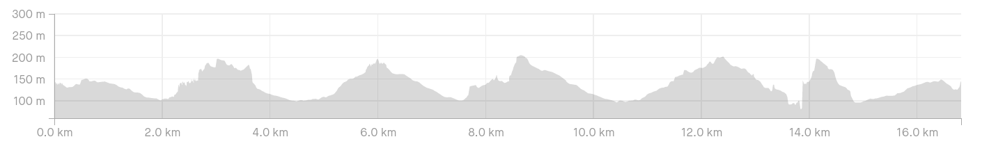

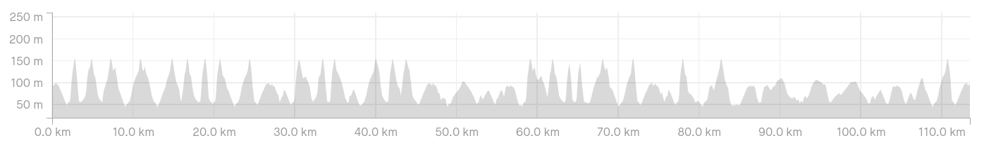

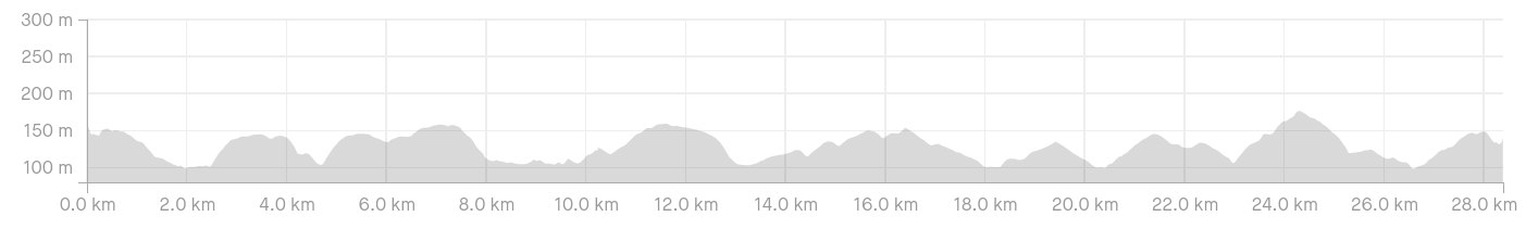

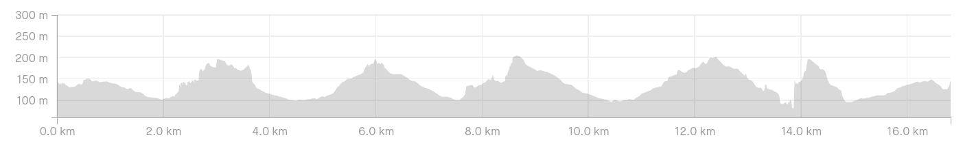

Hi Paolo,
Just been messing around with the same ride recorded in Strava and Blevo. Recorded In Strava, it looks like this (Xiaomi Redmi note 9) :
Recorded in Blevo and uploaded with "upload to Strava" : (quite jagged, altitude about 30% more than Strava)
Normally, if I then send the fit file to myself and upload it, that fixes it .. but today it's not - after a manual upload - it stayed the same :
To make the problem more complicated - it doesn't always do it.

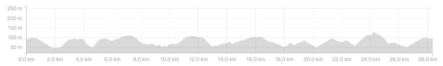

This was yesterday - recorded with Strava :
Recorded and uploaded with Blevo : Slightly more jagged, but ride altitude was the same within 5 meters.

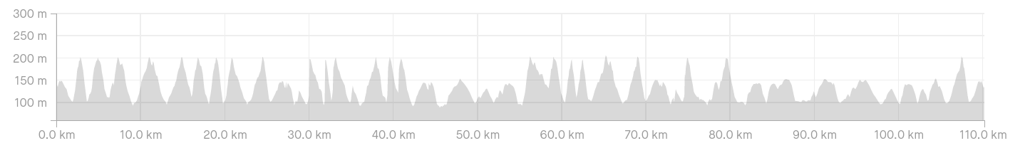

A longer example from last week. Recorded altitudes were approximately the same with Strava and direct Blevo Upload despite jagged trace.
Strava direct :
Blevo Direct :

Hi Paolo,
Strava direct :
Blevo Direct :
Thanks for the report...
I'm testing a new parameter called "Elevation gain sensitivity" where you can select higher or lower sensitivity than now...
Yesterday I tested and BLEvo reported 493m and Strava 492m with "medium" sensitivity. Now is set as default as "Medium-high" so with higher gain calculation...

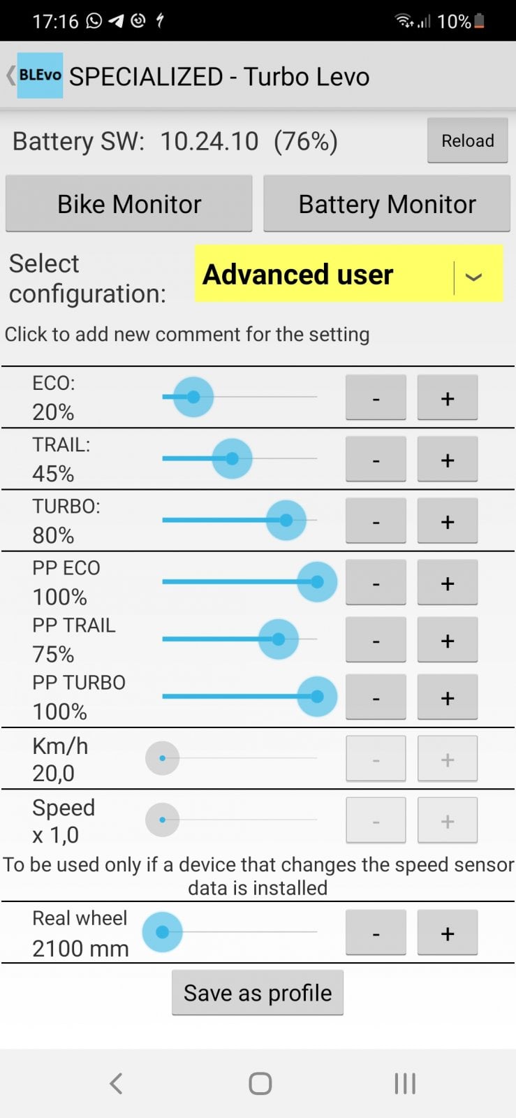

I had Blevo installed on my HT and it worked great for unlocking the speed, I have recently purchased a 2019 carbon comp, I was under the impression that Blevo would not work to unlock the speed on this? However after playing about for a while with the speed re setting each time it has finally saved the settings below, does this mean it has worked? I have checked mission control and the wheel size reads 2000mm (I understand that it won’t read any lower)
PaoloBLEvo
Trader
Jun 13, 2018
1,449
1,184
Varese
View attachment 73101 View attachment 73102
You have to buy something like Levociraptor...

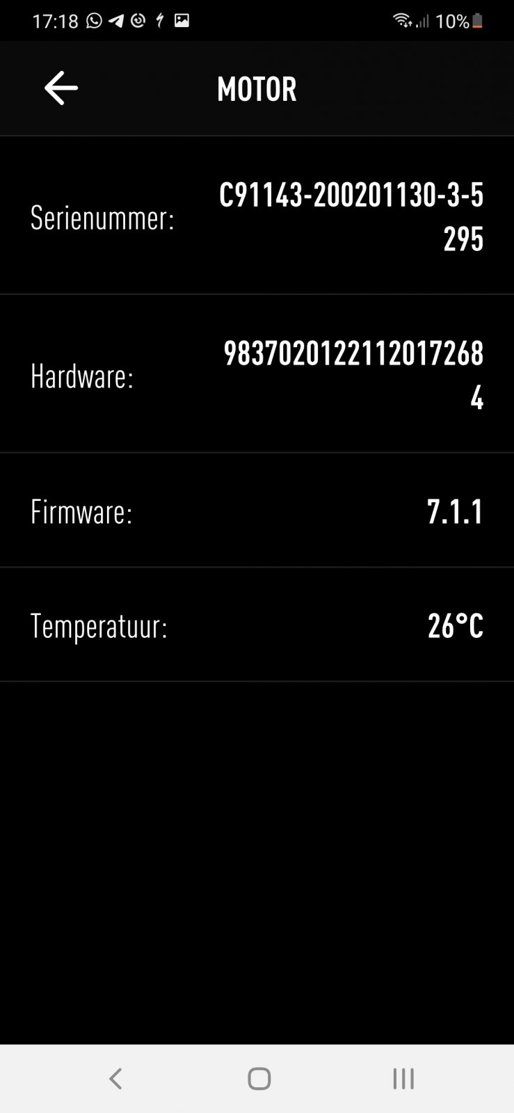

Hi @PaoloBLEvo , I am using Blevo since 2019 on my Levo 2018 and it always worked very well! Today, I picked up my bike from my LBS as I got a new motor installed. And it seems I cannot change the speedlimit. Probably I am missing something. Can you help please? Thx, Kris
Maybe they close the possibility to change the max speed..
In any case please check your configuration.. I think you are not riding with a wheel size of 2100mm... I think it should be 2255mm for 27.5" or 2300mm for 29"..
