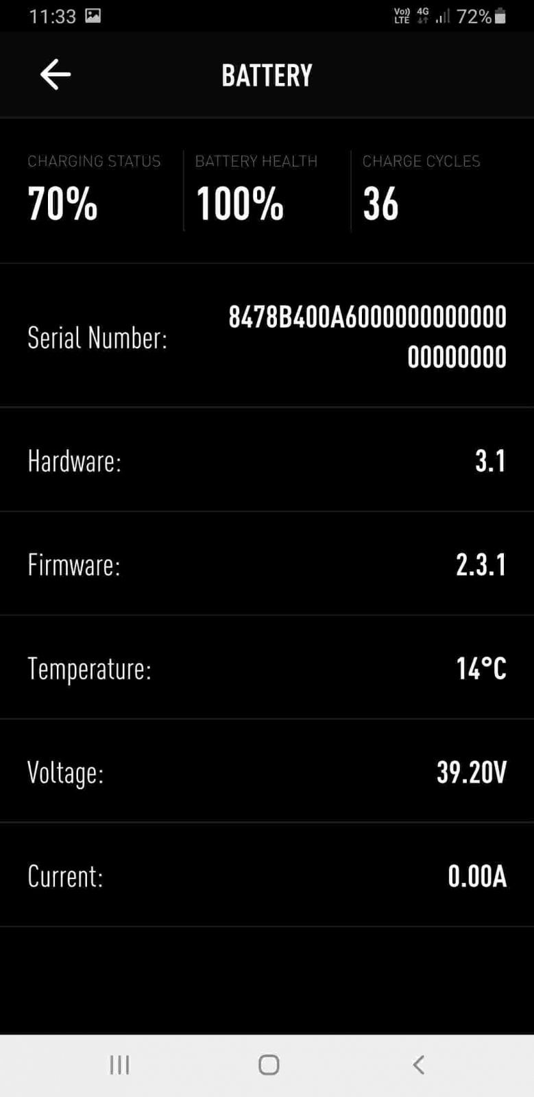

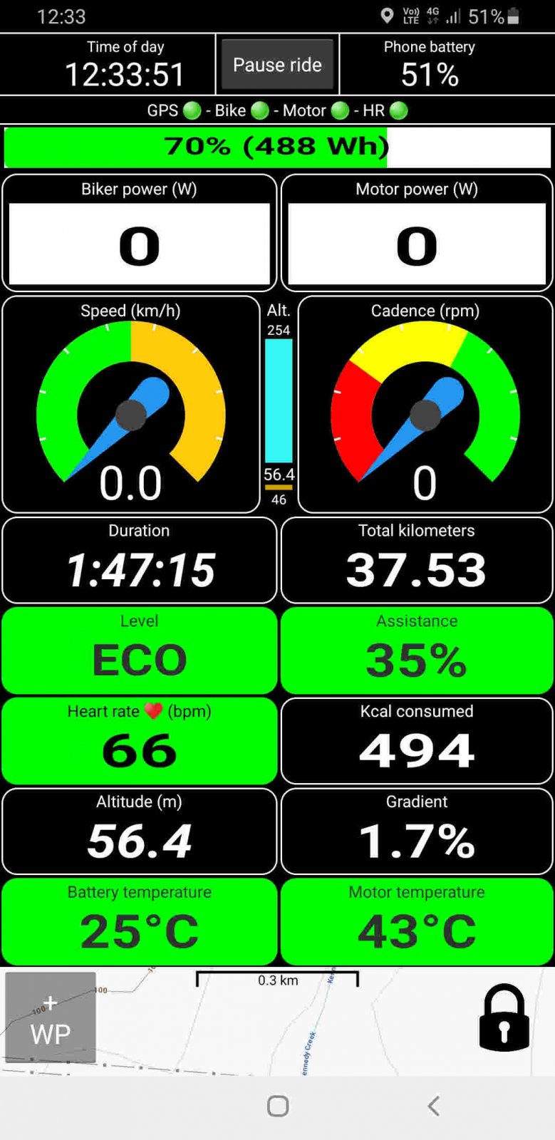

Hi Paolo,
I've noticed for some time that the Bike Monitor page often fails to display battery temperature when I start a ride. The screenshot below shows the battery temperature o.k., but often when I start a ride, Battery Temperature just shows ----- instead of a number, as if BLEVo has trouble reading the actual battery temp.
To overcome this, I have to pause the ride, then click back to the Battery Monitor screen, wait for all battery information to show there, then click back to this Ride screen for the temperature to display correctly. Then it is o.k. for the rest of the ride.
My battery is a 700Wh battery in my 2019 Levo. Battery firmware screenshot (different date and time) is this:
Have you or anyone else experienced this? This is my original battery for over 2 years. The problem has existed for the last few versions of BLEVo (I don't know how many) My phone is Galaxy S9+ with Android 10.
Thanks again for a great product.
ruppia
Dec 14, 2020
249
181
Italy
Hi Paolo,
Yes, it happens to me sometimes as well

PaoloBLEvo
Trader
Jun 13, 2018
1,449
1,184
Varese
Hi Paolo,
The battery temperature is not sent so often... I have the temperature on the display and I saw that it is received after 30 seconds..
So you don't need to pause the ride.. just continue to ride and the data will appear as soon as BLEvo will receive from the bike..

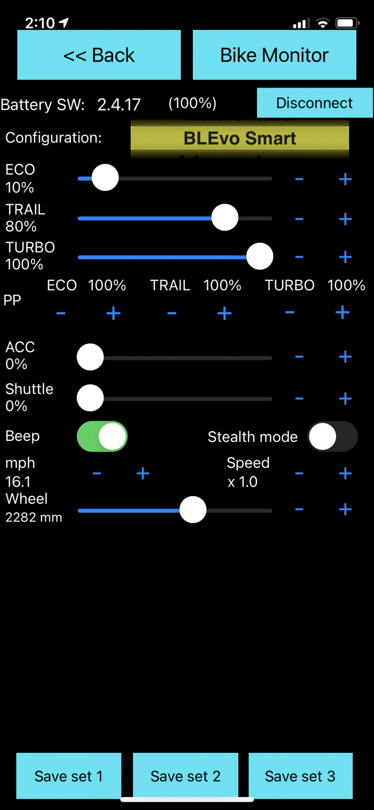

schgoetze
Nov 15, 2021
Hi,
i have a Speciliazed Vado 3.0 from 2017. I want to set up the max. speed. When i use Blevo i can turn up the slider. But after I restart the bike all sliders are set back. I read many posts from guys who have been successfull.
My batterie firmware is 3.3.5 and TCU is 4.022 (16.4). Maybe this is the problem?
Sorry for my bad englisch :)
Jersey Skier
May 12, 2019
140
64
NJ, USA
Hi,

Jersey Skier
May 12, 2019
140
64
NJ, USA
I remember you told me this, but in my opinion is quite impossible... but I trust in you..
Maybe I'm doing something wrong. I change the speed with the +, then as soon as I start pedaling the screen changes to 16.1 regardles of how high i started. I've tried averything in the 20's.
PaoloBLEvo
Trader
Jun 13, 2018
1,449
1,184
Varese
View attachment 76220 View attachment 76221
Ok, now I understood... the speed limit the Bike Setup is showing is ONLY referred to the bike where the limit is 25km/h (16mph).. If the region permits an higher speed limit, this is not understood by BLEvo.. sorry for that...
