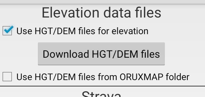

Hi @PaoloBLEvo
today I've tested with a 45km +1200 ride the levociraptor and Blevo.
I am a little bit disapointed, because one of the main point why I bought it was because the elevation was allways higher than the real.
As I mention before in a previous post, I have DEM installed and instant elevation is allways correct but total elevation is 40% higher.
And today, the same! Total elevation shown by the Blevo is 1700 and file exported to strava shown 1200 (the right one). Do you know what can it be?

Ok thanks for the report...
But did you disable the DEM for ascend calculation?

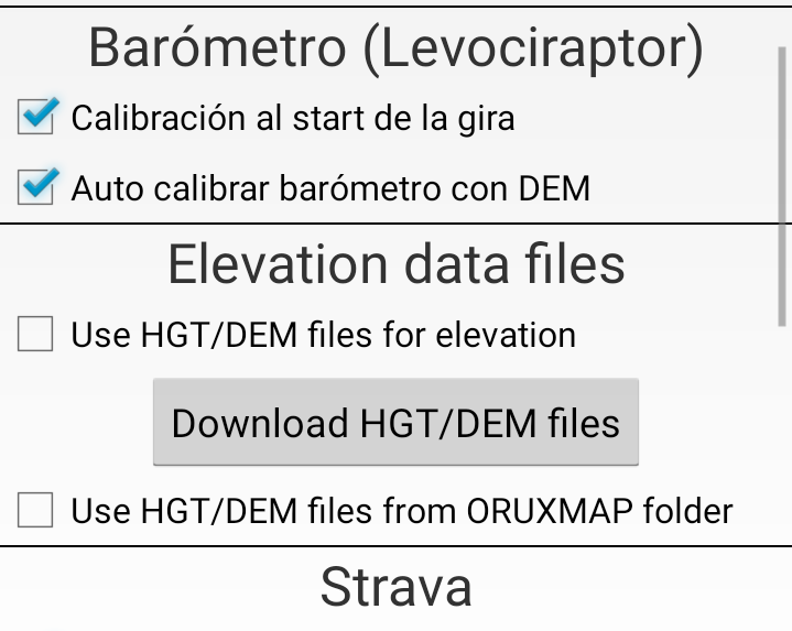

Here you are configuration I have. Is that correct?
