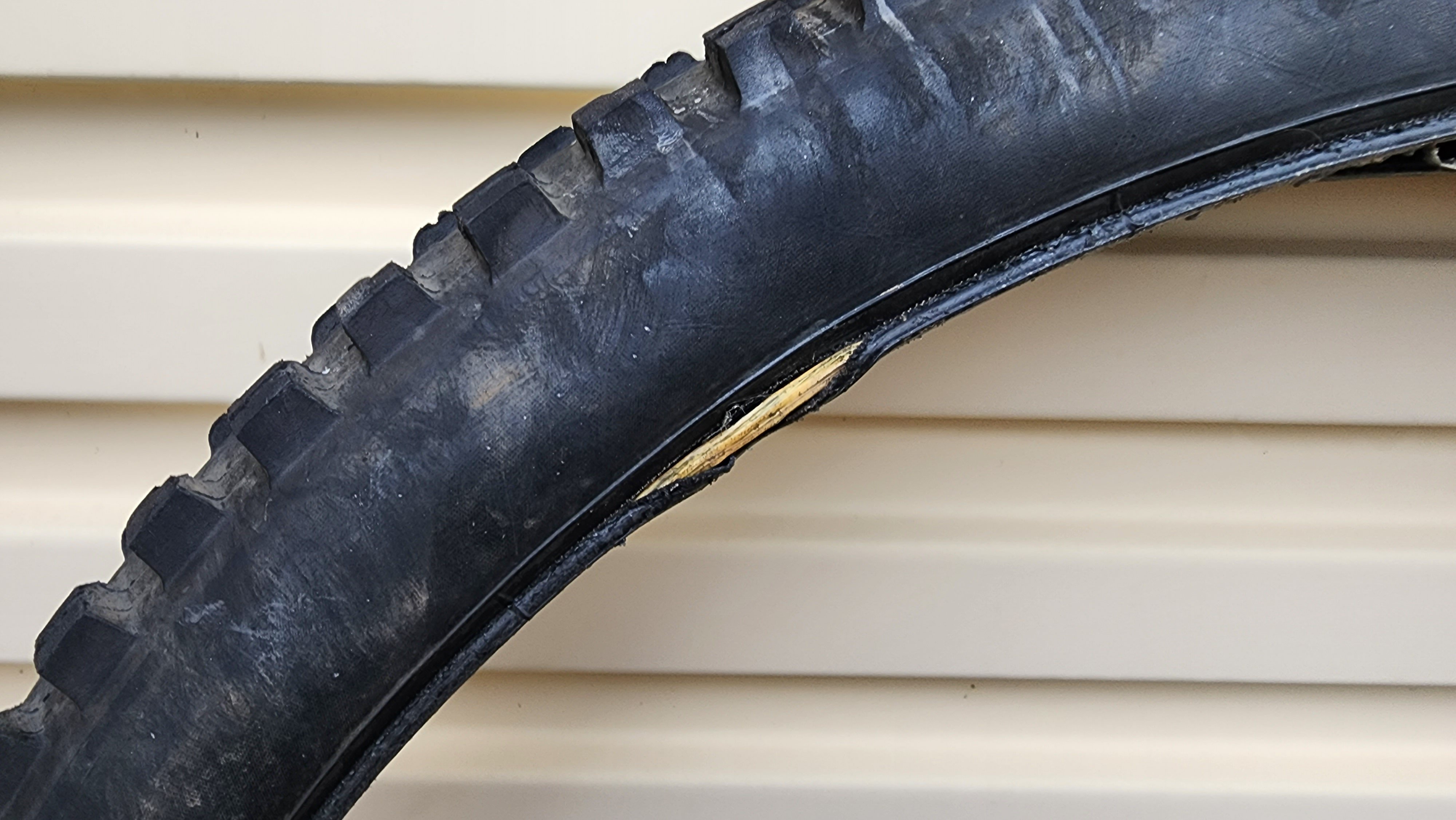

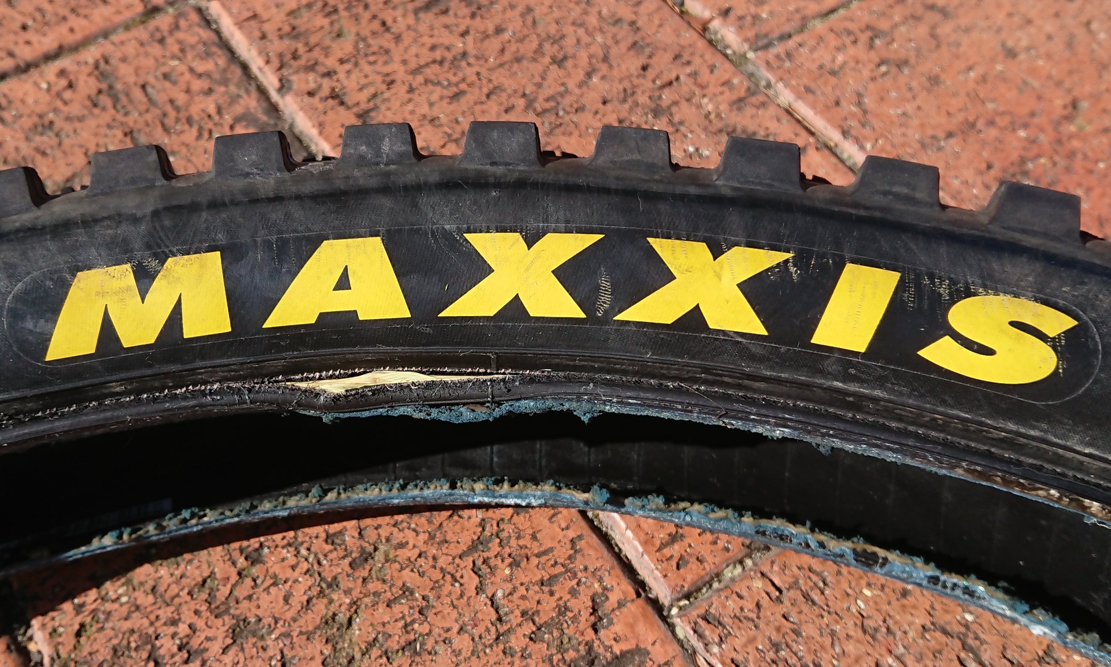

I've just blown my second Maxxis DHR II - separated from the bead - tyre pressure 25psi. Looking at either Vittoria Martello or Schwalbe Eddy Current Ebike rear tyre. 27.5 x 2.8.
What are your thoughts?

After having 2 DHR-II fail at the bead halfway through their life - both have only been half worn when failure occurred, I have switched to a Vittoria Martello on the rear, still running a DHF up the front.
Will see how the Vittoria holds up.

What do you mean by "fail at the bead" ?

@SGS, that is a manufacturing fault. I had two Continental Trail King tyres fail. Each failed on the same side and the same distance away from the logo. Each failed at about 700 miles of use. Both rear tyres. Bought from different sources (different countries even), so unlikely to be the same batch. With zero issues, I got a full refund on the first one, even though I wasn't expecting one. When I sent in the second claim several months later, I included pictures of the current one plus those from the first claim. This time I was convinced it was a manufacturing defect, previously I had thought it was my tyre pressures.
I could get four fingers through the gap on my tyres.
PS: They were both made with the black chilli compound, so they came from the same factory as Continental only have one factory (Germany) that makes black chilli tyres.
