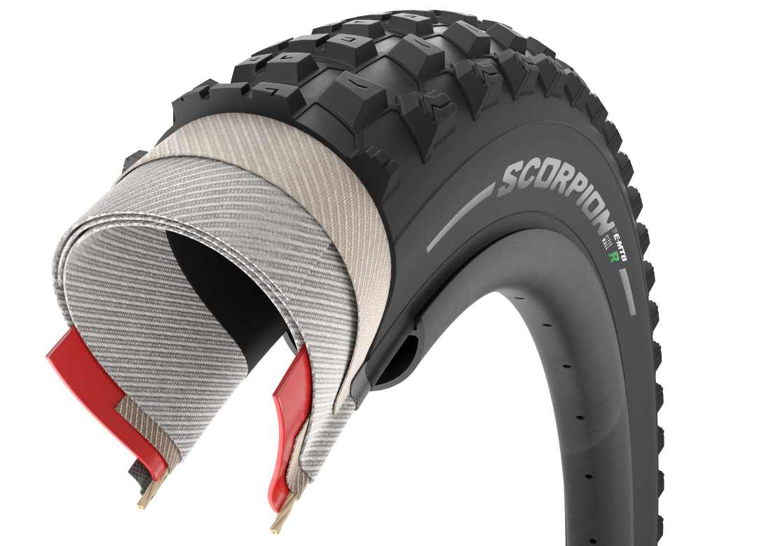

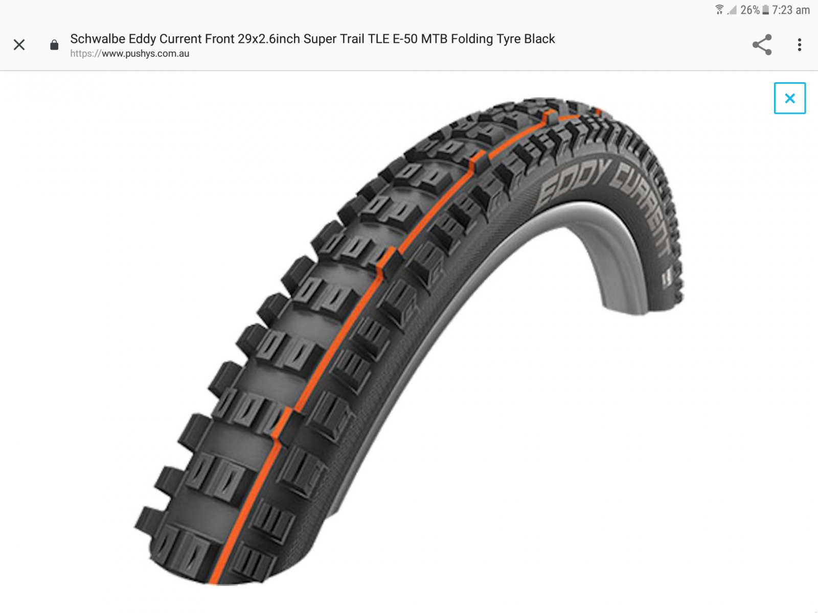

Hey folks
Currently looking at replacing the rear tyre on my focus thron . At the moment i have nobby nic . 2.6 front and back. The front seems ok but the back is copping a hammering , with side wall cuts and wear , snalke bites. Punctures .
Im a big guy 6ft4 and 100 kg so i need a replacement tyre with heavy sidewall protection and strength
I Ride fire roads , single track , some sandy trails. Some rocky stuff. Oh and looking at a 400km bike packing trip next month.
Ive narrowed it down to the schwalbe eddy current or the pirelli scorpion emtb rear both in the 29 x 2.6 . Im leaning towards the scorpion because of the lower rolling resistance and expected longer mileage . Both tyers are similar price . And both tyres are available online in australia .
I saw that rob did a review of the pirelli came up fairly favourable . Some other mixed reviews out there .
Feedback apreciated from folks who have used both tyers . Including wear , grip , and how the sidewalls hold up . Also have i missed an obvious option .
