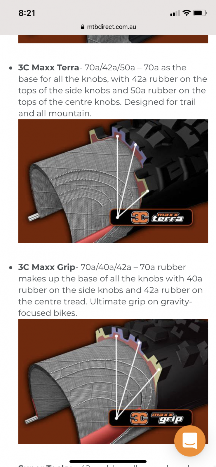

The difference the compound of sides knobs between maxxterra and max grip is only 2a durometer.
The difference between the center knobs is 8a.
Is the 8a you’re giving up in rolling resistance worth the trade off for an extra 2a in cornering grip? Unless it’s a DH or enduro bike, I’ll stick with maxxterra.

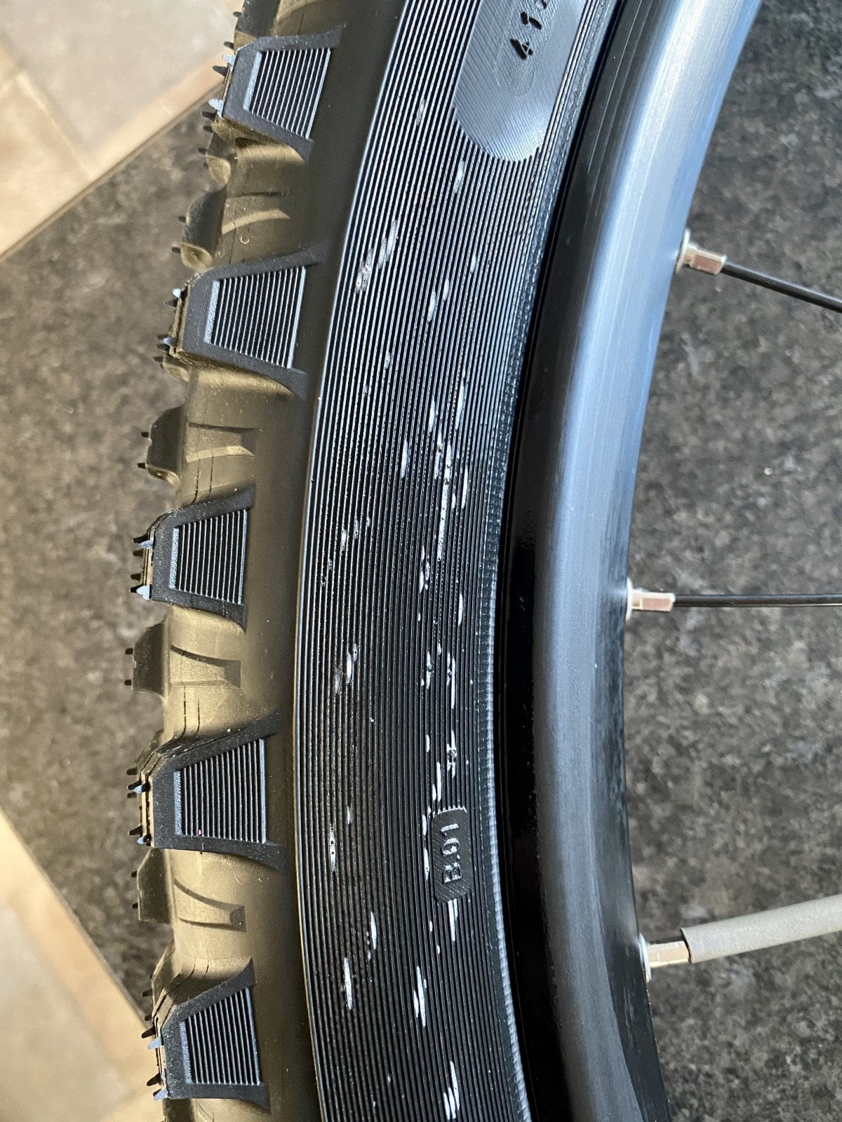

Did you get the sealant leaking through the sidewalls for ages after ? It's been around three hours after fitting the tyre and I'm still losing pressure and having sealant leak.
No they sealed instantly , where’s your sealant leaking from ?

Through the sidewalls, both sides of the tyre, the whoe circumference. The tyre looks like a sieve when I put soapy water on it! Added around 100ml of sealant but that's all I had so ordered some more and will top up when it arrives. The tyre was flat as a pancake this morning. I have the tyre off the bike and now lying flat on its side and I'll keep rotating all day and swapping sides over! I'm sure this tyre will be worth all this hassle ?
If that’s a new Michelin e wild then it’s faulty , there are some tyres that need the side walls to seal on lighter xc / race tyres from conti especially but not on the heavier ebike ‘ enduro tyres we use I usually use at least 120ml of sealant on a 2.6 tyre

I phoned Merlin and they just said it needs more sealant. I'll give it another day of rotating and more sealant but if it keeps losing pressure then its going back
Can you post a photo of the leaking sealant
This is what it looked like yesterday around 3pm, still leaking, and this is a vast improvement to 24hrs prior
However, happy to report that after constant swirling , rotating, shaking and laying the tyre flat yesterday , the tyre is fully sealed this morning with no sign of sealant weeping and still 30psi, so job done ??
Wow I’ve seen a few tyres do that , but as I said usually lighter xc race stuff . I wonder if anyone else has had this with e wild .

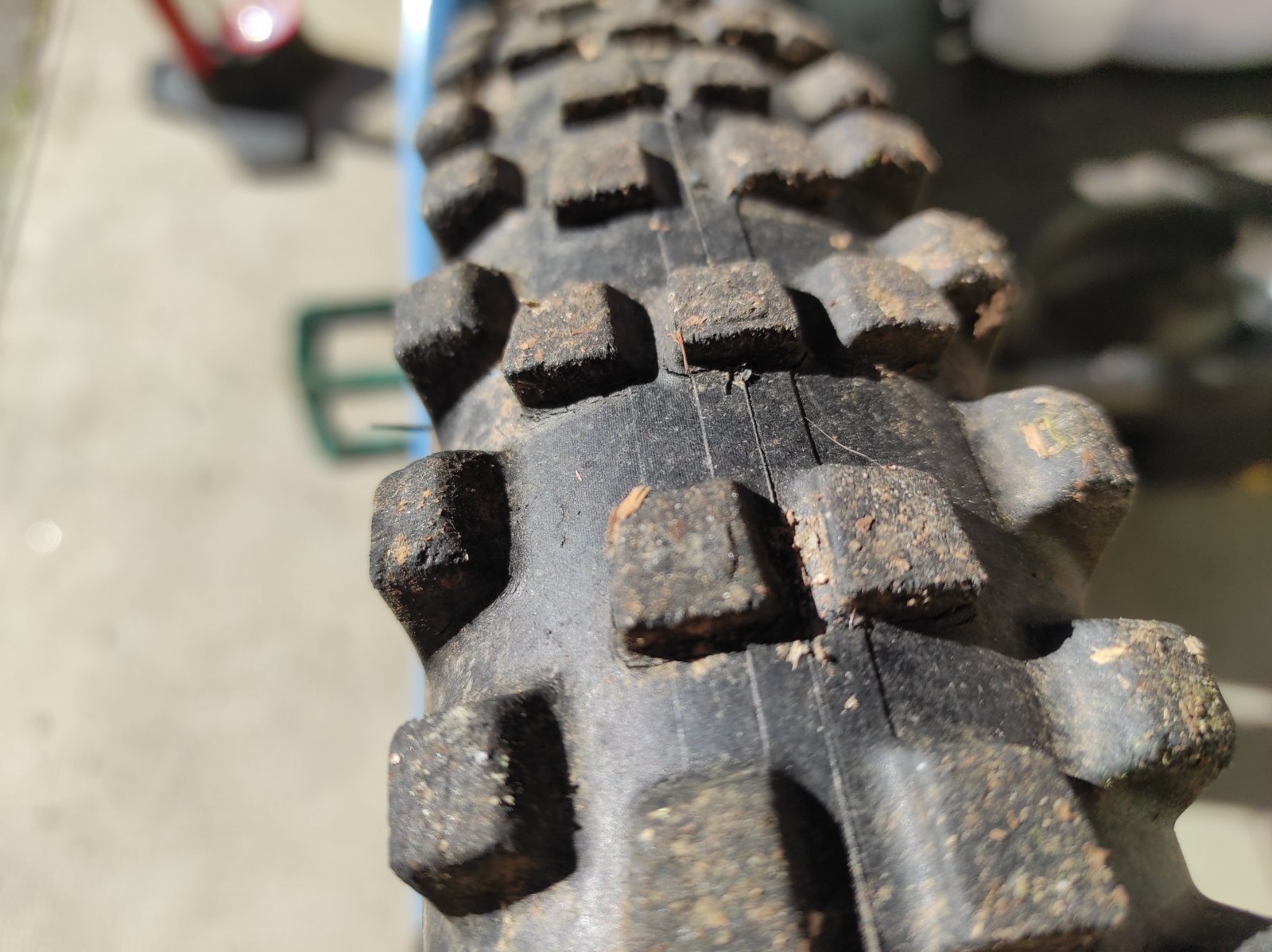

DH22 6 Month overview ..
Confidence wise - amazing. Predictable ! They grip - everywhere (within logical expectations).
Wear - good. A lot better than I was expecting, might wear faster through summer though.
Resistance - No punctures, no problems. Have tested them on and off with and without sealant. They sit fine without, but on my setup I lose about 1psi a day without sealant. Seem tough as hell ! They're not foldable .
Weight - Heavy. 1440g each for a 27.5 *2.4 . So noticeably slower accelerating.
Rolling resistance. HIGH ! Quieter than DHR/DHF but side by side descending on tarmac with same weight setups you need to pedal the DH22's to stay with a same speed rolling DHR/DHF combination. If range is your thing, these are not for you. At least 10%-15% less range than wider profile E-wilds.
EDIT : OK, so having actually done more than glance at them when they're wet and inspected them properly .. and sent pictures to the wise and mighty one ... it would appear that they're actually worn :-( and my theory that unless they're down to 1mm of tread they're still ok is incorrect. So ignore my wild claims that they wear well - they're not magic .. the rest is correct though !
TBF if any soft compound DH race tyre lasts you 6 months you're either not using it for it's intended purpose or just not riding very much.
eg. I'd expect a rear to be worn to the point of reduced performance after just one weekends DH riding at Ft William.
(still useable but close to the condition you'd prefer swapping to a new one to do a race run on)
14,194
21,126
I don't ride with them for gods sake ! They're way to pretty for that ! :) I do dust them regularly though.
I'm surprised with the wear. They're actually holding up better than the e-wilds. The knobs aren't splitting or cracking. They still have edges, very odd ! I need to up my game ! I actually expected them to be completely wrecked in 2 months at the most, though in fairness the trails I'm on at the moment are far easier going than my normal ones.
