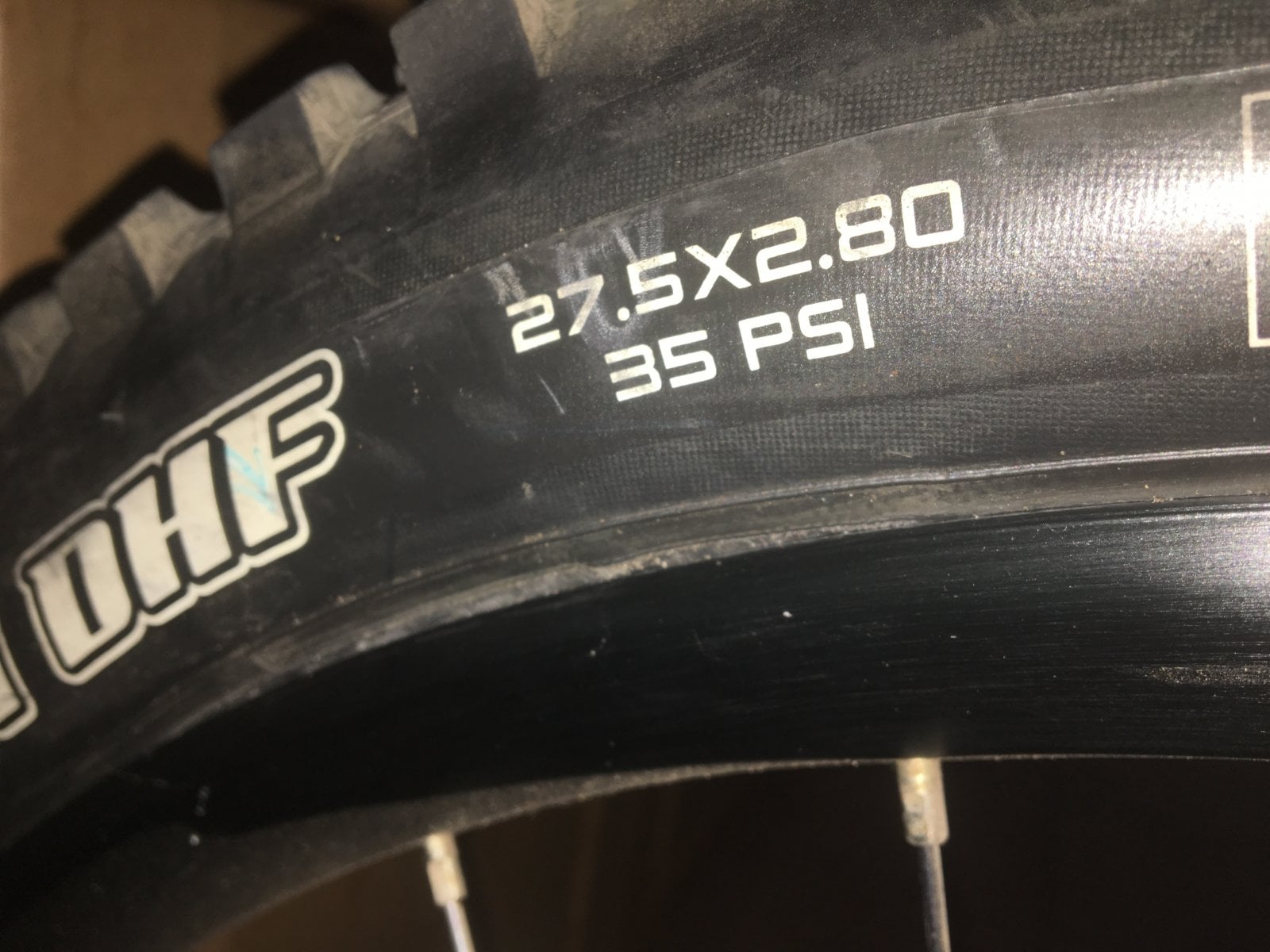

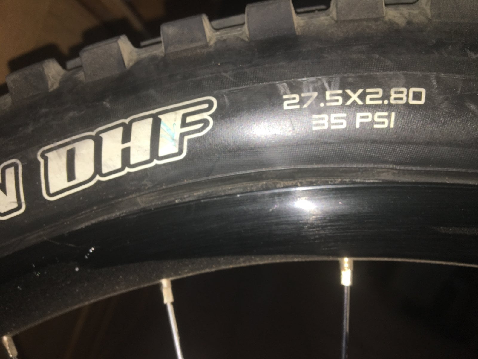

Bloody sidewalls, i’ve torn 6 where the bead meets the rim. 2 x Butcher Grids, 3x Minion DHR EXO, one 3c, and two dual compound. And 1x Minion DHF EXO dual compound.
The last one was running a tube that never dropped below 30psi and the tube has never flated. I have tried all pressures from 22-35psi. These were all 27.5x2.8, and the rim is definitely not damaged ( checked with dial gauge) and I have even sanded the rim at the bead to remove rough spots. Hopefully getting some of the new Spesh Eliminators for Christmas in 2.6. Black Dimond rear and grid front.
If anyone suggests inserts, i’ll throw hands !

Probs not aye, as the rims are a confirmed 38mm inner width. It’s a 2018 Levo and original figment was 2.8 Butchers. The 2017 had 3.0 on the same rims.
As for pinching, I have solely used a tube in the latest Minion DHF EXO and never flatted it. So I thought the tube would suffer from a pinch flat before the Tyre gave out.
Scratching my head, and don’t want to run inserts as they are a pain if wanting to repair out on the trail.
The split does not discriminate where on the rim, or even a preferred side. But it’s always the rear that lets go.

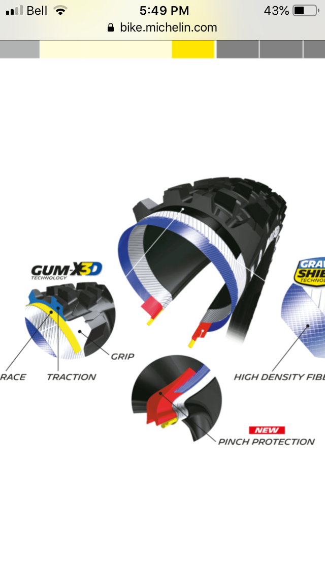

Bit out of my wheelhouse. I’ve never run plus size tires. The Michelin’s and the maxxis that Gary mentioned(not sure if he meant dh or dd casing or maybe both)have additional protection in that area of the tire sidewall. Maybe those new blck dmnd’s do as well. Possibly worth considering apart from the additional 250grams. I found my happy spot and had zero flats last year,with 1100gram tires, and only one rim ding , but that was a race face arc rim w butter in the aluminium. Maybe it was luck but I heard a lot less rim contact on my Michelin than the dd or onza fr/end(same weight and manufacturer as maxxis dd’s). Was funny after chatting w Gary on tires I watched the latest “loam ranger” yt edit. Don’t know if you follow his youtube channel but he’s working with “pole” and was in Madeira with the team testing. He mentioned that they’re testing/comparing maxxis and Michelin . Team recommended he try the Michelin’s . Take it with a grain of salt because I think they’ve already inked the sponsorship deal but I found it interesting that they preferred the Michelin’s . I think they’re still testing and finalizing the dh tire yet to be released and using maxxis is their benchmark

You’re right Gary, but it still baffles me. I bloody put a dial gauge on the rim, on the inner and outer edge and nothing stood out. I have used emery paper to smooth any rough edges. And it still happens at different spots on the rim, and even different sides. Time before last it happened right at the valve stem non drive side.
I line the stem up in between the XX in Maxxis, maybe because I’m a bit ocd.
This time it happened drive side where it says DHF, and I had a bloody tube in it and 27psi. Did not even flat.

Hard to see, but it bulges out it that point. Not real bad this time, as it’s running a tube. Other times with sealant, it suddenly let’s go and goes flat.
It's nothing to do with roughness of the rim edge. It's to do with the rim edge profile, stiffness of the rim material and the width of the rim relative to the tyre width you're using (ie. the profile it's creating as the sidewall leaves the rim hook.
Sounds like a very unlucky combination your choce of tyre just isn't tough enough to handle.
It happens.
I've only ever had a similar problen with one rim ever. it was an indestructible super stiff old skool Sun-ringle DH rim. There was nothing I could do to make it waor for rough DH tracks so ultimately I had to get rid of it.
Your cheapest option is to buy a new rim online with similar ERD. tape it to the old one and transfer all your spokes to the new rim. If you're not confident to build a new wheel take it to your best local wheelbuilder to finish it for you.
Don't ask me which rim to buy as I'd absoloutely NEVER run a 2.8 tyre. Sorry.

Informative and helpful once again Gary.
After looking around and the web, I have found other cases of Spesh 38mm inner rims and 2.8 tires doing the same thing.
I’m going to give a 2.6 Spesh Eliminator a go with a tougher black Dimond casing.
As for tapping a new rim with similar ERD, to the old and transferring spokes. Genius method.
One last try with a 2.6, before I go down the new rim method.
Cheers

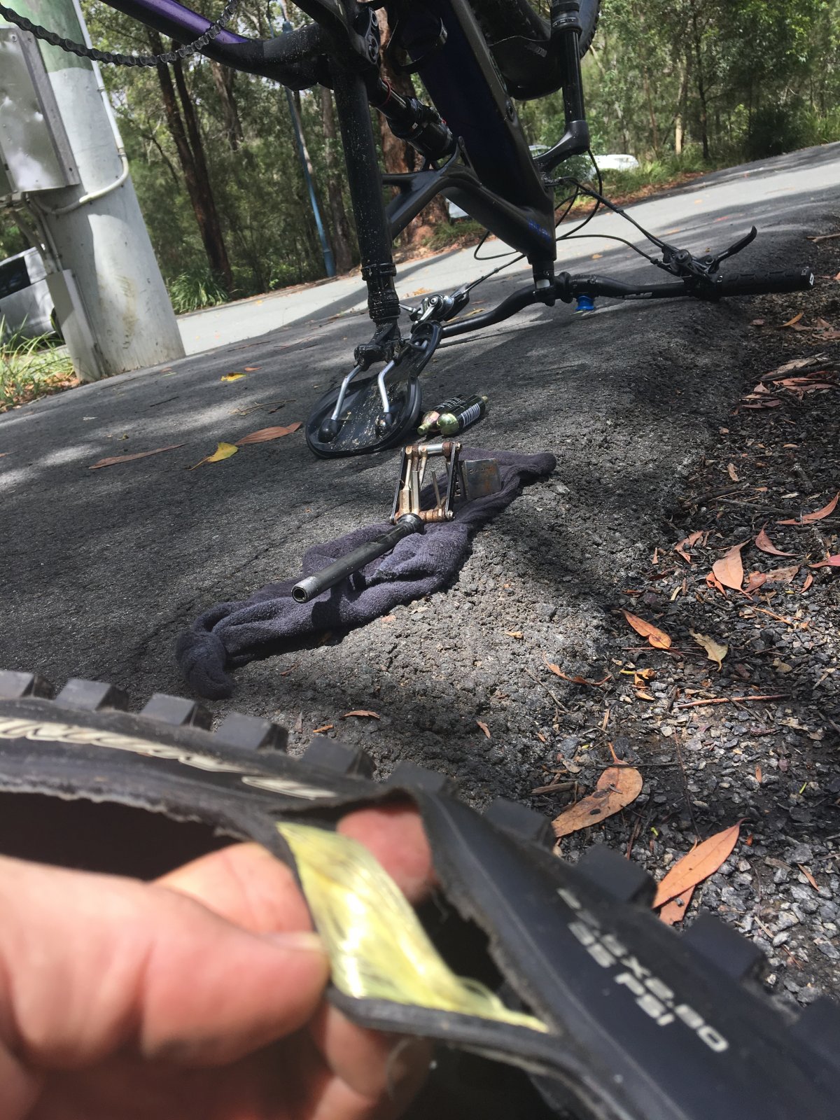

It went out with a bang today
That pic makes me sad! :cry:
As a temporary band aid fix you could try removing your tubeless tape and fitting a split 20" innertube so it fills the rim bed and covers the outer edge of your rim. Often referred to as ghetto tubeless this would give a little more sidewall protection to your tyre. but by the looks of the above pic may still not solve your issues,
Got any pics of the rim channel/edge? Might not be obvious from a pic but there has to be something seriously wrong with the construction/shape to have ripped 7 tyre beads in succession.

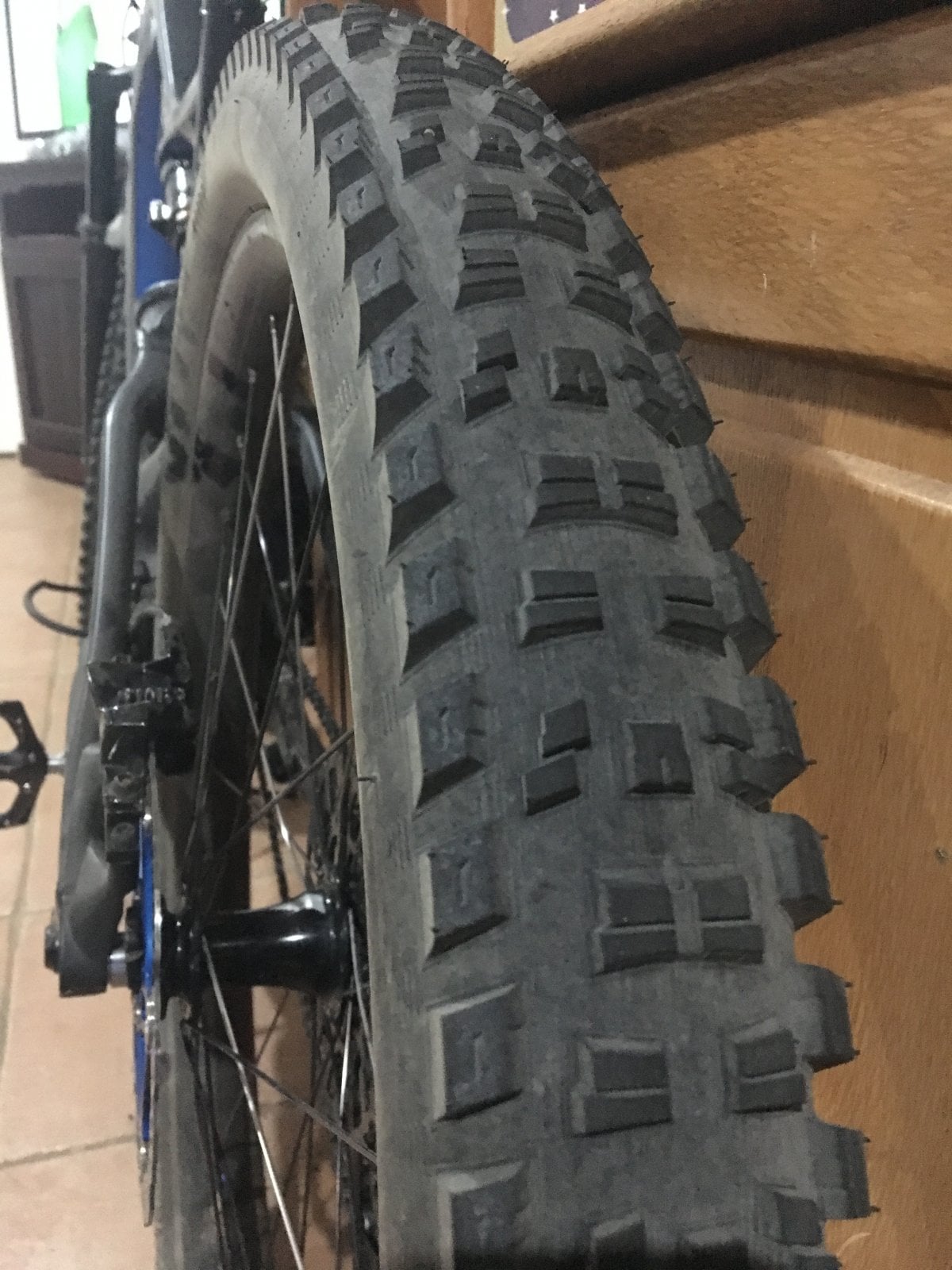

Santa came through with a pair of Spesh Eliminators. Grid case for the front and Black Dimond case for the rear.
The black Dimond casing is way stiffer than the Grid, like comparing the flexibility of a sheet of paper to a box sheet of cardboard.
Had my first decent run on them today and I must say, I like very much, especially on the rear.

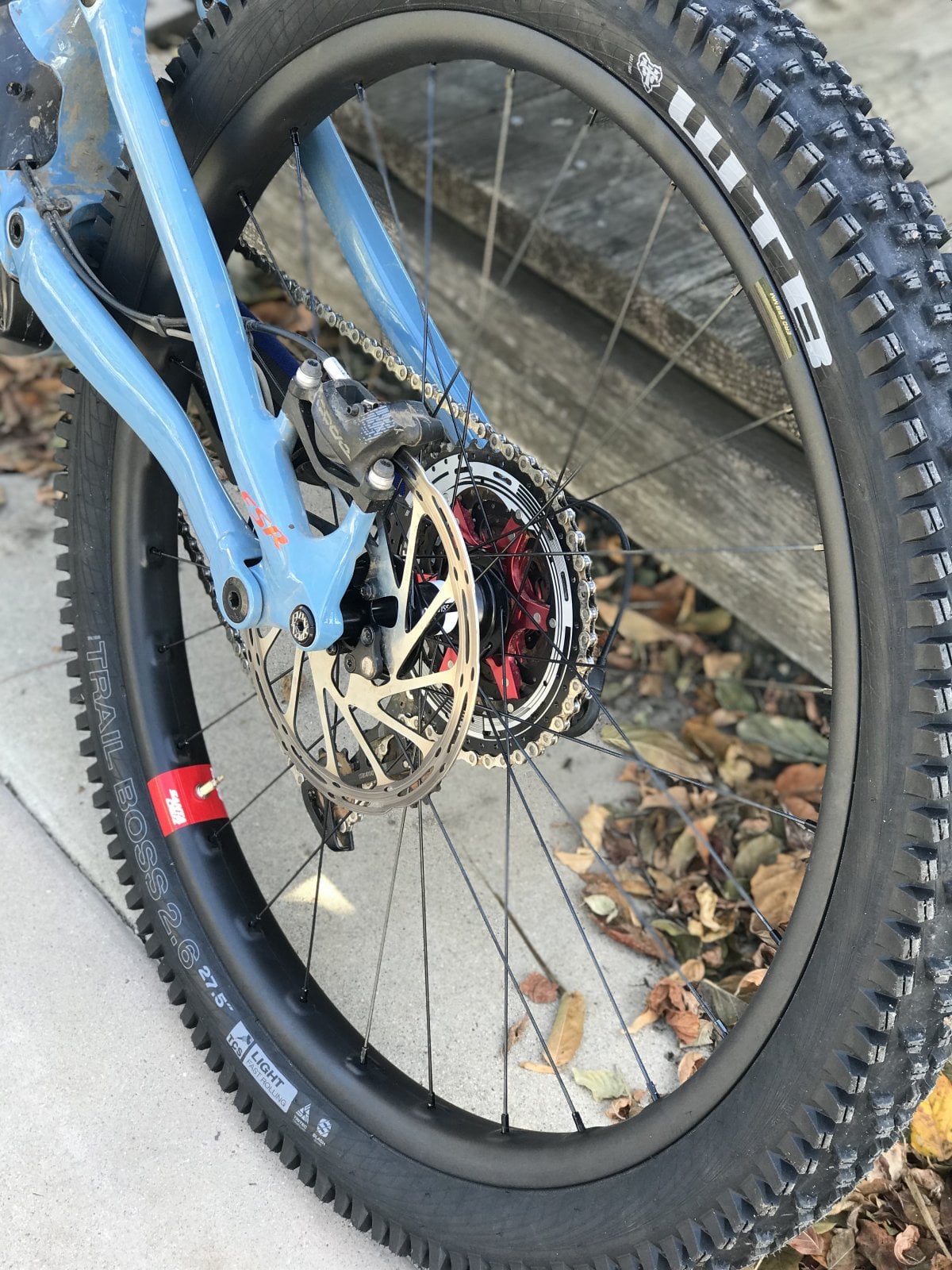

@outerlimits Any chance you can get some measurements of the tread and the casing width? Assuming that you are still on 38mm rims as well? I have been eyeing those tires, but have heard they are fairly small for 2.6

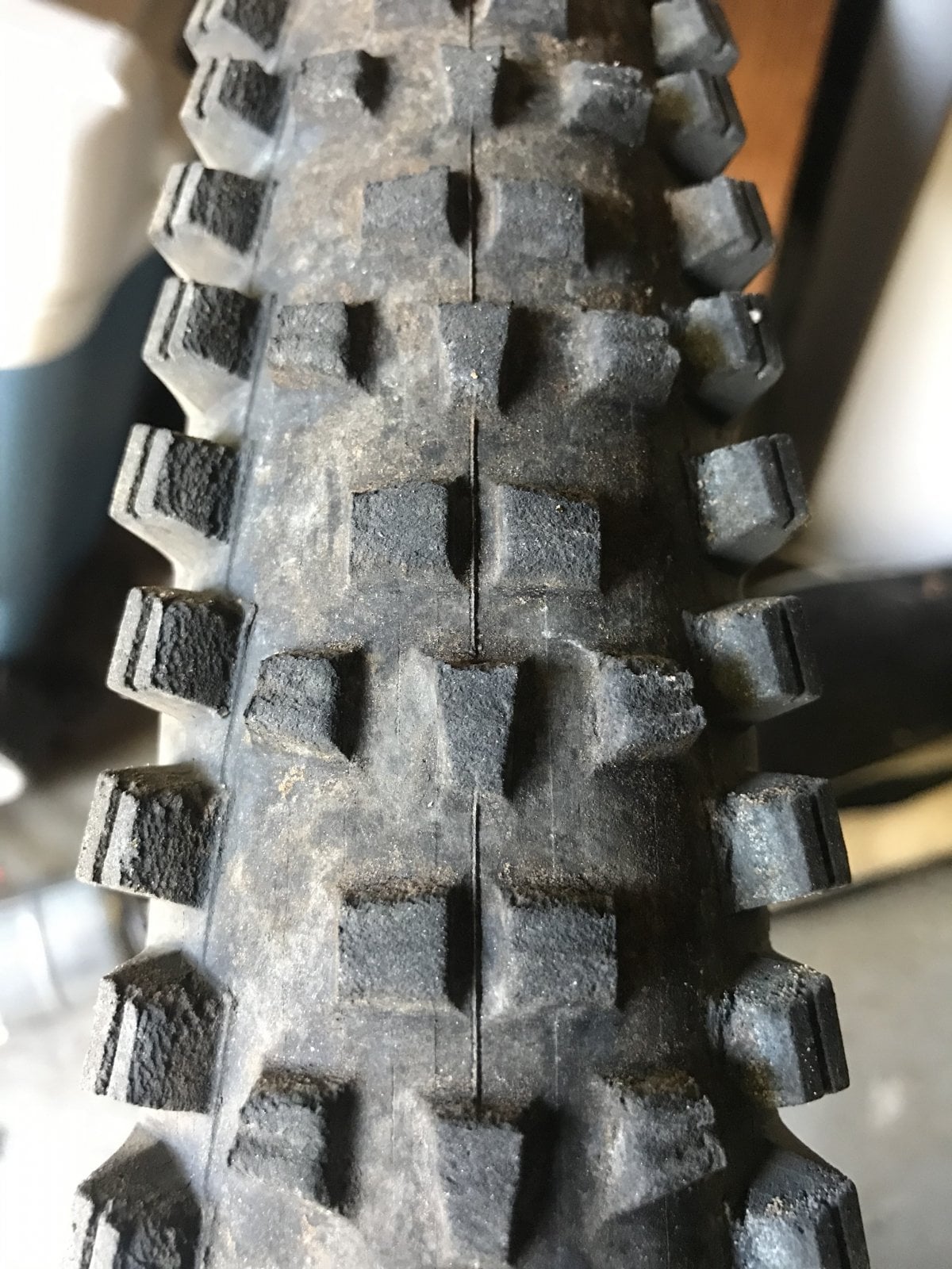

Side note - I have been running a WTB 2.6 Trail boss on the rear of my Kenevo w/ SC Reserve 37. True 2.6 (even slightly wider at tread) on 37mm rims. Other than a pinch flat early on running too low pressure, i have been loving the tire. Rolls great, grips well and is super predictable compared to the stock butcher. Tread wear seems higher than the Butcher it replaced, but I am ok with that given the performance. WTB also sent me a free tough casing to try when I told them about the early pinch flat. Can't complain about that!
New
After ~ 150 miles
