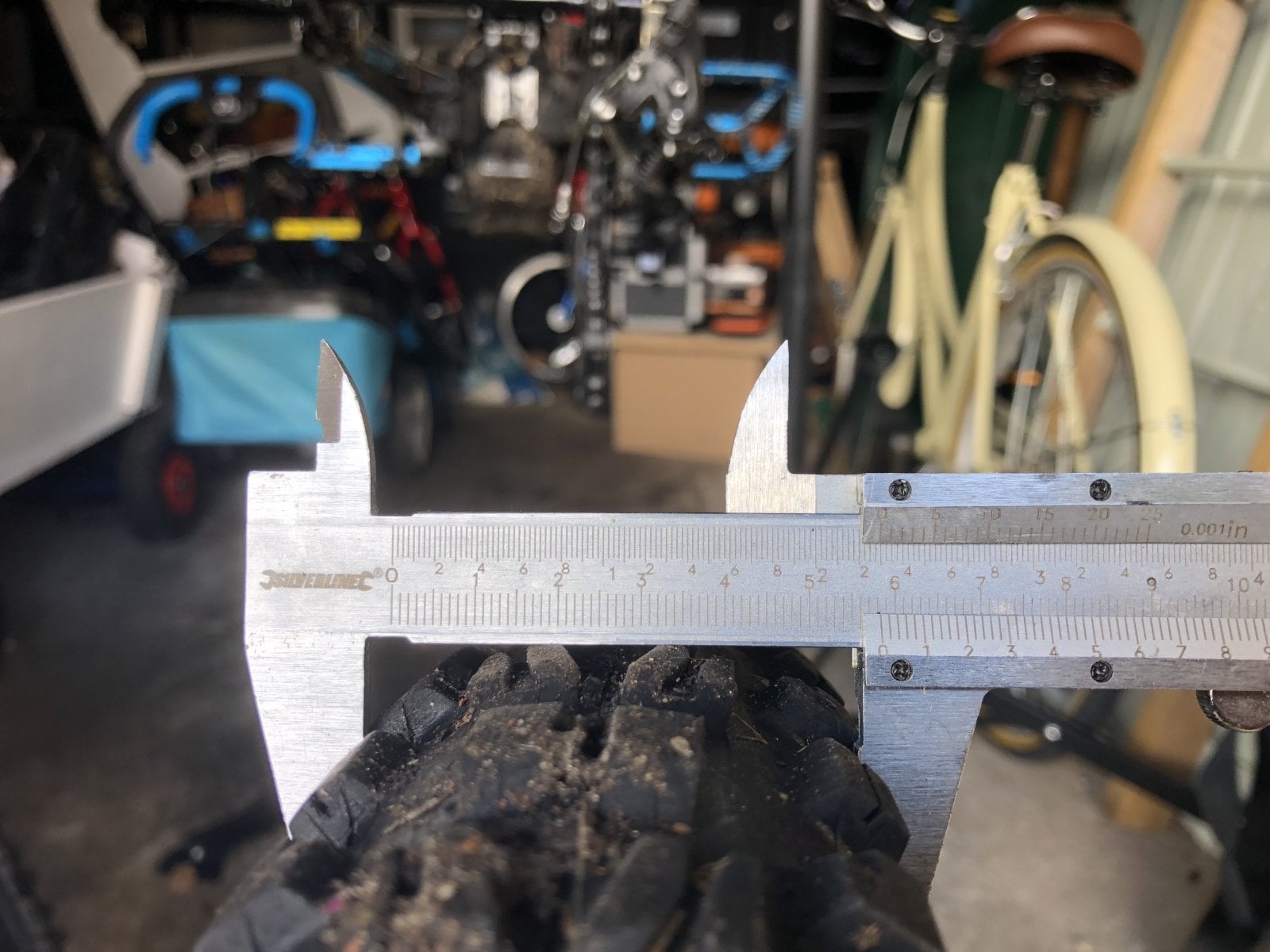

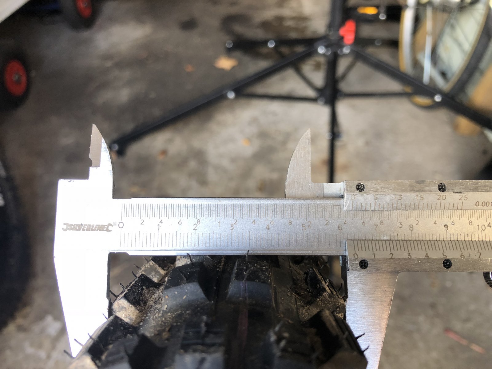

For anyone thats interested, real world widths of Magic Mary 27.5 2.6 DH and a Maxis Minion DHF 2.5 3C/TR mounted on 30mm wide DT-Swiss M1900. Both tyres at 20 PSI:
