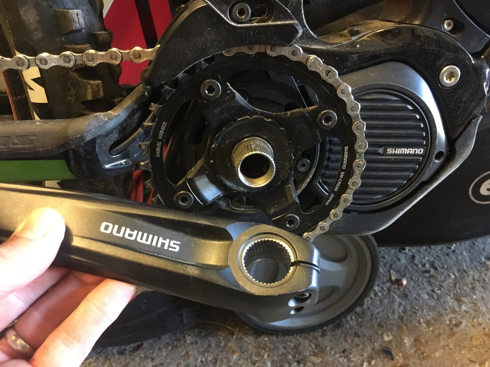

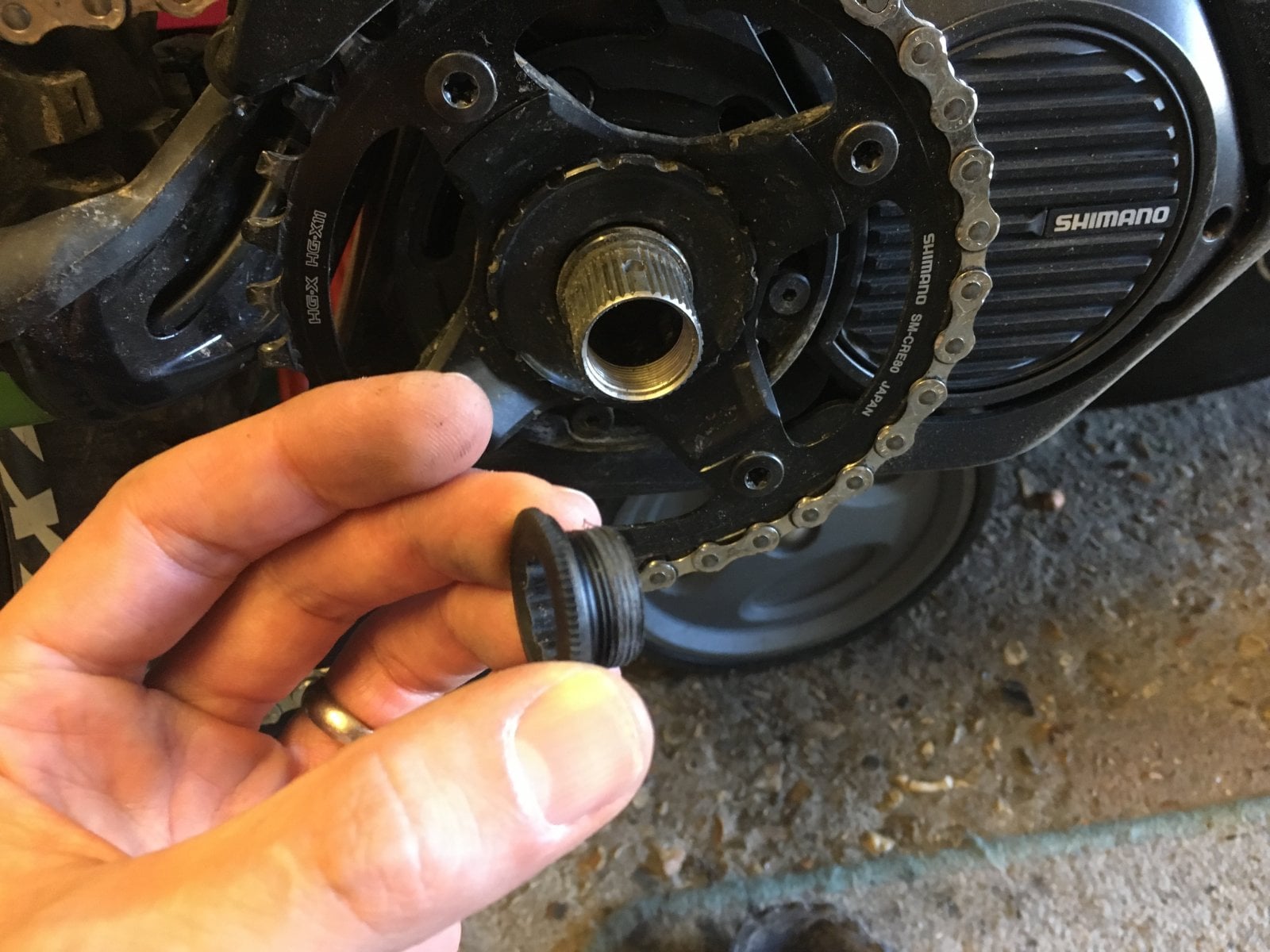

Good ride this morning until this happened..crank arm dropped off!!Allen key bolts are still tight but it’s somehow forced itself off the spline and stripped the threads of the plastic end cap.. can anyone advise??
Lots of people have this problem. Some people seem to think it isn't a terrible design flaw but you are supposed to check to bolt before every ride. me - I'm not so convinced. I also bought the unofficial alu caps to prevent it happening again and so far it works.

The plastic screw on end caps are only for pushing the crank arm into position and making sure it is fully seated. They are not meant to hold the crank arm on really although they are a back up of sorts.
The allen bolts on the crank arm need to be tightened to the recommended torque. Don't just tighten each bolt individually. Alternate the tightening as you'll see each one needs re-tightening as you torque the other, as they work together.
I also use the recommended torque but tighten them a bit more.
My crank arm fell off from new at one point but never again. I also had the same problem on my road bike but lesson learnt :cool:
the black tab on the end of the crank arm fits into a hole on the spindle, once seated and torqued it should never slide off unless the tab snaps and that doesnt happen very often

I agree with others that little plastic bolt isn't to hold the crank arm on, once the crank arm bolts are torqued down properly and the safety tab in place (in case you don't torque the bolts properly and even) you could take the plastic end cap off.. same as you can with your preload bolt on your headset once the stem is torqued in place.
So ultimately the plastic bolt coming off isn't the cause but a result of another fault IMO.
