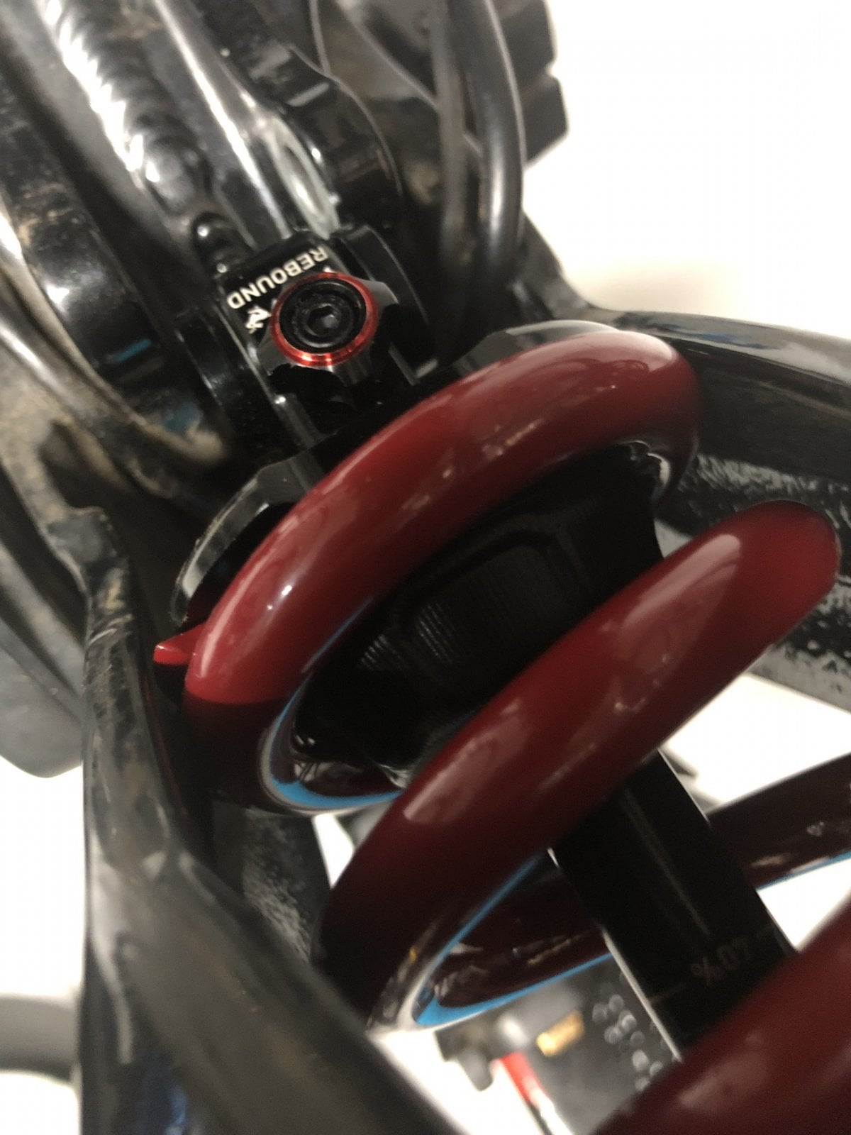

So I can confirm the RS Super Deluxe coil won't fit on an E-Sommett, at least with anything that isn't a lower weight spring that is likely not enough for an emtb, as the RS Springs are a larger diameter than an Ohlins or Fox and foul on the frame. I am going to see if I can source an alternative spring from TI-Springs which may work, but not hopeful.

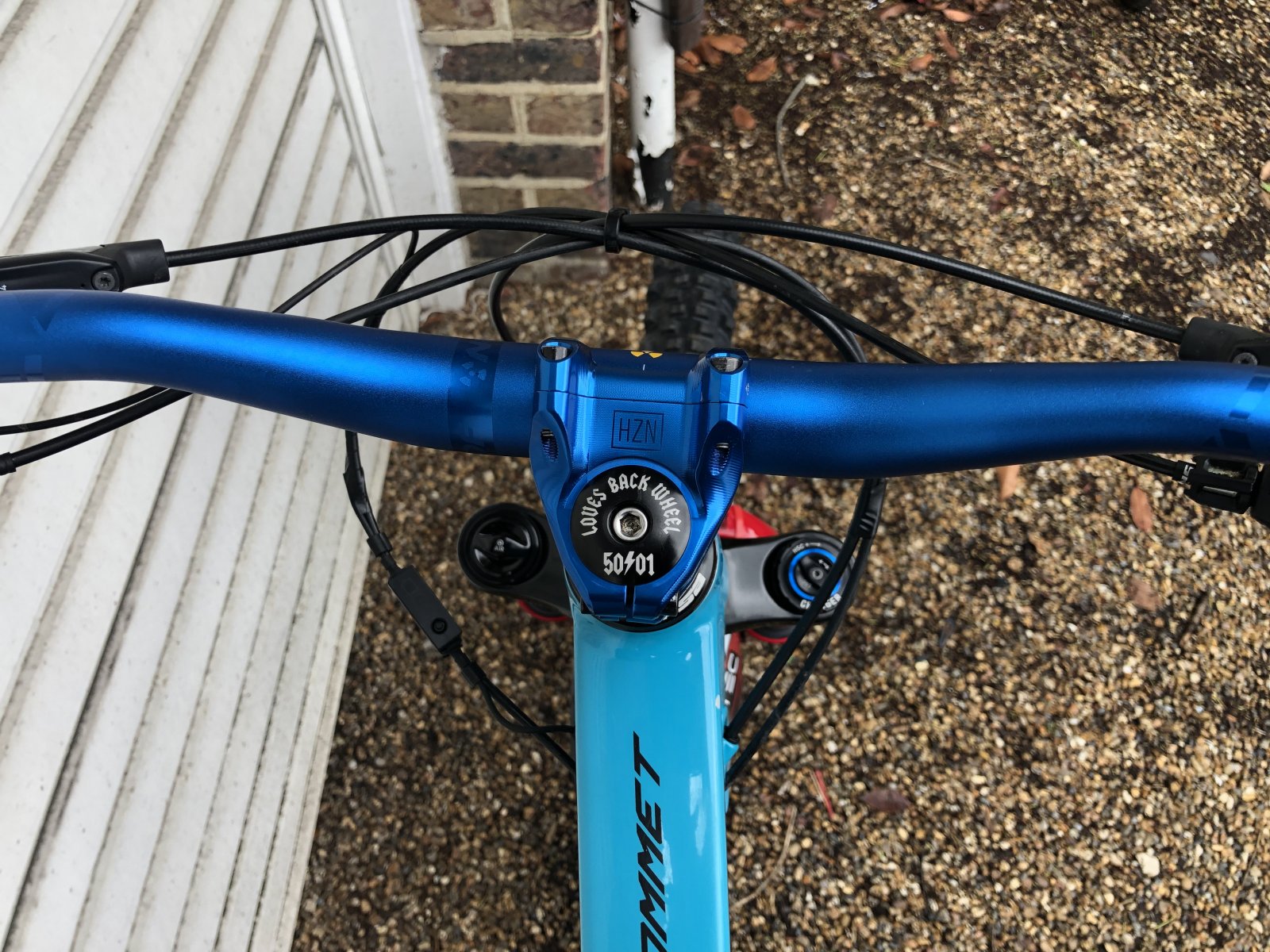

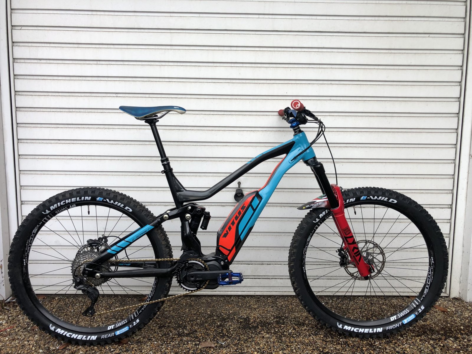

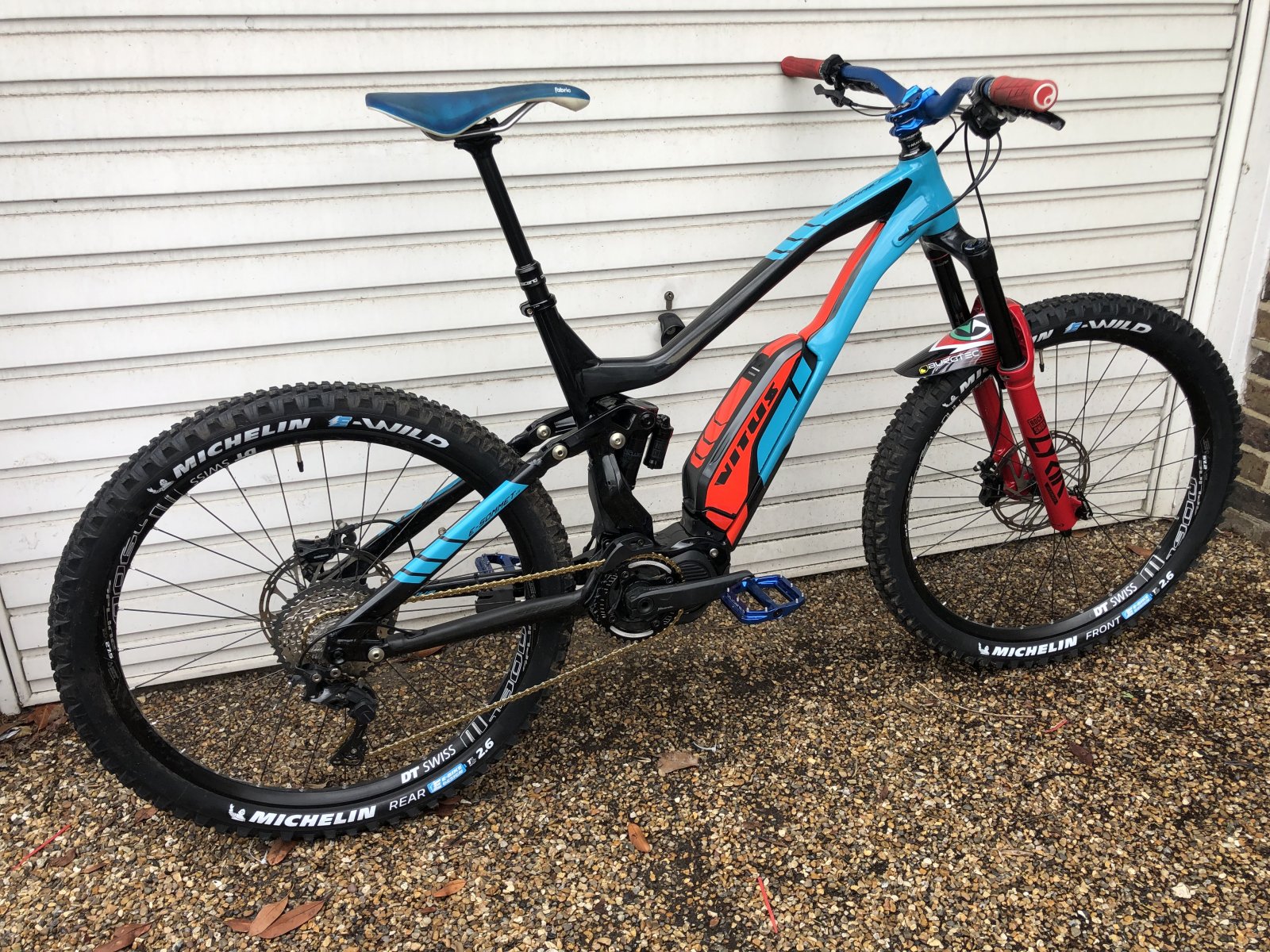

In other news I have made some tweaks to the bike.
  • Reduced fork travel back to 170mm from 180mm
  • Hope 36t Chainring
  • DT Swiss thru axle on the back
  • Swapped my pedals from One-Up to Burgtec, which I am now running on all my bike as I like how close they sit to the cranks.
  • Removed the e8000 display and have gone display less by using the EW-EN100 module.
  • Some new decals for the forks from Slik
  • Michelin E-Wild 2.6 tyres
I am really liking the EW-EN100, de clutters the bike, and I now realise that the screen is quite a distraction - by using the E-Tube ride app on my phone you can get range etc etc info if I need to check anything.
I dropped the travel on the forks back to 170mm as although I liked running the 180mm, I dont need the extra 10mm and it puts the front of the bike slightly too high IMO for weighting the front end well and being able to flick the bike about. It also made it want to wheelie like a bastard on steep climbs.
Only had one ride on the tyres but they where great on the forum ride in a mix of hardpack trails with mud where the sun hasn't cleared the water in the woods, but will reserve full judgement until a few months time - the side knobs are fecking beasts though!
I still love this bike, and can't see any reason to move on, or any other bike I would rather have.
how much by?
and where does it rub?
I've carefully dremelled away frame uprights in the past to clear non OE shocks/springs. but they were always DH frames and had plenty material there.
Possible? non? :unsure:
Don't have my Sommet with me so can't take a quick look to guess where it's fouling.

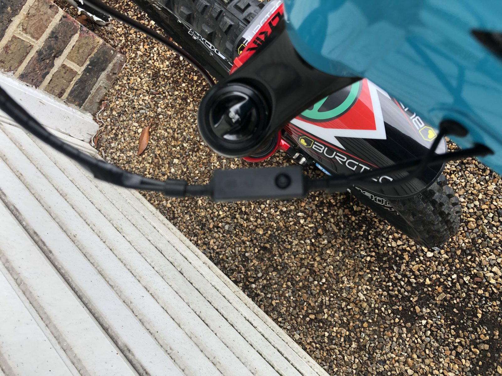

That's really neat. I like it a lot... does it show no indication at all though? a simple LED that changed colour between blue/green/yellow would have been cool. not sure I'd prefer it even if it did as I do refer to the coloured (mode indicator) power bar on mine a lot while riding,
I tend to set my E8000 display to show cadence and have a tiny Tomtom GPS multisports watch bar mounted at the other side of the stem showing gps speed as the main metric with two smaller metrics above showing elapsed time and time of the day (mainly for commuting/geting to work on time). it also shows total elevation among other functions (real handy for range guestimate)

It has 2 led's - a green one that comes on when you switch the bike on, then another one next to it, which is unlit when power assistance is off, blue when Eco, Green when Trail, and Red when Boost. The little button is for activating the bluetooth connection, you just hold it down for a couple of seconds and the power LED starts flashing to indicate its looking for a connection. The bike is switched off in the pictures. There is also a red battery symbol that comes on when you get down to one bar.

The story behind the shock is that the bike went into a LBS for full suspension service, and to alter the fork travel (I had a crash and needed time off the bike, so took the opportunity to do this as was overdue).
Long story short they sent the suspension off to Sram Tech Centre to be serviced, which they where told would take 4 days, but ended up being a nightmare and taking 4 weeks (I only got the bike back on Friday, just in time for the Forum ride).
I had intended to fit the coil myself, but given how long Sram where taking, I asked the shop too, and they had the issue - I went in to have a look, and took the attached picture, but it wasn't an ideal situation to try as at the time I went in to double check as the bike was stripped down and not on a work stand, but you could see where the coil hits the frame.
However I want to check this all through again, i just want to ride the bike now, but will give it a go myself in a couple of weeks. I reckon I may be able to get it to work, with a very tight clearance, I think it would fit when sagged, my concern is that it would still rub/hit with no load on it.

Hmm..
That does look mighty close.
it also looks as if the spring is oversized for thre spring colar retainer underneath.
Maybe a custom spring could give you the clearance you need.
Odd that the shop couldn't service your suspension in house. Were (non seal/service kit) parts damaged ?
thanks for the detailed explanation of the EN100
is it possible to attach it so the junction box would sit infront of the stem/bars (LEDs facing up) ?
I was riding with a few Levo/Kenevos today and thought to myself how daft the positioning of the LED display was on the downtube
9,190
Yup you can position it pretty much anywhere, I pushed the cable that goes from the display to the motor back down into the downtube, but you could attach it to any cable, or indeed part of the bike within reason of the length of the controller cable. It come with a rubber housing that allows you to attach it to the cables.
I had noticed that on the retainer - the shock came with a 300lb spring out the box.
9,190
Most of the shops round here send stuff off to TF or Sram (or Silverfish if Fox). There is a local guy who is top notch, but he seems to have disappeared off the face of the planet, hence why I ended up going to LBS, who to be fair where really good, and didn't charge me for any of the labour, only the parts, due to the delay, even though it wasn't really their fault.

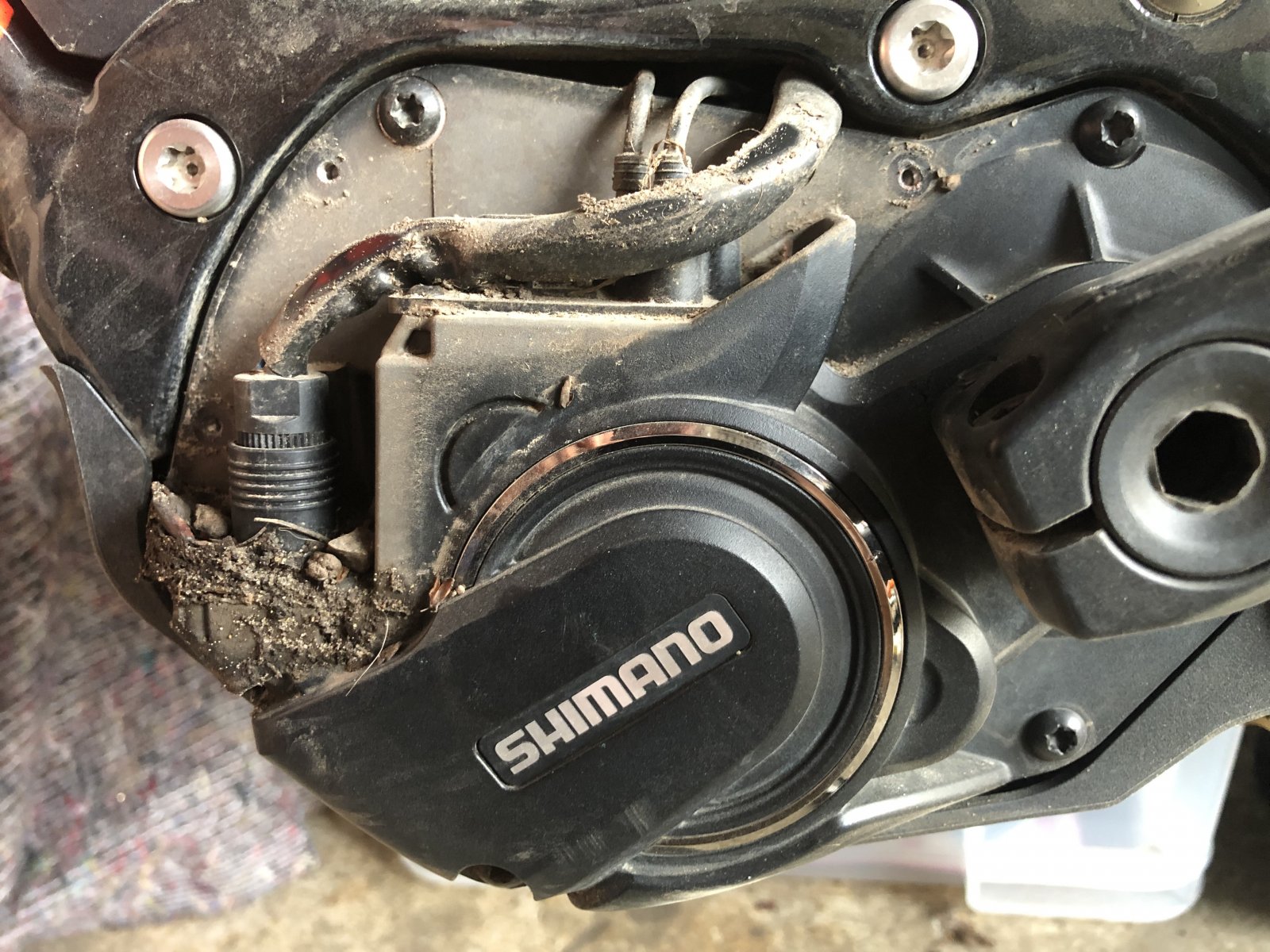

Was out yesterday and noticed at the bottom of a run that the motor assistance had cut out - as I don't have the display any more I had to use the E-Tube Ride app to see what it was, and I got the W010 fault code, which depending on what bit of literature you read means either the motor has got too hot, or unknown fault:
Drive unit temperature higher than normal
Turned the bike on and off a few times, and still no assistance. Then changed the battery for my spare, and it worked for about 10 minutes before starting to get the W010 code, then turned on and off, and got the W013 code, which is:
Initialization of torque sensor not completed successfully
Got back home and put the bike away, then last night had another play with it - same problem when Turing on, straight to the W013 code. So then I cleaned all the connectors, and did a full software update on all the components (hadn't done one in about 6 months). This appeared to solve the problem, as I took the bike out for 20 minutes and it rode fine, will take it out again this morning and see what happens.
It was very hot yesterday, and I was riding the bike hard around Surrey Hills, so hoping nothing terminal.

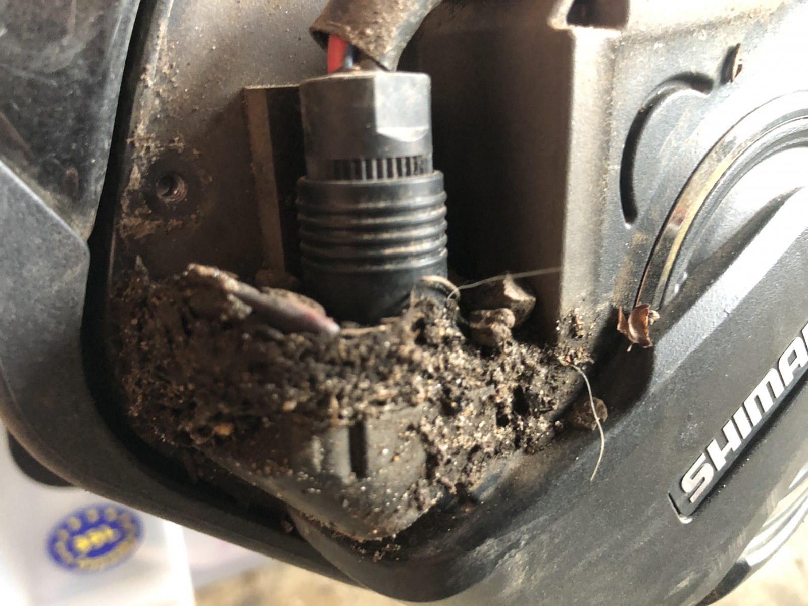

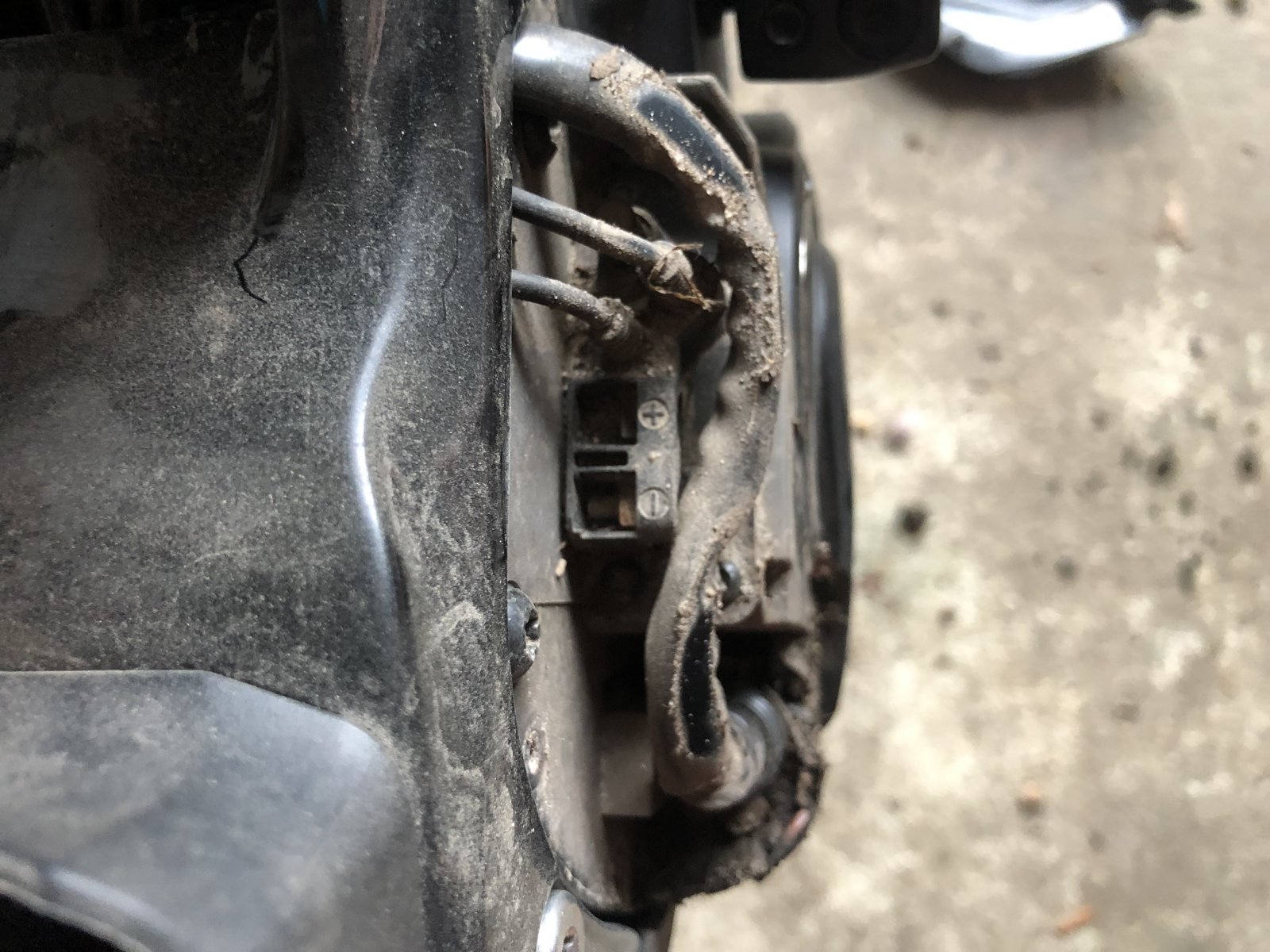

The attached pics of behind the connection cover shows the amount of crud accumulated in there since I last took it off back in October - looks bad but actually quite impressed not more, considering I ride the bike in all conditions all year round.

Upadte - wouldn't work again this morning, so off to the LBS to plug in the laptop and see if that sheds any light on the matter. Hoping it isn't terminal!

Bear in mind most of the mud/dirt that's got into your motor will have been wet as it entered the casing. Your connections could be in pretty bad shape.
It's a pretty poor design on the Sommet. And there's a completely open gap into the junction box from above. (straight through the wiring nest and down directly in to the connector junction compartment)
Mine now stays clean since I
Motofoamed above the motor, under the wiring nest, to the rear and inside Downtube junction. Added the wiring nest Pakora tray flap/cover above. Siliconed the cover edge and added a strip of electrical tape to the edge.
Hope yours isn't terminal.. Or I hope you have a fast turn around if it needs replaced.

I had the W013 error come up on mine mid ride quickly followed by a full screen E010
I did everything I could in the way of terminal cleaning and resetting but that motor never started again. CRC replaced the motor and I'm cooking on gas again.
After a slow start CRC warranty came through well. From fault occurring to bike being returned was around six weeks which got me out on my Capra again :) but I missed the e-bike. It's a real game changer for me at least.
As far as the lhs junction box is concerned I filled the void where the three cables enter with some bathroom silicone which keeps the crud out.
Good luck with, after years of fixing cars, bikes and everything else it is a shock :) to be stopped dead in your tracks by an electric motor error code!

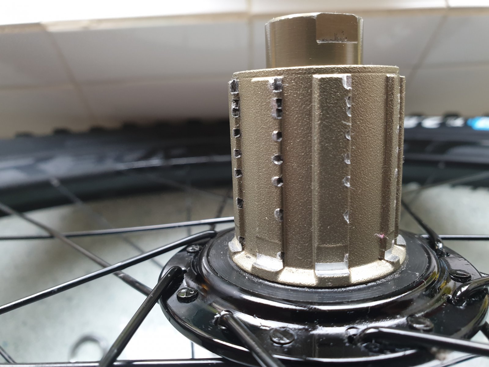

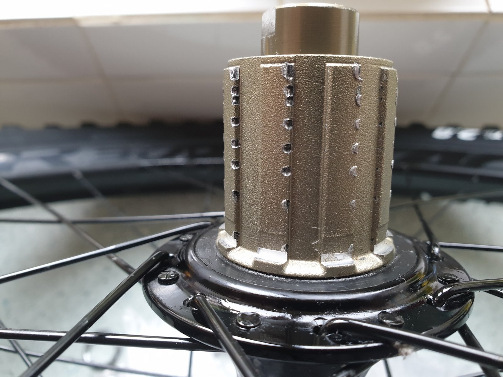

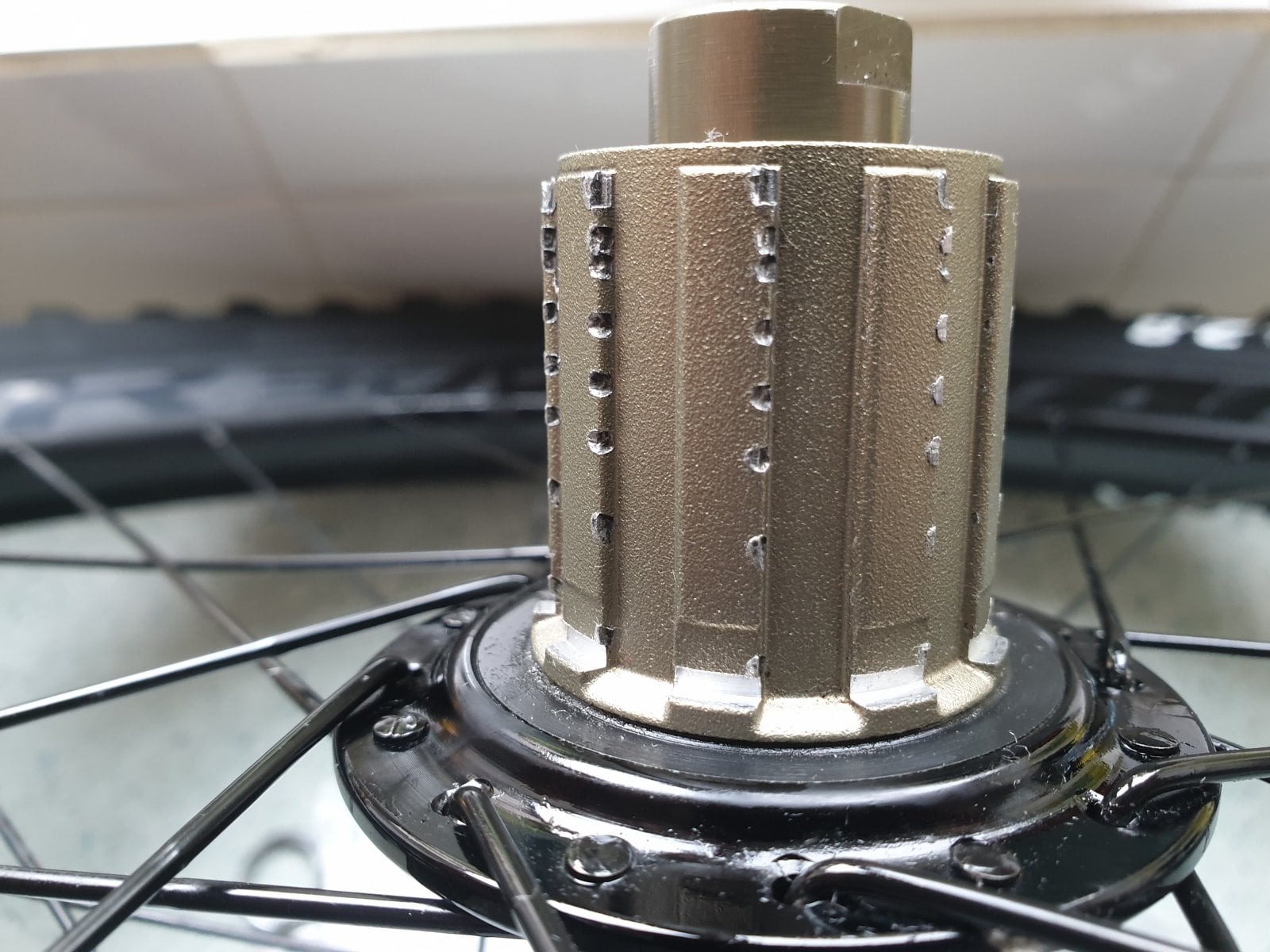

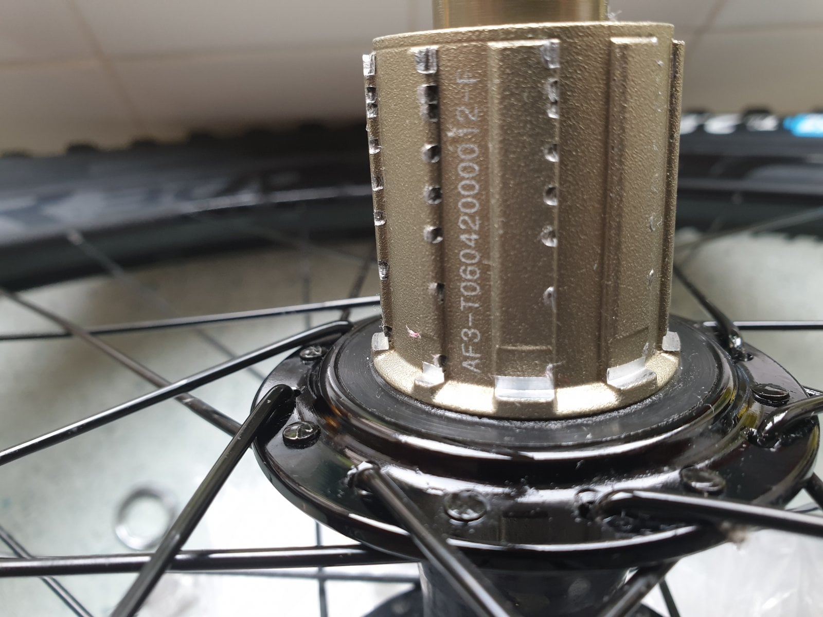

Lat ride out I was getting some what seemed like chain slipping, got in indexed gears and still the same, bought a new chain and still the same, tried my other wheel and that was fine with no slipping so I took the cassette off and I'm met with this...cassette seems fine, no chunks missing or even bad wear at least to my eyes, WTF.
It looks like your cassette have been a little loose on the freewheel, were it tight enough when you took it off?
Anyway an alu freewheel will eventually end up looking like this sooner or later due to the extra power - getting a steel freewheel if possible is a good investment.

Yeah it was real tight Karsten, looks like I can just replace the cassette body but struggling to find the correct one, the serial on there comes up with nothing on google.
I don't know the Vitus in details but I guess that it is an 11 speed 11-42t or 11-46t. If so, the best bang for buck is the Shimano SLX cassette like this:
