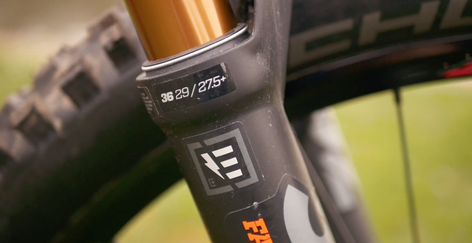

Mixed marketing messages I feel, on one hand were told that the expensive (generally lighter) forks are just as strong or even stronger than the cheaper variants. We are told they are more expensive because of more expensive materials, tolerances and extra machining to reduce weight (makes sense more complex machining massively increases the cost). Now were told they need extra beef to deal with and extra 7-10 kg bike weight?
Another marketing thing I've observed recently is .. we put a cheap fork on because its actually better as it's thicker/heavier so stronger... yet the high end versions are all festooned with Kashima etc
I've broken just about everything on a bike, snapped a couple of frames but never have I ever snapped a fork but I've seen it happen to be fair... but snapping or lots of twang on a "standard" Lyrik or a Fox36 .. really?
Running the stock Lyrik and it's been fantastic, I still need to add a volume spacer according to the shockwiz but it's really well behaved and having High and low speed compression has really helped me dial it in.. what I'm getting at is modern forks are very adjustable so E-Bike specific seems a bit unnecessary to me... but if companies can value add they will.
9,190
I have 180MM Lyric RC2's on my Sommett, and 150MM Fox Factory 36's on the Sentier, and have flung the bike down the hill pretty hard both with and without me on it and never thought about needing a burlier fork. The 36 on the hardtail takes a proper hammering too, I regularly use most of the travel.
Gary
Old Tartan Bollocks
Mar 29, 2018
10,496
10,706
the internet
the stanchion wall thickness of a 2002 Marzochi monster T (pretty much the stiffest most overbuilt DH race/Freeride/hucking fork ever produced) was just 2mm.
I still have a set. The fork is 170mm and weighs 9lb
I don't know what the wall thickness of a standard 36 is but even if it's in the region of 1.25-1.5mm adding 2mm to that upping it to over 3.5mm is massively overkill.
Has anyone even broken a fork chassis on an Emtb yet?
