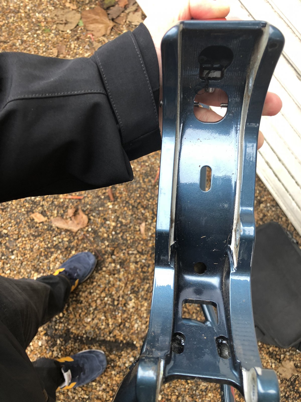

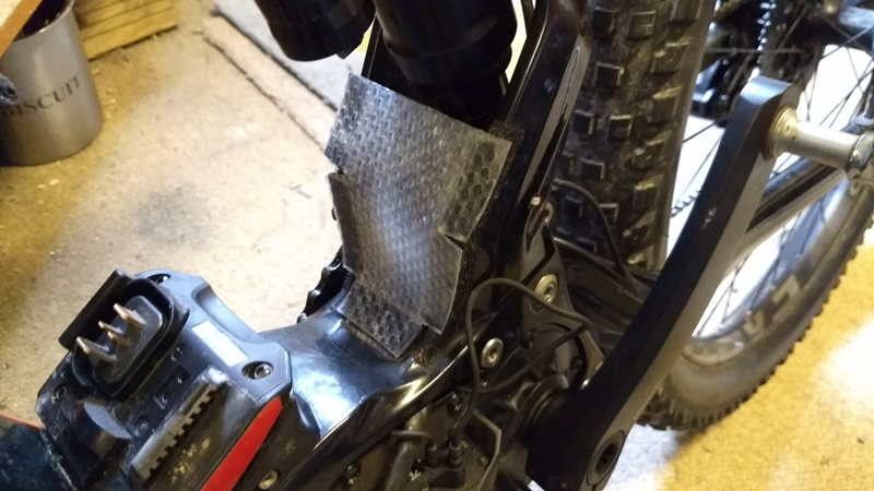

Remember what I did? I've never had any mud in there and been on quite a few muddy rides. View attachment 10566
Considering how muddy my shocks can and reservoir get in proper mud that wouldn't keep everything out.
My solution should hopefully allow any mud that gets past to clear to the back and out over the main pivot/shock mount rather than collect in the wiring.
I'm also to vain to gaiter that much of the bike.

So is this a good idea to prevent shit getting in then..?
As I say above, it does work and so will all the others shown. Mine was a quickie but I've left it as it worked but going to make a better one. I am also going to silicon the hole where the mud gets in.
As I've said before, this is a bad design and it looks like Vitus haven't fixed it on the 2019 model. They obviously haven't tested these in muddy conditions. Maybe that's why they're so cheap?

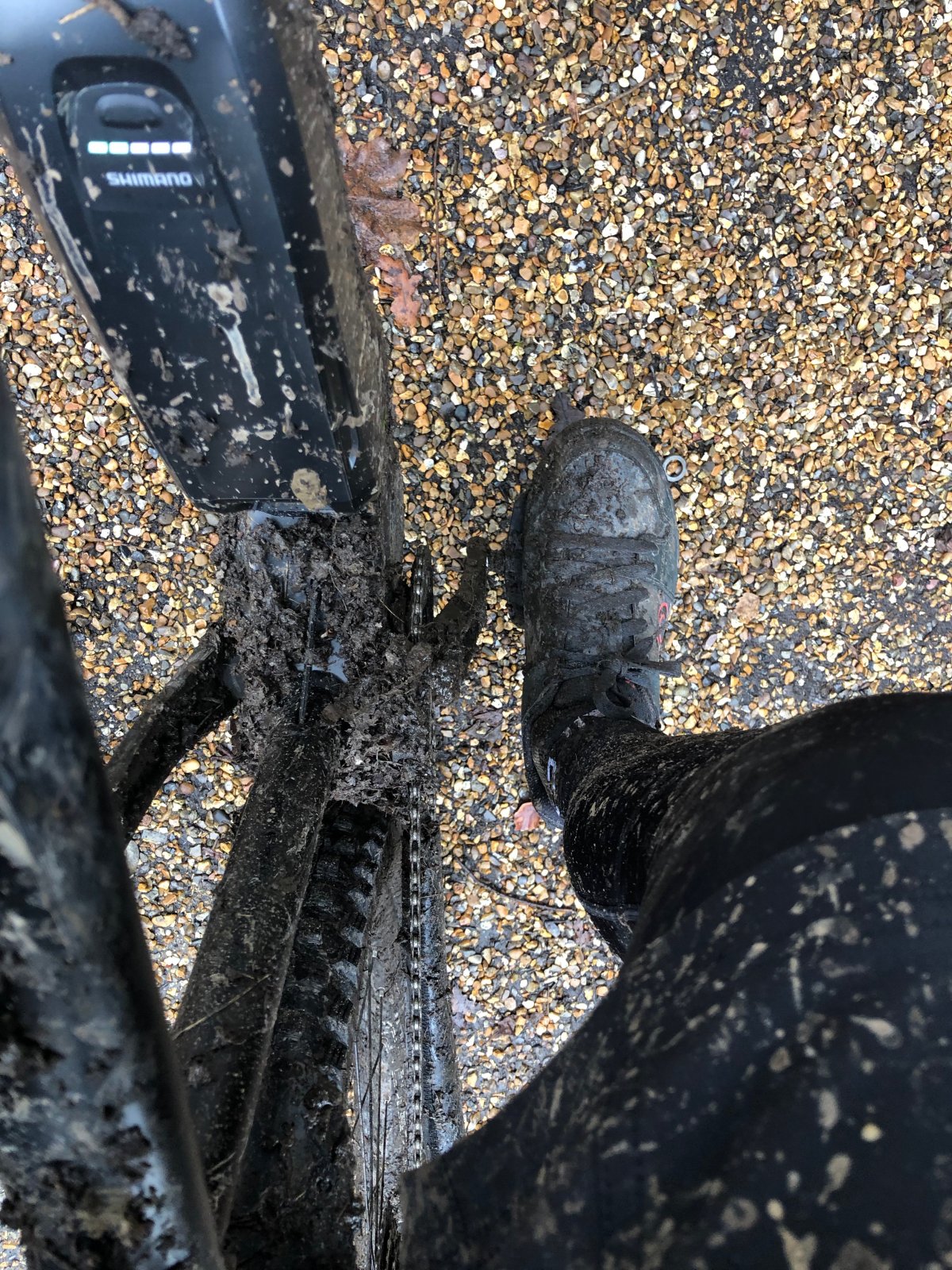

I have been riding both my Vitus's in the worst the British weather can throw at them, and I have had no issue with anything getting in to the casing - the issue talked about here are universal to the Shimano motor system, or indeed any motor system as the cables need to get in to the casing one way or another. You will find that the mounting systems, and how the cables get into the bike, is pretty much universal across all bikes using the motor.
Where the lower shock mount is debris can collect, and you have two options, scoop/push it out with a brush or air hose if you have one, or wash it out with water. If you go for the later you need to be sensible, as you do anywhere near the motor, as if you you too high a pressure or amount of water then it will get in the casing.
Have a look at the actual space left for the cable to enter the motor. (shining a torch into the wiring from above and looking in from the side I was quite surprised at what I saw) It doesn't require particualrly high pressure for water or debris to enter. but yes water volume isn't great either. being sensible when cleaning as you say is the important part. After you mentioned that debris/water from the wiring "nest" just exited the rear past the pivot/shock mount my sensibilities temporarily left the building having not realised the extent of the gap straight into the connector bay.

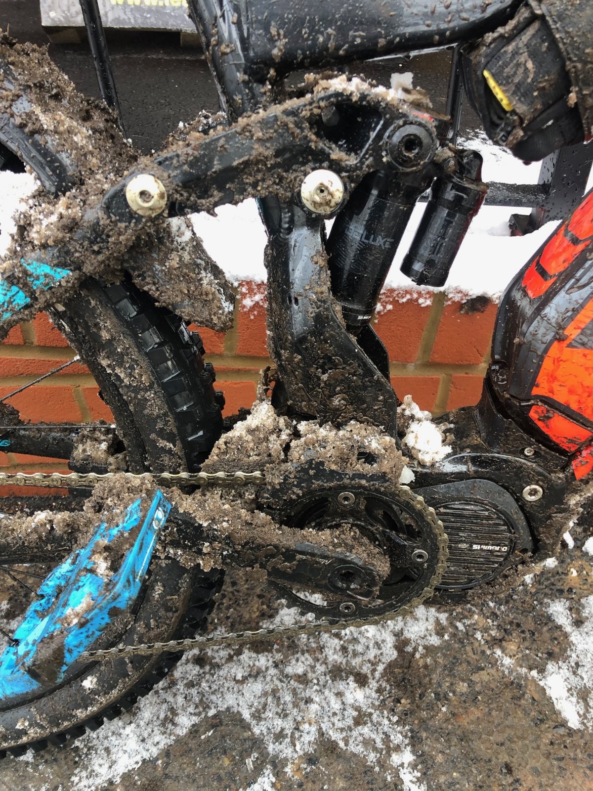

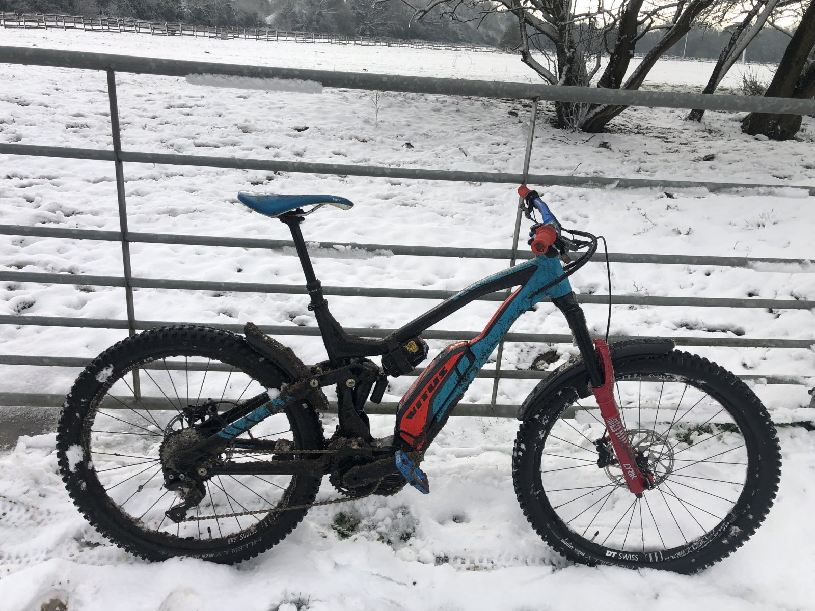

You've thrown the grime on there for extra effect. ;)
How come it's still in the crank arms after you've been pedalling or in/on the car?
Not quite sure what you mean? Both those photos are taken mid ride. The clay mud mix in the Surrey hills means that all the muck sticks.
There is no gap like on the Levo, which is a gap into the motor housing, what there is is a gap of about 10mm between the top of the motor housing and the frame mount on all Shimano bikes, and dirt can get in here but it sits on top of the motor, and usually comes out when you wash it or with a brush.
The deaign of the Vitus and it’s suspension layout means it’s fiddly to clean around the bottom of the shock, but that’s also the same design that makes it ride so well. Crap getting stuck by the bottom shock mount is totally separate from anything getting in the motor casing.
Getting water and mud in this area does not mean getting it in to your motor casing.

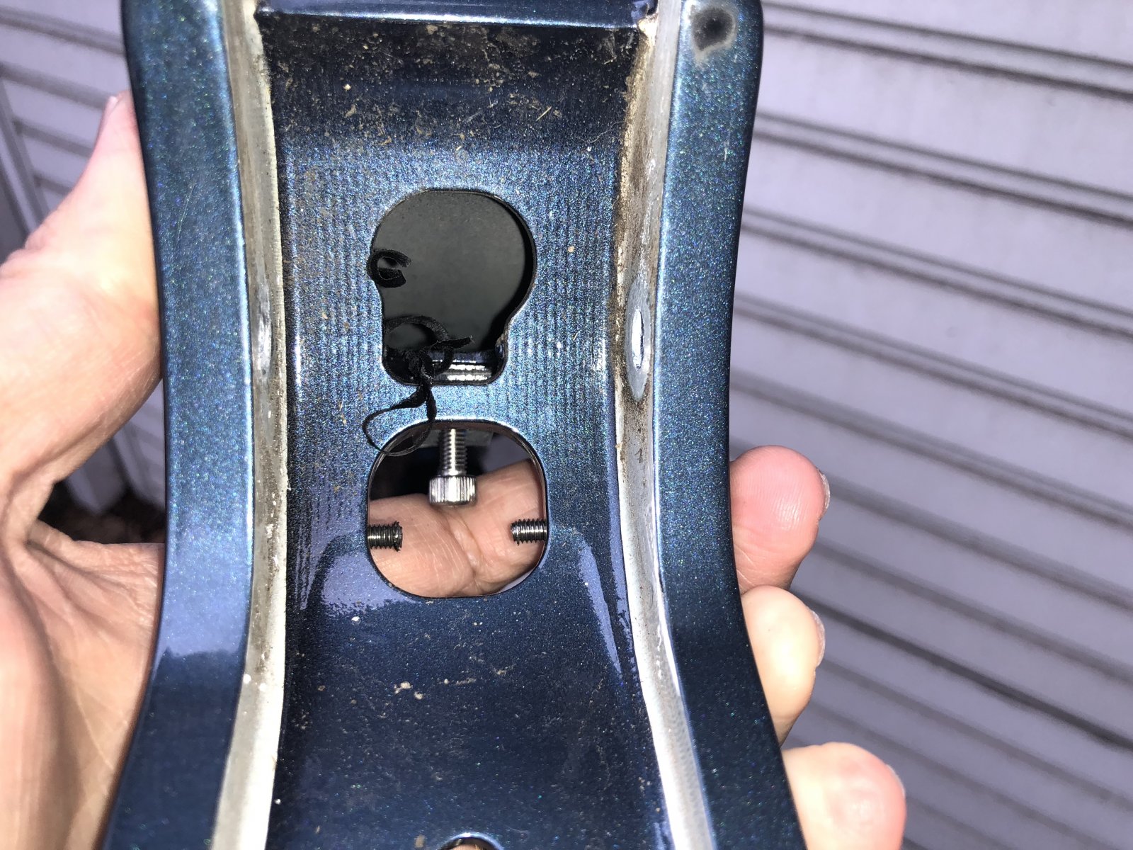

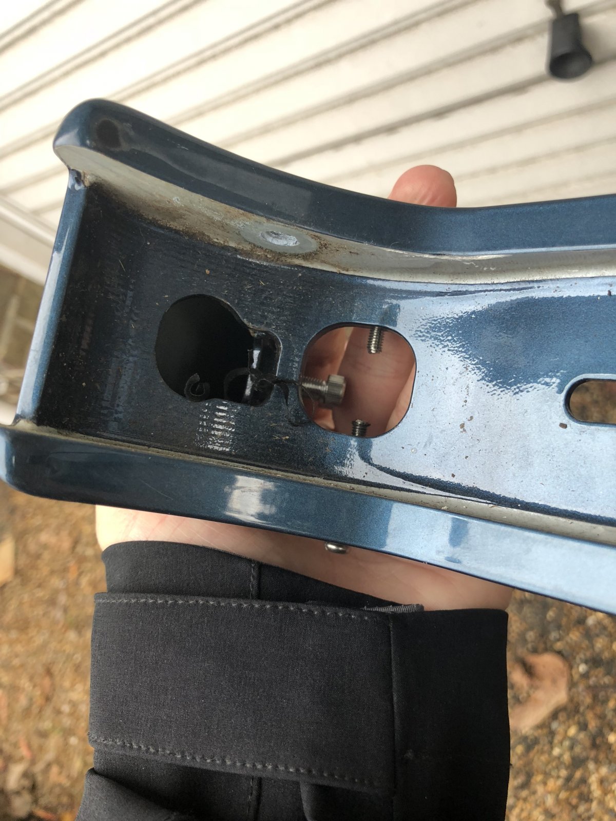

This is a picture of my E-Sentiers motor mount when I stripped it down for a respray, and you can see how there is no crap at all in there.

Looking at the design Vitus know there is a gap and the Shimano cover plate is not water tight so the connections are. I'd say from a primary design the plastic cover is not to prevent water/dirt ingress but to prevent physical damage to the cables / connections mainly from your feet. Just to be clear water and dirt are not getting into the motor as is being suggested but simply into the outer bash guard casing, under no circumstance should you make a gasket seal from RTV for the bash guard/cable cover its clearly designed to drain.
The standard connections on a DI2 rear derailleur and the computer side connections are totally open to the elements, hence the fancy water tight connectors and they are identical to those inside the bash cover. The power connection IS also a water tight connector. Ultimately if you were not protecting the cables from physical damage the case does nothing.
So ultimately the decision has been made to not block the area off and I agree with them .. why bother. The downside for the consumer is cleaning..
The only design flaw I can see is on the Shimano end and that's the lights connector, presumably if you attach lights and power them you should seal them in also as they could short (Silastic or RTV etc). The design is flexible but surprised they didn't use the same water tight connectors and sell proprietary cables for various sets of lights.
As for W011 errors.. they are thrown when there is something wrong with the speed sensor signal.. say like you when take the signal from the sensor, run it through a cheap RCSC that you power from the light connector so it sends a slower modified pulse rate to the motor than actual. First port of call on fault finding this by myself would be to try removing this "upgrade" and see if the Speed Sensor errors stop ;)
not sure who was talking about dirt getting in from the bash guard?
That's just not going to happen.
See my pic above (post #1399) the red circled section is where it's getting in.
I opened my 2019 up and the power, speed sensor and control connection all look to be watertight connections.
trust me (and others) they're neither water or dirt tight and do need cleaning out from time to time. (often even when siliconed)
