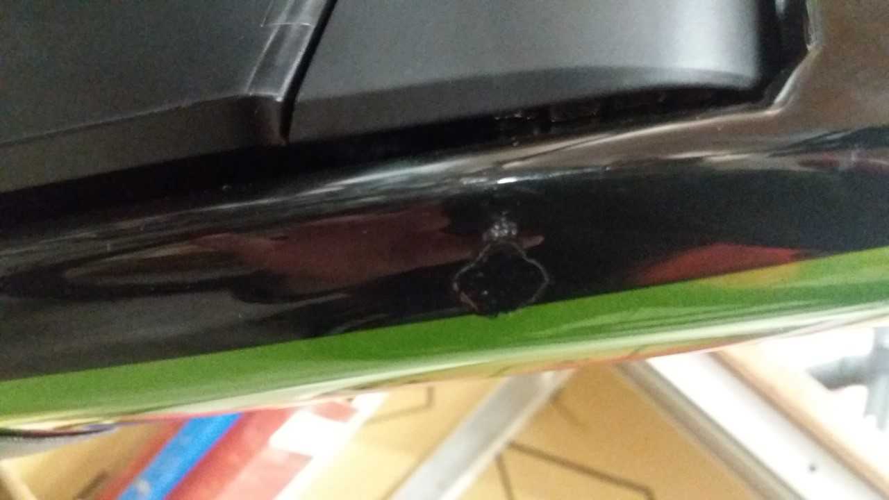

Absolutely gutted, I took the plunge and ordered a size large vitus e-sommet vr last week (very exciting first ever emtb) however today I received a email explaining that my new bike was in the workshop being built by there mechanic and getting a pre delivery check (?exciting exciting my bike is coming) however one of our team discovered a chip on the lower underside of the downtube which they have touched up and wondered if I was happy to accept it. Should I accept the bike they would like to send me a £30 crc voucher ?‍♂️
Am I been picky ?

It is a 170mm enduro bike. it's going to get paint chips at some point.
£30 seems a little low as compensation

Yeah I know I can accept that but I just thought £30 in vouchers (so I’ve got to spend it at there shop) and the fact it looks like they’ve touched it up with tippex and coloured it with a maker pen

£30 seems a little low. When I got my whyte from the LBS one of the stickers on the frame was very slightly crinkled (no paint damage) and the chap knocked £50 off the bike straight away, and that was after a generous discount to start with
9,190
I wouldn't be put off by the damage, but I would scour the CRC website to see if there is something you fancy on there that you could ask them to chuck in.

Yeah, but not usually before it's even been delivered.
BITD pretty much every DH bike you ever owned would get placed in a cattle truck, drivven up a ropey fire road and dry humped by all the other bikes' pedals, disc calipers, bars and levers for half an hour BEFORE being let out for it's first proper ride. From years of this I'm probably a little more de-sensitised than most.
I'm sort of of the opinion if it's not a stanchion a scratch is generally not too bad but yeah, I still wouldn't let some boy down the pub key my downtube for 30 notes. ;)
TBF it probably doesn't look quite so bad in real life. The parts box includes touch up paint so I'd have assumed that's what they'd use
Am I been picky ?
I had something similar but mine was delivery damage.. I was offered 150 IIRC but sent it back , yes they are cheap ebikes but still no small change and personally I'll add my own "character", a ding or a scrape from your mistake is your own story to tell IMO... received damaged well that's not character, that's just a new bike received damaged...
A 30 voucher is a bit insulting considering they will loose several hundred+ selling on their Ebay store.
Personally I don't think it's unreasonable to buy a bike new and receive it in new condition.... but that's just my take as I wouldn't accept it.

I emailed them back at 5:30ish saying I’ll wait for a new one but now I’m sat here looking at the picture thinking mmmm it’s not really that bad maybe I should have accepted it ??‍♂️
£30 is bs, they gave me £100 just for a scratch on the forks! No way should you receive anything of this value battered in anyway by anyone else. May be my OCD kicking in but any damage should be yours to make lol.
