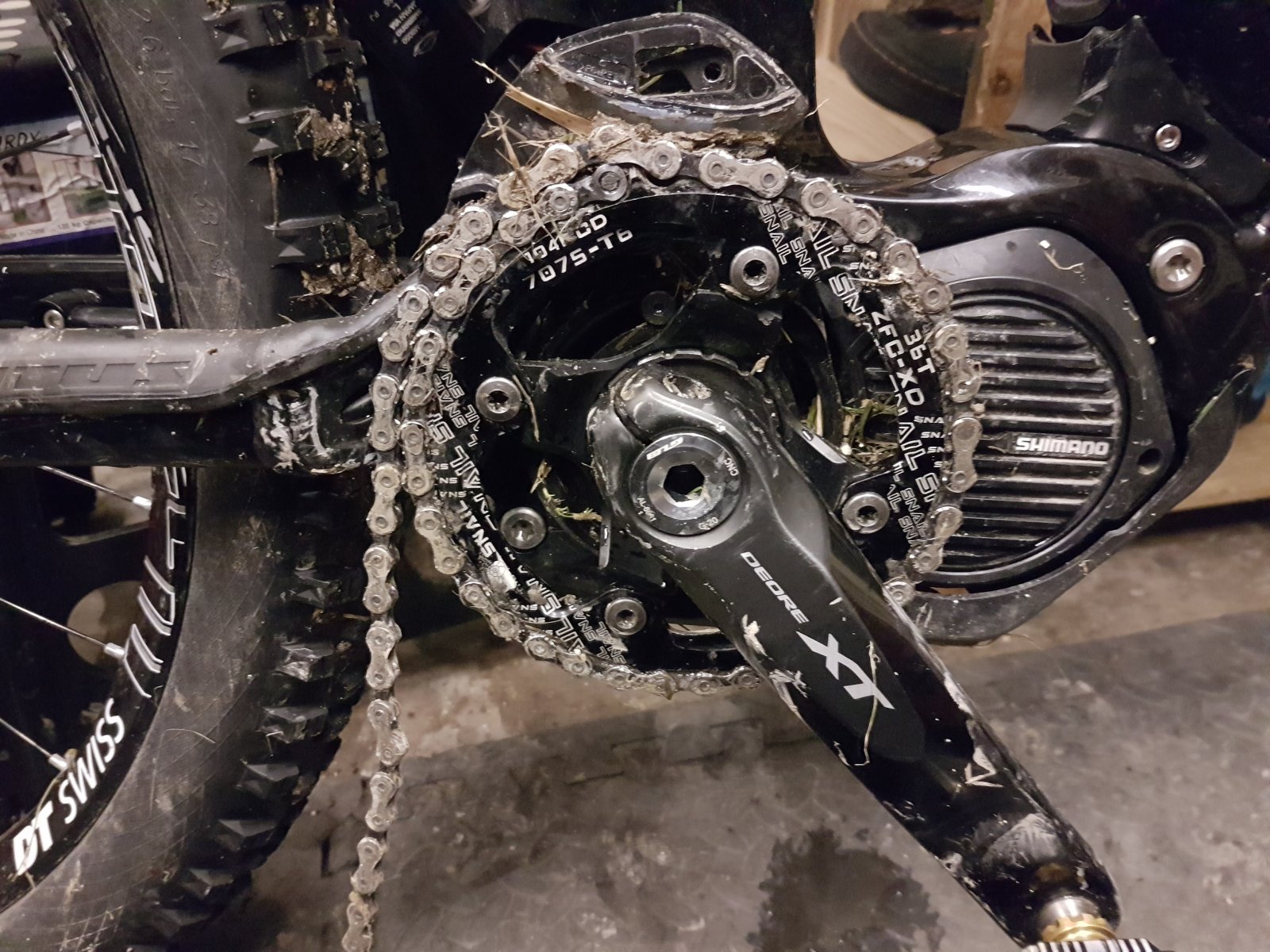

Made the classic South Downs mistake of heading out on thawing trails after a freeze. Turned round at the top of the hill but still did this at the bottom. Will need to take the chainring off to free it and fair chance the chain will be twisted. Bah.
Out of interest what chainring is that? I’m looking to change mine to the Shimano SM-CRE80 38T just because of direct compatibility but there are obviously others that fit? Cheers

any 104 bolt NW chainring will fit the spider on the e8000 crank
Dave's using a cheap aliexpress NW ring. they're about a fiver and decent quality.
There isn't really clearance for a 38t ring at the swingarm/chainstay on my e sommet. (size small, but I'd imagine it's the same for all sizes being the same chainstay, motor housing and pivot location)

It's a 36T Snail, cost about £8 from Ebay, HongKong seller but have since seen a UK seller doing them for a few quid more. Couldn't find the £5 option on Aliexpress (although I do have some pink anodised bits on the way from them......). I have turned it around now as the graphics are a bit minging, plain black on the other side.
Shame Shimano don't do a steel 36T, I'd have one of them. Reckon a 38T would be Rizla clearance, if at all. Too close for my liking.
Note with a 36T the Shimano chain guide only has positions for 34 and 38, I've filled the gap with clear silicone, Gary has used some sort of 3M tape. Also helps with keeping things nice and quiet.
That is the deal. I had a 38t DH ring kicking about so tried it.
what with the play in the E8000 BB and swingarm flex there's zero clearance room for movement. so a loose pivot/crank is going to mean that chainring eating into your swingarm/stay

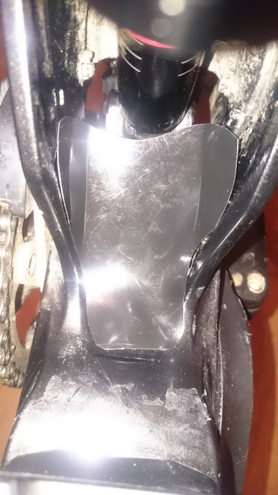

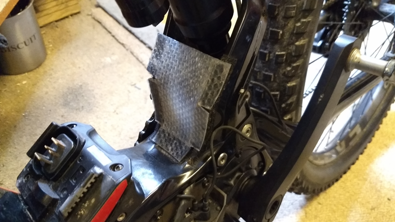

So is this a good idea to prevent shit getting in then..?
Just knocked up a neater solution using plastic cut from the packaging of chicken pakora (from the local SPAR) and bent to shape by hand. nabbed my youngest daughters hot glue gun to stick it in place.
It's only stuck at the front so it can still flap open to insprct/clean if needed.
No idea if the glue'll hold but going by the crazy shit my wee one stick together I'm fairly confident it'll manage to stay put during a ride. Washing will be the real test.

Chicken pakora, from spar..? You going to die a horrible painful death man. I started to cut out something similar but thought it looked bollocks so gave up.. it’s definitely missing a fixed cover down their like the back end, way too open to the elements

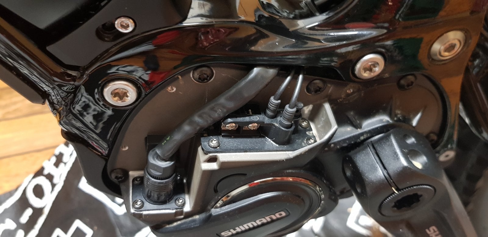

I opened my 2019 up and the power, speed sensor and control connection all look to be watertight connections.
From left to right Large cable is main power then the 2X sliver screws are for lights, the next 2 are control connector, speed sensor connector and then a spare with a blank plug presumably for DI2 rear Derailleur.
I checked the +ve and -ve terminals of the Lights and it's Zero Volts with the bike turned on, could be a weak point though if you do run lights from the main battery... so IMO unless your running lights I don't see too much to worry about?
I've got some RTV that stays pliable over a large temp range I could use to seal off the gap.. but really having looked at it i'm not really that bothered now as I wont be running lights from it. If your really worried run some sealant around the power, speed sensor, control connector and blank plug for a bit extra as water will track down the cables but really..?.
I definitely would not be packing that space around the power connector etc with Motocross foam as you'll want to keep that area open, just clean it out occasionally. Perhaps some motocross foam jammed in the gap behind the cables to stop the worst of the crud getting in?
Don't wanna tell you how to suck eggs polaris but i'd let the air out of the shock and check clearances.
Gary what have you got connected to the lights terminal? and what's that wedged behind the power connector?

Started getting W011 errors while using peartune last week so cleaned out the connectors etc. And all good again next ride. But got the error code again yesterday so opened the motor casing again to have a look. Here's what I found. after only 3 muddy but dry rides.
*sigh*
How is it getting that manky after such a short amount of time? And when I'd sealed the motor casing with bathroom sealant?
Well.. Turns out the shit isn't getting in through the casing but from behind the motor (through the top where the wiring sits) as there's a gap from there straight into the connector compartment for the cables to enter from.

I've now closed the gaps around my wiring (from the motor side) where it enters the top of the motor using sugru and have resealed the casing completely with silicone so hopefully I'll be back to normal service for a good while again.
I won't be trying to get that wiring properly clean again from now on either.

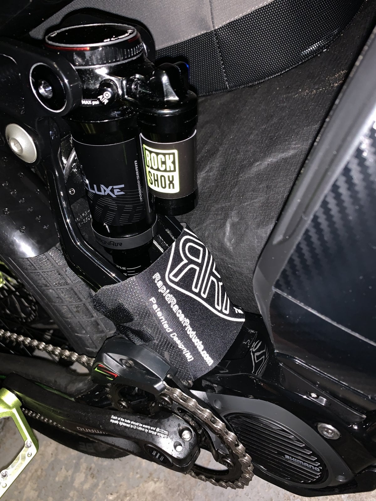

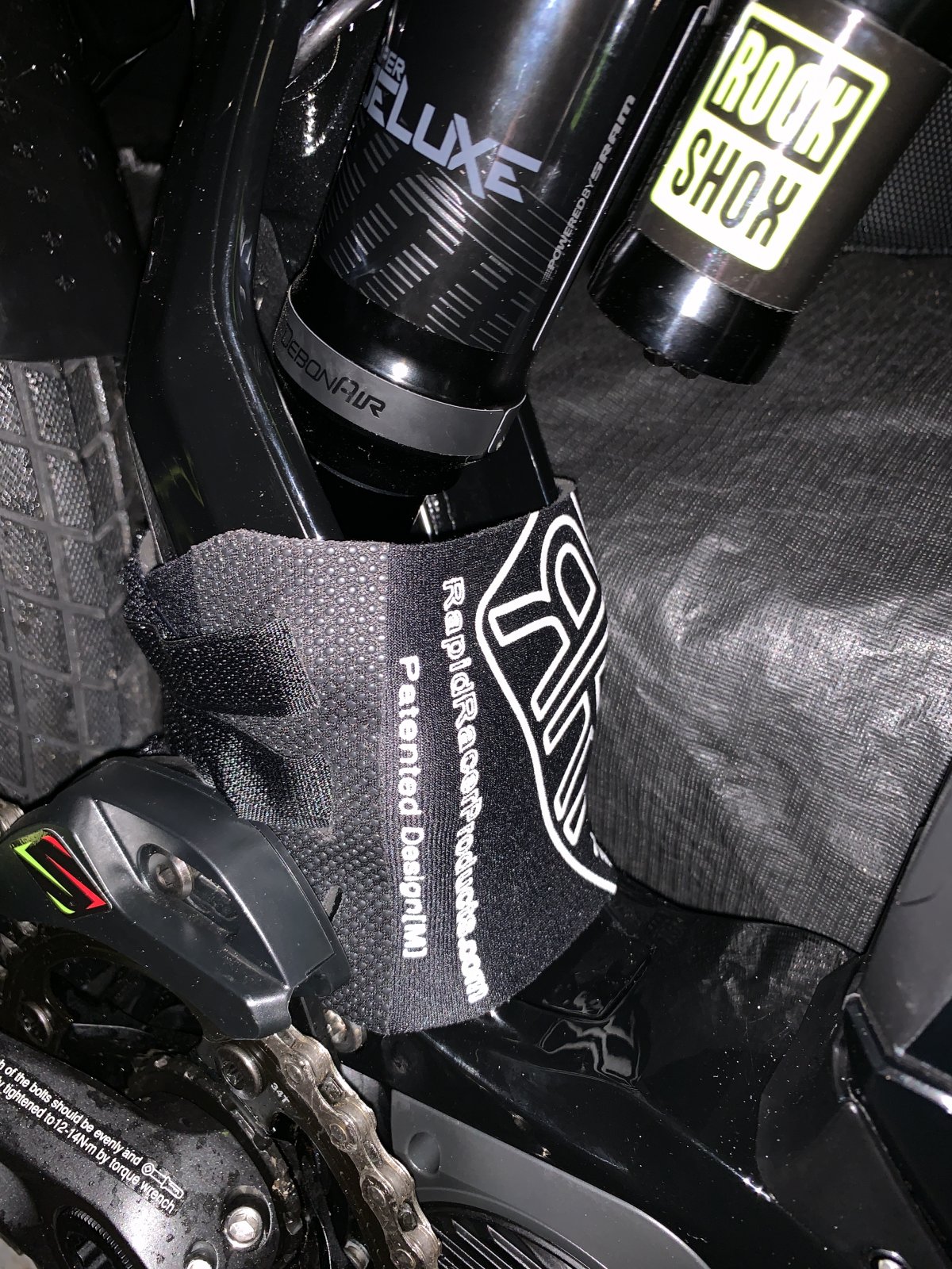

Those 3 little round plug in conectors on the top will eventually get dirt working down inside them and you’ll get an error code , just apply a little grease around them to seal them and you’ll have no problems when it gets used a bit
