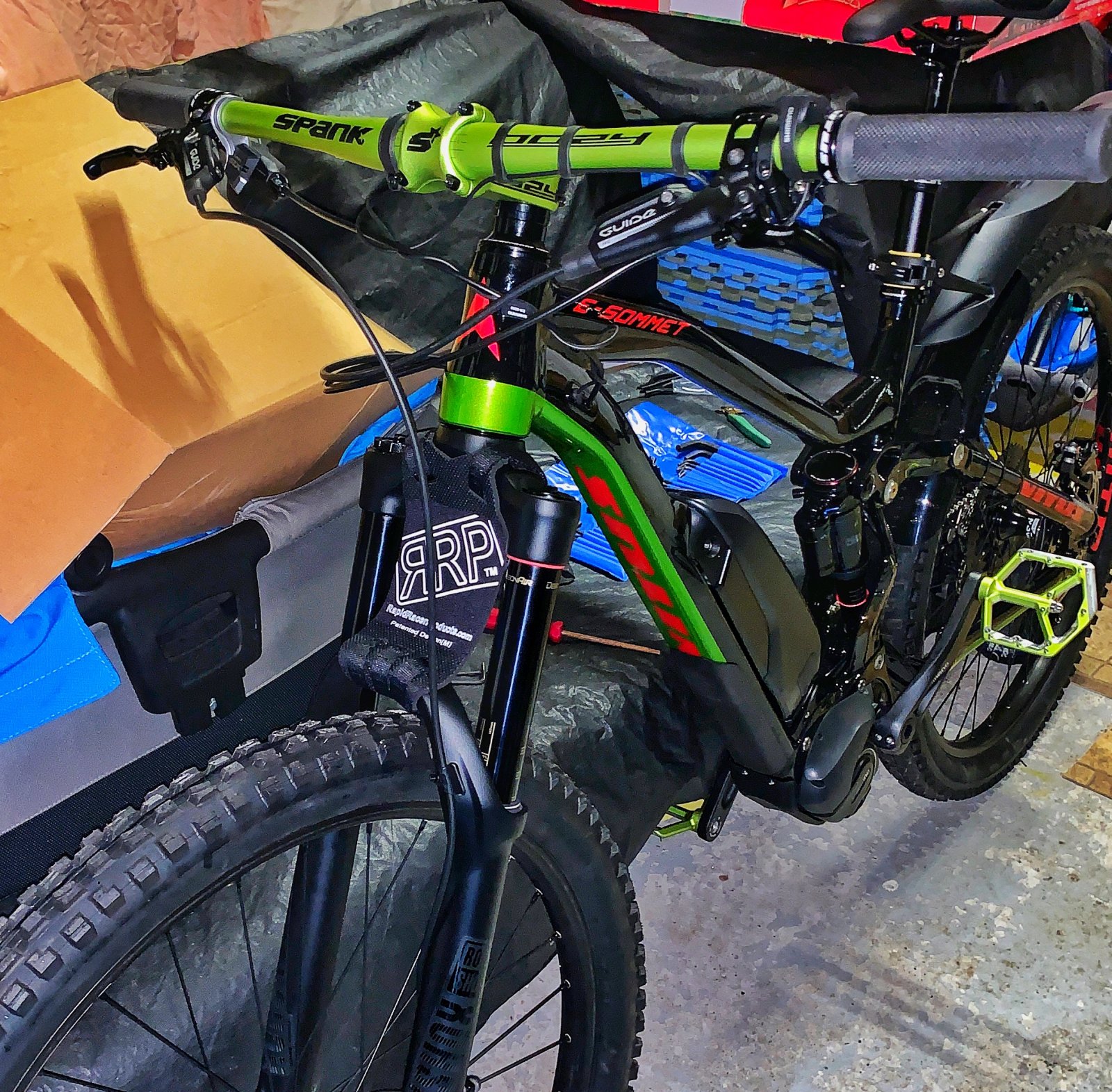

Mine came with a chip on the headtube. I got £200 ish, which paid for my Di2 upgrade and they sent a paint touch up kit with the black and blue paints.

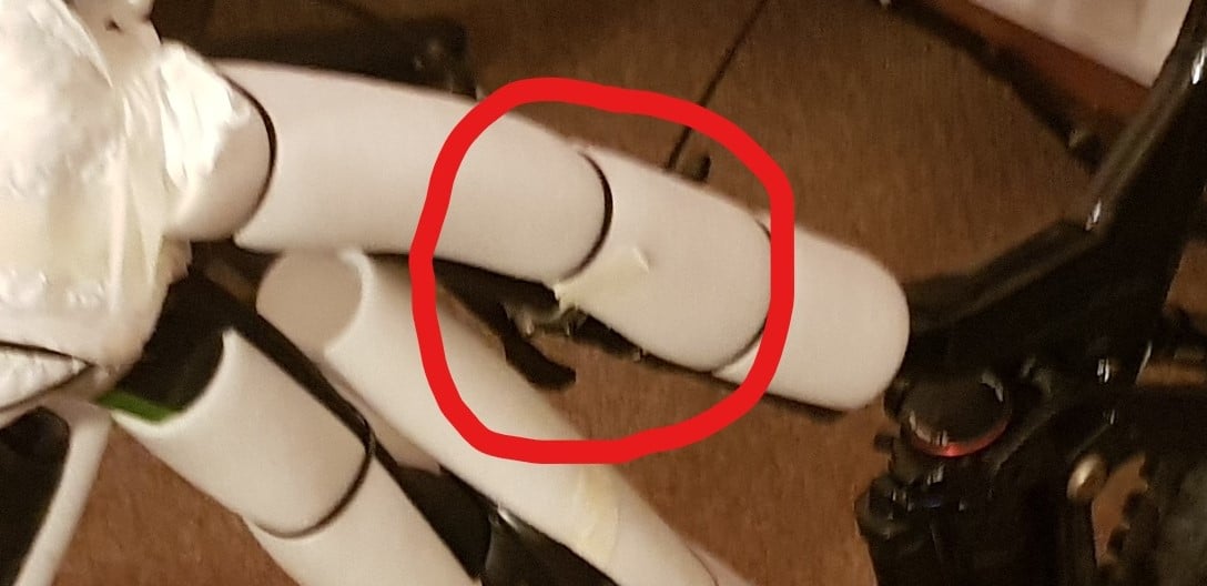

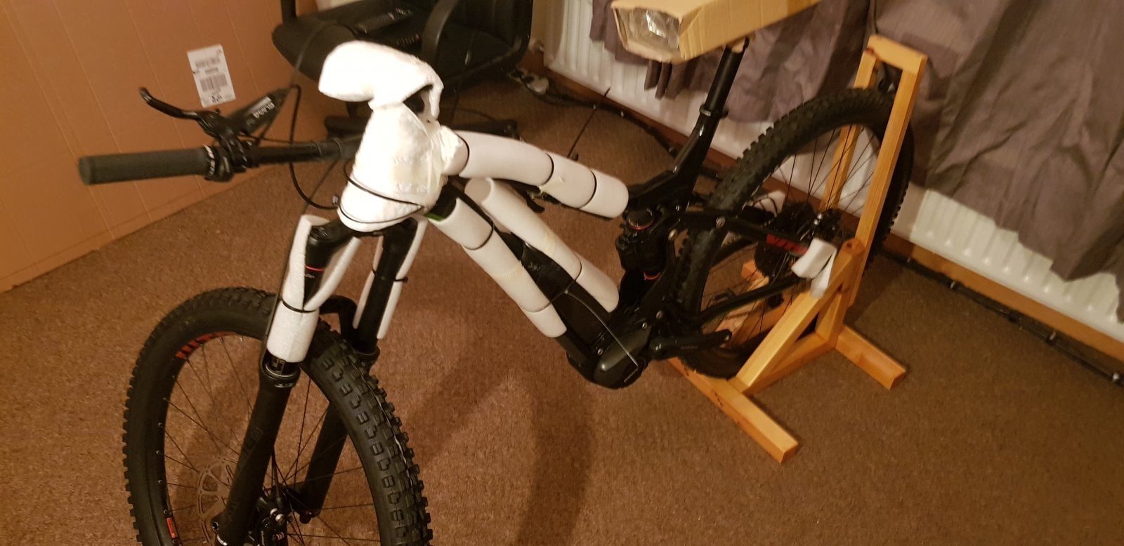

Well it's going back and it's being collected on Thurday.
How the bike was received minus the front wheel holder. No packaging on the controls, if there had been the damage wouldn't have happened.
You can see the cause... the silver clamp from the shifter. All for the sake of a couple of minutes and some bubble wrap.
To be fair to Wiggle as soon as I uploaded the above pictures no hassle. Just seems like a month or two wait for a replacement... I waited for my SC Hightower LT CC for 4 months I can wait for this.
Hi . Had same with mine . When I clocked the huge holes in the box , I was just a bit gutted !
Luckily just the steerer cap marked . No other marks . Plastic pedal did snap first time out .
Vitus thicker cardboard , bubblewrap etc and you be golden ( or green ).
Wiggle been great though IMG_20181216_151422407.jpg IMG_20181216_135543967.jpg IMG_20181216_135543967.jpg IMG_20181216_151409911.jpg IMG_20181216_135449548.jpg IMG_20181216_151351747.jpg IMG_20181216_151422407.jpg , sending nukeproof cap replacement and aluminium pedals .
Brilliant bike , luv the looks .
Do like a bit of green !
