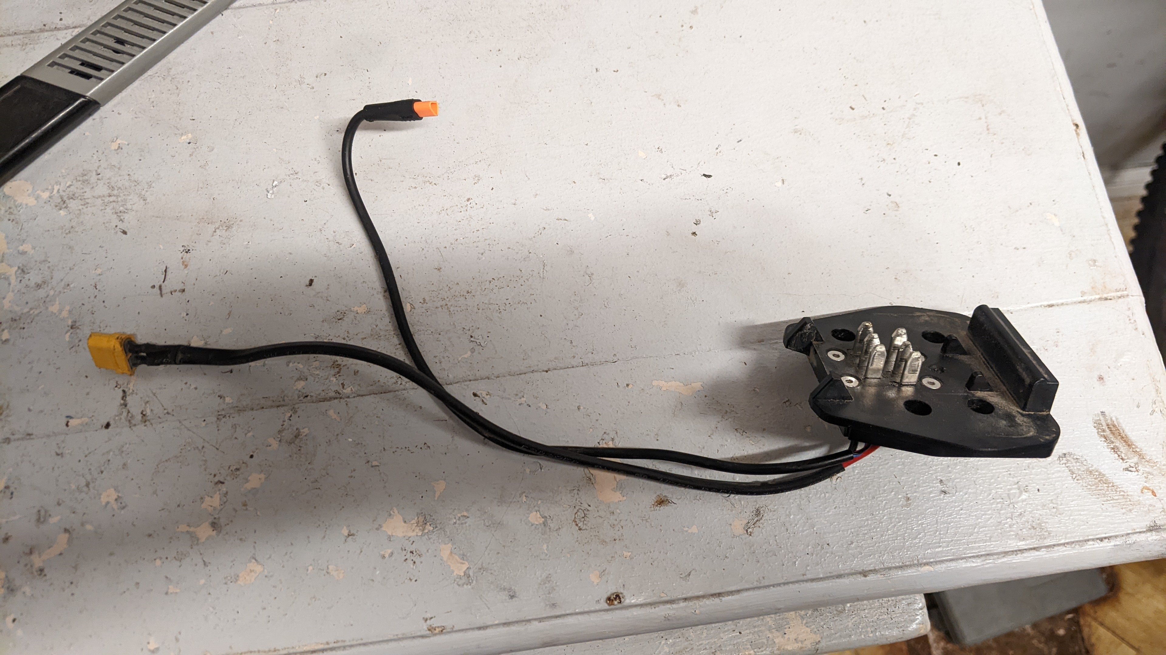

I still can't turn our bike back on. We went down the possibility of a wet motor route and ordered some AliExpress replacements. I opened up the motor and it was immaculate inside so I didn't go any further. Now I'm thinking it's a power issue. More info in next post.

So maybe it's a power issue. The battery is fully charged and on the blue light. Not in sleep mode. But I did notice that some of the pins on the battery connection in the bike look eroded. And if I look into the battery one of the connections looks burnt. When installing the battery there are lots of clicks from the battery slotting into the frame and the battery latch but I thought I could here a sparking sound too. I removed the connection and plugged it into the battery and confirmed that the battery is sparking when I plug it in. Not sure where to go from here. Possibly try to replace the male side of the connections that lives in the frame.
PXL_20241106_210046931.jpg PXL_20241106_210808006.jpg Screenshot_20241106-211601.png PXL_20241106_211944536.jpg

Ok, so shes back working for now 🤞 🤞 🤞 🤞 🤞
I replaced the power board and she fired right up. AliExpress purchase. Battery is charging in the background.
I also got a new cable but didn't use it as the original has added sealing behind the block. New cable had none.
The battery still made it's little spark sound when I put it back in the bike so inwanst expecting much. Either the board worked or the battery just decided to play ball again. Fingers crossed 🤞 🤞 🤞

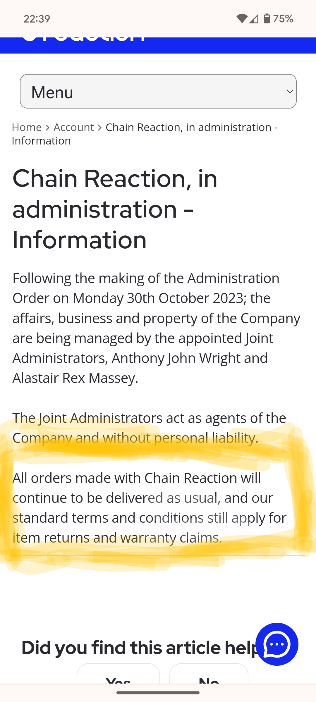

I bought my E-Mythique from CRC in their sale last year. Although they were in administration, details on their website indicated that standard terms still applied to returns and warranty claims.
After only a few rides I started getting intermittent problems with the motor before it stopped working altogether.
I managed to contact CRC through their webchat. By this time they had been purchased by Frasers Group who said that they were not responsible for any previous orders or issues. I was advised to email the administrators at wigglecrcreturns@frpadvisory.com.
I received a reply 2 months later saying I could register a claim as an unsecured creditor.
In the meantime I contacted my credit card provider and explained the situation to them and provided all the information. They opened a case and within a few days had agreed to refund the cost of the bike through the 'chargeback' process.
Within a couple of weeks the money was refunded.
I then came across the forum whilst looking to repair the bike. I took the motor apart and found that one of the boards was corroded. I ordered spares from AliExpress, changed the faulty part and it has now been working fine since.
