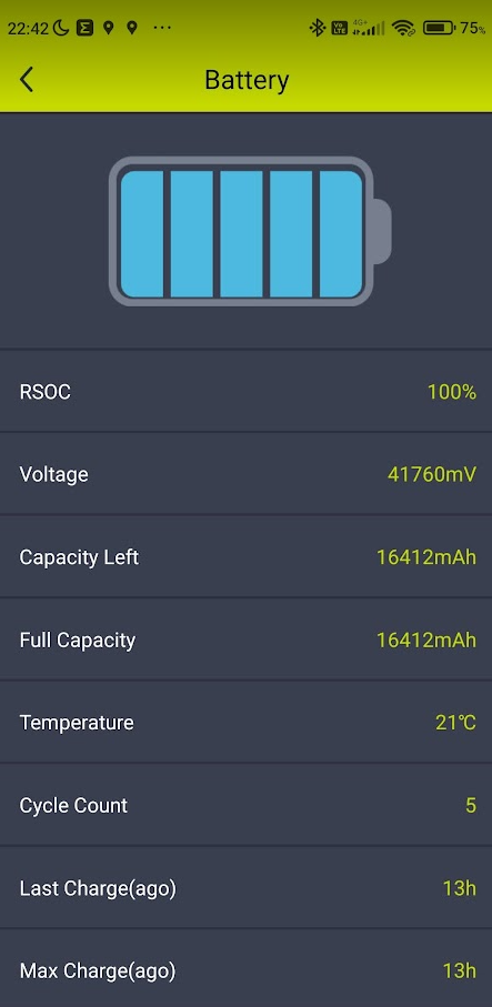

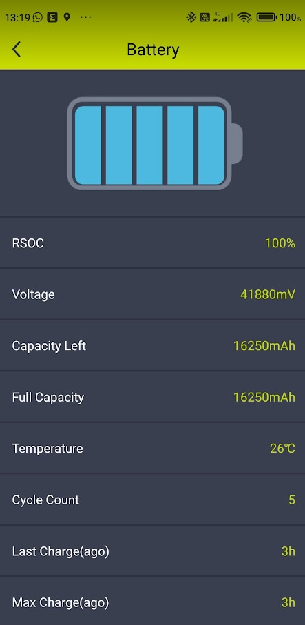

OK, this isn't hugely interesting :) But it's not something you can really do on the other bikes as it's data you can't normally see.

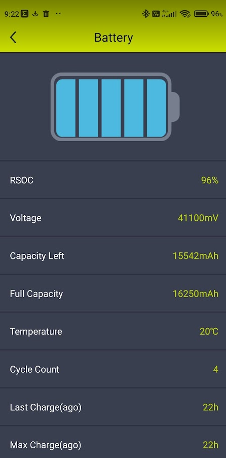

I've been monitoring the battery. As previously mentioned, it's new and they can take several charges to stabilise.
Unlike other bikes the "Charge Cycles" - which normally means how many times a battery has been charged though it's whole 100% range, ie if you charged it from 70 to 100 one day, 80 to 100 another day and 50 to 100 the third day, that would be one charge cycle - the equivalent of it being completely flat to completely full. With the Bafang charge cycle count it literally seems to mean how many times the charger has been connected. I'm at 5 now as I moved the bike around a few times when it was charging.
On the first charge, it said it had a Full capacity of 16250mah. By morning the Relative state of charge had dropped to 96%, presumably as the BMS re-calibrated.
Leaving the charger plugged in, the calculated full capacity for the battery increased.
When charging the bike, there doesn't seem to be any external way to see if it's been fully charged other than turning it on and looking at the display or feeling if the charger has cooled.

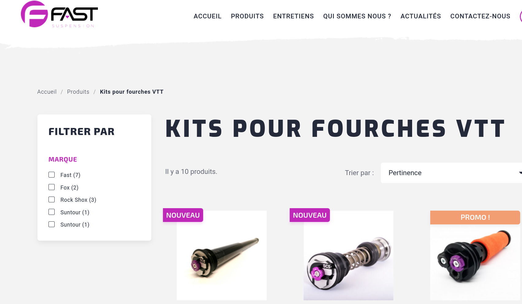

FAST Suspension damper is about €400, but you could end up with an amazing fork - haven't ridden one though.
A friend of mine has the old version (SC4) on his Zeb. Really nice. But I don't think that they list compatibility with Suntour forks. You may ask though.
Actually I don't think I've ever seen a kit to upgrade a Suntour fork from some suspension tuner 🤷‍♂️
14,115
20,928
I've just written to them .. In English it says no comparability, in French it says they are for suntour - unless you read the individual item then it says it's not ..

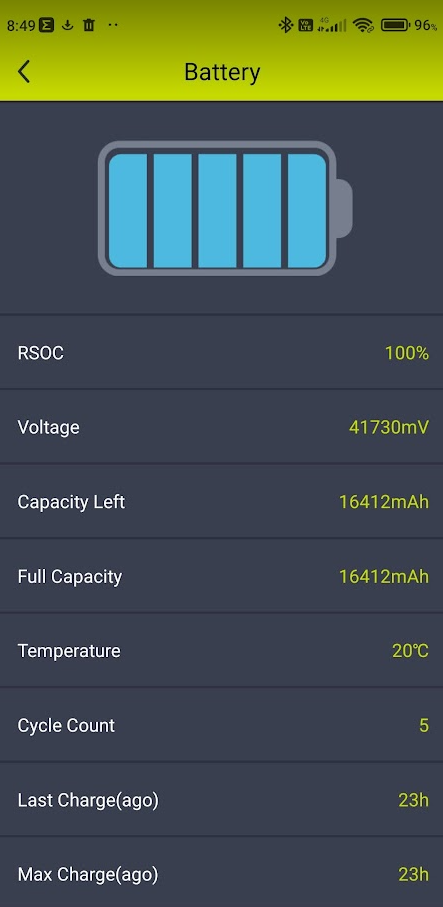

I forgot to say, the battery stayed at 100% after it's last charge.

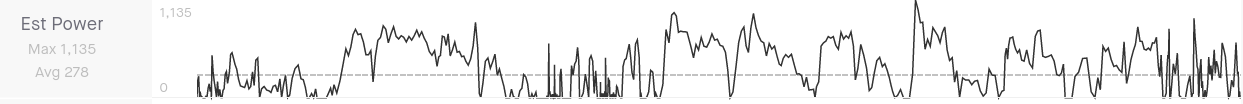

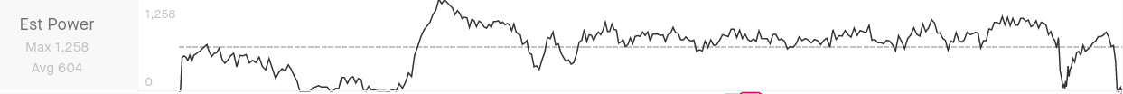

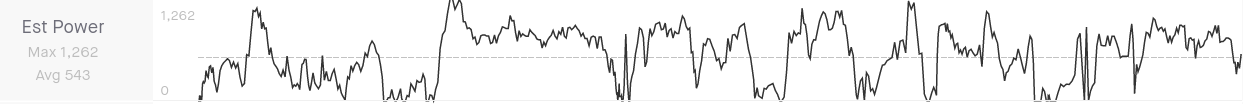

Totally inaccurate and unscientific power comparisons using stravas estimation of combined motor and rider :
Bosch Gen4 -going as hard as possible all the time : Peak 1262w
Shorter less up and down ride going fairly hard on a Kenevo/Brose : Peak 1258w
Longer steadier ride with just a few bits of going for it and lots of really slow bits (so a much lower average power) on the Bafang M510 : Peak 1135w

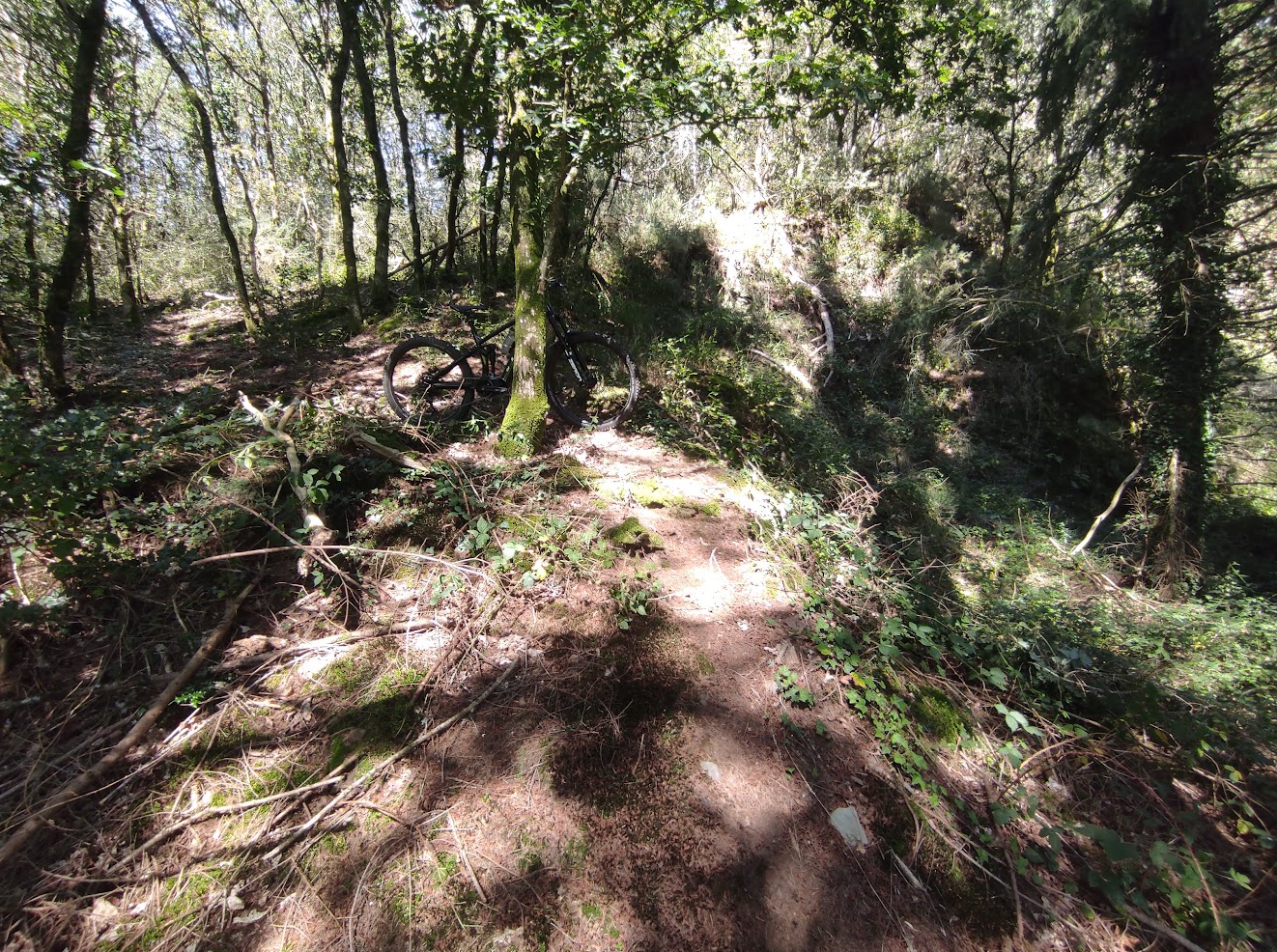

Winning the worst E-Mythique pics of the week award : Random not a trail from today ... but yo can see the extra battery guard the production bikes have that the pre-release bikes don't seem to have.
Hiding behind a tree on a new bit of trail I made this week ...
