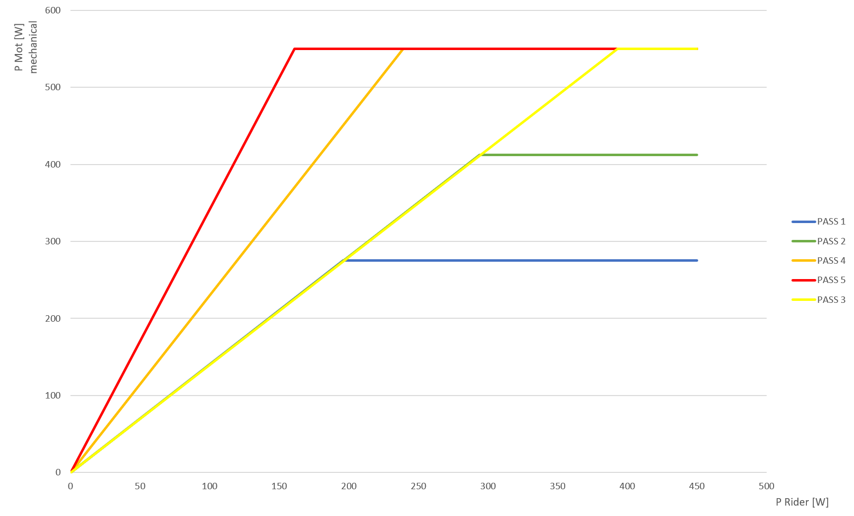

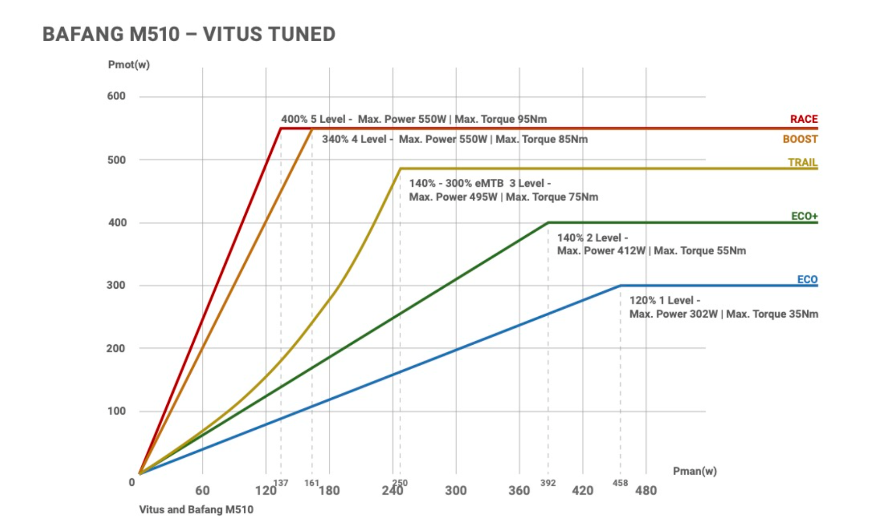

Seeing more and more M510 now.
What catched my eyes is the graph. I can imagine guys in Vitus had hard times to tune it with Bafang. ;) But thumbs up for this job.
Edit: Pman power for PAS1 and 2 is wrongly calculated in this grapf. Should be 266 and 294W - so different incline. With PASS 4 and 5 it match: 550W/3.4=161W
If somebody interested - these are Bafang FC2.0 factory defaults:
Support level: 140% 140% 140% 230% 340%
Max power: 50% 75% 100% 100% 100%
And Acceleration : 4 (out of 8) for all PASS.
So this will be the graph - looks Vitus is more power saving on PAS 1 and 2 - which will extend range.

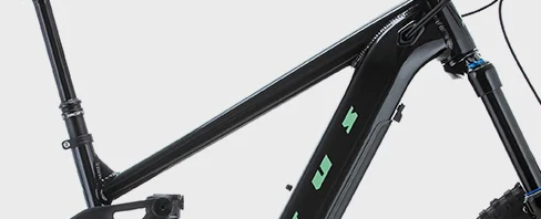

To me, this bike looks more like a cheap option than a real bargain. I got curious to know if they chose to use such gross looking welding in purpose, to make the bike seem really brutal.
14,184
21,098
If you read the press release they say "We developed a new welding technique to embody the masculinity of the bike, too often bikes now use welds which are machined back too far and create weak points in an attempt to make aluminium frames appear like carbon Frames. The E-Mythique welds are like huge testicles with massive veins, it's proud of itself"
I believe a lot of sections like round the motor, were welded instead of cast in order to reduce costs. With the E-mythique, they've tried to make something as capable as other main stream bikes, but for less cost. Presumably, they have spent less time smoothing and filling welds (like Orbeas) - because this is a bike for people who don't really care and just want to get on their bike and ride it rather than talk about it 🤯
(the press release isn't real .. yet ... )
It doesn't look that dissimilar to everything else, just less time spent on cosmetics .
The welding on all of Vitus's alu frames looks the same, but the e-Sommet and e-Mythique frames do look like they can take a beating:)

If it's welded and you can see the welds I really don't see the problem, it's welded, right? Sell me a strong budget frame (for which I can buy a motor) which works really well with all my functional shite bolted on and I'll be happy, these are tools to do a job. Function before fashion, but if you want pretty then buy pretty.

Have to say I can't see anything wrong with those welds.
As others say, I'd prefer to be able to see the welds and not have to worry about the frame cracking. As long as they're neat (not done by the apprentice on his first go, or by me for that matter), I'm happy.

I’ve got a Vitus Sommet bike (not the E version), it’s got some lovely welds, obviously welds, but very competent welds nonetheless.
One thing though that could be better on my Vitus is the paintwork, beautifully finished but seems very thin and prone to chips (unlike me who is not so thin but also drawn to chips!) but the paintwork on my 2020 model might be different to this new e-Mythique, so not necessarily an indicator.
