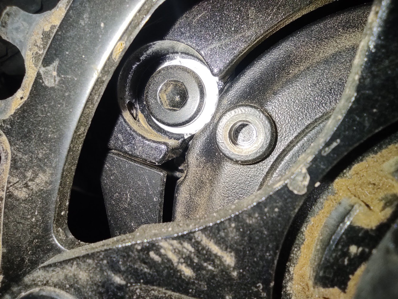

Found my first annoying thing ! The speed sensor magnet is secured with a "security" T20 (it has the little bump, so needs the bit with the hole in). Bafang might have done this to stop people stealing/messing with the magnet. Might be worth swapping the screw out though for something you have on your multitool incase you have trailside issues (could possibly do it with pliers too).

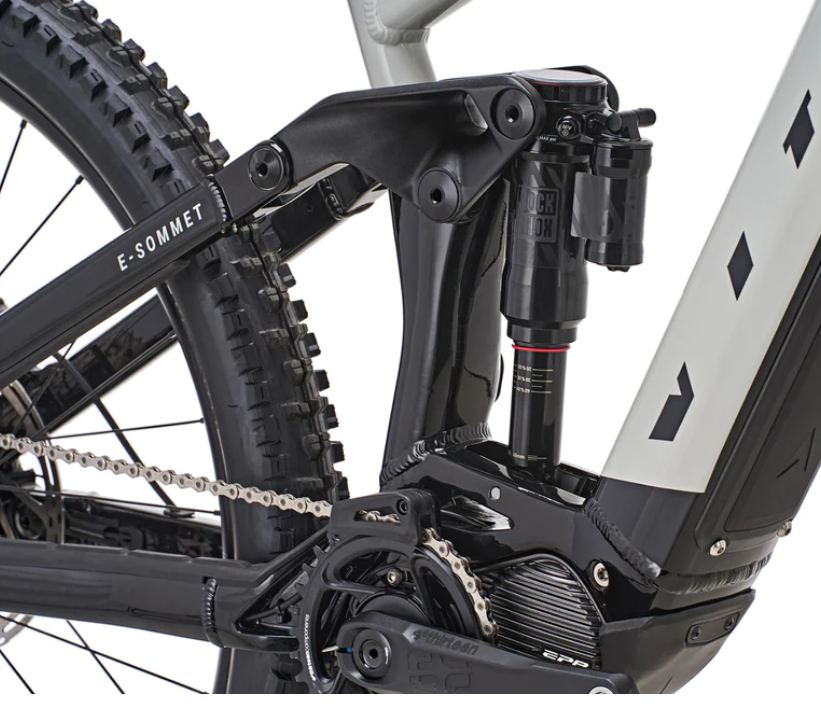

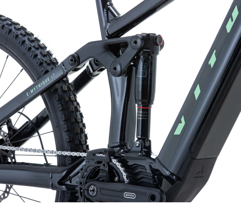

Early in the thread there were concerns that the E-Mythique had lower a lower standard of welding than the E-Sommet for example. I was looking to see if the linkage/rocker could be swapped (Gain travel) and at the same time ended up comparing pictures :
E-Sommet :
E-Mythique :
E-Sommet :
E-Mythique :
I have been thinking the same, if it would be possible to use Sommet's rocker link. Since I haven't found it as a spare part, I haven't followed this idea any further.

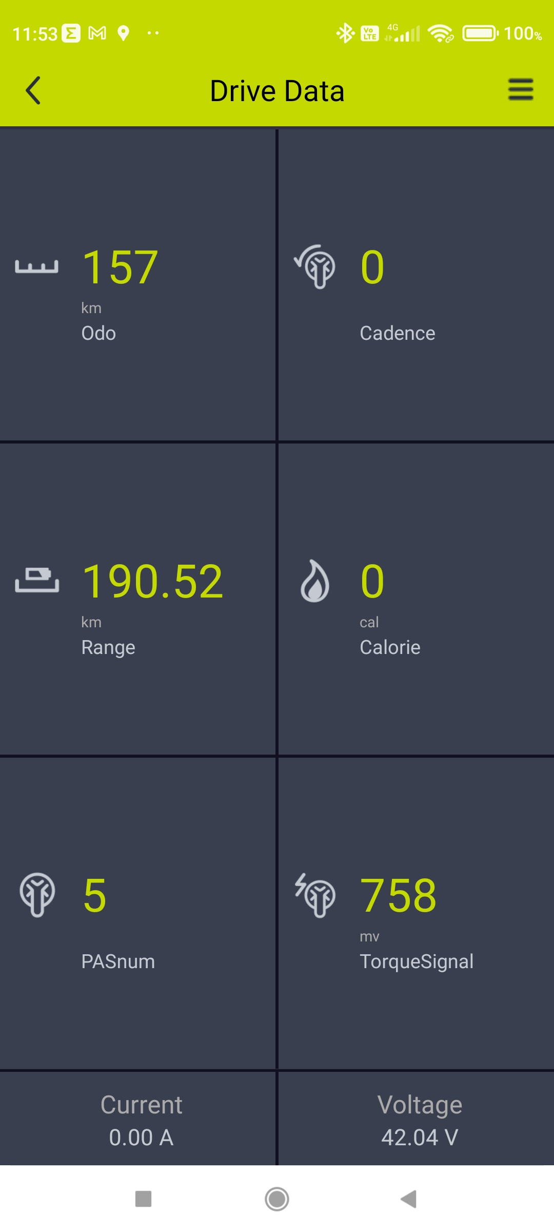

Tested amps today. Peak in B and R was 18.98,.call it 19. The battery also charged to 42 today so peaks of 798w.
Peak in T was 17 Amps.
Voltage before ride :
It also got to 100% charge. Light went green .. but carried on pulling 200ma as it cell balanced.

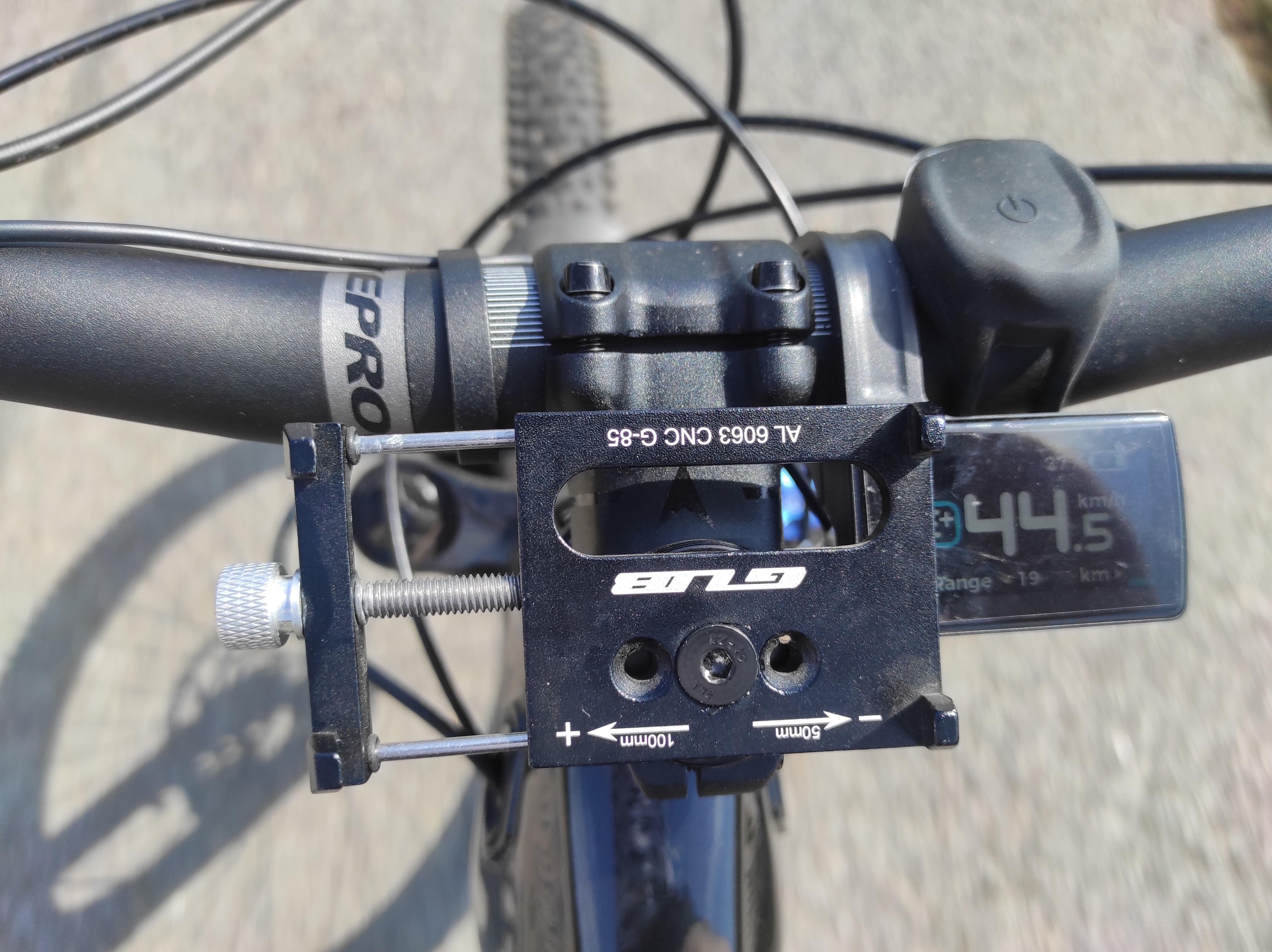

Tried a cheapo phone mount on the stem.(Needed to for monitoring current) Works well, doesn't obscure the display.. GUB G-85. Suspect pre load was torqued too tight, but they may have tightened the top cap afterwards.
I was comparing geo's between the Mythique and the Sommet the other day and they are strikingly similar.

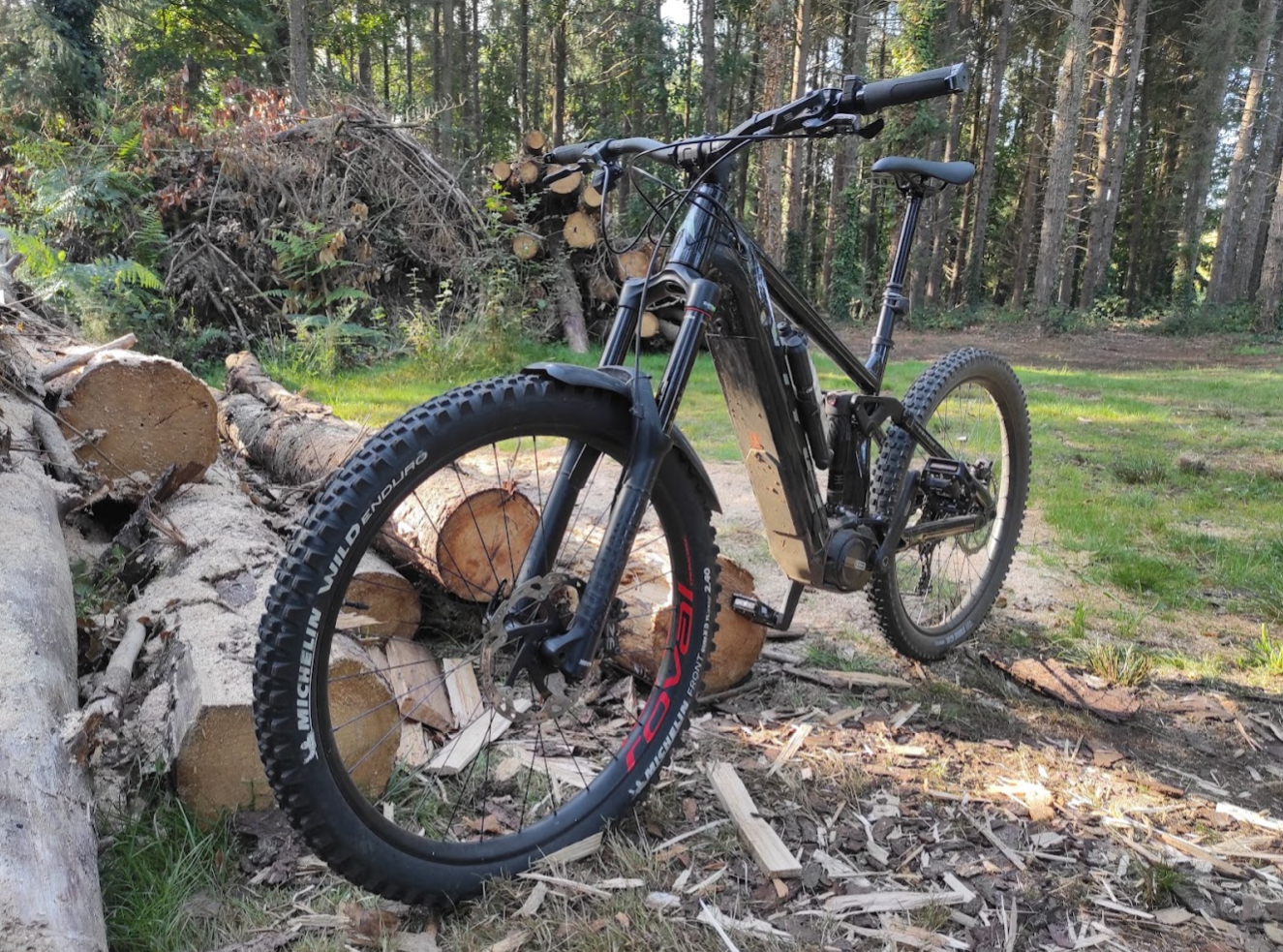

Waiting for forks, brakes, pedals, chain so quickly swapped the Lyric 180's with 27.5 on .
180/160 27.5/27.5 E-Mythique :
WOW ! What a bike ! :) Agile, flickable. Really rideable ! Those faulty Suntours are super scary. So nice to be able to ride fast on things, pop off things, drop off things, turn without the front randomly washing out.
The bike felt a lot like the Kenevo with that fork on, plus the setup was over 1kg lighter !!! Will update the fork shock thread with more info.
Plus a PR on a climb (In Race mode) - so the M510 can pull more than the Brose/Gen4.

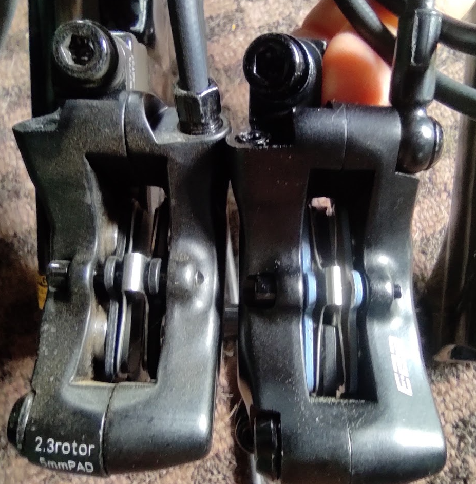

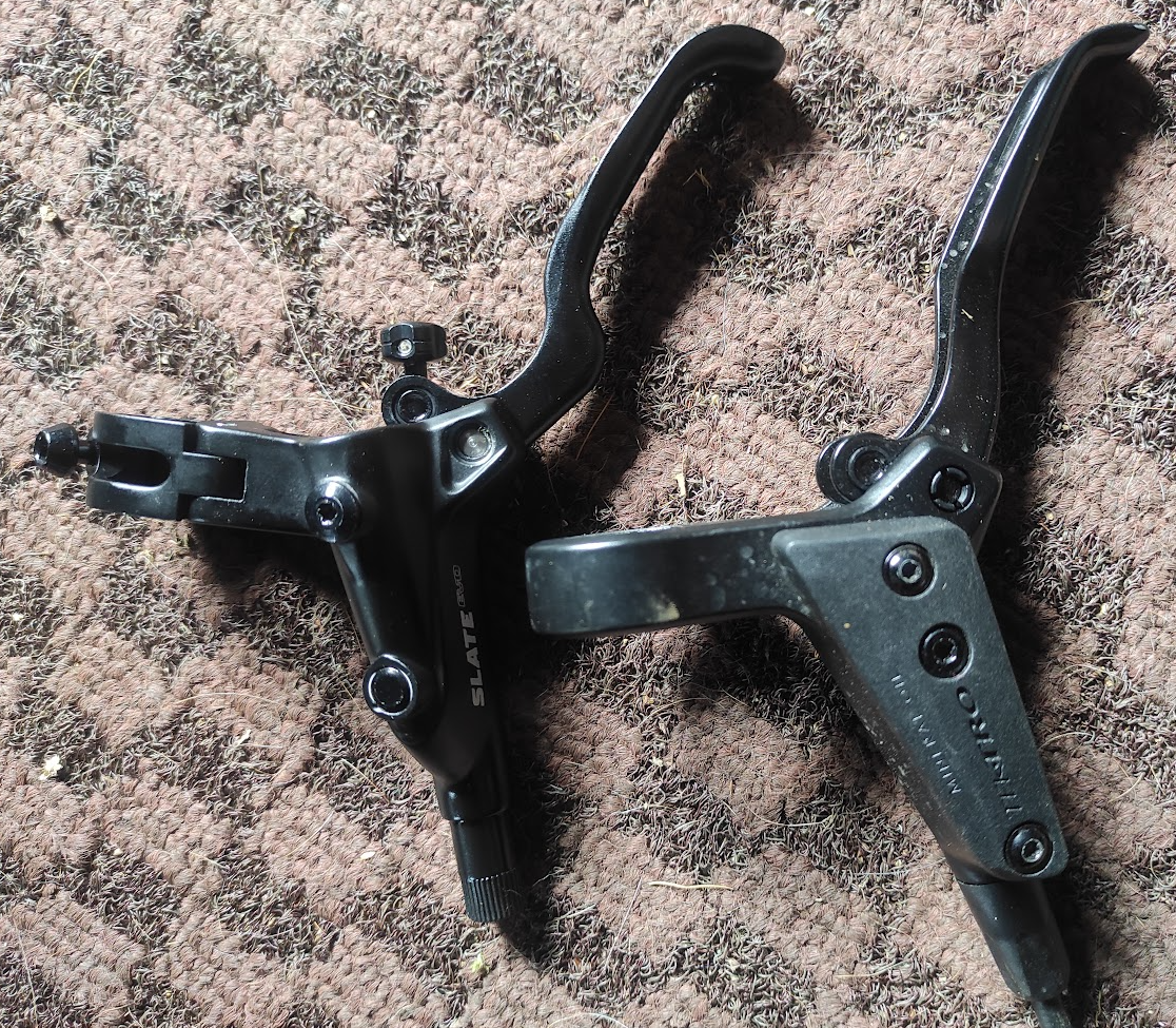

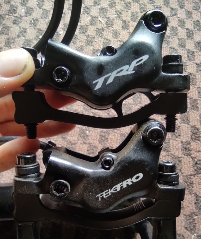

The TRP's arrived.
The TRP Slate EVO calipers appear to be virtually identical to the Tektro 4 pots apart from the brake line mounting and the right hand half on the TRP's aligning better with the left side. Maybe the oil ways pass round both sides of the caliper on the TRP's ? :
The TRP levers much more closely resemble a Zee/XT style lever, unlike the Tektro one - so fingers crossed we have a bit more power. The Zee's on the 27.5 obviously feel considerably more effective than the Tektro's.
TRP Caliper with 180/200 adapter and front hose was 224g. TRP lever is 121g.

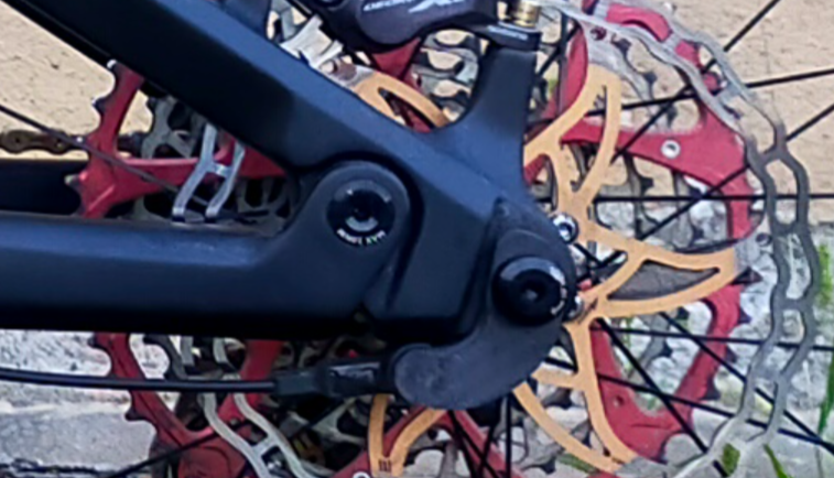

And finally...

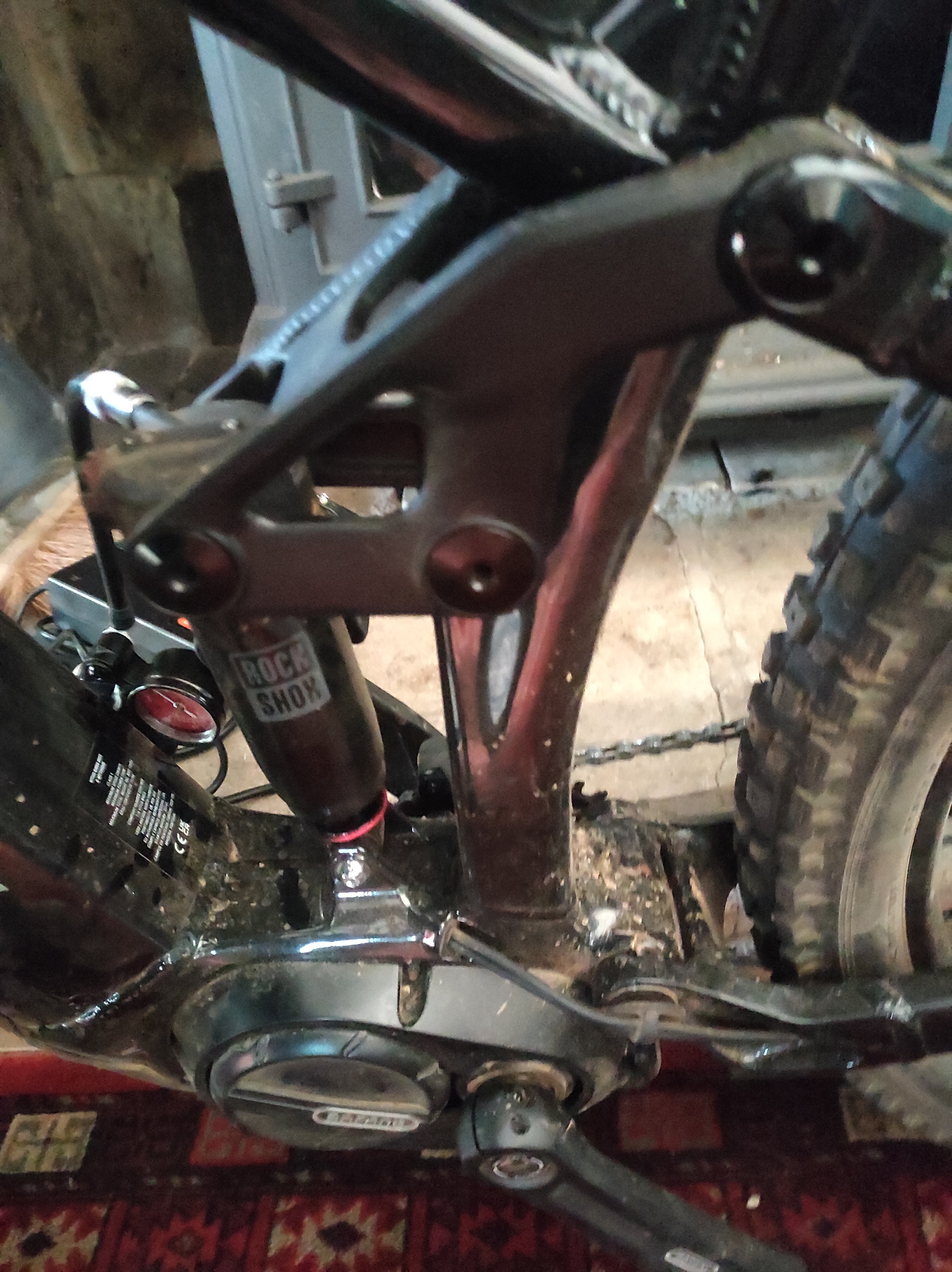

Lots of frame clearance with fully compressed rear :

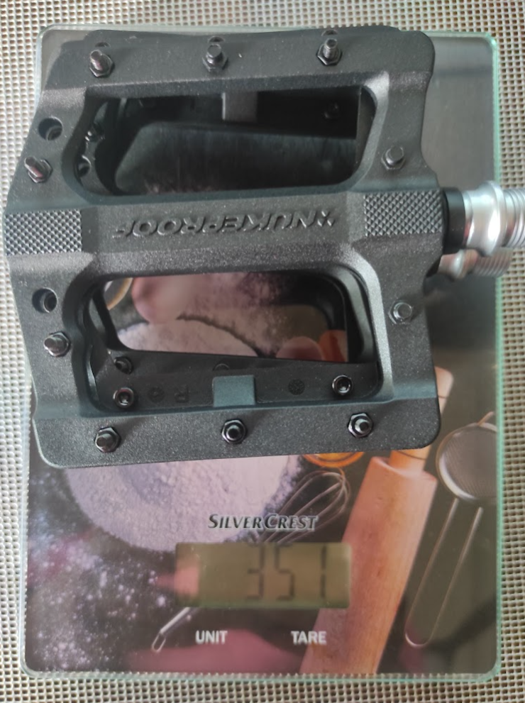

Nukeproof pedals have arrived. Never tried them before but was trying to stay Nukeproof/Vitus where possible with this bike just for the sake of it.

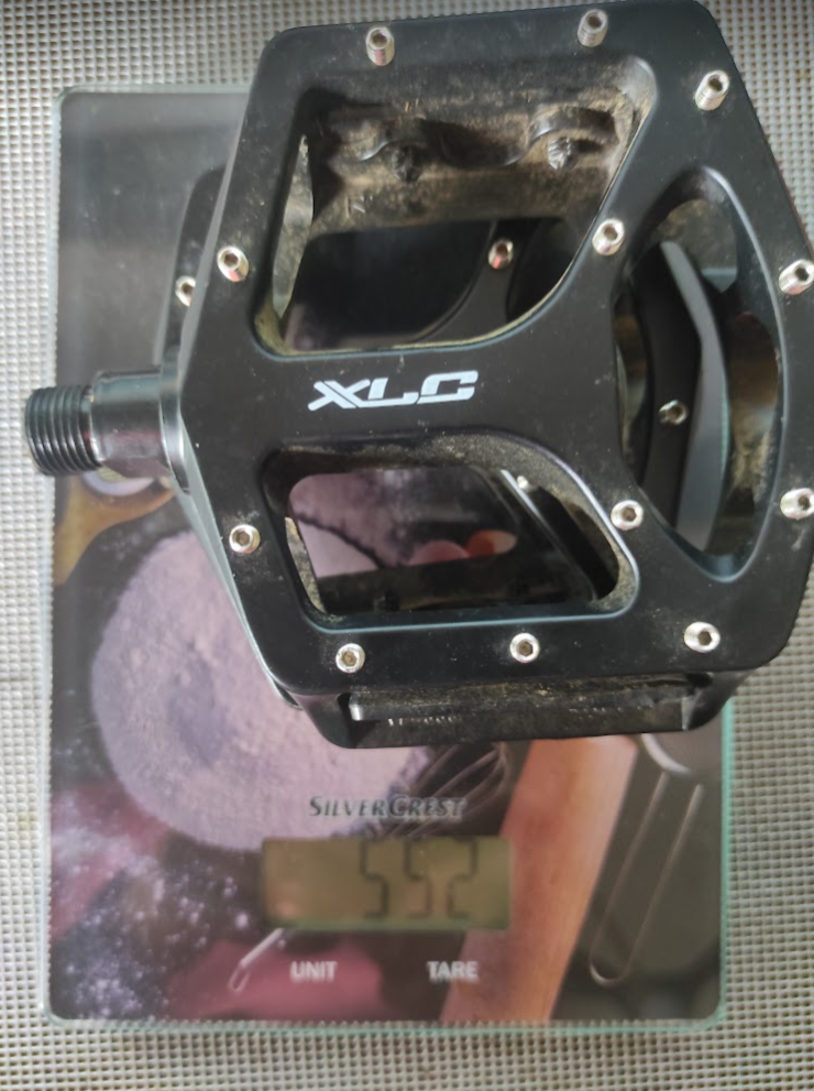

Just swapped out the Noddy XLC freeby pedals for the Nukeproof somethings (didn't pay a lot of attention).
The freeby's do work, but they're a bit clunky .. and heavy :

Did a quick weigh in. Now tubeless, lighter pedals, 4g lighter chain....., Kenevo's 180 forks/wheel/tyre.
24.7kg. Therefore, 200g more than the Kenevo with a 500wh battery and 1kg less than the Focus Jam2 6.9 150/150.

First ride today. Mostly on alphalt and no real mountainbike terrain.
The fork is just a waste of resources. Rebound seems to have infinite clicks and compression sometimes and only in one direction. The front tire seems to have better shock absorption than the fork.
I will open a warranty case. Fortunately my Fox 38 came yesterday. So I will be able to swap forks.
I definitely need to ride more to get a better impression of the bike.
