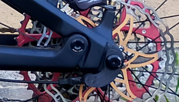

Was just having a break and being really boring thinking about weigh bias ..
The Focus, for example, is incredibly neutral in the air and off drops, it's exactly 50/50 front to rear weight bias.
The E-Mythique with the 27.5/180 Lyric/XT disk is 46.6 Front/53.3 rear (ignoring tiny rounding).
With a Fox 38 or Zeb, 29 and the 2.3 disk I think it will be about 47.5 Front/52.5 rear - so still not nose heavy.
I guess I'll just have to wait .... then ride it and see ...
