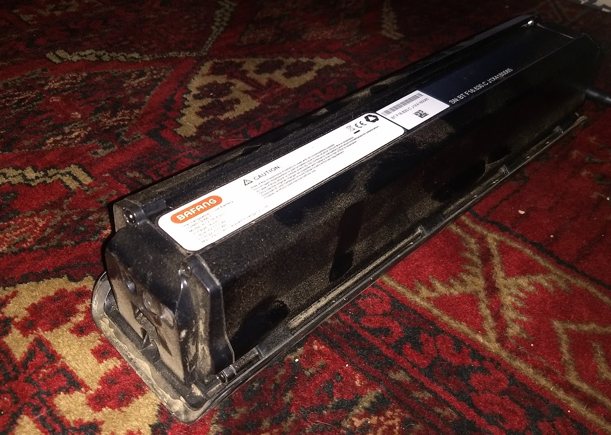

I wonder if this is a genuine Bafang battery? It has no markings that I can see but it says it fits. Makes me a little leery. I guess the best thing would be to contact one of the Aliexpress venders and see if they can get just a battery.

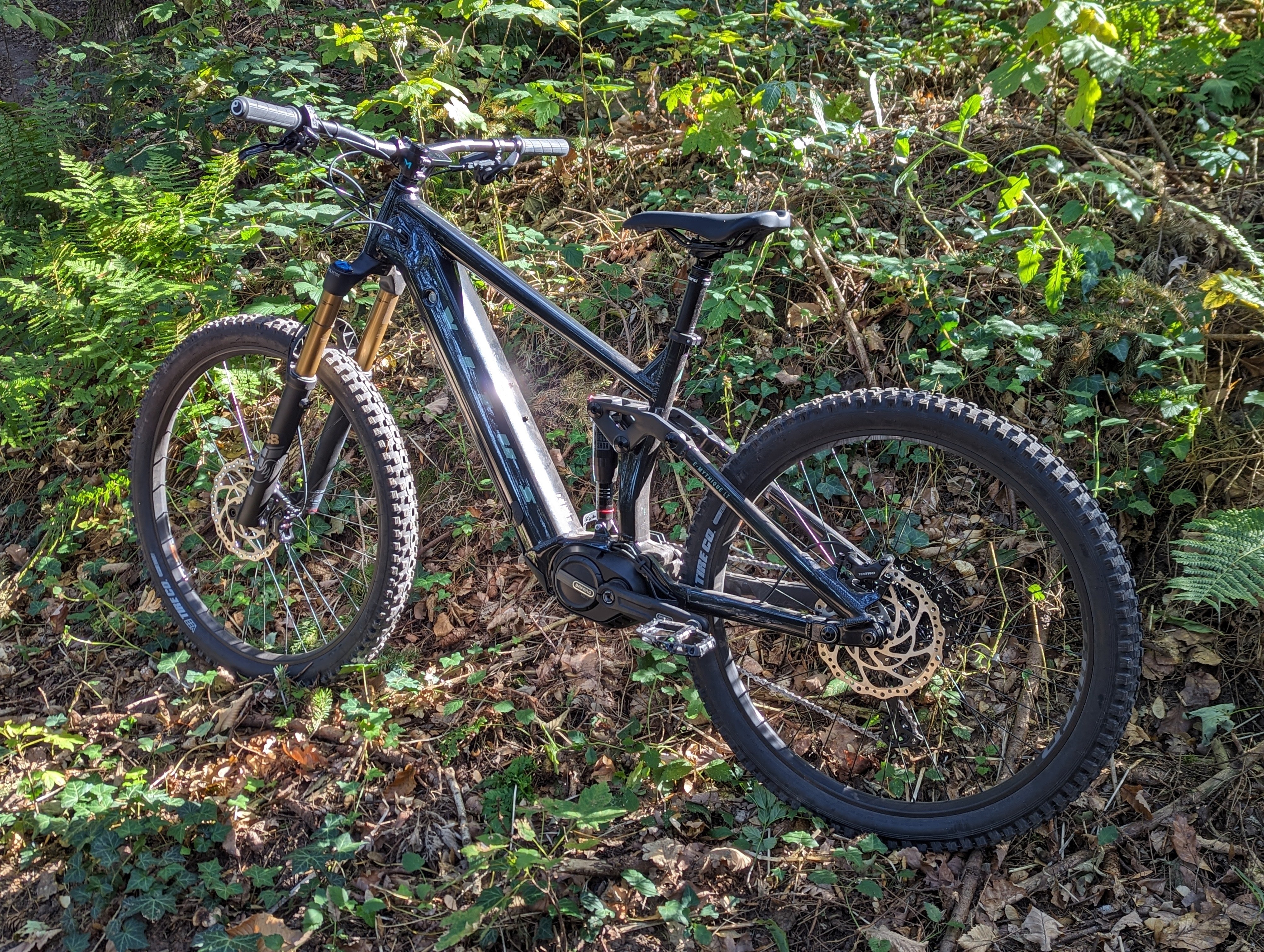

Juts put a 170 29' Fox 38 on it to replace the temporary 180 27.5 Lyric on it ..
Sits about 5cm higher than the 27.5 fork with 27.5 wheel !!!
Probably more where it's designed to be ! Only been around the garden, but feels great so far ! The TRP's with the 2.3 disks also feel better than with the XT Ice Tech disks, though still not quite as nice feedback as XT/Zee's. Just going for another quick play .. don't have much time tonight unfortunately.
Had to visit the LBS this afternoon for a crown race and star nut .. €5.30 ! so gave him 10 and said buy a beer .. It's going in tomorrow to have it's motor bolt tension officially checked as per the request from Bikester.
Was also going to swap out the bar and stem for a 35mm loamlab stem and 35mm carbon bars I had lying around (the display fits both sizes of bars, you just remove the inner rubber spacer for 35mm. The stock ones weighed in at 472g. The Fancy loamlab CNC stem and carbon bars 414g. So for 58g I decided to leave it as it is as I like the feel.
The 38's have far far better small bump compliance than the Lyrics and so far just seem super smooth off anything. Maybe not quite as poppy as the Lyric's.

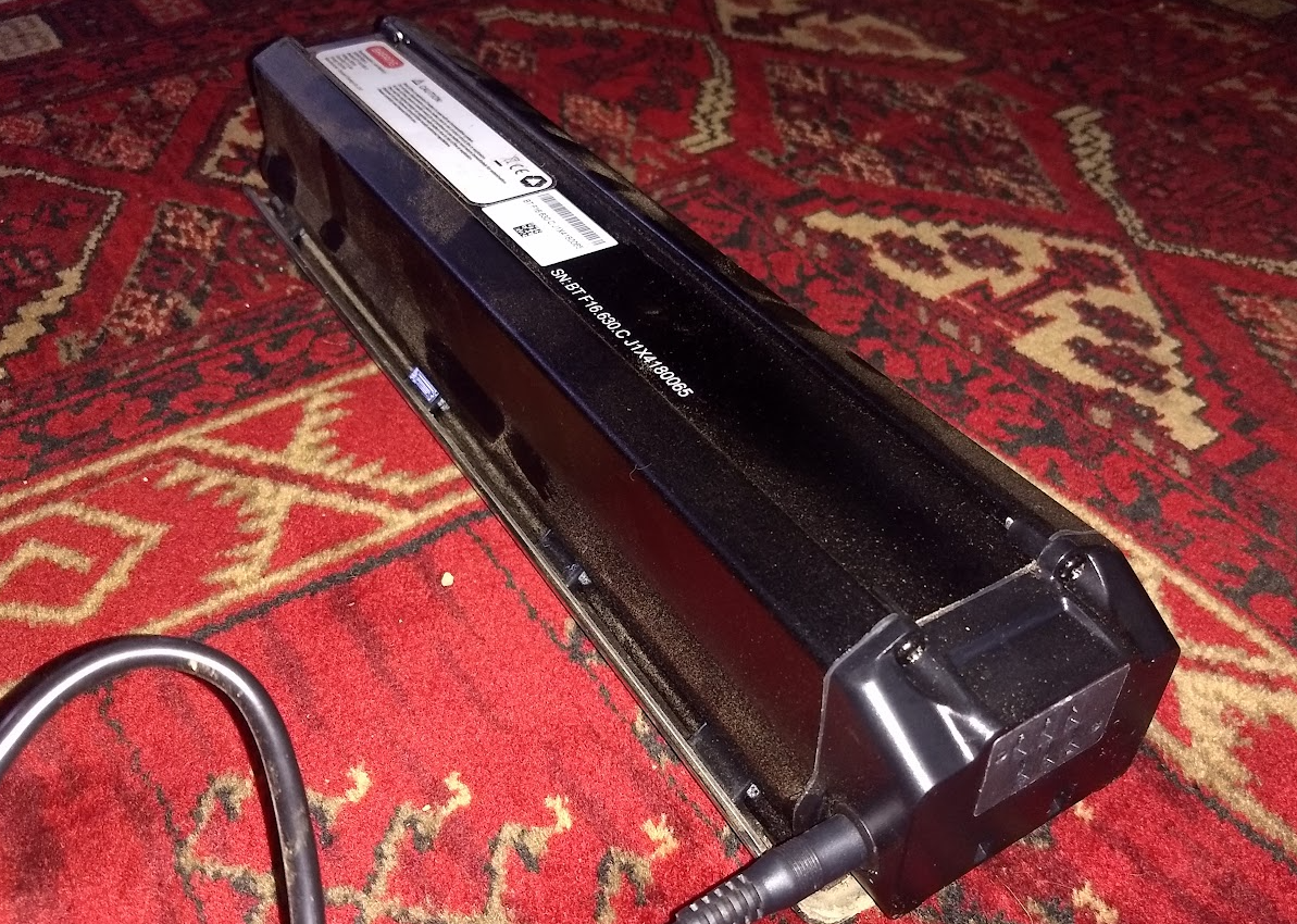

Battery hasn't been charging for a couple of days so just took it out. Randomly rotating the charging cable seemed to get it started, so possibly the connection has crap in or isn't a very good connection.
It doesn't look the same physically. Different connections, looks physically taller. I think the E-mythique is 36v too.

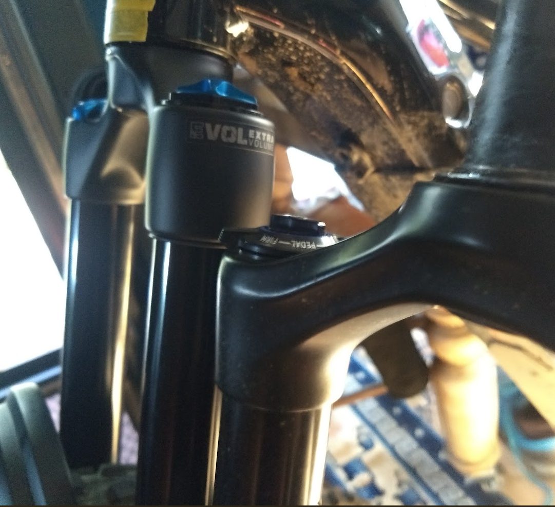

To switch back to the topic:
After weeks of only a few commute rides with my bike (because of a holiday and a combination of too much work and poor health), I am optimistic to start my project of a 'high performance bike on a budget'.
First step will be ... a swap of the fork.

I've read a few Facebook posts where people seem happy with the fork - so either they're not hitting it very hard (only low speed damping) or some of the Zeron's aren't faulty.. Mine went back, but would imagine it will be a slow turn around with it being then shipped to Suntour. Presumably, if it's working properly, it should be ok as a fork .... (or I'm making a huge and incorrect presumption - but Vitus seemed pretty on the ball with this bike so I can't see them shipping it knowing the fork was pants).
Merlin Cycles have the Fox 36 on offer, but in 160. Though I always find Fox forks generally seem to sit about 10mm higher than Rockshox.
Not sure if you could do a damper swap on the Zeron, but by the time you've invested in it, it's probably cheaper to buy a different fork.

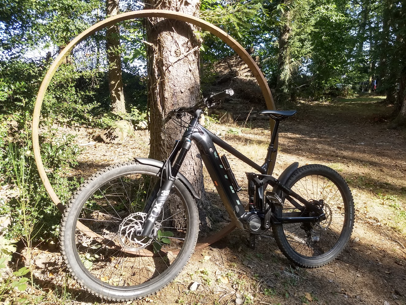

My final build ... for now anyway .. still might swap out the shock for the Fox Performance, but will stick with the stock one for the moment as so far I'm really happy with it.
Disks/Rotors .... went back to stock, they're heavier than the ice-tech but seem to work well.
Rear caliper - stock Tektro. Front TRP. Levers - TRP. The calipers performance wise and feel wise are pretty similar so you only really need a lever swap if you want more power.
Fork - 170mm 29" Fox 38 Performance GRIP E-bike spec. The Grip damper's slightly better for lighter riders and the e-bike spec means the rest of the damping is also slightly softer.
I think pretty much everything else I've put back to stock. The bars and stem feel good and aren't heavy.
Mudguards have come off the Jam2 (same bolt on RRP fits the Fox 38 with a different angle spacer).
Loam Lab grips and bar ends/tree/rock sliders with a granite tool in one side (From Kenevo).
Stock grips are super light - 88g for 2 ! (Spesh 110g, Raceface 146g, Loamlabs with ends 170g, 200g with Granite as it replaces the LL compression clamps).

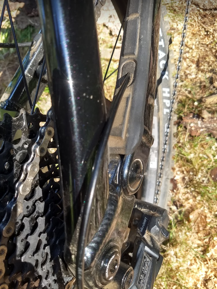

Looks like the gear cable might rub on the seatstay over time, so that want's some tape on it :

My Suntour fork is not working correctly for sure. I can turn the rebound knob as long as I want without reaching an end. So good to hear that there might be some forks which seem to work well.
I am not 100% sure, but it should be possible to travel the fox 36 up to 170mm. But this may void the warranty.

600k ... Still working :)
Loving the Fox 38's - balances the whole bike out perfectly, though still haven't abused them properly.

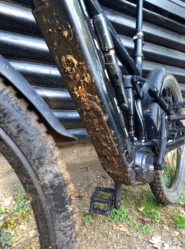

I stopped washing my other bikes a couple of years ago so this will be wash free from new. Just let it dry, brush it off, squirt it with silicone or something and wipe it down once in a while ... I can't decide if it's the bike or just me actually looking and noticing, but the downtube seems to be magnetic to crap !
This was clean a couple of hours ago.
It could also be the tyres, if you have the time to look, they seem to quickly clog and then eject at higher speeds.
