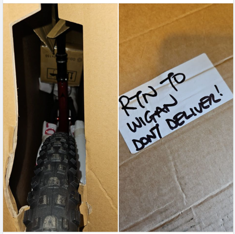

One on facebook just turned up ! With a weird return sticker on the box.
So it looks like Arrowxl did return them and either CRC has used a different courier or Arrow eventually did deliver them

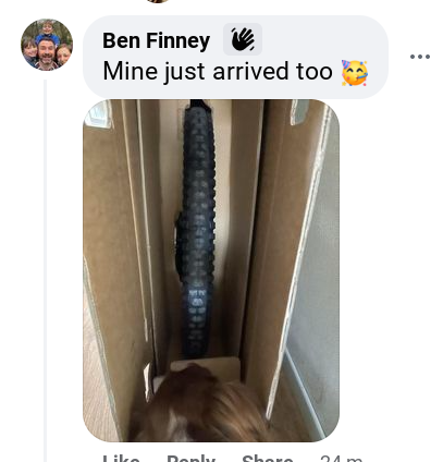

Another on Facebook
This is what this guy got before hand. The other one was also Arrow XL.

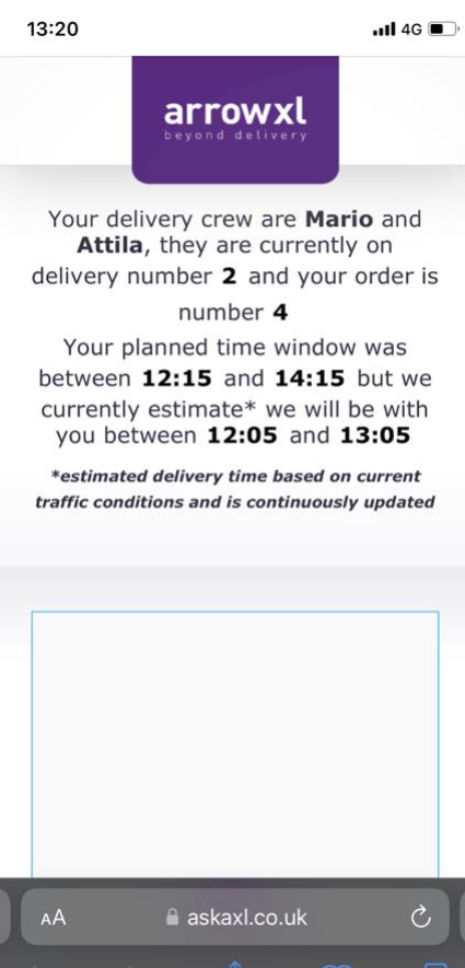

I know we’ve been through this multiple times already. But used Arrow XL we chat and supposedly rebooked delivery for Tuesday. But will keep you updated. in the meantime I have already opened a dispute with my credit card company, so not liable for any costs until I have accepted delivery. The 30% 30 day trials T&Cs stated this starts once you have received delivery of your bike.

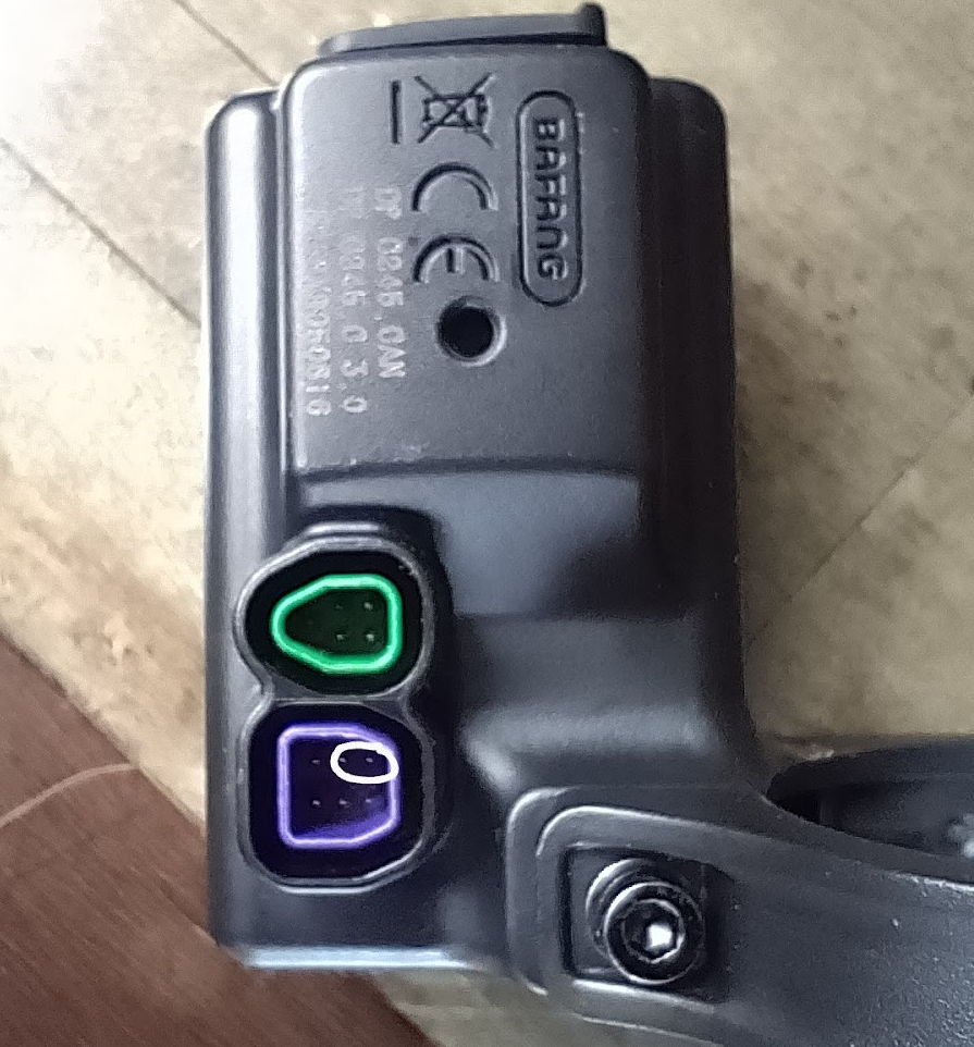

May we offer just the smallest piece of advice as we have used the M510 since it was launched and the M500 before it?
As long as both cables are firmly inserted into the back of the display screen, the next thing we would check would be the other end of the comms cable that plugs into the screen (the end which plugs into the motor).
If you remove the left pedal arm and then the plastic cover from the left side of the motor (three v small torx bolts) you will see two comms cables plugging into the motor (plus the battery cable). Try making sure the left comms cable is correctly pushed in. It is an incredibly tight fit to push it in securely and could easily have not been done effectively during the initial build.
We use a special tool to insert the cable but you could try to lubricate the plastic end of the cable with a tiny amount of liquid hand-wash (being careful not to make pins wet) and then push the cable in CAREFULLY using pliers to get enough force behind it but not damaging the cable. I am attaching a diagram showing the cable to check. Good luck!

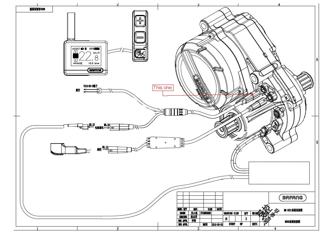

I think there is a way to power on the system with two of the battery connections, but I don't know which two. I guess you'd have to remove the bottom mount and attach a couple of wires temporarily, but until we know more ......... it's risky !
@patdam do you know if you can use two of the connections off the bafang battery mount to act as a power on button ?
The cables are all on the none drive side :
So you could drop the crank and remove the cover to check them all. I think no.6 is stuffed up the seat tube though. I wonder if this is where people get problems ? Maybe if the dropper is adjusted it might pressure the cables.
