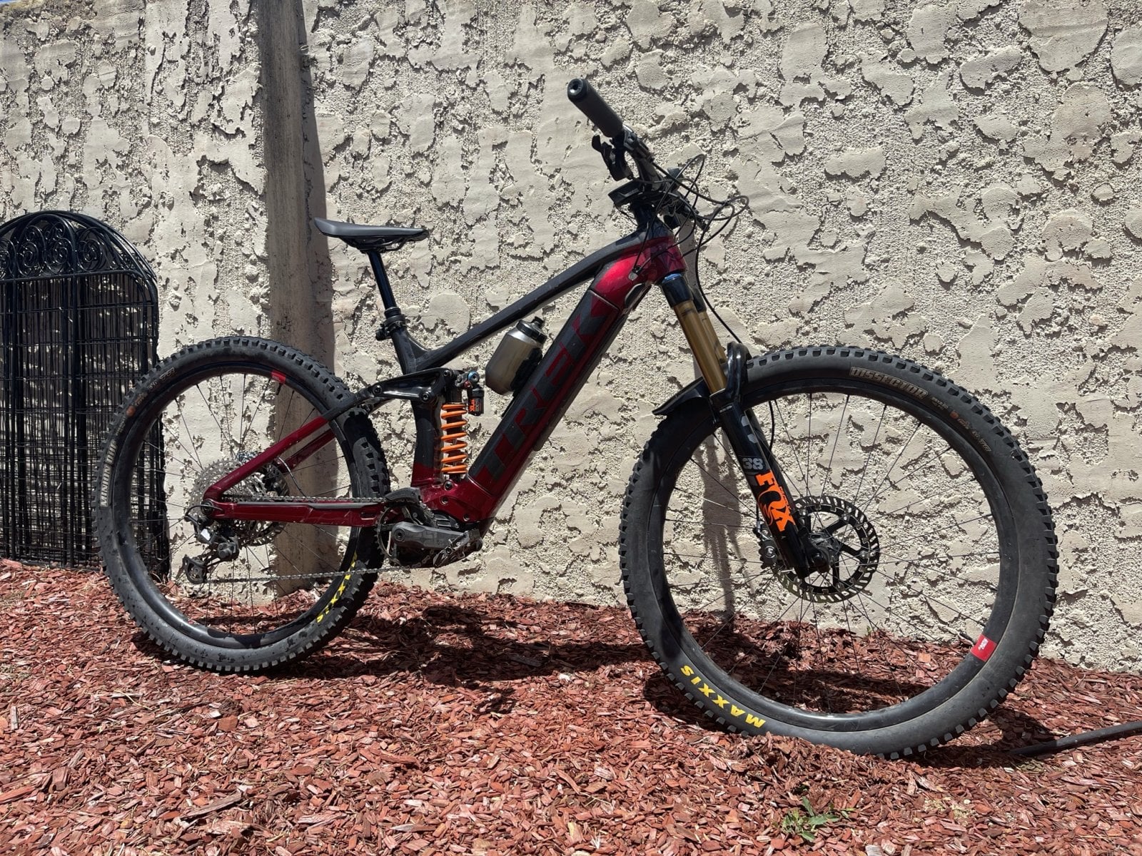

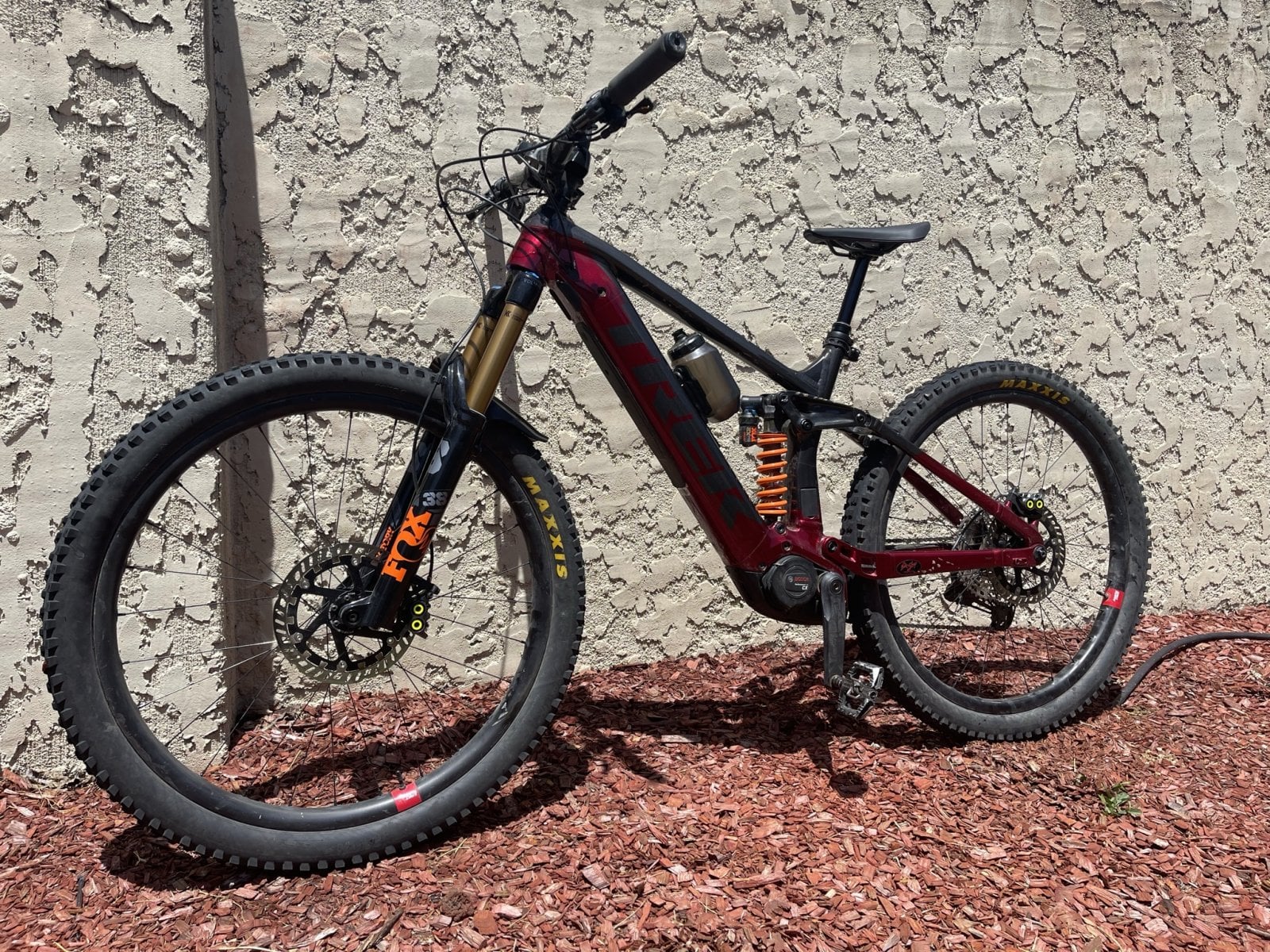

Think I'm finally done upgrading.....unless I upgrade to a Volt/Raw 9.7 frame, & swap all the parts over. Components are dialed (just need to install 220mm rotor up front).
Upgrades:
2021 Fox Factory 38 Grip2 170mm
2021 Fox Factory DHX2 230x65
Santa Cruz Reserve 30 I9 Wheels
Magura MT7 Brakes w/ 220/203 MDR-P Rotors
Bontrager Pro 35 40mm Stem
Raceface Next R 35 Bars
Crank Brothers Mallet E Pedals
e13 160mm Cranks
Kiox Display
Fizik Tempo Argo Saddle
OneUp V2 210mm Dropper
Wolftooth Fat Paw Grips
Upgrades:
Magura MT7 Brakes w/ 220/200 MDR-P Rotors
e13 160mm Cranks
Kiox Display

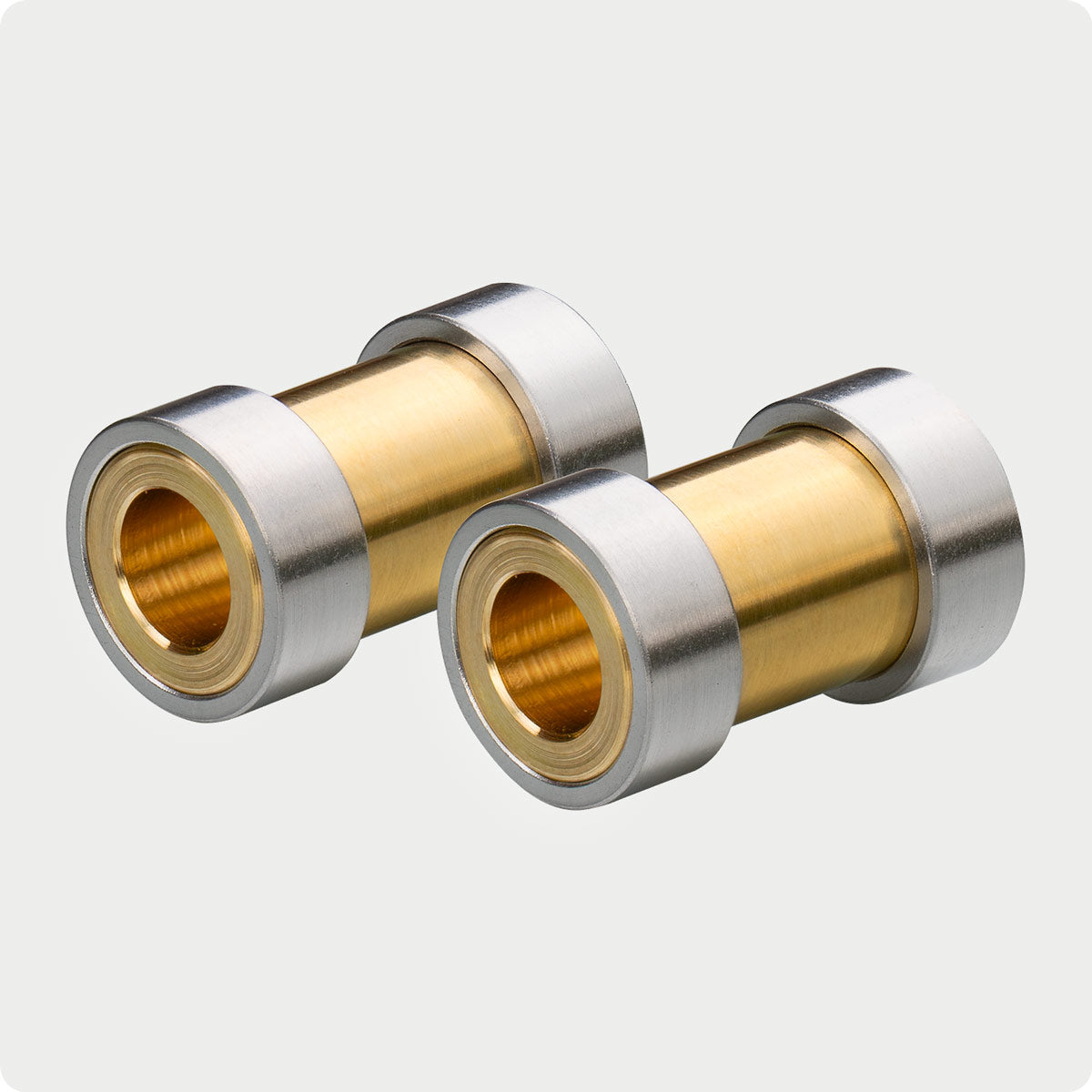

I want ot run the 2021 Fox Factory DHX2 230x65 on a large rail frame what do I need to make that happen besides the shock itself?
BiGJZ74
Mar 17, 2021
573
444
American Canyon, CA
I ordered new standard hardware from offset bushings and just installed it (I did re-use the black caps from original hardware as silver didn't look as good.). I had no fitment issues. With the spring off i Jumped on the pedals on no resi or seat stay contact on a large Rail 7. Shock Bushings | Trek Rail
