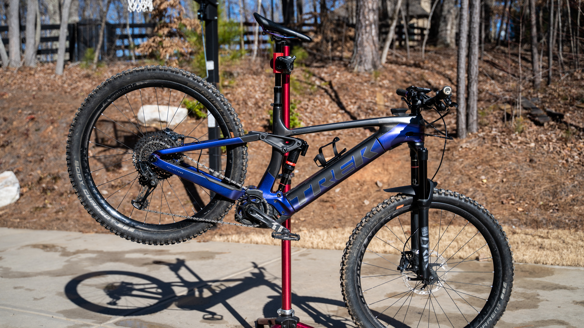

Upgrades on my 9.8
Schwalbe Eddy Current Front and Rear
Matte Invisiframe
Bontrager Carbon Bars
Bontrager Carbon Wheels with the 105 upgrade
Ergon GA2 Grips with Oil Slick
Ergon Enduro Comp Saddle with Oil Slick Rails
OneUp Flat Pedals
To Do:
170mm ZEB
Coil Rear Shock
Magura MT7 Pro's or Hope Tech 3's
Might swap out the wheels to I9's...

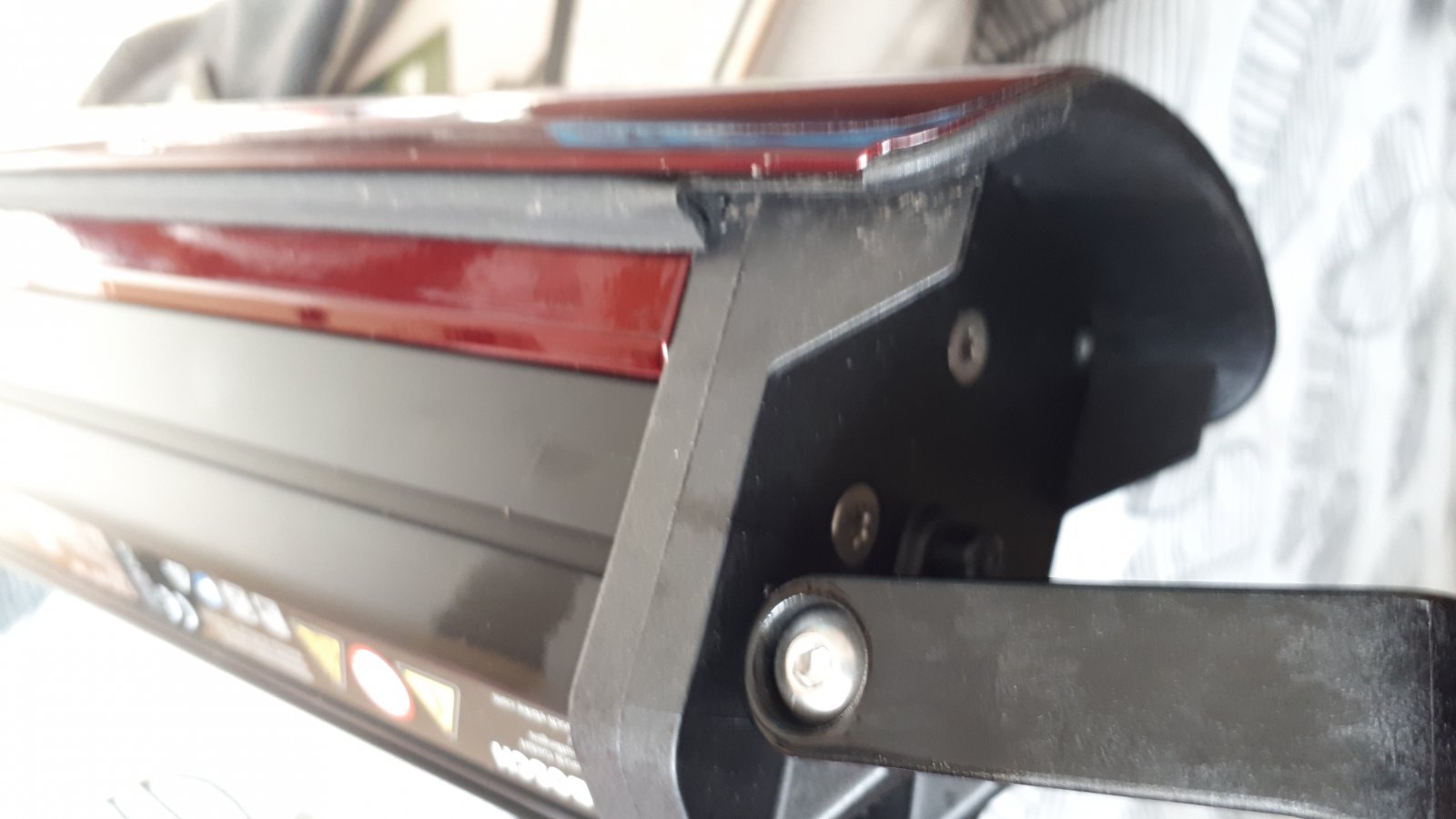

Changes / upgrades to my Rail 7.......
Invisframe
Charge Spoon Stealth saddle
XT SPDs
60mm stem (stock is 50mm)
Maxxis DHFs fitted front and rear
Mudhugger FRX front guard fitted to front and rear (back to front on the rear...if that makes sense!!)
Trimmed bars to 760mm
108 hub upgrade
Fitted 'P seals' to battery to fill the gap between downtube and the battery cover
Lovin' this bike.....
Jubby
Aug 23, 2020
50
36
Langley, BC
Invisframe
XT SPDs
108 hub upgrade
What are "P" seals?
