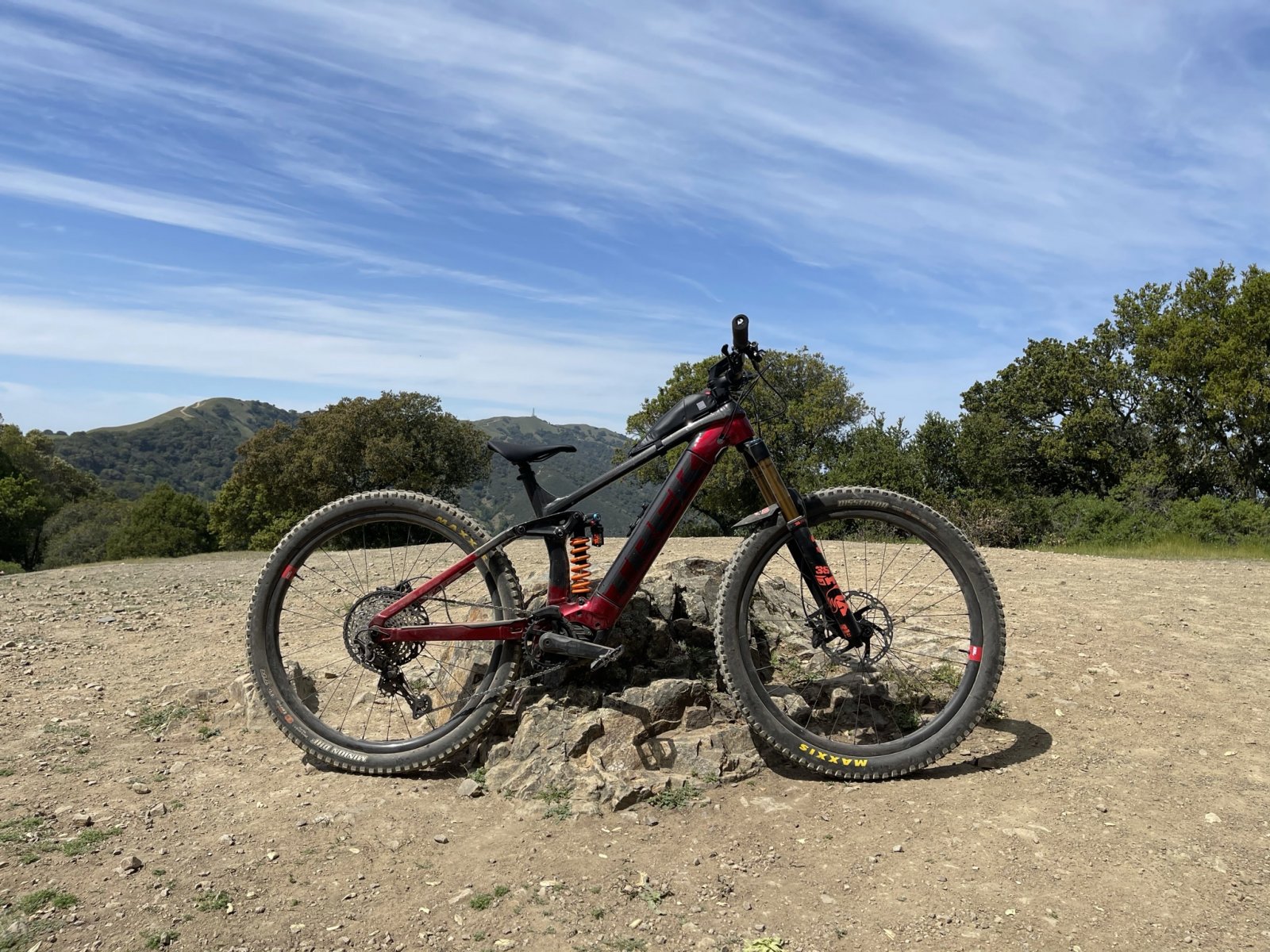

Added a 230x65mm 21' Fox DHX2 to my Rail 7. Feels amazing and at this stroke....not to linear.
