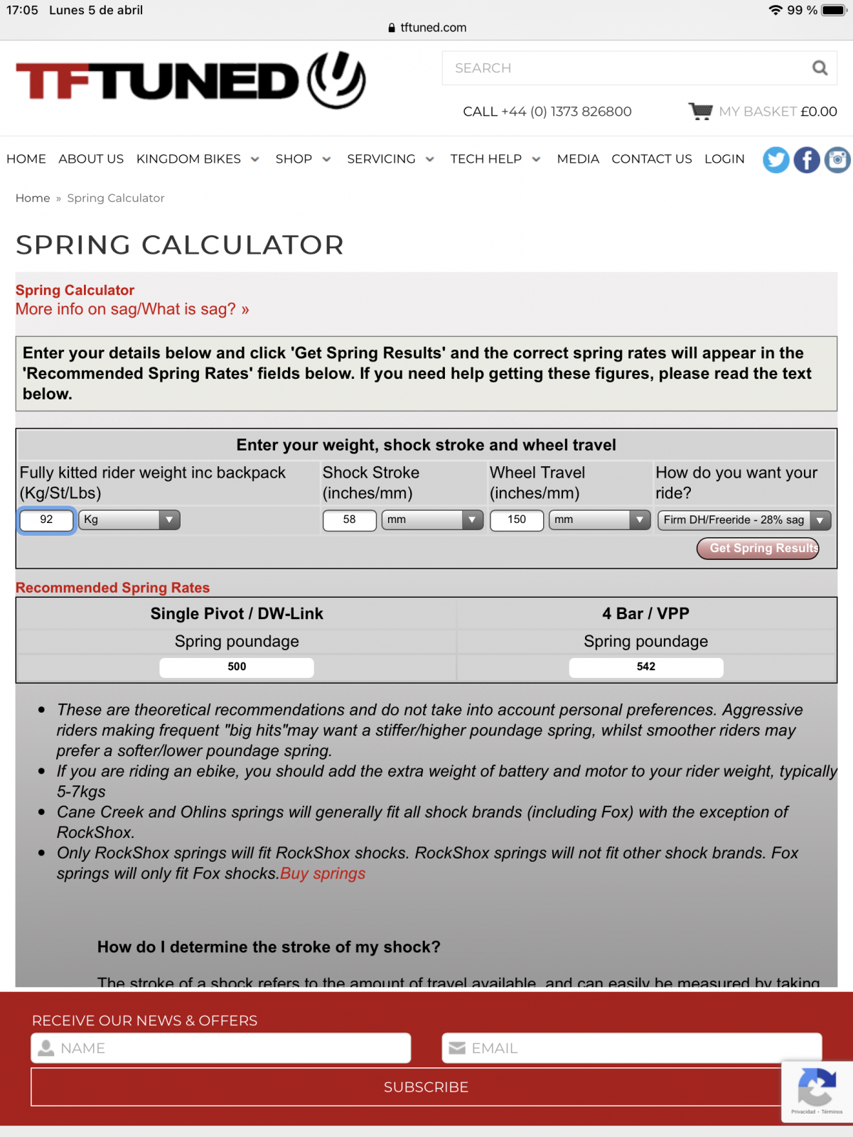

Hi guys, i have a doubt i bought a DHX2 shock with 500lbs of the spring. My total weight is 85kg and i changed the spring to 550lbs but i'm not sure that it is enough to avoid bottom out, can you help me? i' m open to receive your suggestions
Many thanks
Slide the bottom out bumper up to the top of the shaft then use it to test ur sag. What stroke is ur shock?
Many thanks
Here you are:
magic82
Nov 18, 2020
13
italy
Hi, my shock is 230x57.5, for the spring I used the Fox spring calculator, the SAG is about 27%. the bumper gets to the bottom.

TFT's Spring Calculator says 400lb is ballpark for your weight, have you checked the sag or are you going off feel?

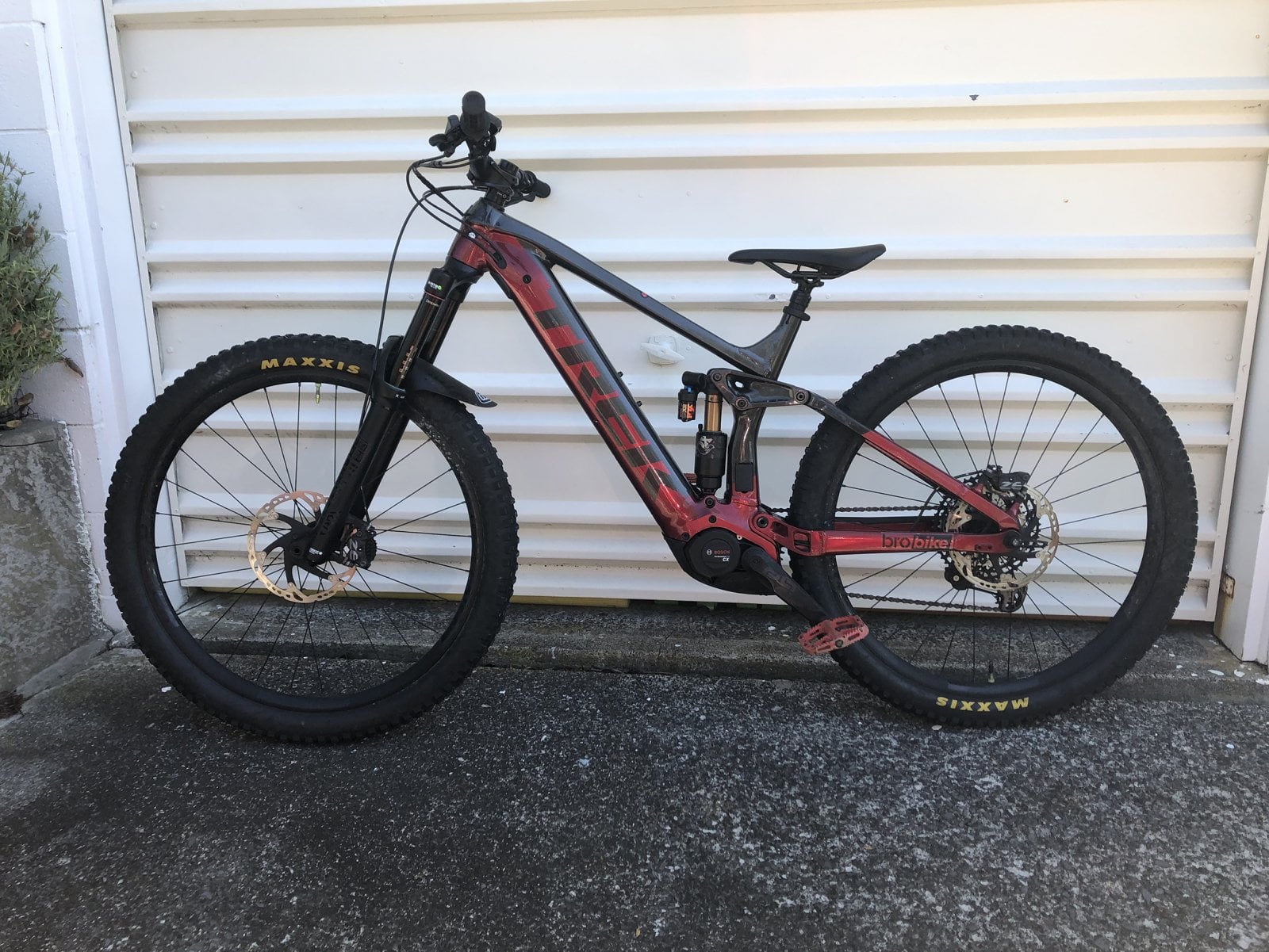

Is anyone able to confirm if a Rockshox Super Deluxe Coil will fit my Large Trek Rail 7? My LBS can’t confirm it and they don’t have a stock to try. Cheers!
I've seen it been posted before that the Resi on the SD coil hits the frame but i'm not sure if i've seen pics. Good luck, I have one on my Evil Wreckoning V3 and love it

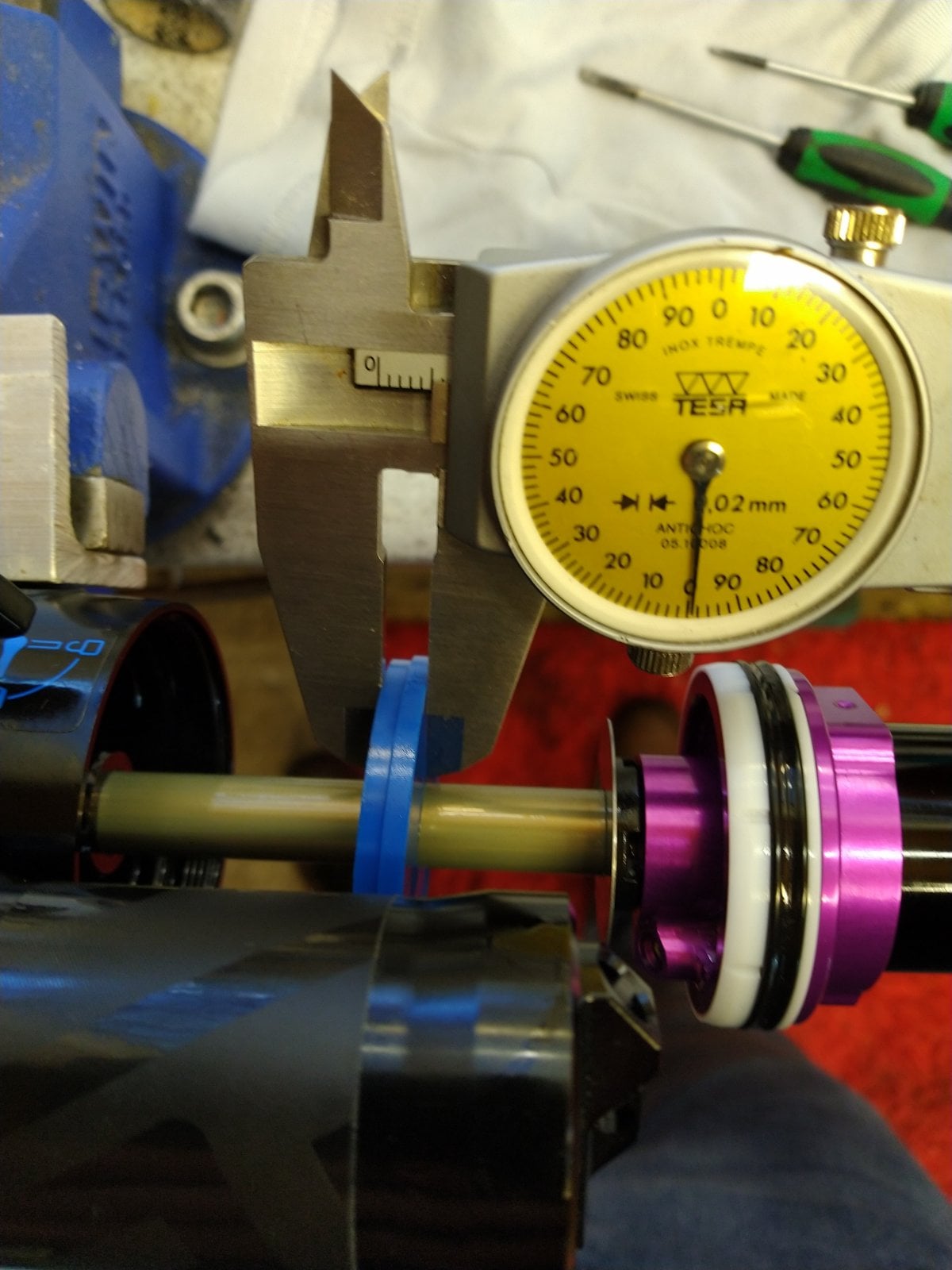

Hello Rob,
Did you manage to increase RS Deluxe stroke to ~62mm along with 170mm ZEB upgrade ?
How does it feels? :) recommended ?
Cheers
I did, works just fine, although on my medium I need to run the minolink in high to get clearance at bottom out. It's not a problem as the extra sag and 170mm forks offset it slightly. I'm running the sag O ring at about 33% and it feels great.

Thanks for the prompt reply :)
Is it easy to change the shock internals (I have some knowledge ....)
Any tip for it?
Cheers,
You don't need to change the internals, just remove the air can (you'll need a thin spanner to get the yoke off) and CAREFULLY cut off the blue spacer on the damper shaft. Remember your sag gradients will now be off, so lower your air pressure accordingly.
