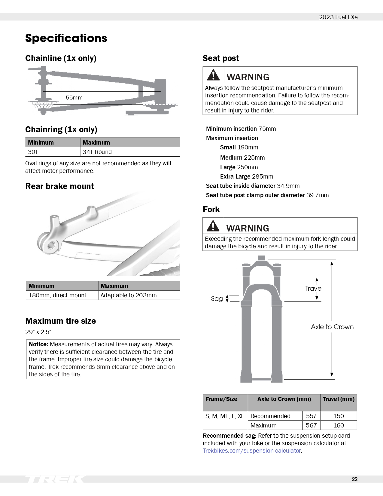

Interesting. On the last page on max fork length, the diagram has a sag measurement. I read this as the allowed length of the fork in the sagged position. Then they state the measurement to the crown as a recommended max. Not clear to me what the actual number is. Somebody have another angle, so to speak?
JP-NZ
Feb 17, 2022
1,195
911
Christchurch - New Zealand
For all Fuel EX-E
Recommended fork travel = 150mm
Maximum fork travel = 160mm
Sag has nothing to do with those lengths
volts
May 15, 2018
343
266
DK
For all Fuel EX-E
on mtbr forums a trek representative mentioned the exact axle to crown measure and even a zeb @ 160 comes 3mm over that and void warranty according to him.
