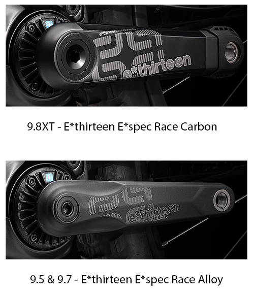

My 9.8 XT had the alloy cranks (Australia).
I had to get the dealer to put a claim in. I chose to get a $400 refund. I could have waited for the e thirteen cranks or they could get Praxis straight away
Piss pore that they don't let you know, and probably hope you don't notice.

9.8 buyers beware! Some of these bikes, mine included, have been fitted with the much lower spec and price alloy cranks in lieu of the carbon cranks listed in the spec sheet. The store was unaware of this and said Trek headquarters stated that there was a long lead time associated with the carbon cranks and they did not want to delay release of the bikes. I can totally understand the reasoning behind this and am pleased my bike was not delayed, however it is pretty piss poor that they did not notify customers of this and proceeded to charge them full price.
I suggest that everyone who has received or is expecting a 9.8 or 9.9 check for this as I have seen pics of other 9.8 bikes with the alloy cranks.
Aside from this I am absolutely loving the bike, perfect in every way and have no regrets switching from my Ibis Ripmo V2.
Yep, I got those on my 9.8 but I noticed it and they swapped them over once they had them in stock. Took about a week to get them so no issue really.

3 options
1 - request a refund of the price difference and ride the alloy's
2 - wait 6-12 months for stock (lead time unknown)
3 - purchase from a retailer with stock (not many), wait till they arrive, have LBS swap cranks, request full refund for cost of carbon cranks. Probably best to have the LBS agree to this prior to proceeding.
I went with option 3
Trek should send out the carbon crank to replace the alloy crank on bikes that have already been delivered. That is what Orbea did. Oh wait, it’s been six months and still no crank from Orbea.

Looks like maybe $300 difference in price between the carbon and the alloy cranks retail . $300 to save 6/10 of a pound in weight, works out to about $500 a pound.

I also have the alloy crank arms instead of carbon and wasn’t informed. Thanks for the earlier post on this and I’ll speak to the Trek store and report back the response.

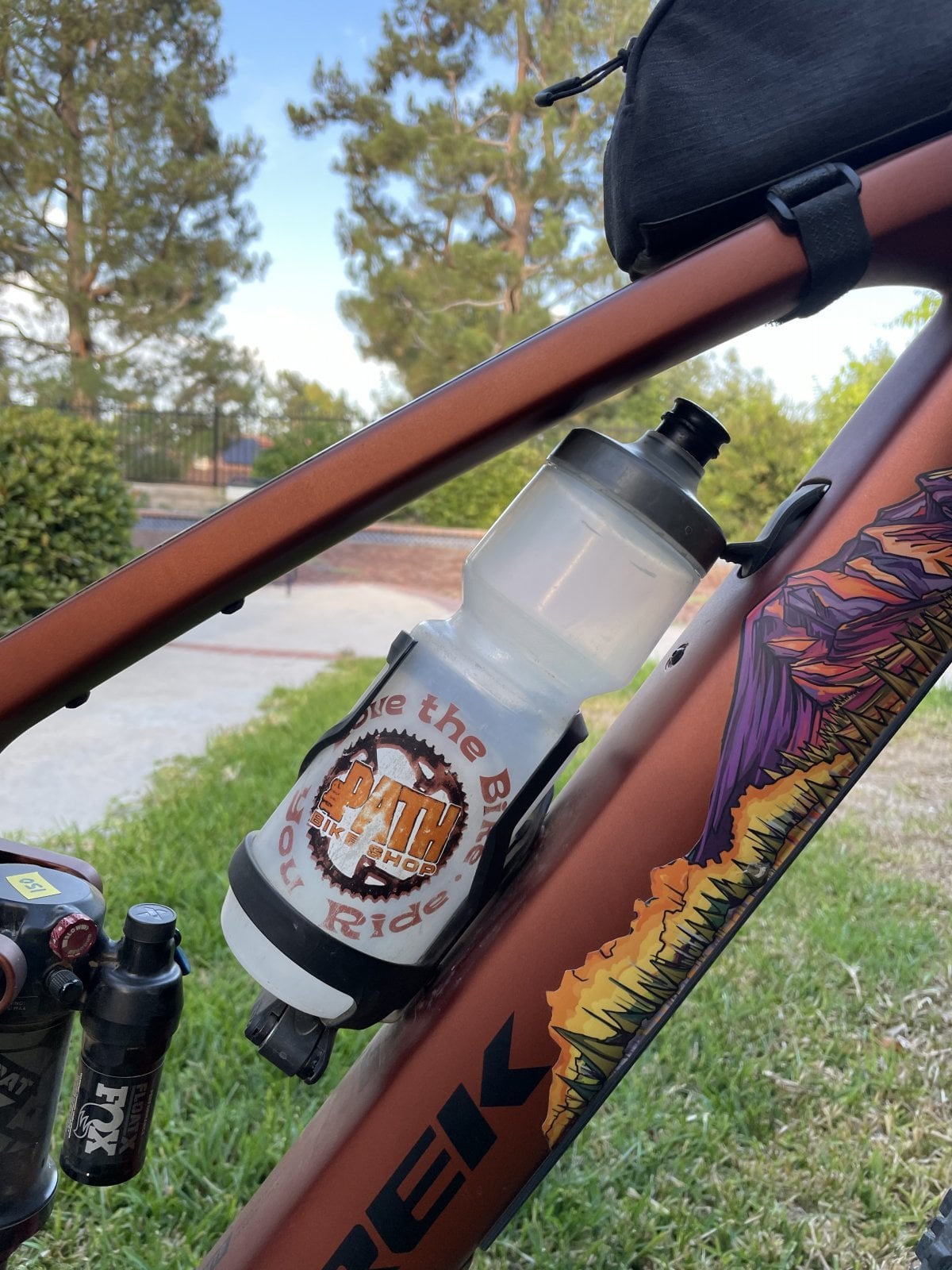

Has anyone confirmed a 26 oz / 750 mL water bottle fits in a size Large or smaller frame? I can do most of my non-eMTB 2-3 hr rides on that. A 22 oz / 650 mL bottle is not quite enough in the summer.
The issue is more that on very long rides when you need more water you might also need the range extender. Another first world problem.
I use this 26 oz. bottle on my Large Fuel EXe. Mrs levity's Small will only accept a 20 oz. bottle.
As mentioned by @R2thek longer summer rides require a fanny or backpack with bottles or a bladder.
