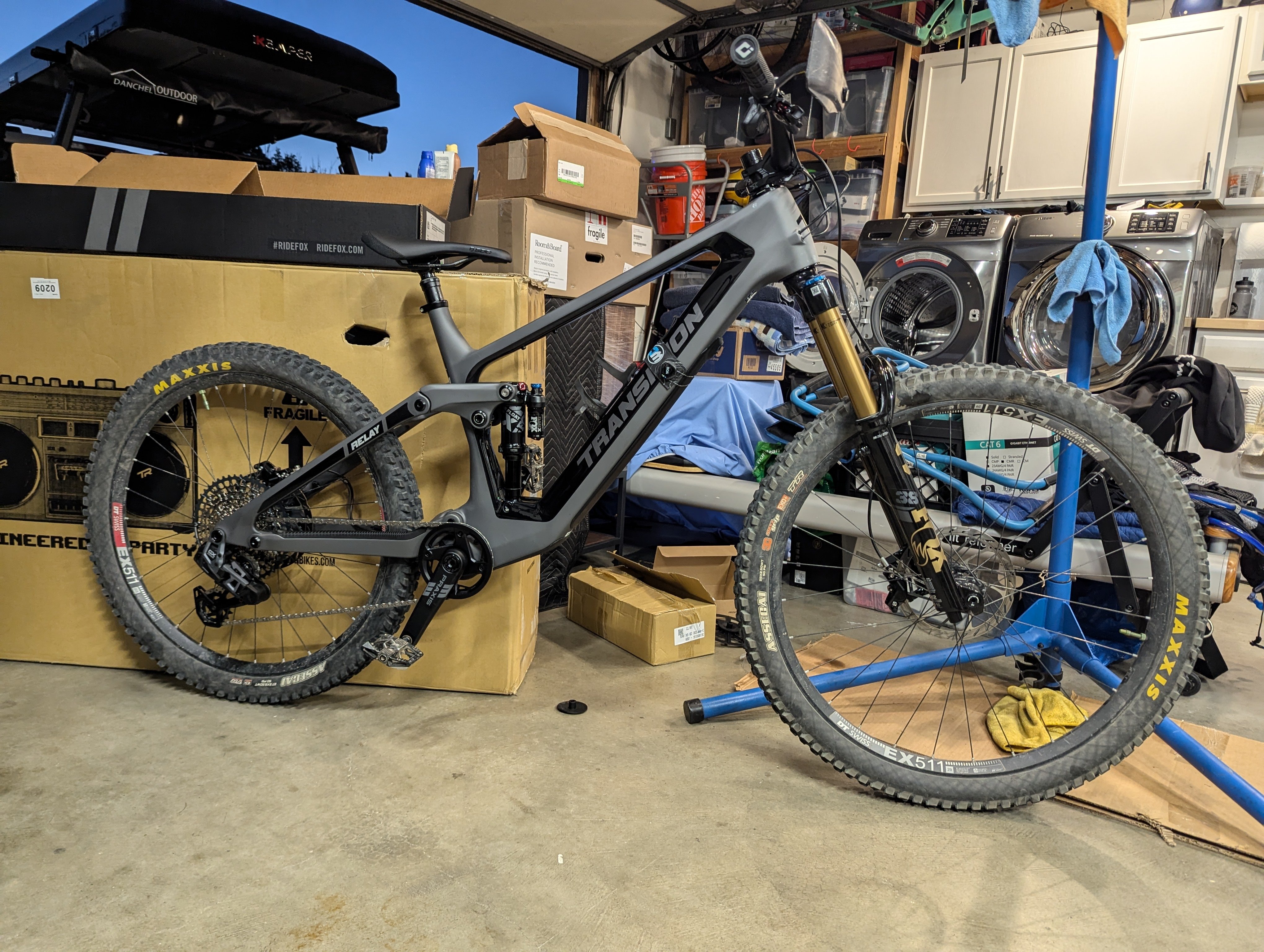

I just picked up a carbon gx axs build myself. Swapped it over to mx, swapped the 36 for a 38 grip x2. More mods and fiddling to come. Coming off of a long shocked, cascade link mullet orbea rise with 160/160 that's done tons of miles. Stoked to ride this thing and super stoked that it's the same geo and fit to my nomad 6.
What’s your height and what size did you go with? Thinking of doing the same
ebsocalmtb
Sep 29, 2021
247
277
Southern-Cal
I'm 6'2", 33" (ish) inseam and 175lbs. I bought the XL, it's definitely a large bike, but fits me pretty well. It's nearly the same geo numbers as my nomad 6 which fits me like a glove. I will likely put a works components 5mm reach adjust headset in it to shorten the reach down to 497ish so the fit is the same as my nomad just for consistency of feel/font center / rear center ratio on my hardest hitting bikes.
