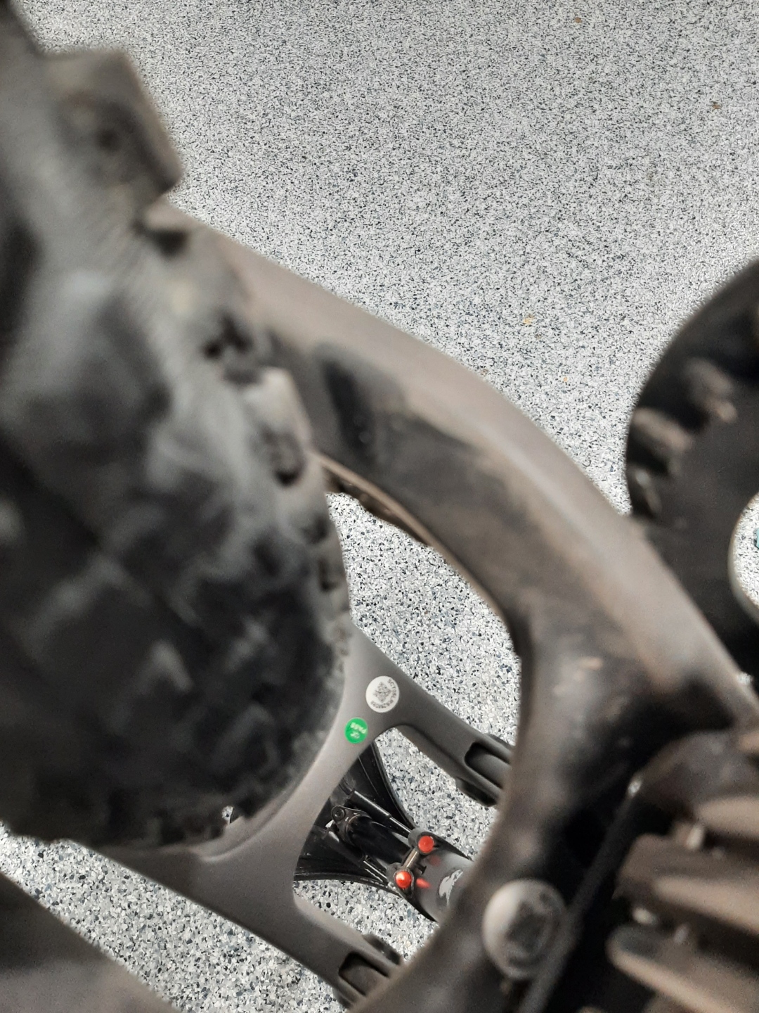

Couple of other notes:
1) So it has been record breaking heat here in Central Texas. 107' is common, with the heat index it's about 115' Fahrenheit. The trails here are also very chunky, especially the ones I ride. They are also steep but not for long. As much as the heat kills me, I've been riding anyways. My Relay has had a shutdown problem and it generally happens after very steep climbs about 1x per ride. It's always the same situation, I climb in the 'rocket' mode but still work my butt off. Typically, these climbs are only 2-4 minutes but it's very steep. 1st gear, rocket mode, me pedaling pretty hard. I'll get to the top and basically collapse because of the heat and when I sit there, the lights will shut themselves off after about 1 minute. Pushing the button will not restart it, but pulling the battery will. Now my motor and controller were all replaced under warranty, but the problem remains. After discussing with Transition, we agreed that the motor is overheating and shutting itself down, If I had say kept moving but maybe under less stressful conditions it might not have shut down as it might have gotten some cooling. I guess when Fall arrives I'll know if this problem still occurs. Don't feel too bad for us, it'll be between 50-85' for the other 9 months of the year.
2) My Relay has a stiff Downhill rated rear rim, a 27.5 x 2.5 DD Aggressor rear tire & an insert. Also, I'd consider my terrain so loose and rocky that it's a bit hard to really 'load' a tire really hard. But either way my rear tire rubs (harmlessly from what I can tell) on both sides of the swingarm. Picture attached. View attachment 123066
I did a chunky G-out and my rear rim became so loose that it was wobbling.
This wheel had been built especially for this bike by a local shop but the spokes had become quite loose.
Point is that I don't think this wheel/ tire would have rubbed the Relay chainstays if I had not had a wheel loosening up like this.

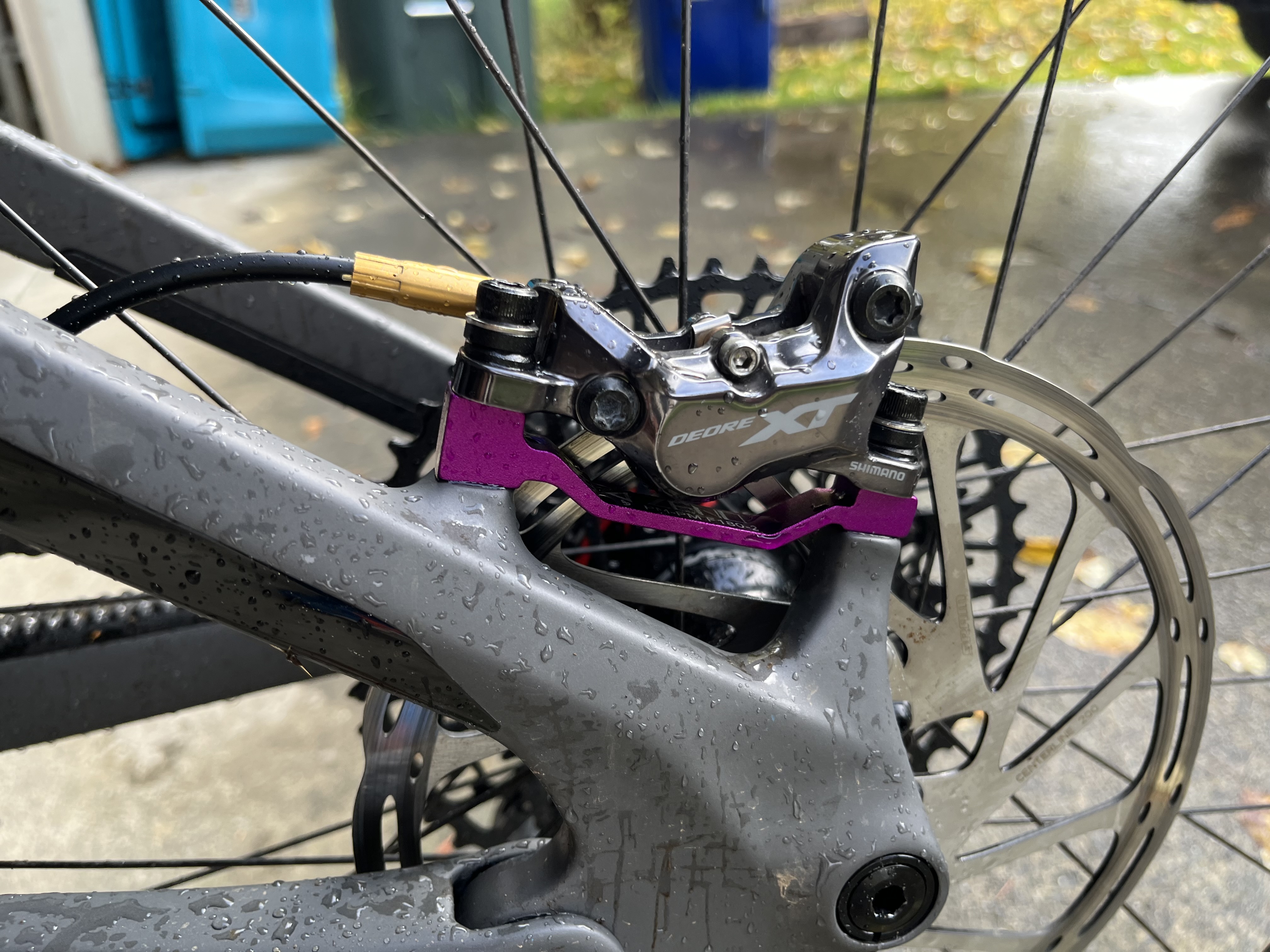

Any size small owners actually able to fit the fidlock bottle without the shock hitting it? Hell, it seemed just as likely to fit a regular one as this thing.
Also did brake swap from TRPs to XT 4-piston for my wife. Was a bit frustrating, because I didn't want to separate chainstays/main pivot. But eventually got it and put back together. (luckily I love the TRPs)
Talked with Transition and their customer service sent me this guide, which others may find helpful. I just copied it from his into my Google Drive since he had it restricted even after trying to share it.
Next up will be swapping XO Transmission for Shimano setup. She is a Shimano girl caught in a SRAM world. And maybe fork decals.
Oh yeah, have to order another set of these brake adaptors since these were supposed to be for my cyclocross bike.

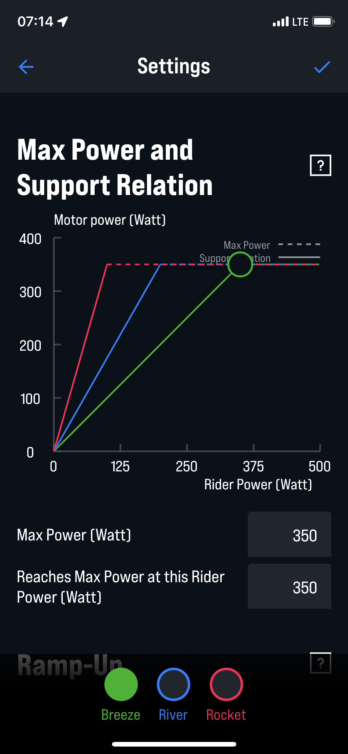

Hi, my wife is looking at getting a Relay and we've been trying to find out how easy it is to swap between mullet and 29r setup in terms of the motor/software. Is it easy to change the settings if you swap wheels and how is it done? Been looking online but can't find an answer.
Thanks, Paul
Suns_PSD
Jul 12, 2022
530
455
Austin
It's only a 1 mph difference in the assist cut off speed if you are running the 29er set up but with a 27.5" rear wheel.
Only a Fazua dealer has the software to make the change.
