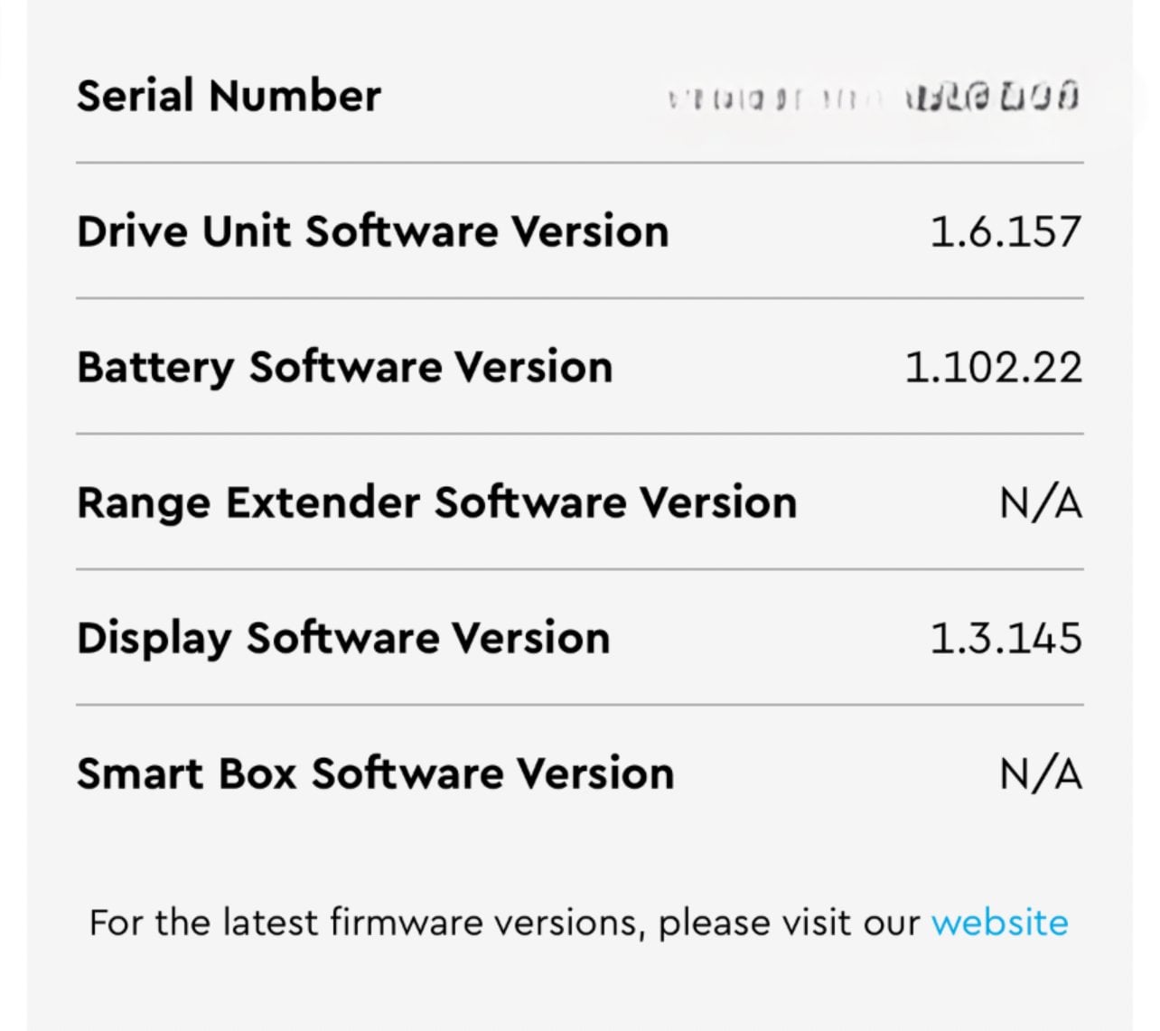

Today there was an update for the TQ app on iOS available.
New features are
  1. ability to read and show firmware versions of all TQ components on the bike (motor, battery, display, range extender, smart box) and
  2. in the tuning section you can now set a speed limit in addition to your other support values.
Slowly, but still progress.

New features are
A short update to the practical use of the new features.
On my wife’s bike which had all TQ components updated to newest firmware end of November 2023 the new features do not work. :confused:
From a small pop-up tip I learned that the TQ components need to be on the latest available firmware for the new app features to work. Checking the TQ website I found much higher version numbers for all main components than the ones installed in November.
Last week I have sent an email to TQ support asking whether there is any other significant improvement to justify paying my LBS for another update after only three months.
No answer yet.
Does anyone here know what has been improved with the recent motor updates?
One more fun fact: On the new screen showing software versions the first item is the motor serial number. That can be read and displayed even with the older firmware. But, as soon as you turn the motor off, the info vanishes from the app. It is not stored and so you have to take a screenshot for later use. Modern IT!

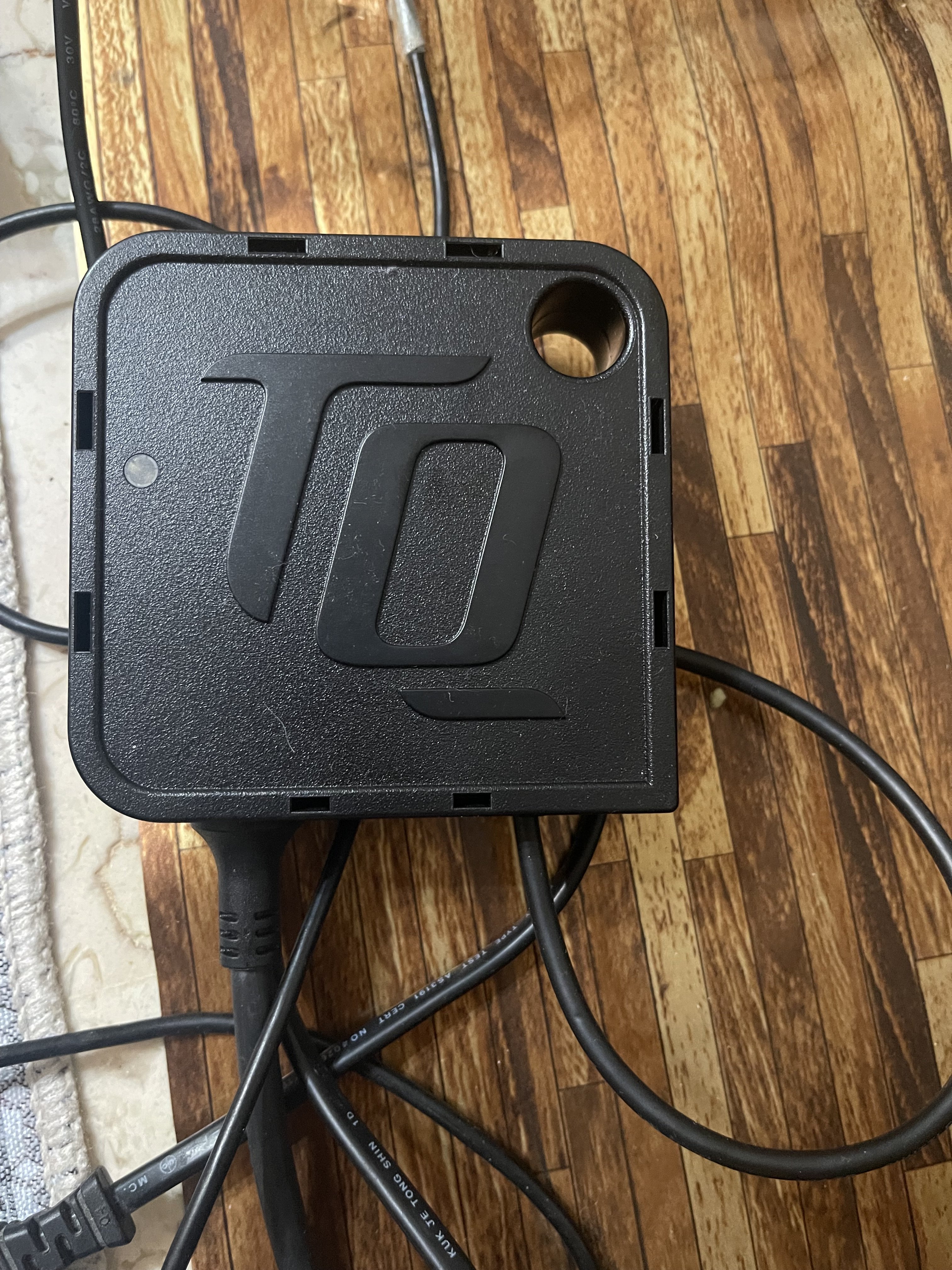

I received my own TQ USB service dongle and up date the firm ware by myself

To update you need a service USB dongle and download the software from TQ WEB , that’s all.
Could you be a bit more specific please. I really tried but can’t find any place on the TQ website that offers a download for the service software. Do I need any registration as dealer or something similar?
Ali_Foto
Feb 16, 2024
43
8
Dubai
Yes just register as dealer or bike repair shop then you will get permission to download software and service manuals.
