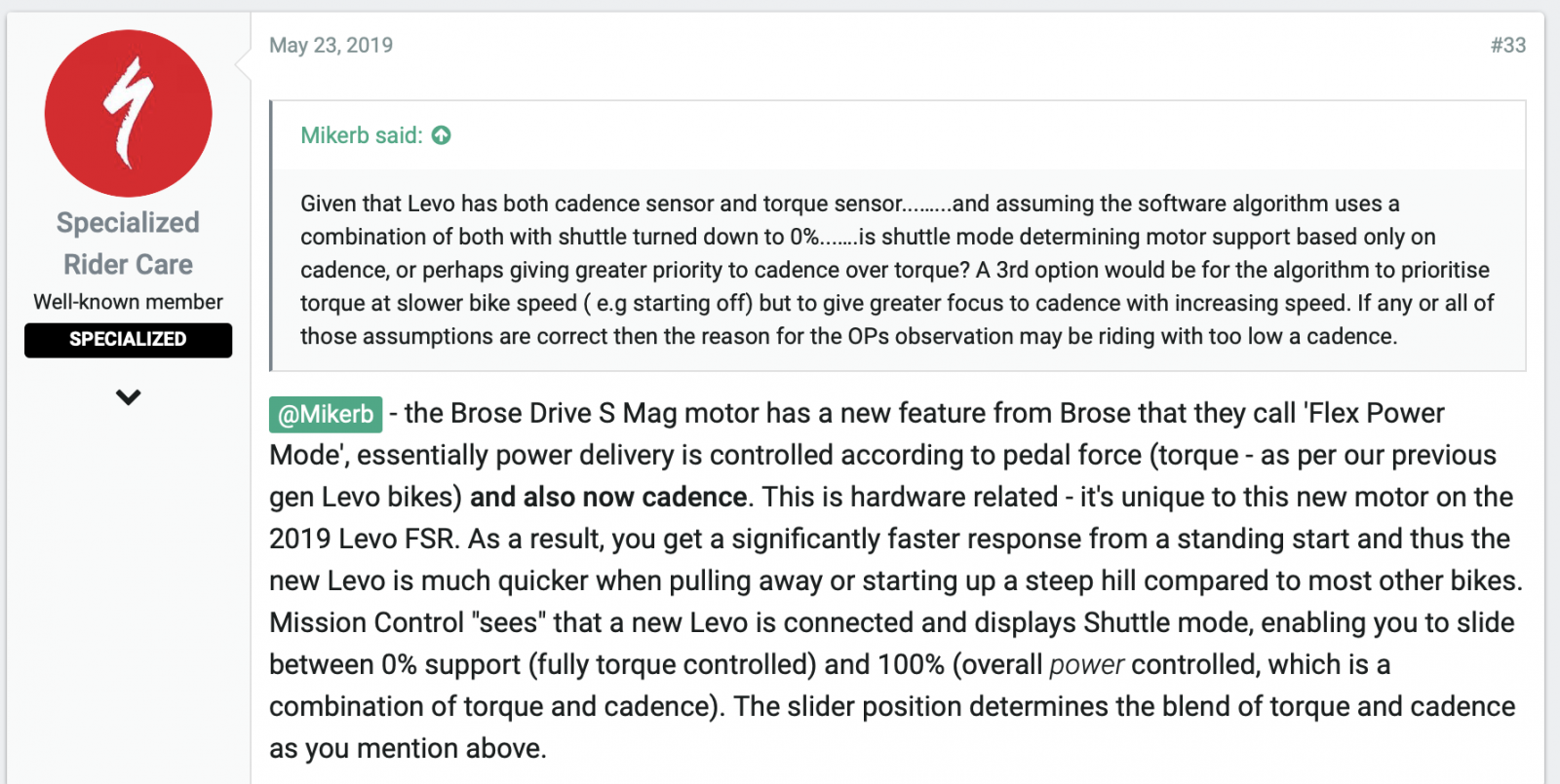

Interesting I was wondering if Shuttle Mode could be implemented via software. In essence a power delivery bias between crank torque & cadence so doesn’t sound too complex.
Then I read this:
Drive S Mag has also been equipped with new boards and chips, making it easier to combine the sensors inside. The result is a new riding mode at the highest support level. In Flex Power Mode, power delivery is controlled according to cadence and pedal force. As a result, Brose promises a significantly faster response from a standing start and thus significantly quicker when pulling away. Due to the hardware requirements, Flex Power Mode is only available in the new Drive S Mag.
from New motor: Brose Drive S Mag - More powerful, lighter, smaller | E-MOUNTAINBIKE Magazine

Isn't this related to the 2019 acceleration setting which differs from shuttle mode?
Definitely related but my brain started to hurt a bit trying to think that through - not to mention I don't have Shuttle Mode.
So I searched through the doctrines of the Oracle
Thanks!
In my case I have always been very focussed on reducing unnecessary energy consumption. I still have the 500Wh battery. As I am still a young guy I like the workout side too with the benefit I can extend my rides as long as possible. Therefore I use BLEvo smart power during all my rides and just increase the leg power threshold to the maximum achievable value for me at that moment during the ride.
On the other side, if you like to pedal more easy and get more assistance quicker than you would normally get then I would try to do the opposite and decrease the leg power threshold in BLEvo.
But just to experience the real shuttle mode setting, as it's intended, I will try it next time.
