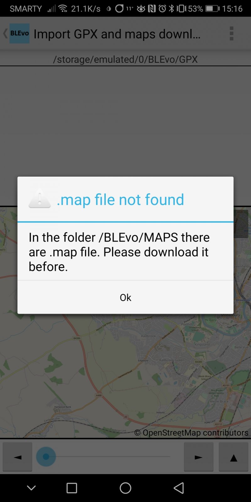

Hi. Apologies as I'm sure this is me being stupid but I'm getting an error with Openandromaps. I've downloaded and extracted the zip file within the blevo/maps directory on my android 9 phone but get the following error. I've read through this thread and searched but can't find the answer. How do I download and get openandromaps to work?
When you check the BLEvo/MAPS folder via the file explorer do you then see .map files which you copied to the phone? After downloading and unzipping the Openandromaps only copy the .map files to the phone.

Thanks, I was being stupid and had the .map files inside a folder. Thanks again.

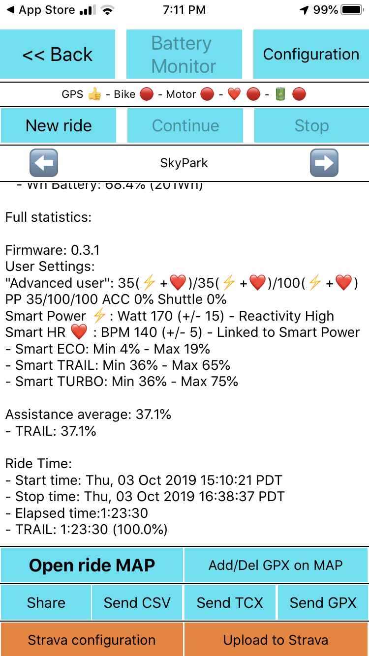

Hi Paolo,
I have a problem uploading my tours to strava. When I try to upload, it gives me a error message that says:
"Error 2: ("message":"error").
A friend of mine has the same problem. We both are using a BV 6000S with the latest version of BLEVO
I deleted my strava permission in the app and added it again - no effect, same problem. Can you help please?
Just for the case, that you suggest to reinstall BLEVO again: How can I save all my tours and settings?

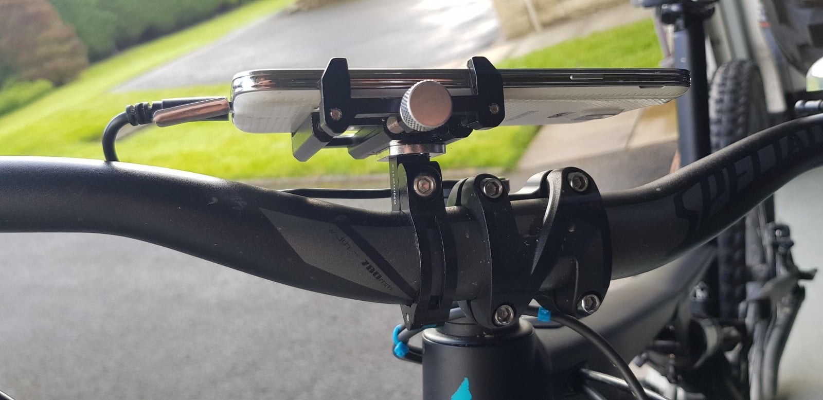

I went over the bars pretty hard last night and my BV6000 stayed connected to the Outfront/quadlock/superglue combo....
Hope not only the BV6000 is doing well but you too?
As most of us know who've used superglue .. you end up sticking yourself to something .
@grantini still has both hands firmly connected to the grips and even though he's lying upside down with the bike riding him rather than the other way round, he's been kind enough to confirm, by typing with his nose, that that the superglued BV6000 mounting works.
But @Maastricht is correct, are you fit and well to continue testing ? :)
It’s working great!

Hi Paolo,
I'm investigating on the issue..
Please wait to reinstalla BLEvo.. In the next release will be available the backup and restore procedure..

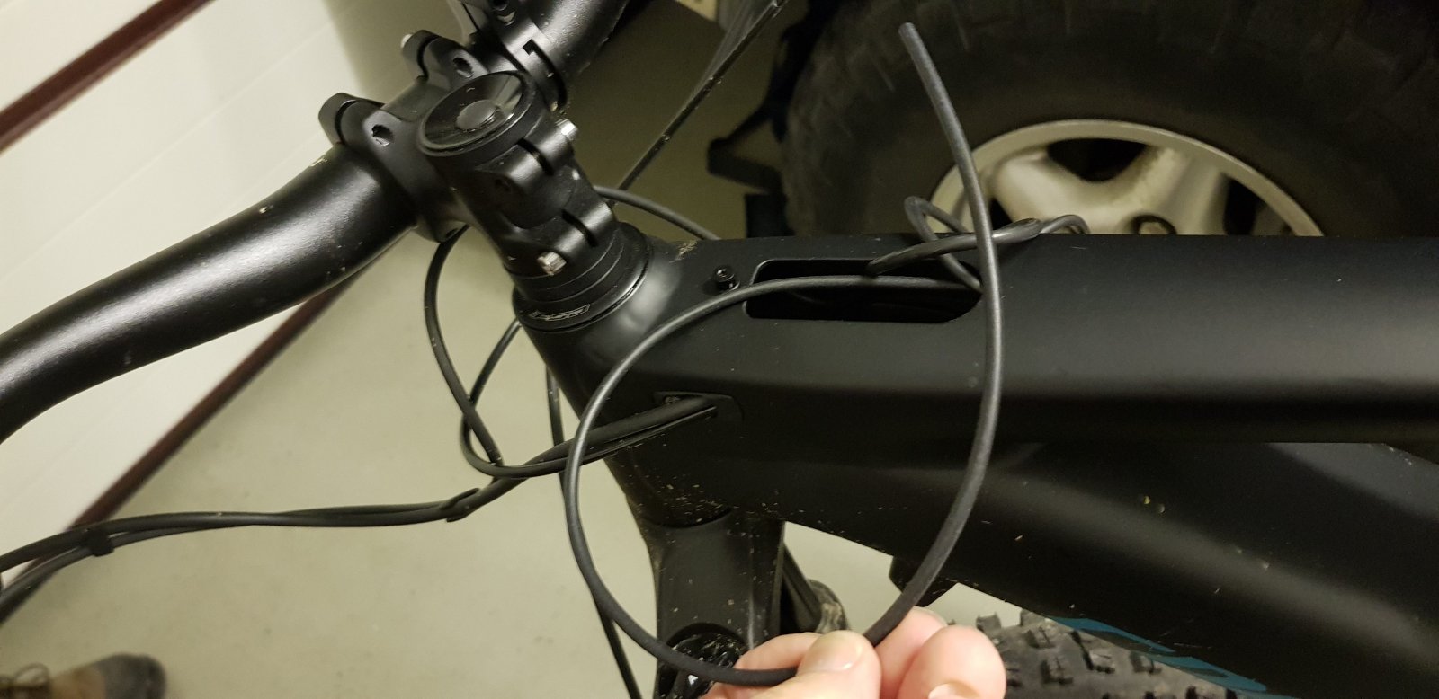

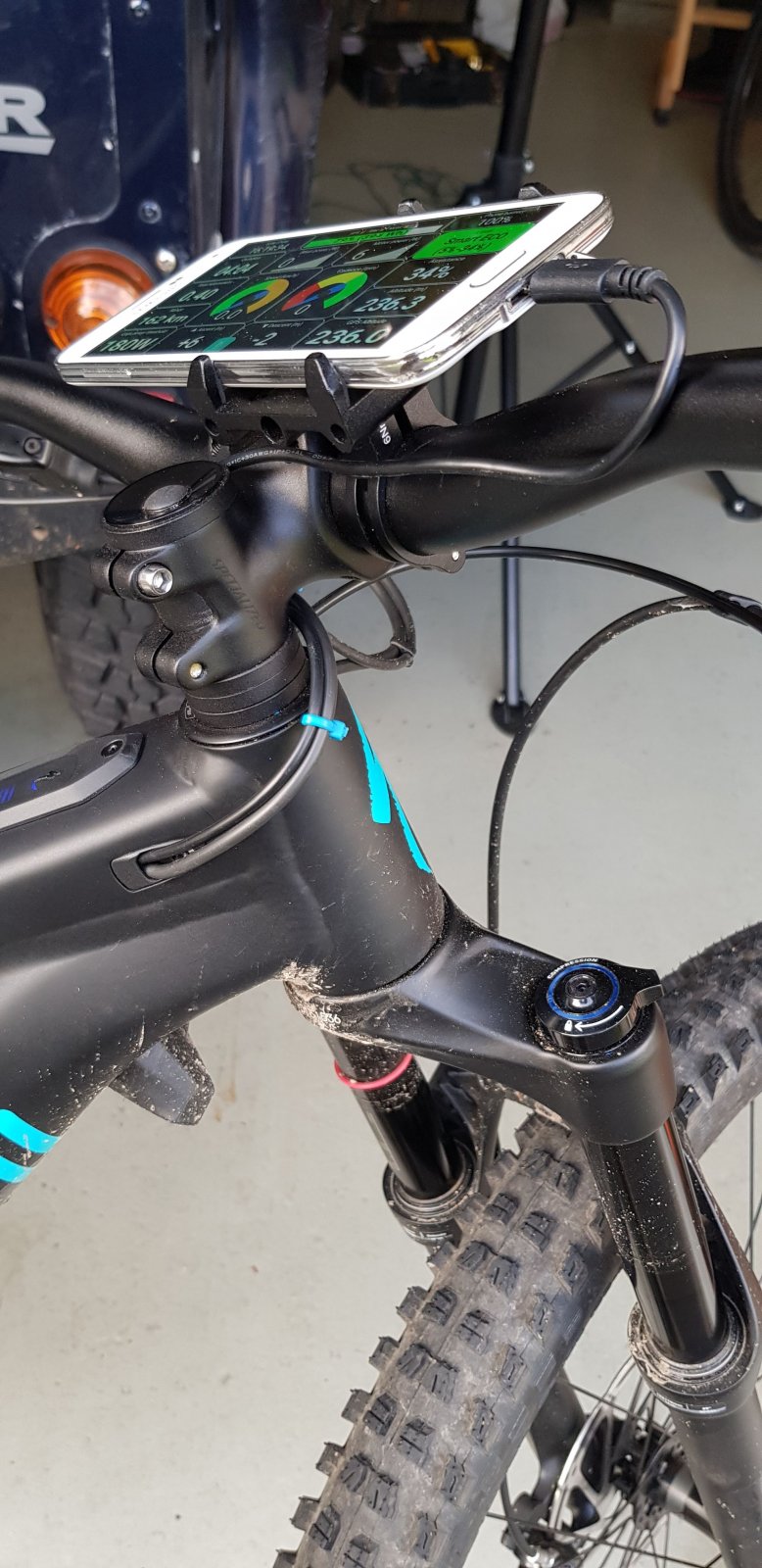

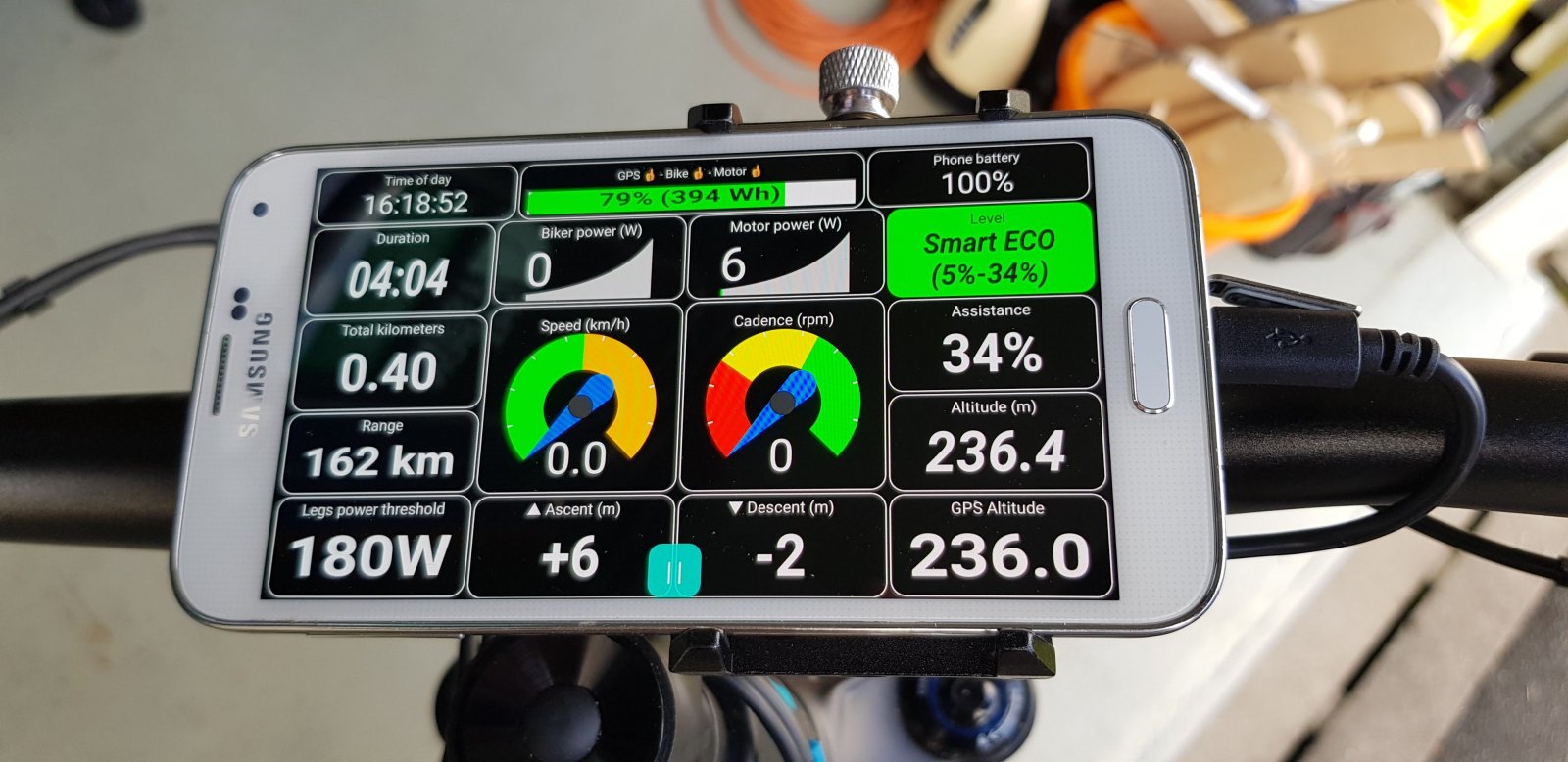

I created a cable from the front light connector on the motor and up through the frame to a waterproof connector. And then used a DC-DC converter to give me USB.
it works really well, however it could be costly to make if you don’t have all the tools. PM me if you want the details.
DC-DC-USB converter that I used
As a followup, I'm pleased to say I used Eds advice and created the connector and power converter solution and now have unlimited power to my phone and BLEvo..;-)
I used the Lupine cable to plug into the Brose light socket on the bike and attached the DC-DC converter. I pulled the cable through the frame and it exits on the right hand side via the brake cable hole.
Lupine Cable:- Lupine Brose E-Bike Light Cable at Bikester.co.uk
A few photos to show what I did...
