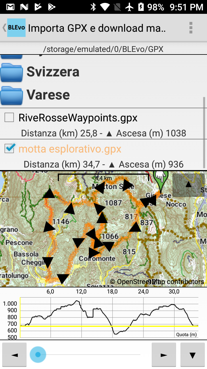

I have just released version 3.5.6 of BLEvo for Android which solves the problem of uploading the ride to Strava. I also added the folder management for GPX.
I did a little video tutorial explaining how to use it (sorry but it is only in Italian)
Here are all the news:
- Add folder management to GPX import
- Added help with the order of display customization fields
- Now the GPX are copied under the /BLEvo/GPX/MyRides folder (on request)
- Bugfix: Barometer calibration on start tour
- Bugfix: Upload Strava
Minor changes:
- Fixed initial autozoom on GPX opening
- Fixed import and WP name with tag <![CDATA[
- Enlarged assistance keys +5 +1 -1-5
- Store GPX ascent and distance information
- Converted to ? characters not accepted by Strava
- Now scrolling through the rides, the relative TXT is updated
- Removed the private field from the upload on Strava
- Added Battery Monitor button in Bike Setup

Varese
Thanks for the update.
What I wanted to achieve, was when I “add file gpx ” (and I download them to OneDrive folder) that I could select a OneDrive sub-folder and it loads all gpx files in that folder.
Does your new feature allow that..?
Yes.. Did you already try?
