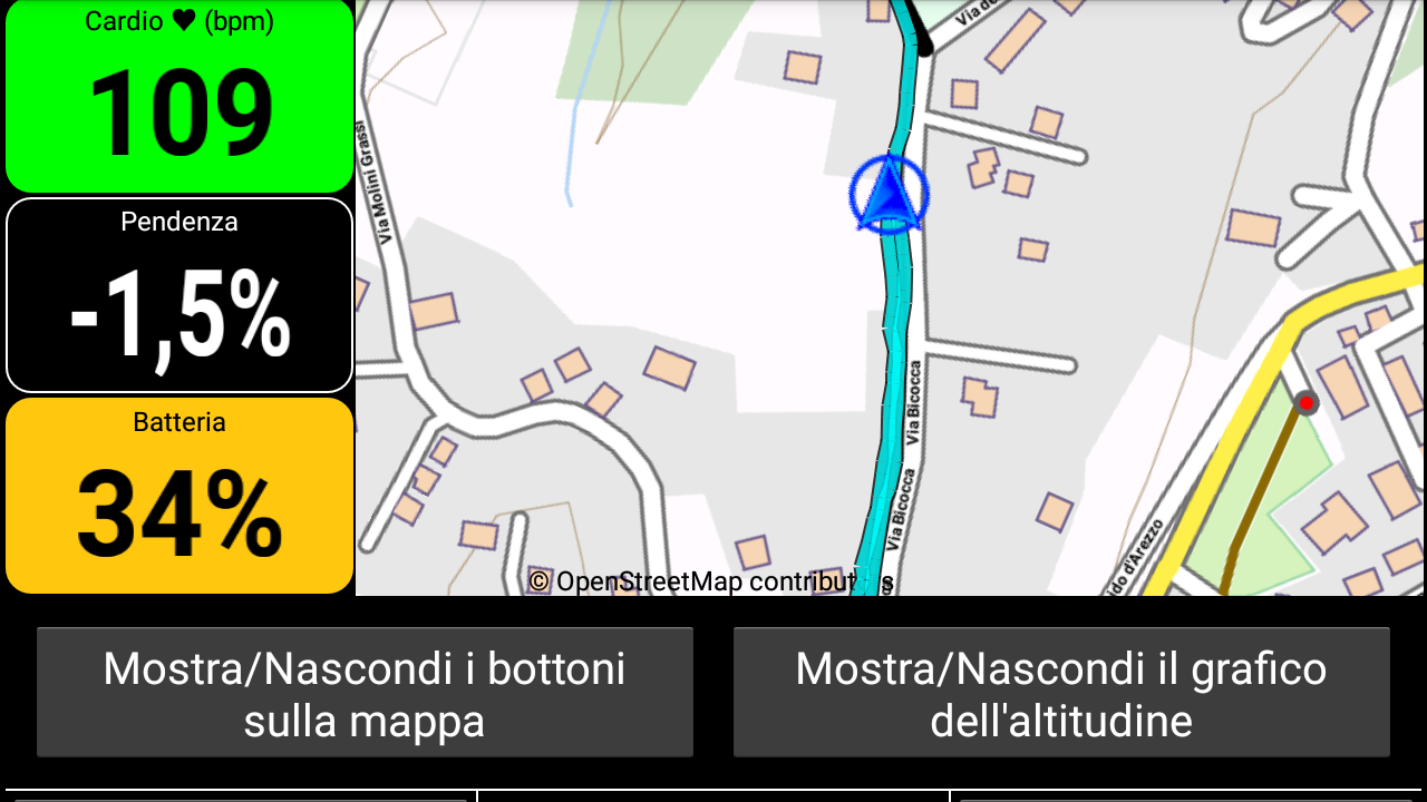

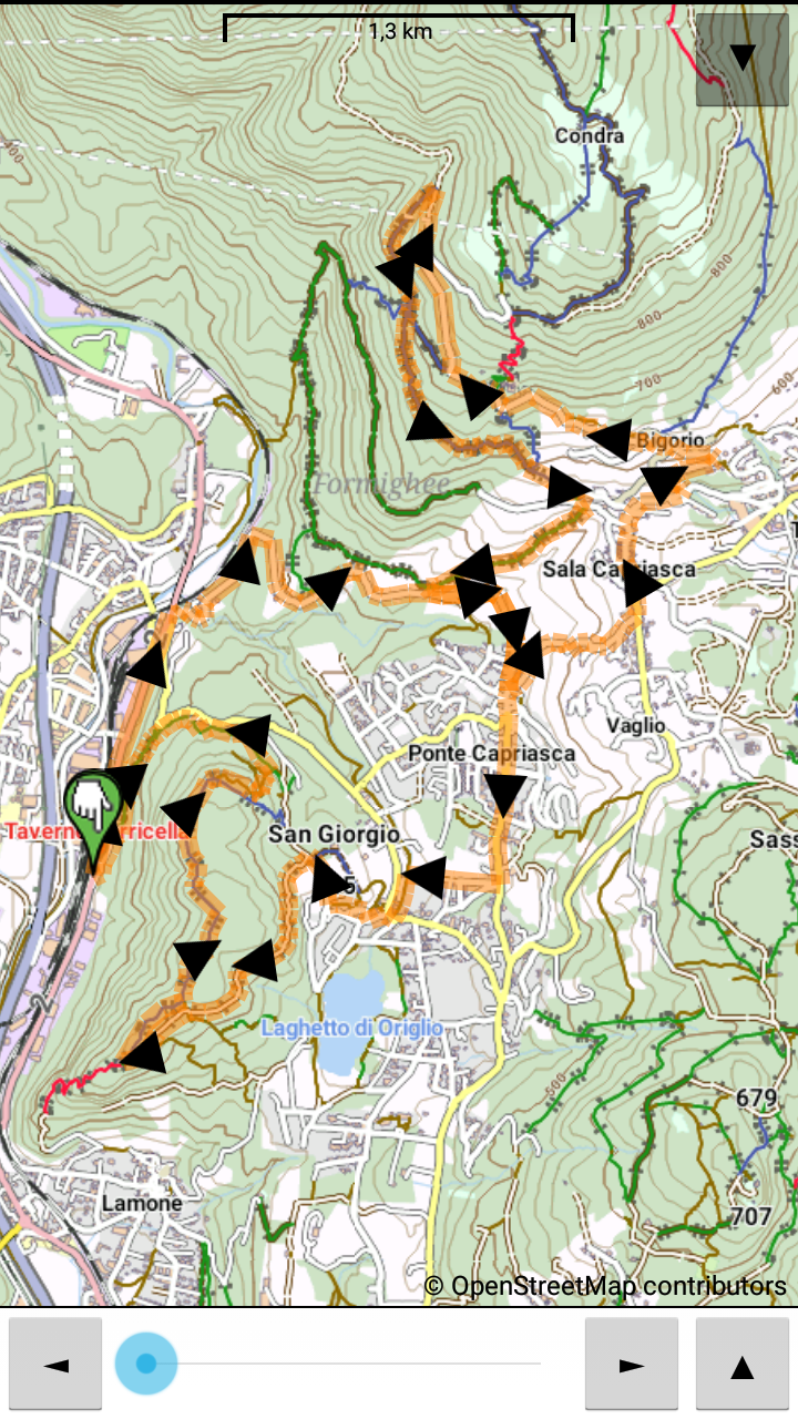

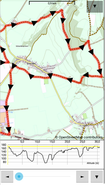

I have just released version 3.5.5 of BLEvo for Android.
I added the very useful bell functionality via the remote control. In the attached video you can hear an example (ps: activate the audio).
Another useful feature is the possibility of viewing GPX in fullscreen mode.

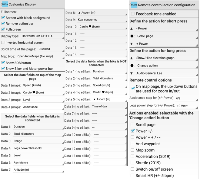

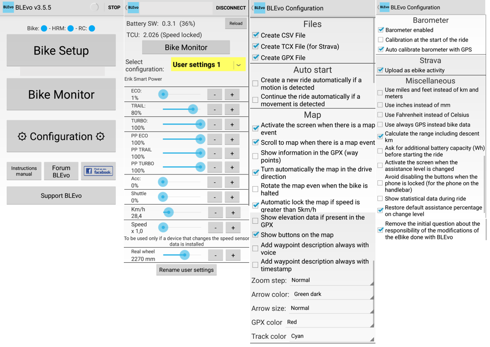

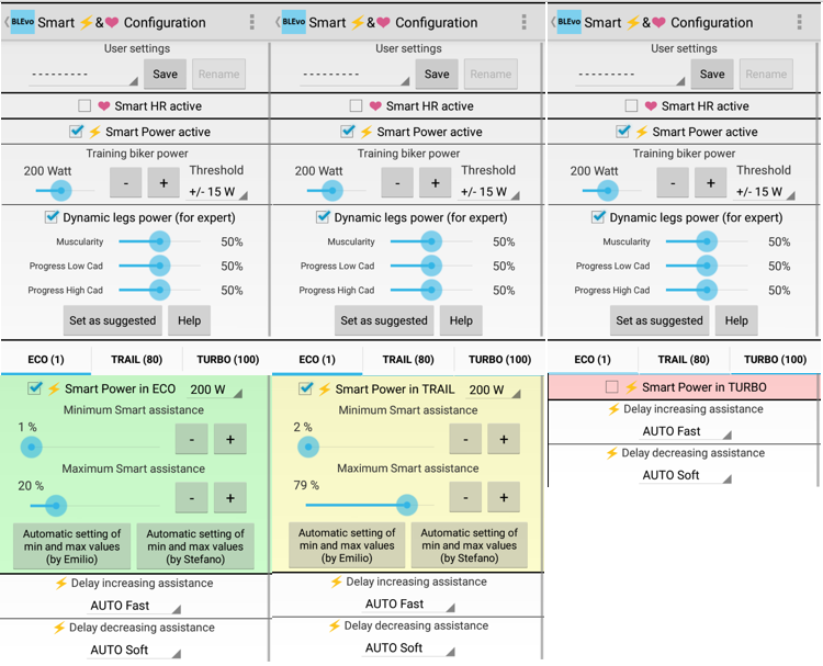

Hi BLEvo friends,
As I noticed many new users have sometimes challenges to setup their initial settings as BLEvo offers many options to customize each individual riders preference. Therefore I thought it would might be helpful to share my settings as a guideline:
Side note: Theoretical speed limit of 28,4km/h above is based on wheel circumference of 2000. LBS can change this setting to this minimum 2000 value if desired. However in practice the assitance drops around 30km/h. (so there is a slight overshoot above the theoretical speed limit)
With normal mtb riders I use the settings below but change smart power level to around 250W in eco which resulted for last two rides with a total of 66,64km with 630hm in an average consumption of 2,6Wh/km. Both rides together I only consumed 173Wh which would offer a theoretical range of 192km with 1815hm based on a Levo 2019 Comp with 500Wh battery.
If you get too tired during the ride, simply reduce the smart power via the optional remote control and/or switch to trail:

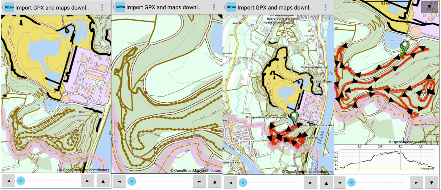

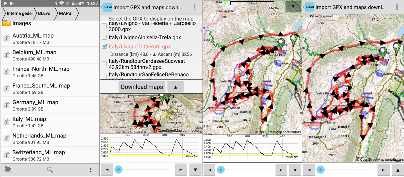

Underneath screenshots of the offline high quality OpenAndroMaps which I downloaded to the BV6000 only once:

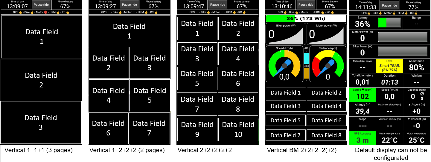

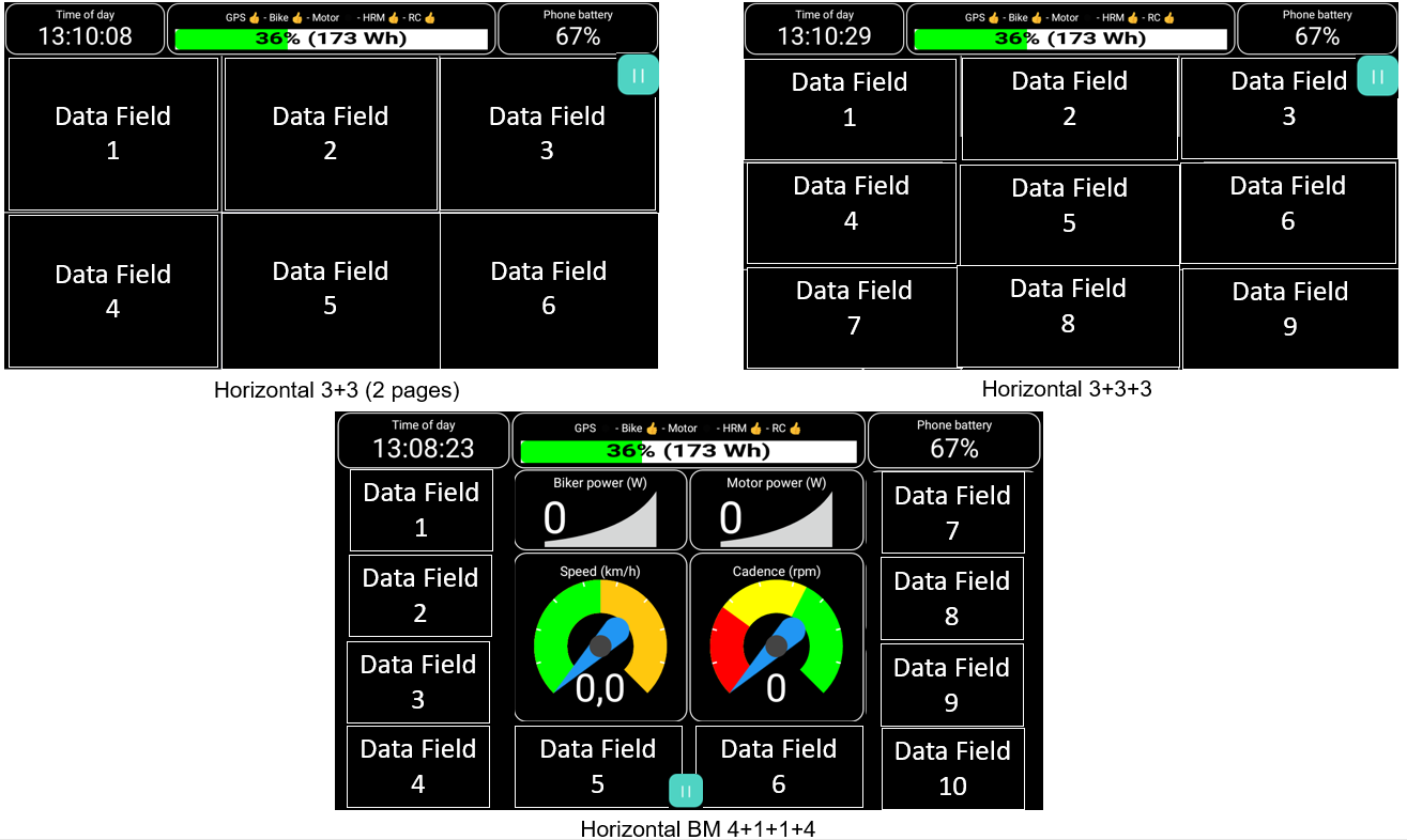

I’m configuring the data fields for my display. Is there a diagram that shows which data field is on the display, or do I just use trial and error to get the information in the box I want..?
Sorry but I don't understand.. the name of the field should be auto-explaned..
Could you describe better what you want? Thanks..
couplands
Jul 16, 2019
139
70
Peak District and Cornwall, UK
I knew I wasn’t clear...!
For the example, when I select “Data 5” = Descent, I don’t know which box on the screen this will be shown. I can do it by trying each one to find out, but it would help if there was a map that showed which box was which field.
PaoloBLEvo
Trader
Jun 13, 2018
1,456
1,188
Varese
The fields are in order from left to right, then from top to bottom..

There is a lot of talk about phones on here, and I thought I'd share what I have done.....
Phone - I purchased a Ulefone Armor X2, reasons I chose this phone are...
- GPS (Obvious)
- Fingerprint / face unlock - Easier than typing a PIN every time
- NFC - So I can use it for google pay when out and about should I need to buy something
- Screen - Pretty high res / pretty large which is great for maps
- Wifi - Beware, not all cheap android phones have wifi!
- 3g/4g - Supportrs all frequencies used in Europe (again beware as many cheap ones are either 3g only, or don't support all frequencies)
- Price - I think it was less than £150
- Dual SIM - Or in this case SIM + Expandable memory via Micro SD
- Protection - Waterproof / Shockproof / Mudproof / Smash Proof - Its been dropped / rained on / thrown around and it still looks like new!
- Battery Life - it never seems to run out! on a 4-5 hour ride with screen always on will often use <25% battery!
The phone however does have some let downs.
- Its not very fast compared to more modern phones.
- Its heavy
Phone mount - just a basic (aluminium) one from Amazon. It has a threaded adjustment bar to accept multiple phone sizes and can be in landscape or portrait orientation (needs an allen key to change though). Very sturdy and grips the phone well. Price was around £10
SIM Card (UK) - I have an o2 pay as you go SIM so that in an emergency I can make calls / send texts. The SIM was £10 (which included £10 of credit, when I registered it online I got another £10 and then after registration o2 sent me an email with another free £10 credit - in total I got £30 worth of credit with the SIM card. Calls are 3p per minute, texts are 2p each, data is 1p per MB. Only caveat is that I have to perform a chargeable "event" every six months, to achieve this I have a calendar reminder and send a text message (2p) to my main phone once every 3 months! I switch off the data on the phone and only use wifi.
SDCard - I put a spare 32gb SD card into the phone and downloaded the free OpenAndro maps to this card. I have most of Europe on there with room to spare! They work perfectly when out and about without requiring a data connection.
And then of course I have the Blevo app - in all honesty I really do think that this app would still be a bargain at 5x the price! Theres more than enough detail regarding the app on this thread and Paolo obviously listens to feedback and is constantly improving the app, sometimes with big features, sometimes with very small tweaks.

Hi Couplands,
Hereby an overview of the customizable data fields in combination with the different Android displays:
Personally I really like the "Horizontal BM 4+1+1+4" version where you can configure for map view 4 data fields.
Paolo will add them to the manual.
Perfect, just what I was looking for. I agree that the "Horizontal BM 4+1+1+4" is a great configuration.
I just need to decide what my favourite data fields are...?
Here are all the changes:
- Added GPX support without end point tag </trkpt>
- Added GPX import checks
- The privacy field is no longer possible to use for uploading activities (Strava decision)
- Added the sound of the bell (and of General Lee) in the remote commands
- Added possibility to remove the WayPoint of beginning and end of the course
- Added possibility to save WayPoints with date and time without having to enter a text
- Added possibility to remove buttons from the map
- Added buttons to display / hide the elevation graph and the buttons on the map (also with remote control)
- Fixed vocal message of ascent (now without comma)
- Fixed vocal message of the distance under the km
- Now the scan button on the home page has no timeout
- Correct display of speed and min / max slope in the map
- Correct display of the bike name in the title bar
- Now the tour map does not display the battery value at zero
- Correct reading of data for the elevation chart with <ele> tag at the beginning of the line
- Added average assistance percentage in short statistics
- Now the total km of the bike are always displayed in the bike monitor. The last value received is displayed
- Now the full screen of the GPX import is "more" fullscreen
- Now the speed multiplier is in scale x 10
Update from Google Play.
Have fun with BLEvo.

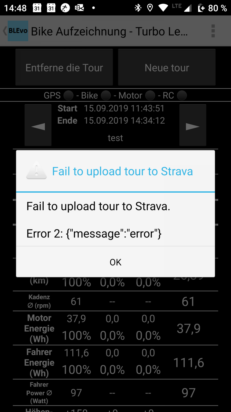

Since Version 3.5.5 i am not able to upload my ride to Strava, even when the privacy field is unchecked. A new authorization to Strava changed nothing. I always get this error message

I'm not sure if this is a bug, but thought I'd let you know......
- When not following a track (GPX) the elevation profile on the map view is obviously blank, so I turn it off - however if the ride is paused (manual pause by hitting the pause button) when the ride is resumed the elevation profile is shown again and has to be switched off again. Auto pause does not do this, just manual pause. Would it be possible for the on/off setting to be remembered between manual pauses of the ride?
I also have an idea for an enhancement related to this.....
- If no GPX / Elevation is loaded, could the elevation section at the bottom of the map be used to build up a picture of the elevation of the ride so far? Blevo has the data of elevation and distance and it might be good to have a visual of this as we ride.
