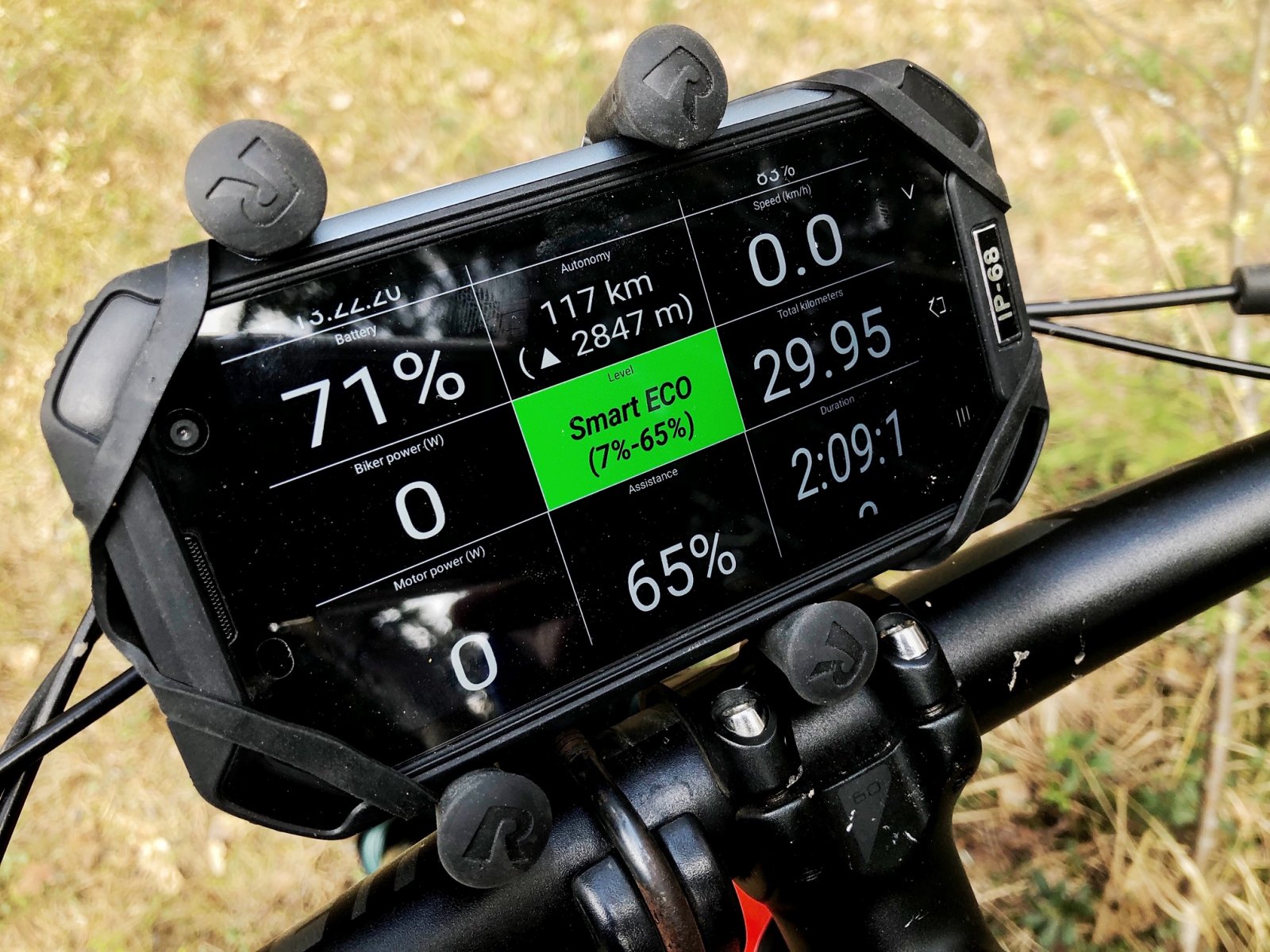

Thanks Paolo, I have been doing some tweaking to my settings, and based on your comment, I think I've found the sweet spot. I went yesterday for a 55 km ride and I think that never gotten the average Wh/km such low and also never done so little amount of manual assistance changes during the ride. I was using my home-made, extra 250 Wh battery and came back with 43 % battery left :cool:
Now my settings are:
7-65 %
70-80 %
94-95 %
And thresholds set up so that Eco power goes up quite soon, when I push pedals hard, but also comes down, when I don't need the power anymore. Trail is for steeper and/or more technical uphills and Turbo for going over logs or other short technical sections.
I do have one wish though:
I have "Duration" visible in my 3+3+3 horizontal dashboard, but the moment, when duration goes over 1 hour, the value goes to two rows and then it messes the layout (see the attached image, lower right corner and the whole bottom row). Would it be possible to have a setting that, when duration goes over 1 hour, the seconds are not shown anymore?
I will check the field of time in this kind of display...
