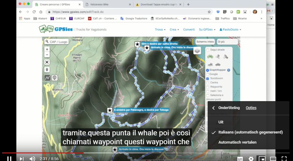

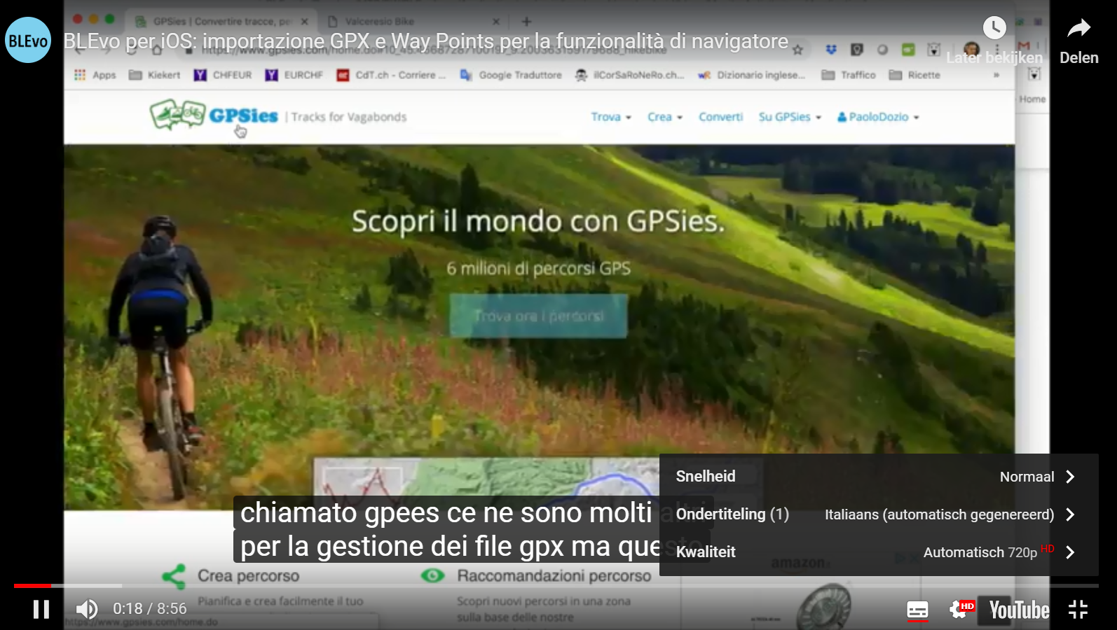

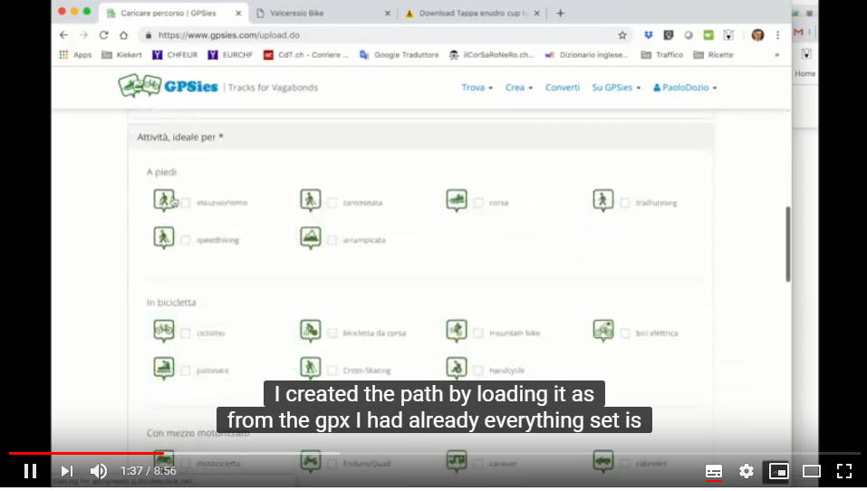

The new version of BLEvo 3.3.3 for iOS is available on the Apple Store. I implemented the navigator functionality through WayPoints.
Look at the following video in which I explain how to do:
The video is in Italian, but you can use the subtitle functionality of Youtube.

Hi Paolo,
Thanks for all the updates!
I watched the video and via auto translate I understood about 70%. I think I only missed the part where you imported all my tinder matches as waypoints? My wife will going to miss me for long time this summer. :ROFLMAO:

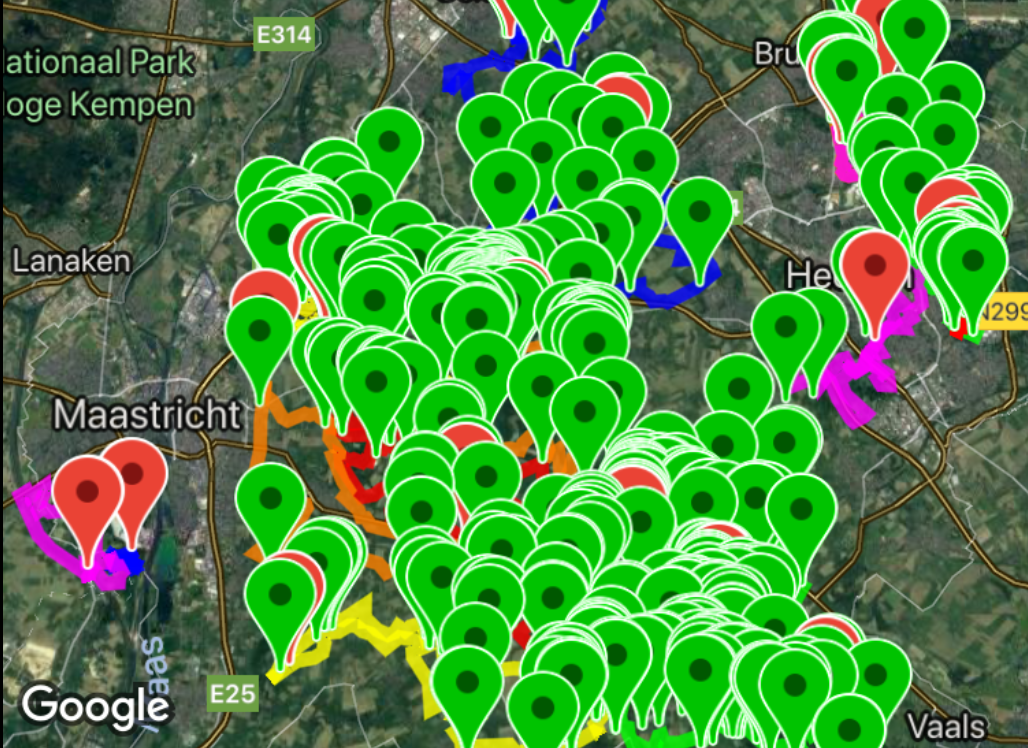

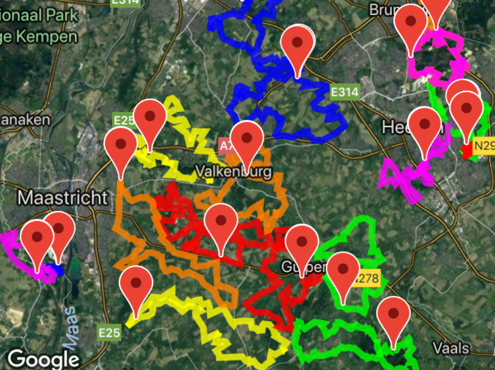

Hi Paolo,
I watched the video and via auto translate I understood about 70%. I think I only missed the part where you imported all my my tinder matches as waypoints? My wife will going to miss me for long time this summer. :ROFLMAO:
Previous post was just a joke Paolo!
The GPX tracks I used here are official mtb tracks in the southern part of The Netherlands. They are distributed by our tourist agency. Our tourist agency likes to add a lot of waypoints like bars, restaurants, hotels, etc. As you can see below the new BLEvo "hide waypoints function" works extremely good:
So here you only have left all the start and end points of each route. This new function offers me a lot of value while I am now very easily able to start for example on the orange route then jump to the red route where they touch each other and so on and so on. With my new Levo I already see that where I normally rode one track with my non assisted bike, I now easily ride two trails.

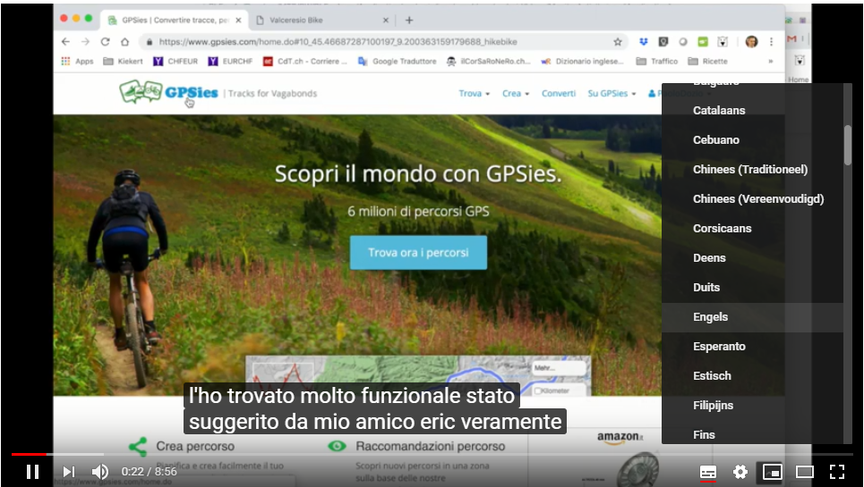

i know i’m not very digital, but i cannot figure out how to bring up the english subtitles on paolo’s youtube vids. i can only get italian subtitles. any suggestions? have you guys been able to do this?
Stumpy
Staff member
Jun 17, 2018
645
622
Essex, UK
I just watched it in Italian - couldn’t understand a word but it sounded very relaxing and looked good :ROFLMAO:
Maastricht
Oct 3, 2018
646
655
M
You can use the following settings but these are only available when watching Youtube via a computer but NOT via the Youtube app on a mobile device:
Left of Youtube icon select settings button, then select subtitels -> arrow to right and then choose automatic translate into your prefered language:
For example english:
Now subtitles are automatically translated:
