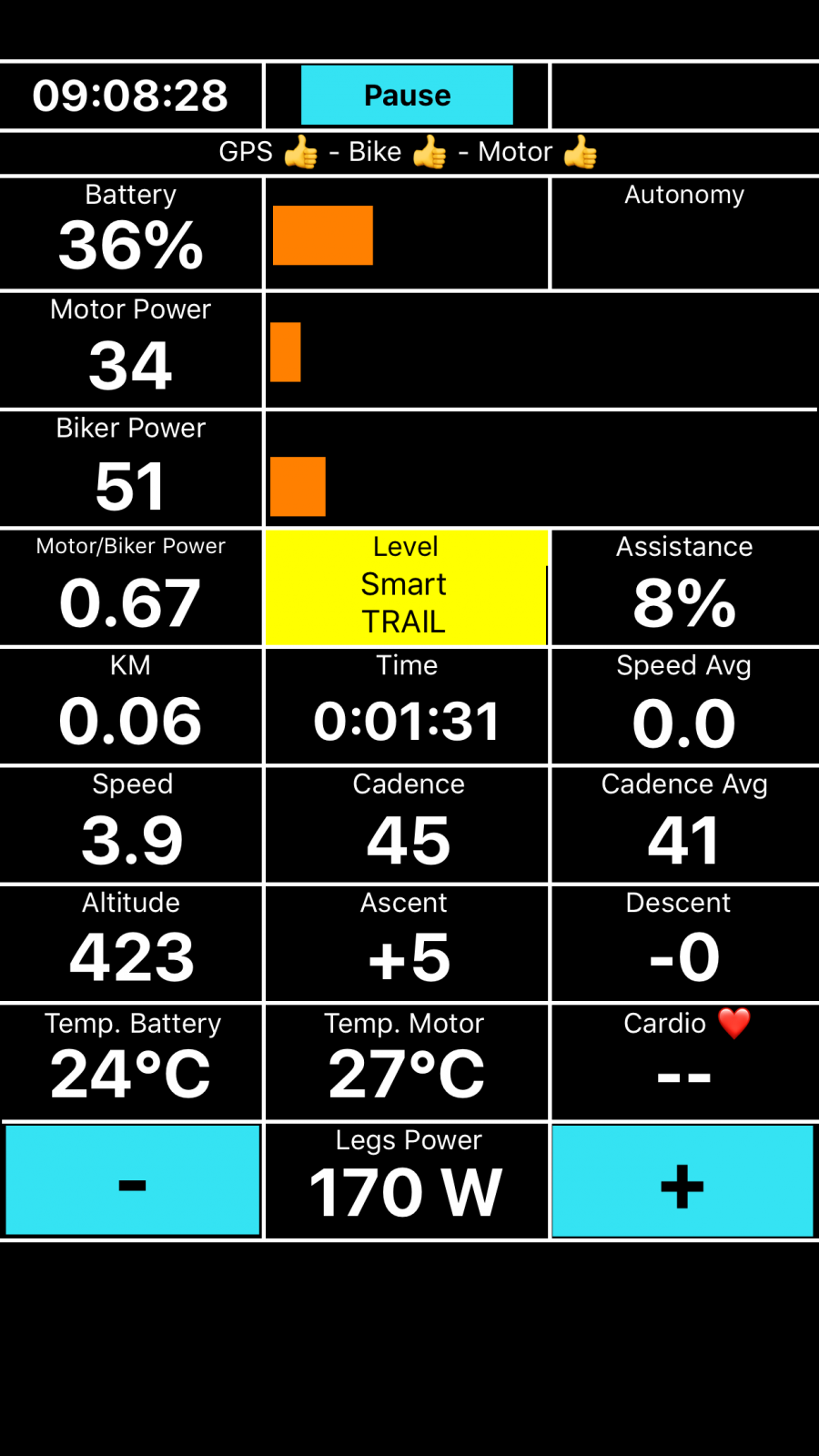

Today I release the new version 2.6.1.. these are ther news:
- Added Short statistics
- Added statistics for Max Cadence, Max biker power, max Motor power, Motor Energy
- Now the Bike Monitor is in full screen
- Added GPS/Bike/Motor/HRM status also in the Bike Monitor
- Added in the bike monitor 2 buttons to increase/decrease the legs power (if Smart Power is active) or the assistance percentage. This feature is available from iPhone bigger than 5.
Update it from Apple Store

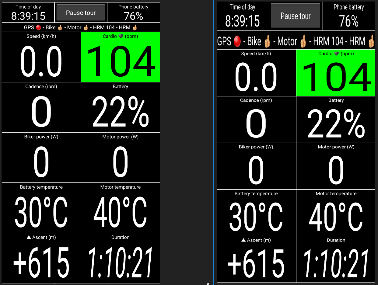

Hi @PaoloBLEvo ,
Is it possible to change the 10 section Customised screen slightly?
I have been using it for a while now and think that the top 2 rows could do with being bigger so they are easier to read.
Hope the others users of BLevo on the forum agree with my proposal.
Please see the screen shot below of what I would like. Your current screen is on the left and my proposed one is on the right.
PaoloBLEvo
Trader
Jun 13, 2018
1,457
1,191
Varese
Hi @PaoloBLEvo ,
Ok, I can understand you point of view, but the new line added is only to have a quick look of the red light..
I can try to increase it but I'm not sure when...

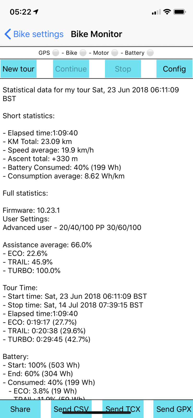

Still having a couple of issues with the app.
I’ve paired it with a HRM and that’s working well. Went out for an hour ride today but I still can’t send csv, tcx, gpx files so there is no way to export the ride and save it anyway.
Again I’m looking for anyone else using an iPhoneX who’s managed to use any of the send buttons. That way I know it’s me and I’ll keep trying different things.
One thing I thought about was the fact that the iPhone ‘swipe up bar’ is covering these buttons and that might be causing issues.
@PaoloBLEvo - does that sound like it could be an issue?
Welcome to ideas. I’d love to keep using the app but I can’t if I’m not able to export the rides :/
Thanks for any feedback

Levorunner
Jun 16, 2018
73
50
Canada
Dean
Yep, I have the same problem but I'm on android. Tried everything but nothing seems to work. ???
Stumpy
Staff member
Jun 17, 2018
645
622
Essex, UK
Dean
I’m OK on an X Dean...
