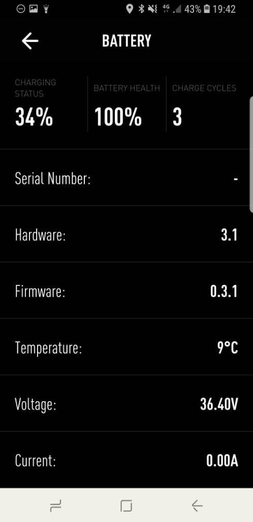

I see in blevo battery 98% = 439Wh
Believe blevo working only partial with 19er levo at this time.

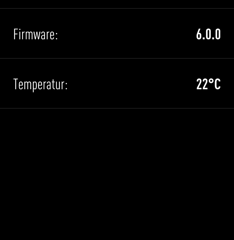

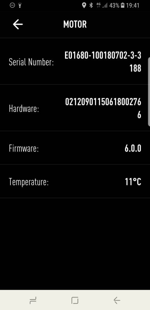

I have FW 6.0.0 and i can change Speed with Blevo .... no Problem.
Here from the MC APP:

Yes with Motor FW 6.0.0 its possible. With Motor FW 6.1.0 is blocked.
I can confirm that it's blocked with the latest firmware (6.1.0 for the motor and I think 19.x for the battery).It's not possible to update just the motor or just the battery with the tool, so I'm not sure where exactly they implemented the blocker...
