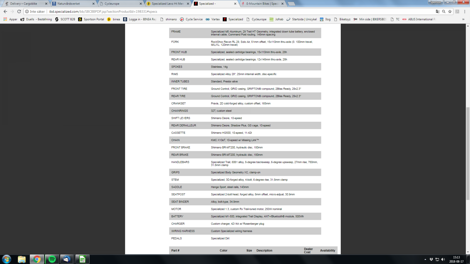

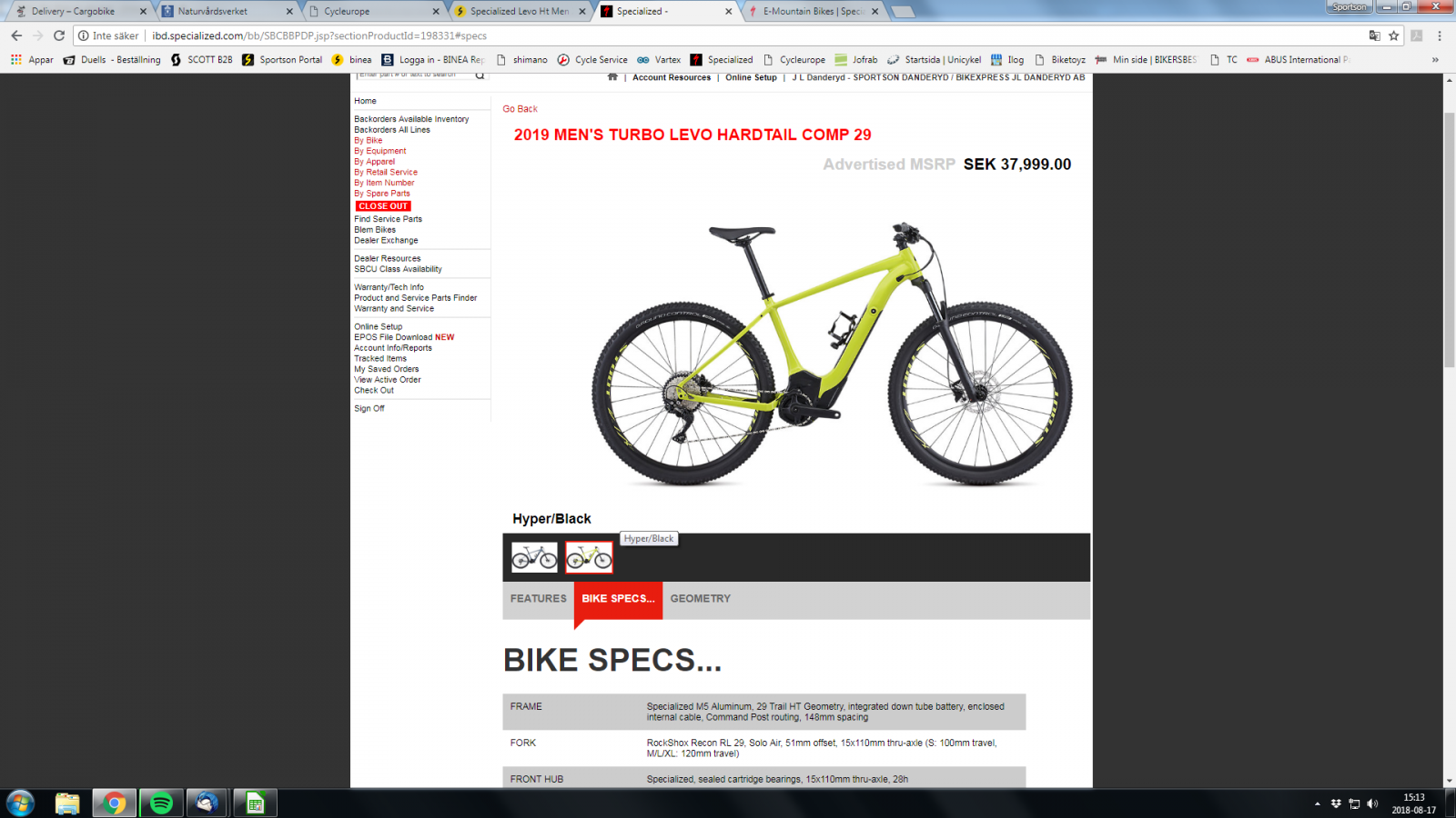

I think for clarification any levo before and including 2018 Blevo will work with.
The 2019 hardtail have either 1.2 or 1.3 motors Blevo will work with these.
2018/2019 kenevo Blevo will work
Only the 2019 levo fsr with the brose 2.1 mag motor is in question
Before asking questions @PaoloBLEvo its important to state which model you have

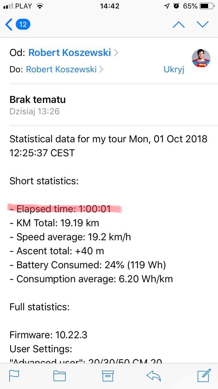

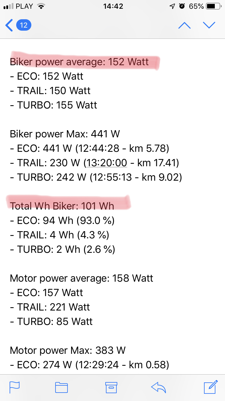

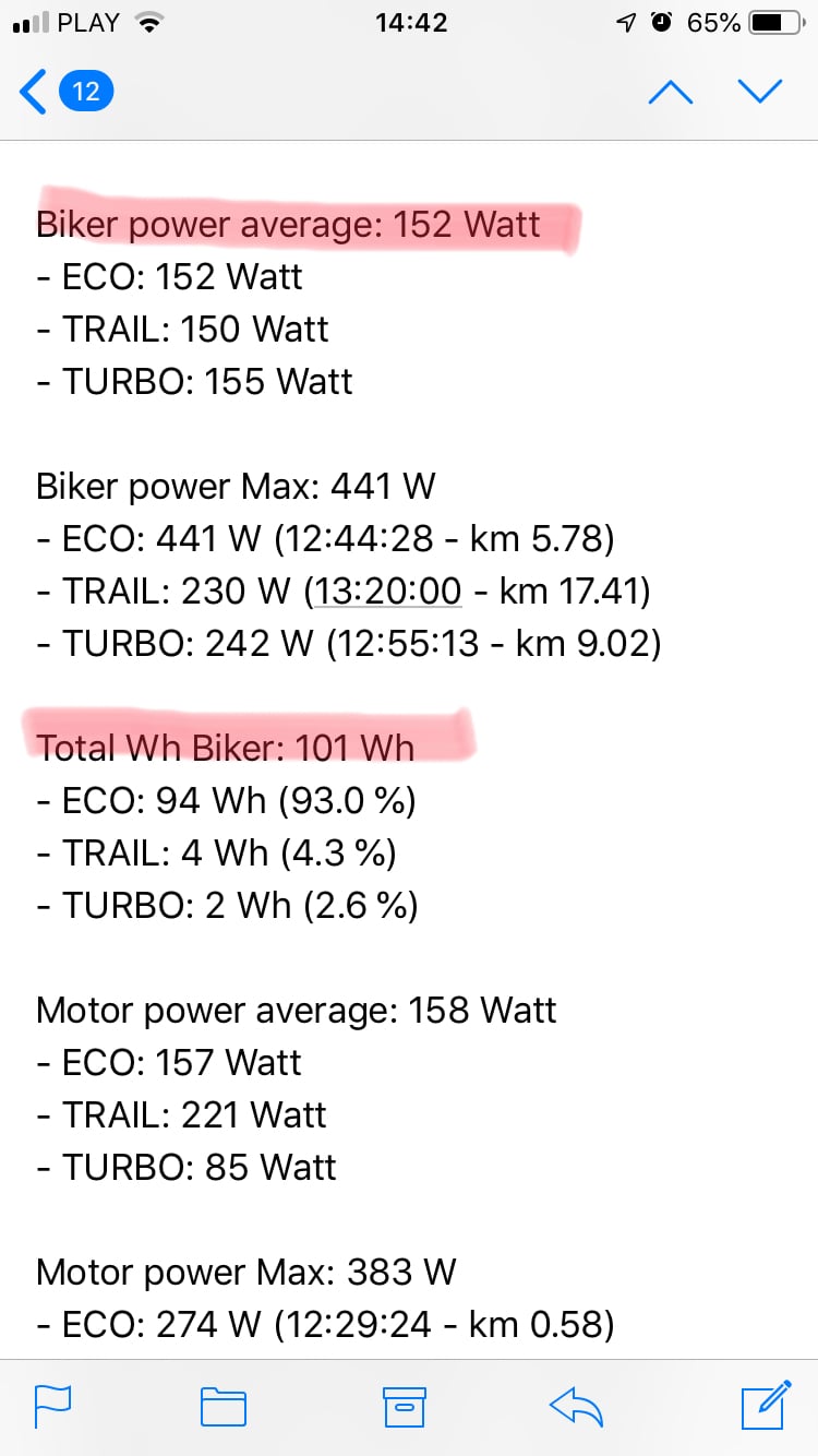

I had an 1 hour ride on Levo 2018, iPhone and blevo. The summary of the ride from blevo are:
Biker power average: 152 Watt
Total Wh Biker: 101 Wh
as the ride was 1 hour there slould be:
Biker power average: 101 Watt
or
Total Wh Biker: 152 Wh
Am I wrong?
or
Am I wrong?
Watt is the power..
Watt average is the power average..
Wh is watt per hour and it is the energy and it is not the same of power average..

Watt is the power..
I know. But I think that if I burn average 100W during 1 hour I will use 100Wh. If I light 100 W bulb during 1h I will have to pay for 100Wh. Or not?
The biker power average is different because the values with cadence under 30rpm are not considered in the average calculation, otherwise this is not a "good measure".

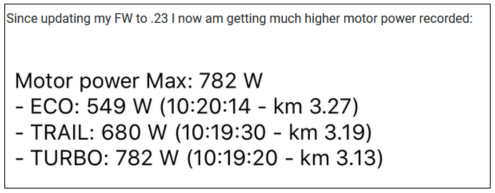

That's good @Rob Hancill but I expected more?
This is my 2018 1.3 stats
Motor power Max: 772 W
- TURBO: 772 W (06:29:24 - mi 7.60)
Total Wh motor: 211 Wh
- TURBO: 211 Wh (100.0 %)
It’s 100 W up on my 2018 Expert.
Maybe the 2018 S-Works got the handpicked powerful motors ?‍♂??

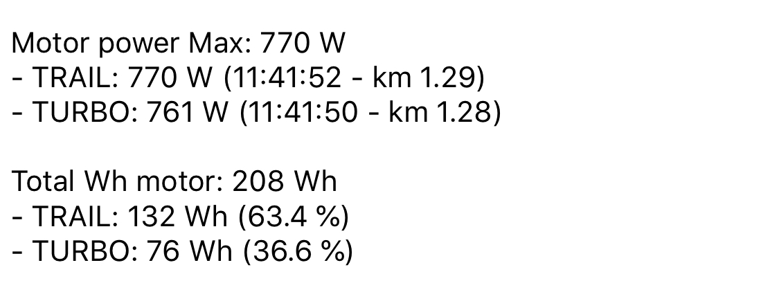

2019 Levo / BLEvo
The motor is E*POWAH!
Hmmmm.....
Rob, I am not sure how Brose calculate their increase in support on your 2019 compared to your 2018 but the Blevo figures you are showing above are:
More on Trail 680 v 770? but ....
Less on Turbo 782 v 761
Compared to what you posted for you 2018 a few weeks ago ?

It does seem a bit random my first 1.3 motor would only hit about 550w my second hits 768w wifes kenevo would hit 660 and her new HT with the 1.2e motor hits 630

Brose say for their Mag S motor the increase of assistance goes from 380% for their 1.3 engine to 410% for their 2.1 engine. What that should equate to in Watts I dont really know....

Hmmmm.....
Oh yeah, so it is, I thought for some reason it was 670 I was getting before.
