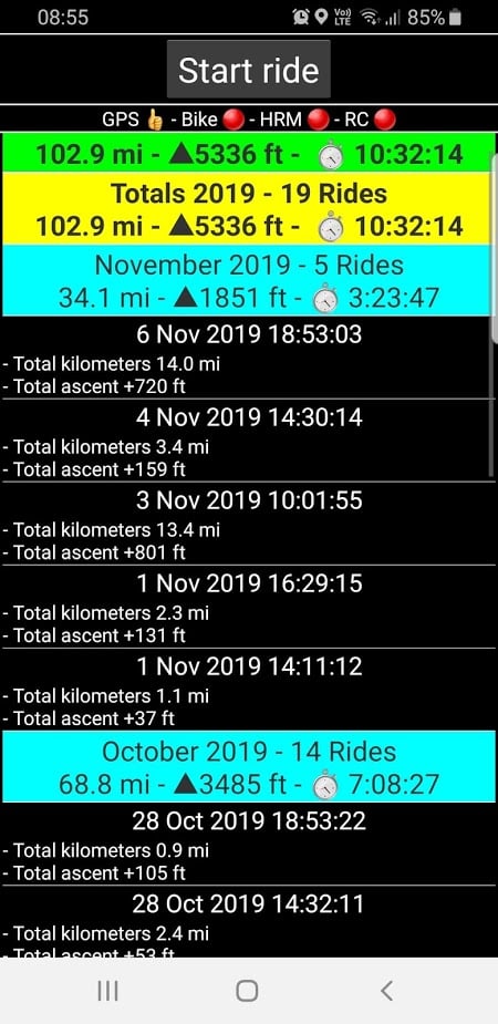

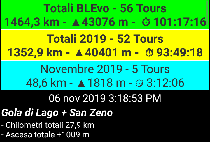

Today I completed my 56th ride with BLEvo...
More than 100 hours recording data of my bike.. I did more but in dicembre 2018 I changed the phone and the backup functionality was not yet ready so all my old rides are not present..
Who did more? ?
Who did more? ?
would it be possible to merge rides from two phones..? This would allow old rides to be added to new rides.
....and no, I haven’t done more rides than you...?

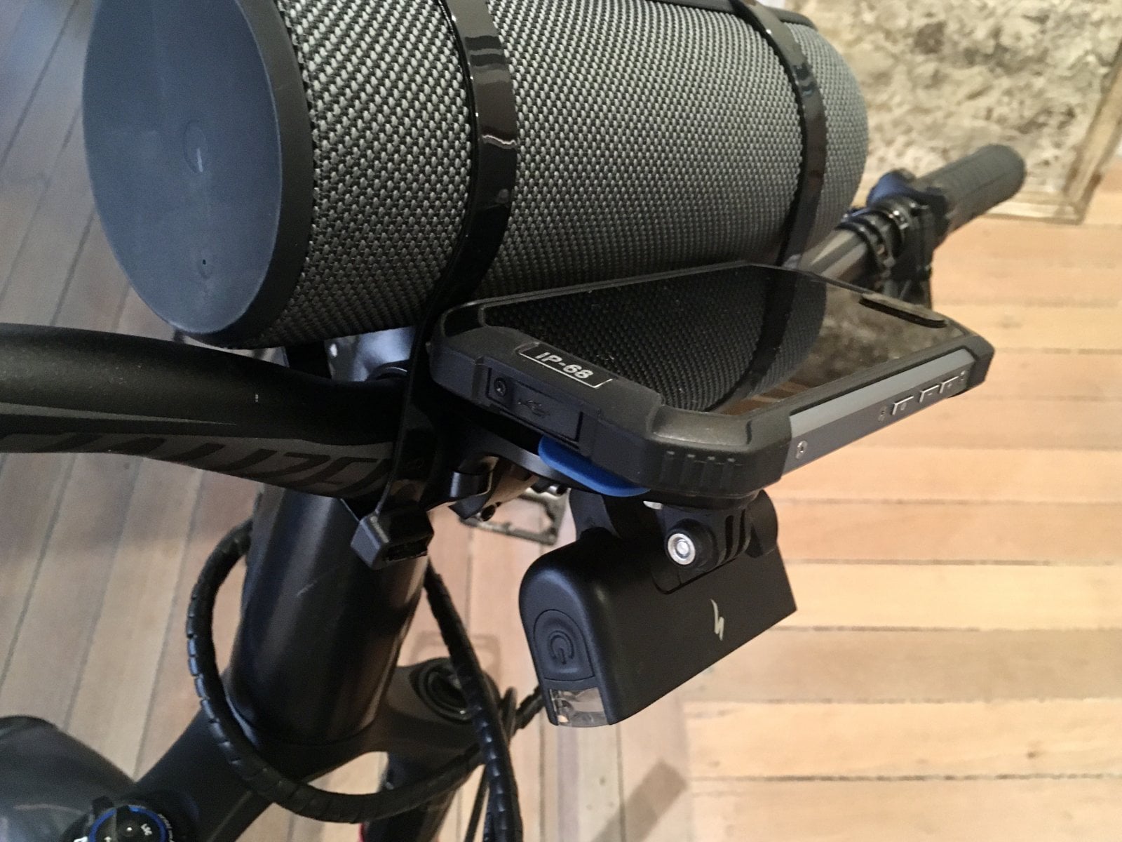

I love the option to have 'General Lee' as a bike bell, I have my phone mounted on the handle bars. Pedestrians love it!
Yes it is yet another unique Blevo feature more than just an Easter egg. I thought I'd mount a Megaboom on the handle bars. Pedestrians don't love it! I (and they) discovered the hard way that it automatically defaults to maximum volume :D I thought I turned the volume down but it still went to max.
I'd like to deploy some subsonic snake countermeasures. Some extra sounds would be even more awesome or a user supplied selection? Like a Lightsaber?

Yes it is yet another unique Blevo feature more than just an Easter egg. I thought I'd mount a Megaboom on the handle bars. Pedestrians don't love it! I (and they) discovered the hard way that it automatically defaults to maximum volume :D I thought I turned the volume down but it still went to max. View attachment 21361
http://soundbible.com/grab.php?id=19&type=wav
I love that idea!

I love that idea!
Haha I'm not going to ride any trails with that thing on my bars but maybe in my backpack for a laugh. Maybe a smaller speaker mounted lower on the frame.
I'm going to have to try the lightsaber out one way or another.
