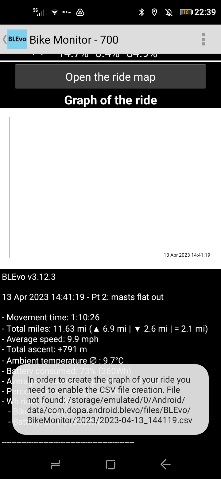

@PaoloBLEvo Hello!
I recorded a ride today and all the statistics show up, but the .csv file is empty or doesn't exist. When I try to do anything to view the ride I get an error about needing to enable .csv file creation (see below). Is the ride lost or is the data hidden in there somewhere? Other older saved rides work fine, it's on Android 9. Cheers!

@PaoloBLEvo Hello!
Could you check with a file broswer if the file is present or not?

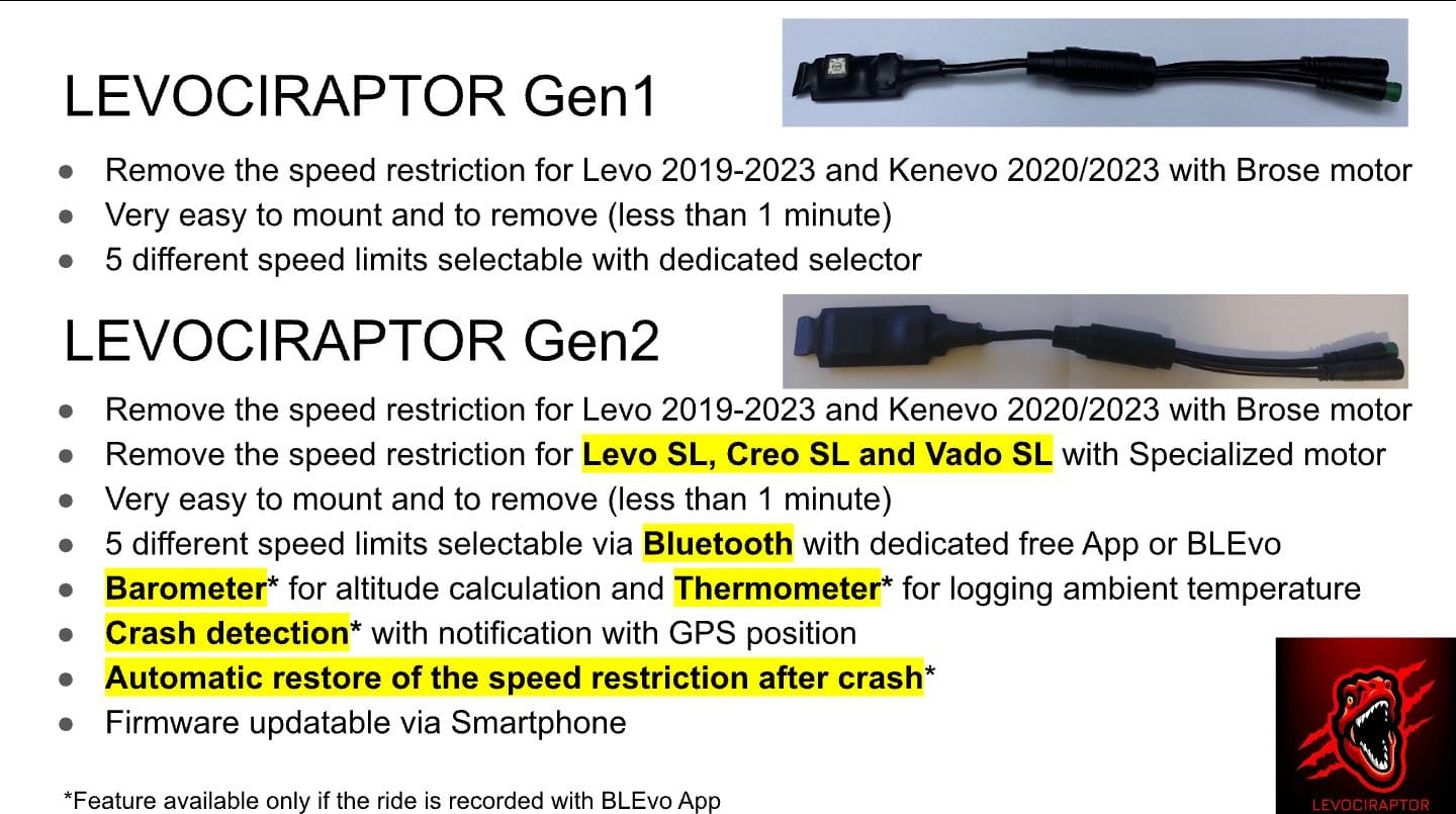

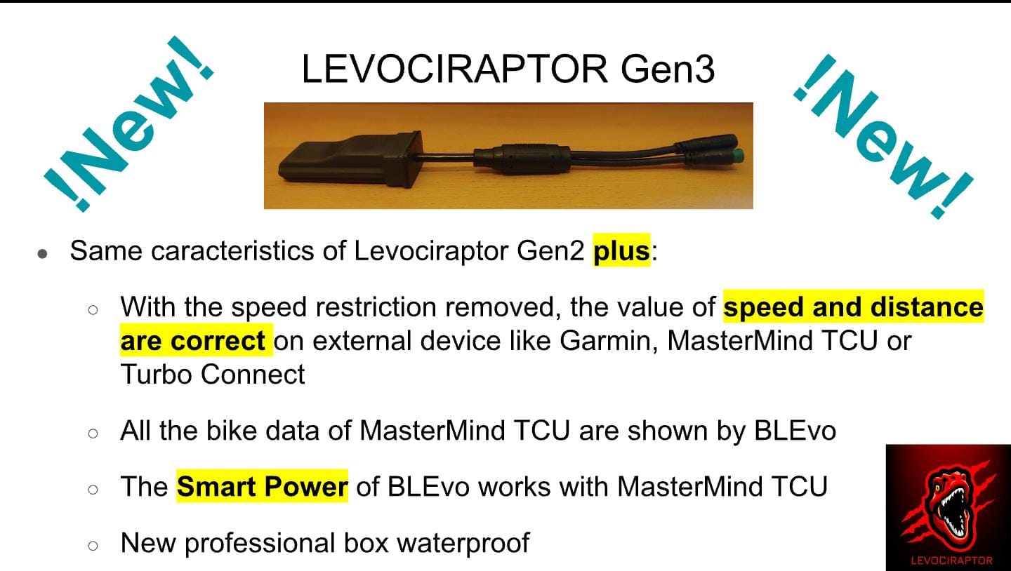

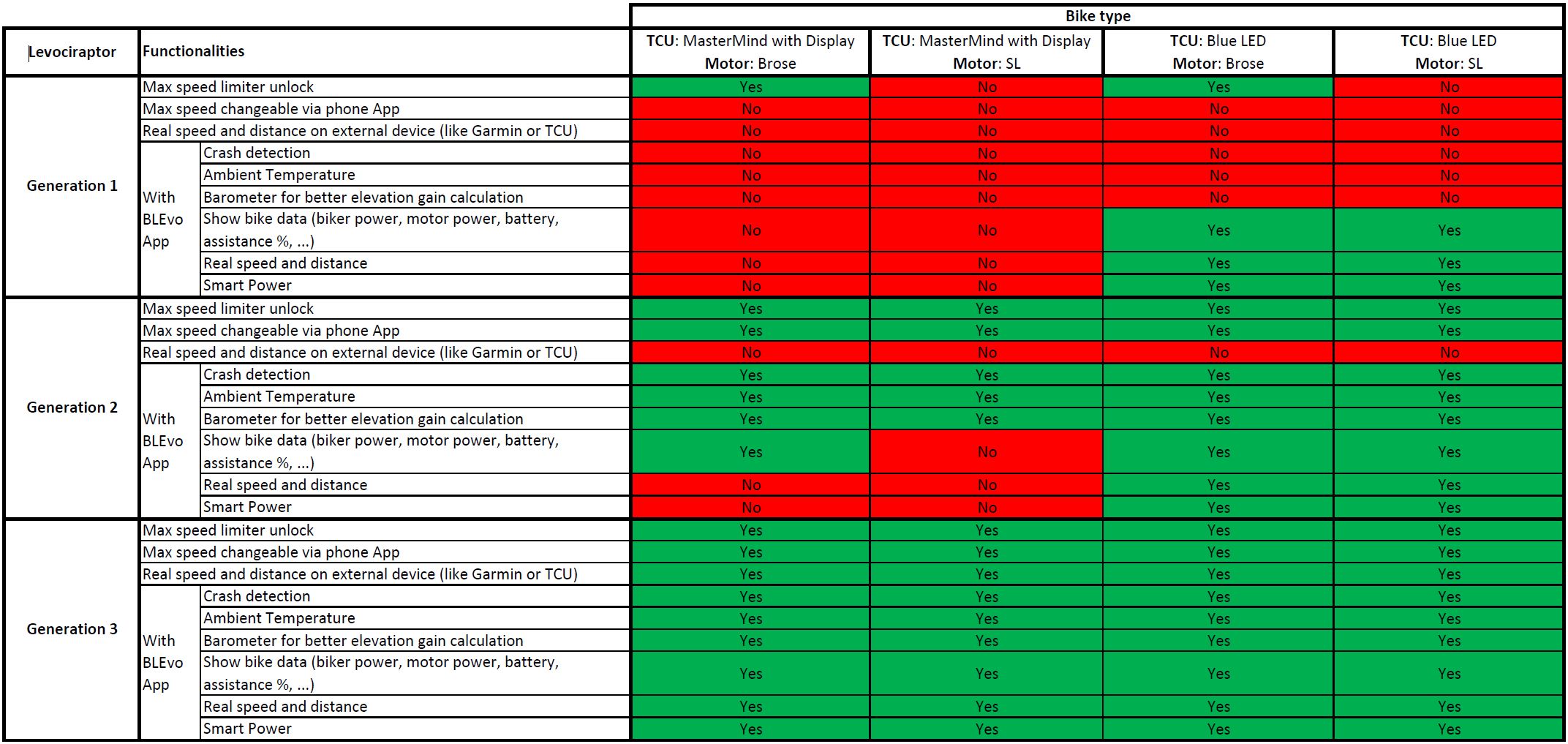

I'm very happy to say that the Levociraptor Gen3 is available for presale!!
Now thanks to the Levociraptor Gen3 you will be able to use BLEvo also with the MasterMind TCU and the Smart Power will be much more responsive and fluid.
I am attaching 2 screenshots explaining all the new features.
For any information, write to [email protected] or visit the website www.levociraptor.com
Good news!!
What about Blevo with Gen 3?

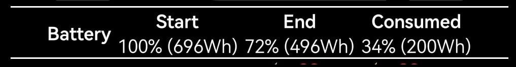

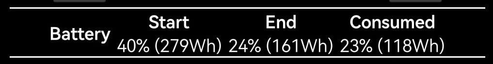

just out of curiosity: Every single day I wonder why my ride statistics always report these kind of strange looking (at least for me) % values for remaining battery capacity and consumption. Maybe someone can explain the displayed values to me ...
As an example the values BLEvo showed today:
- Start: 100 % (696 Wh) (remark: played around with the light a bit on yesterday evening)
- End: 72 % (496 Wh)
- Consumed: 34 % (200 Wh)
First of all: If we take the nominal 700 Wh as a basis, 496 Wh would not correspond to 72 % but 67.0 %.
First thought, BLEvo may take the starting 696 Wh value as 100 % - which would of course still not be 72 % but 71 % , but it would at least be close. Nevertheless, I seem to be wrong, as yesterday's example shows (follows below),
However, I found no way to end up at 34 % for the consumed 200 Wh.
For me, 200 Wh equals a consumption of either 28.57 % (based on the total of 700 Wh) or 28.74 (based on 696 Wh) ...
OTOH: If we take 200 Wh as 34 %, this would mean 100 % ≘ 588 Wh ... does this appear strange to only me ...?
Things get even stranger if I start my ride with less than 100 % battery. Yesterday's values:
- Start: 40 % (279 Wh)
- End: 24 % (161 Wh)
- Consumed: 23 % (118 Wh)
My thoughts:
- 40 % ≘ 279 Wh => 100 % ≘ 697,5 Wh - looks pretty fine, but falsifies today's assumption,
BLEvo may use the start battery level as basis
- 24 % ≘ 161 Wh => 100 % ≘ 670.83 Wh ... ahem, already missing 27 Wh, am I? 23 % would at least be closer to 696 Wh
- 23 % ≘ 118 Wh => 100 % ≘ 513 Wh ...?!? I have absolutely no clue, where these 23 % may come from ...
Am I missing s/th or is BLEvo just guessing the percentages ...? ;)

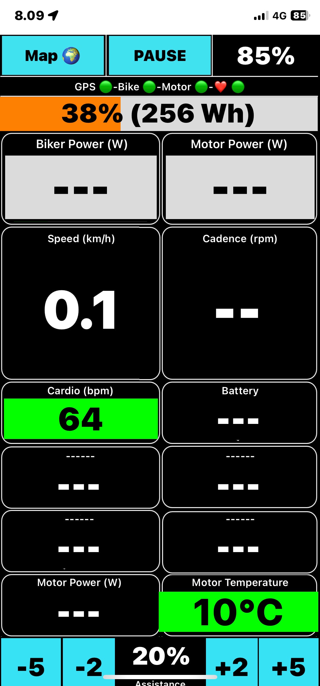

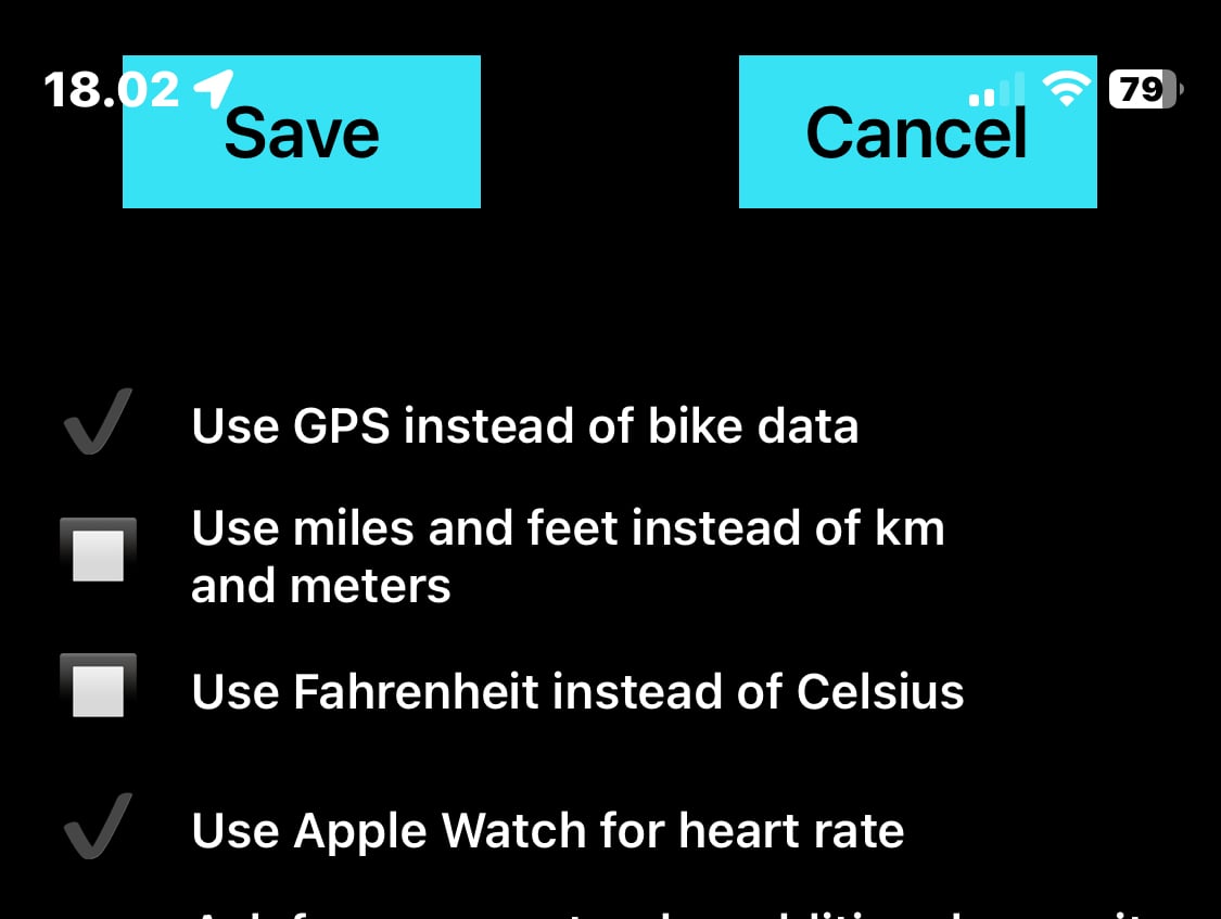

Has anyone succesfully paired Apple Watch Ultra with BLevo?
This is what i got when i first powered Levo and and opened BLevo. When riding at first heart rate stayed that same 64(not measuring anything?), then it became totally blank. So i finally put Strava on on my Ultra, seems to a better option. :D
What else i have to do than this?
Sorry but the new Apple Watch cannot send the heart rate in real time to avoid to high battery consumption...
