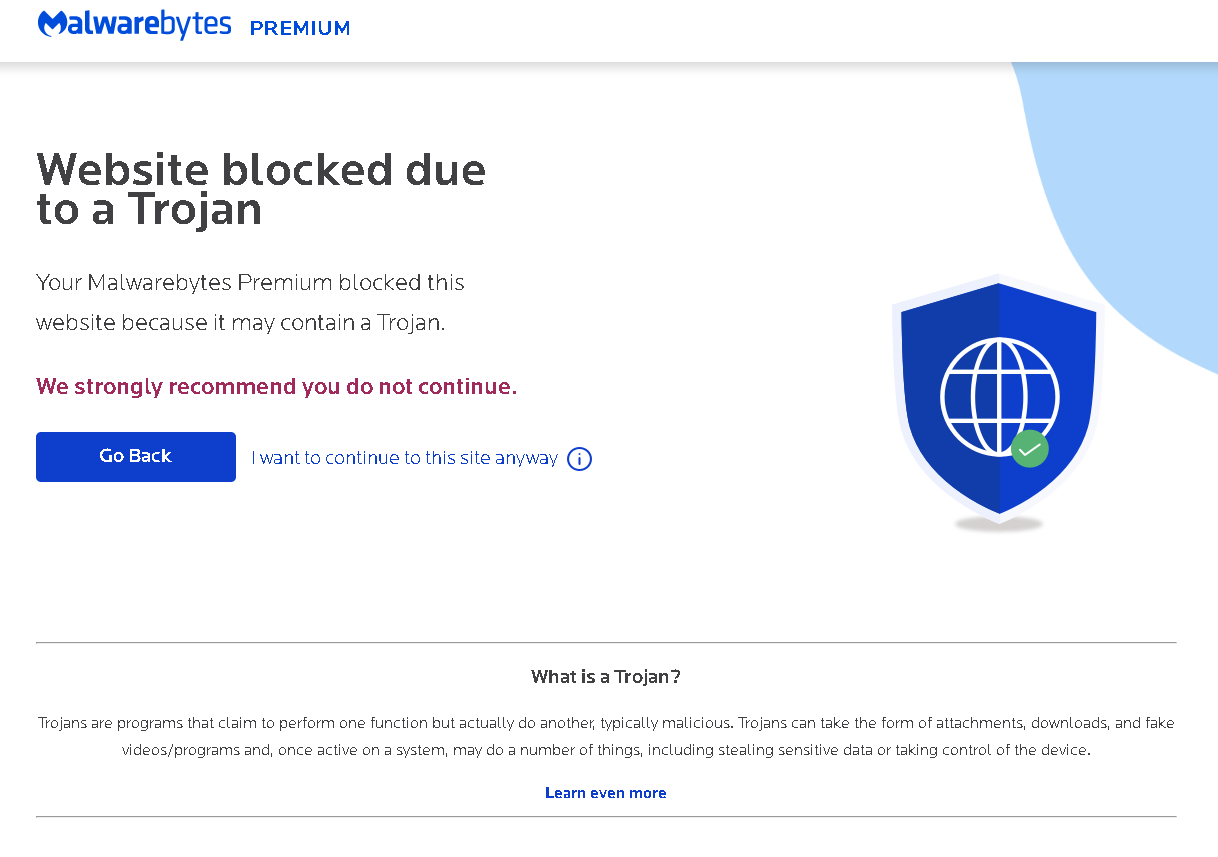

Hi All
just installed the Android App and then wanted to go to stepsunlocker.com
But my Bitdefender shows following critical Notification. Does anybody have experience with this, is there a simple answer to that, or is this page really critical?

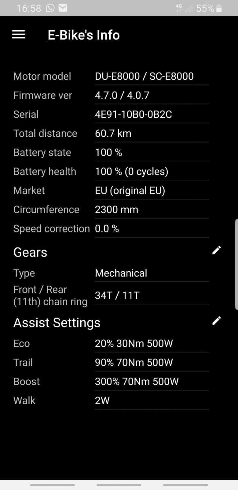

Today I decided to by the license, 30 Min. later my bike had pretty small wheels and accelerated to more than 30 Kmh. That's absolutely fantastic and a good deal.
I prefer to change only circumference of my wheels, so there will never be a hidden speed recording above 25 Kmh under assistance. I think this is the best way not to jeopardise warranty. I do not care about speed indication, for this I have GPS. With the app I can change back to original settings within a minute, before driving on public roads.
Thanks very much to the authors.
